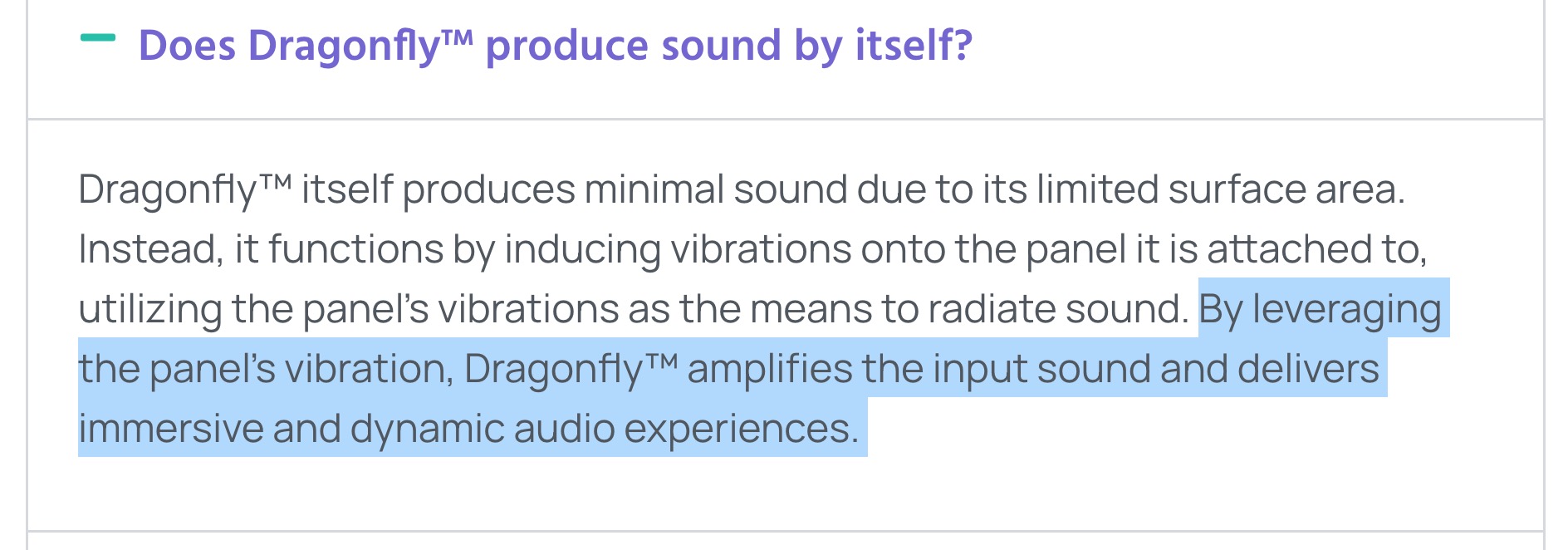

Interesting word salad, "By leveraging the panel’s vibration, Dragonfly amplifies the input sound and delivers immersive and dynamic audio experiences."
In fact, it is the panel itself that amplifies the sound through surface-bending waves, with the quality of the audio being contingent upon the surface and its inherent quality.
Once you purchase a piezoelectric speaker or a standard exciter, if the resulting sound doesn’t meet your expectations, you find yourself needing to buy another, and then another. However, if you’ve simply wound the coil yourself, you have the flexibility to redo it. Instead of committing with glue from the outset, you can use tape to test the sound first. You can also adjust the size of the coil based on the dimensions of the neodymium magnet available, or vice versa. The DIY spirit to the fullest.
