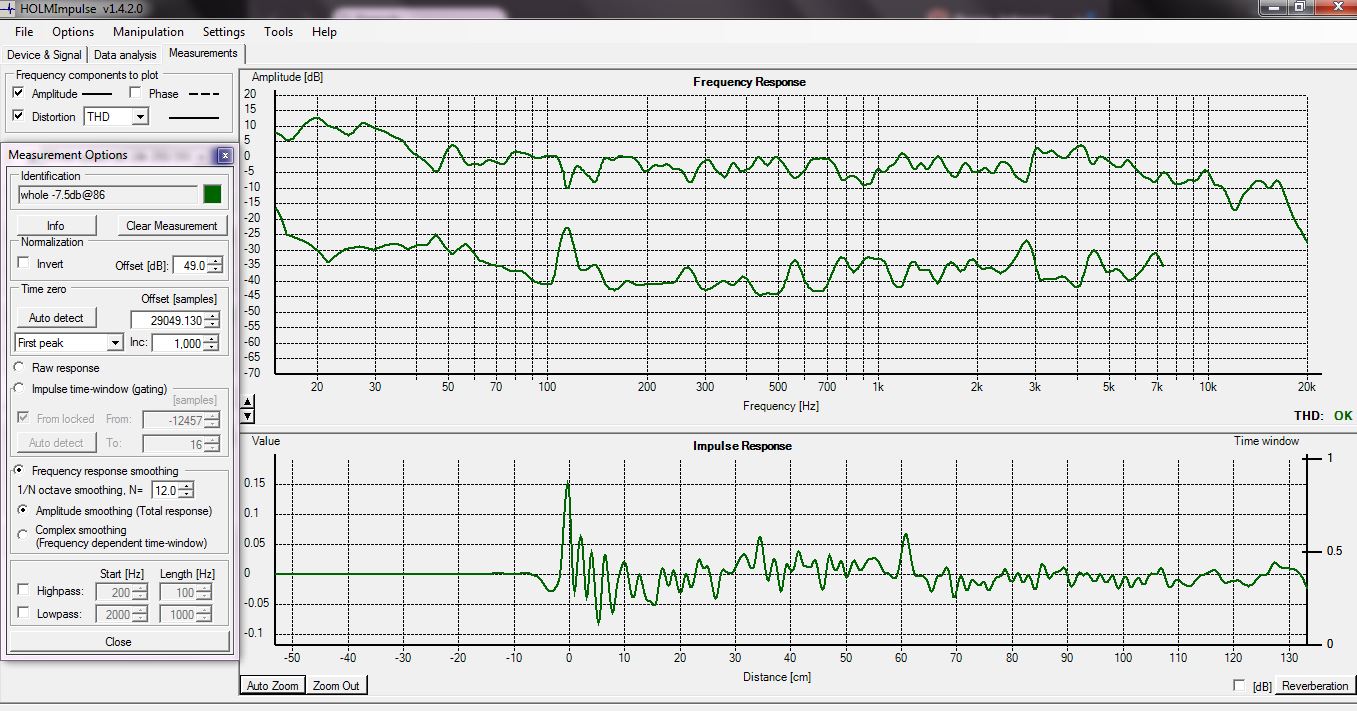

Hi Eric,
Sorry you haven't had good results with XPS. I have gotten pleasing mids and highs with Foamular 250 in 1", coated front and back, 19x32, with 1 Thruster, no frame or spine. The attached response is with a sub to 70 Hz, 70-300 cones and DML for everything else.
Tri-amped. EQ is 6 db hi pass at 7K. No muddiness quality at all. My main complaint with DML bass is that the distortion goes up (with my panels anyway) starting around 300 and down so I'm using cones for now. My goal is to have low distortion, high output DML down to 100 and then use the cone sub from there. Does anyone think that is really possible?
Bruce
Hi Eric,

Bruce,
I have tried 1" Foamular 250 also, but without PVA coating. Since it didn't eliminate the muddy with 1/2 inch, I didn't bother trying with the 1".
I see the same with distortion, but I would say mainly below 200 Hz.
I haven't used HOLM, is the lower line in your plot THD?
Thrusters arrived just today. I'll see what they do, but I'll be surprised if they make the difference, WRT muddiness.
I must admit I hate that I don't know how to measure muddiness. I hear it but don't see anything I can point to in REW measurements. I do see the HF fade with PS in REW but I don't believe that's what causes the muddiness I hear.

This measurement looks a little odd to me,a sharp roll off at 200hz ,down 15db at 150hz ?,no exciter or panel resonance?,to be honest if you wanted to xo at 200hz this would be perfect,can you give the mic position please.
You say you supported the panel along the long edges with foam ? Against what?and why?
Did you find the spot where the exciter makes the panel rumble before applying the foam strip?
If I placed 8ft of foam along the long edges of any panel let alone A very narrow panel I would expect damping of panel movement to happen,but I must say I'll be surprised ,a little anyway,if it caused that heavy a drop .

Generally I've found the response for my plywood panels above 200 Hz to be pretty flat, almost regardless of how I mount them and I agree if you use a sub below that it works pretty well.
Now, with respect to the foam mounting: My intention was to support the tall panels similarly to BurntCoil. Admittedly, he used foam in shorter intermittent strips along the long sides, rather than continuous strips, but in my judgement, that difference is trivial.
To further clarify, in my view, the "default" support for a DML panel is to mount the panel to a frame of the same outside dimensions with a soft foam around most of its perimeter. I can't say for sure if the primary function of the frame and foam is damping, or if it is modification of the boundary conditions of the panel, or a combination of the two. But I can say that I have found that when less than roughly half of the panel perimeter is attached to a a frame via foam, the likelihood and extent of lumpiness in the LF response increases significantly.
So for me, the use of foam support on JUST the long edges is actually less support than "normal".

Thanks!Two exciters actually. My favorite combination so far. One Dayton Ultra (better LF), one TEAX32C30-4/B (better HF).

I get the impression that whatever I say regarding your xps panels, isn't going to go down well.
So let's look at your measurements and your own words.
Your measured response fall off after 2k !
You say your panels sound muddy,muffled and unfocused.
And you also say applying the default ? foam around most of the outside of the panel basically reduces lumpiness in the LF(without affecting the sound of the panel above100z?)
For me the measurements say it all,and you are actually confirming what they show.

muddiness is between 200-500Hz. Basically, that's all that your panels are giving you.
Well, if you were looking at that 20dB scale you've shown, anything can be made to look flat!
How about changing the scale to 5dBs... you'll see a lot better.
Personally, I would've thrown the panels away after seeing that FR curve and started experimenting with another material.
