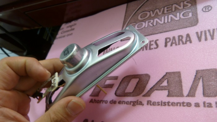

It doesn't look right on the fixing between driver and panel.
Try lengthening the timber and using soft material to couple the panel. Keep the mounting points away from one another. Like the one on the right in my sketch. The driver itself and the panel should be supported separately.
Or, if your driver can support itself, then ditch the wood blocks between frame and panel, and the timber. Then suspend the whole thing by other fixing points on the panel itself. By this, you support the panel only, and let the driver 'float' on it (by its own suspension).
And, your panels looks very near the wall and not much space around them. If they have to be that way, put some sound absorbing material between panels and wall to reduce reflections.
![exciter_panel%20assemby_zpskzxdhgk2.png~original](https://i82.photobucket.com/albums/j263/CLS_photos/Audio/DML%20Trial/exciter_panel%20assemby_zpskzxdhgk2.png~original)
CLS: Thank you for the suggestion. I will do the easiest first: remove hard (wooden) feet of speaker and instead find a softer means of connecting the timber at its far ends. I am leery of free-floating the panel ( = only attached at speaker cones). I had voice coil alignment issues when I tried that with the smaller coroplast panels. A conventional speaker's suspension is tuned to support a lightweight cone, not cone + 16 square feet of foam board
I guess extra foam board qualifies as soft material for the new stand-offs.
![wizard :wiz: :wiz:](https://files.diyaudio.com/forums/images/smilies/wizard.gif)
No doubt you are correct to suggest a panel is better not against or near a wall. However, in my current room (it is small) as hung is probably the best place. Also, if the DML is bipolar or bipolar-like, the backwave should not be as destructive as a dipole?
There is much better bass. EQ is constantly being tweaked, of course. I seem to have peaks at 300-400 Hz and also around 2.5K. Right now, EQ-ed flattish but letting the highs roll off naturally. Sounds very good. With very bassy stuff (electronic, trance etc.) there are still some buzzing issues to hunt down. Other than that, I've heard no distortion even driving them quite hard. I know the science behind the DML is quite complex, but I am amazed the possibilities driver + adhesive + panel offers. Hell, I might even try a legitimate exciter someday

Overall you've given good information, but the stand-offs are best minimized as per CLS's notes above. My current "test bed" confirms this; 4 (x2 ) stand-offs = very little bass; 2x2 = better; all the wooden ones gone and two "soft" (foam core) stand-offs at end of my board = bass!
