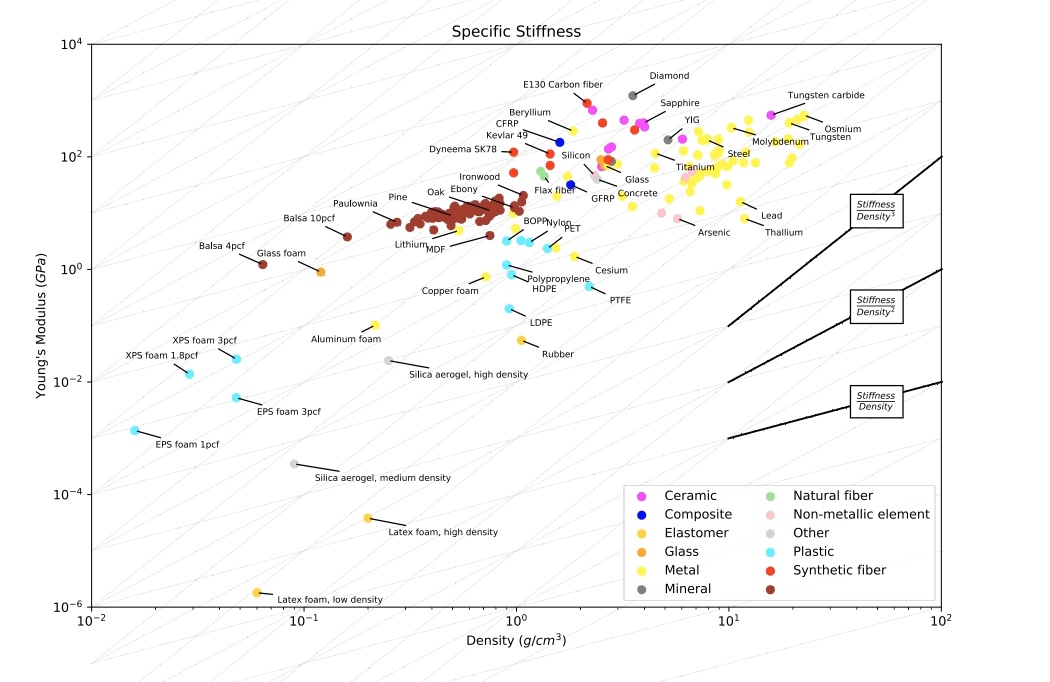

Spent a good part of the morning trying to find information on the relationships between Modulus of elasticity and density, area density and volumetric density. I found this chart on a Wikipedia page on area density. I am still mulling over the chart and all of its significance but taking into account then general observation that the XPS panels( (Foamular 150) sound so good, check out where XPS and EPS lie on the graph relative to other materials. Look specifically at CF, balsa and XPS. XPS is a huge outlier. Conclusions? Share them. I am not an engineer. Is there something about the combination of modulus and density that make it good and potentially make those properties a goal for those trying other materials.
So, that quote and equation tells us the panel must be light and stiff. It also tells us the panel must be isotropic( same mechanical properties in length and width.
Close. Technically, I think it just says that in all directions the "T ratio" (their name for the index) must be greater than 10. It doesn't say that it has to be the same in all directions.
Veleric. I looked this one up and need to know what units are being used for the calculations of bending strength and mass per cubic area to be sure calls are correct.
The units for bending stiffness are Nm and the units for wt/unit area are kg/m^2.
Eric

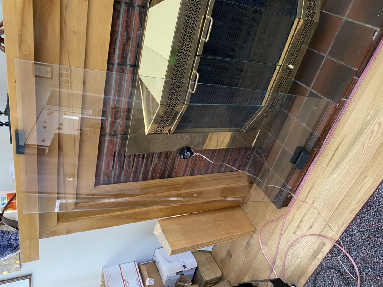

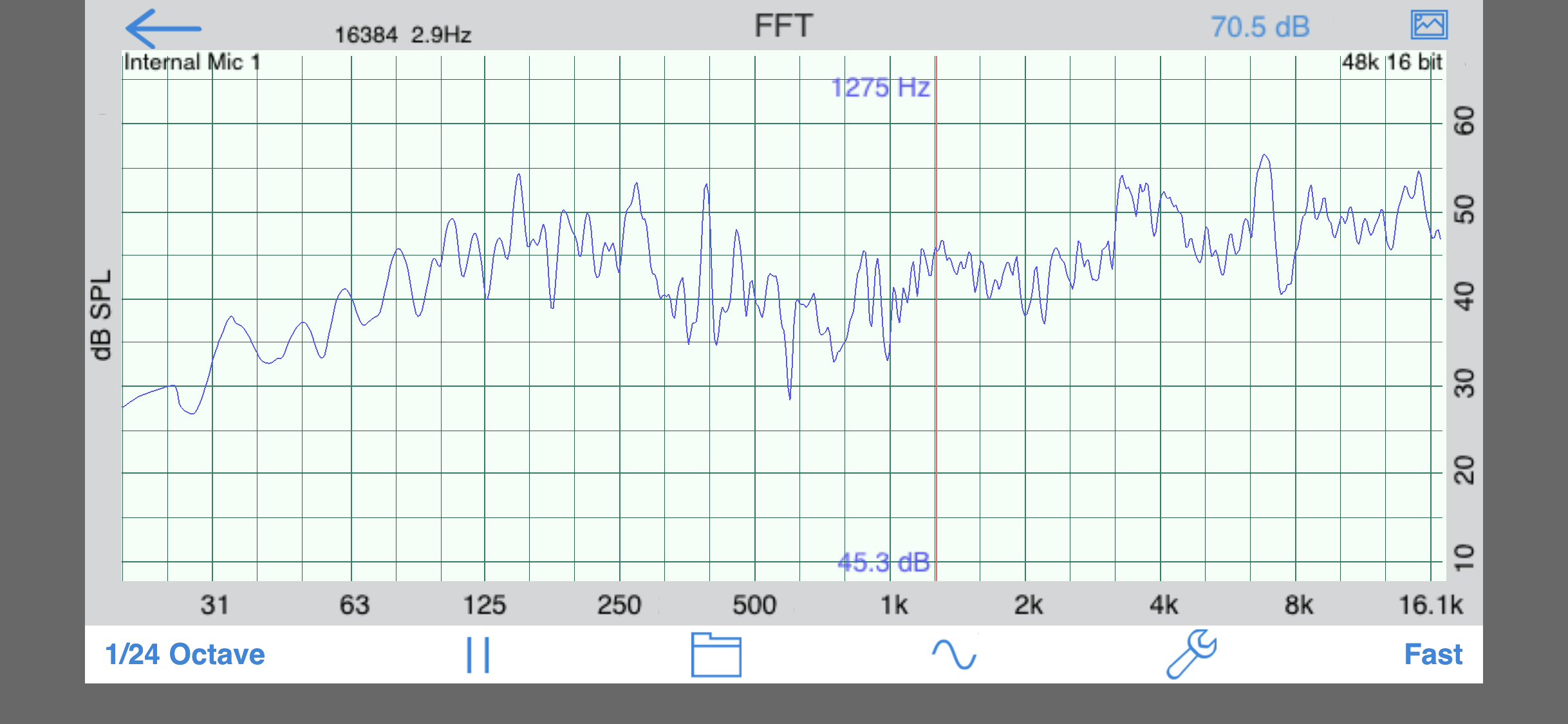

While just messing around... white noise track, 24 x 48 x 0.25 acrylic sheet, Dayton thruster and iPhone Audio tools FFT. Hmmm
Yes, what's special about XPS is that it's specific stiffness is very high compared to most other materials. As your graph suggests, specific stiffness can be expressed as stiffness/density or stiffness/(density squared) or stiffness/(density cubed). Which of the three is most applicable depends on the application. The Heron patents I've been referring to are basically saying that, in the case of a panel speaker (as he envisions it, anyway), the parameter that matters most is stiffness/density^3.
The T index from those patents that I've been talking about (B/µ^3), is effectively the same as E/rho^3 (where E is Young's Modulus and rho is density). In fact, for a homogeneous material:
(B/µ^3) = (E/rho^3) /12
So, at least for a homogeneous material, comparing materials based on "B/µ^3" is exactly the same as comparing them based on "E/rho^3".
Then, to interpret your graph: Locate the dot for the material you are interested in, then draw a line through that point that is parallel to the line on the right side of the graph that is labelled "stiffness/density^3". Look at your new line. Any material whose dot is above (and left) of the new line is "better" (based on E/rho^3), while anything falling below (and right) of the line, is "worse". On that basis, at least according to the data used in the chart, EPS, XPS and Balsa all fall pretty close to each other, and way better than anything else.
I've been going through exactly the same though process as you: What is it about PS foam that makes it radiate sound so effectively, and how do I find other materials that might also radiate as well? My best answer so far is to find (or construct) materials that also have a similarly high T ratio.
Eric
