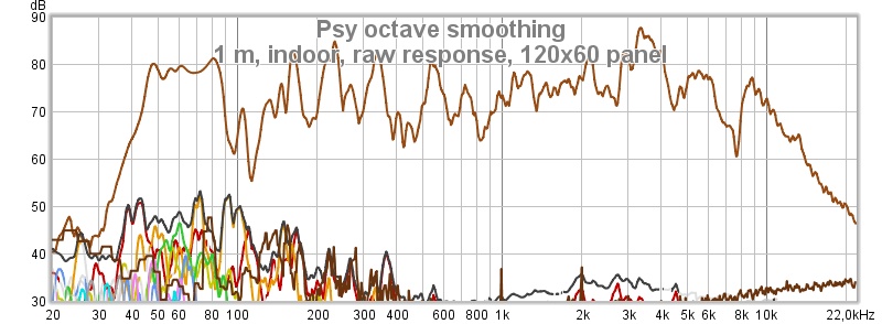

frequency response of my panels
Hello again,
Here is my data of the ASX05408-HD-R exciter movement measured with a MTI non-contact capacitive probe that measurers physical displacement. Here is the link to the technology page:
I have the exciter point up on a metal base and the probe is 2mm above the ground plate. From this data I think that the effect one sees is more piston movement than Surface Acoustic Waves . Not sure that any of the small exciters can produce enough power to distort the panels in any meaningful way. The piston makes more sense in my mind since it is just F=ma and that can easily explain way plywood in not as loud as foam boards because of the mass one has to drive. The data also helps explain the HF drop off that the driver has to the panel.
Cheers
Steve
Hello again,

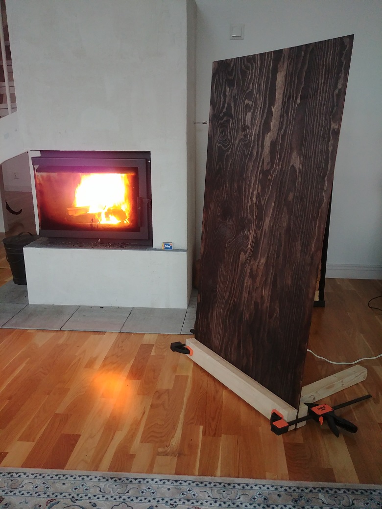

Steve, thank you, this is a great suggestion.
Does this look more or less like your proposal?
![](https://i.ibb.co/ZXXkt8M/Paper-Work-16.jpg)

Or like this

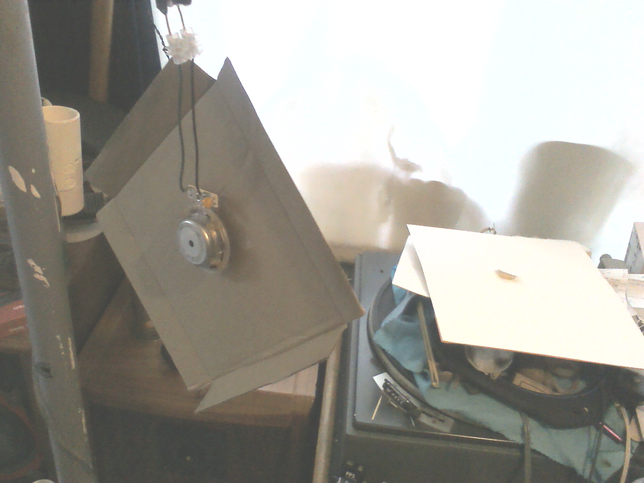

My first large thin cardboard panels used masking tape stretched from the top of the panel to the exciter,I had to do this as I only had ordinary double sided tape to stick the exciter onto the panel.
With this method of taking the weight of the exciter off the double sided tape ,the exciter would stay stuck to the panel for ages , but the masking tape did buzz a bit if I it didn't have some strips of foam attached.

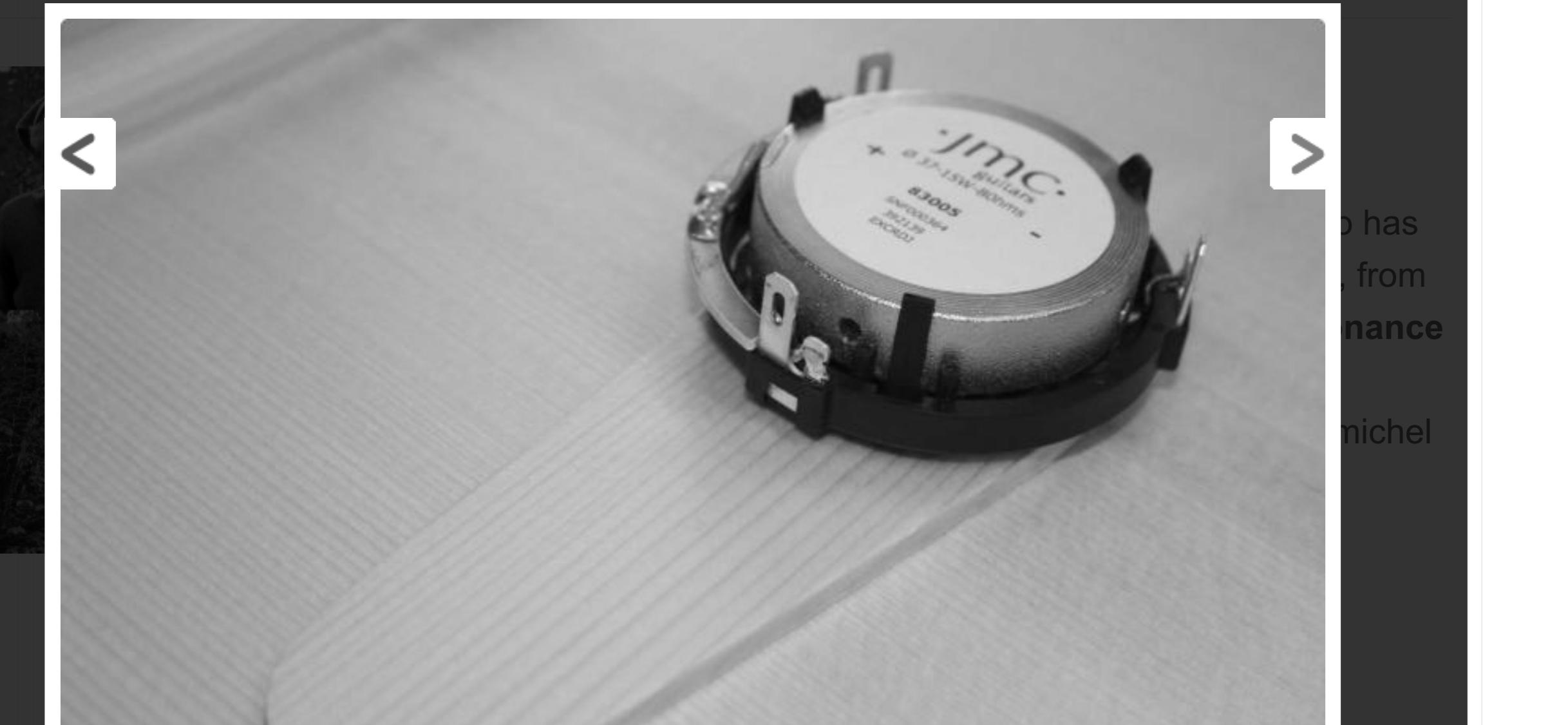

Davelang.
That looks like a well balanced exciter,jmc guitars ! mmmmm haven't seen that one around,you would obviously still have to be very careful with the type of wires and placement.
On my small light panels ,to an extent balance isn't a problem as the panel hangs off of the exciter .
Steve

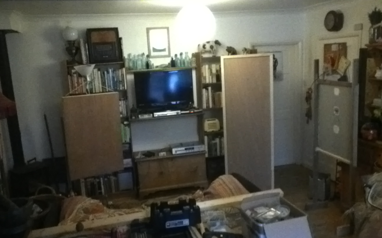

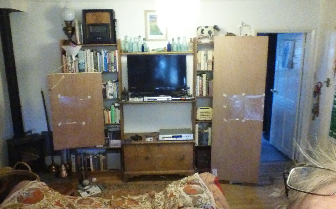

Pictures
Burnsville
Accidentally found some old photos on a first generation kindal,the picture quality would you believe,looks better,but it only has a camera on the screen side,hence my nut getting in the way.
No doubt you'll be seeing a lot more of that full set of golden locks!!!
This was some early experiments,large cling film on the panels ,i didn't think that worked well ,plus,the small paper strip, and at the time , the blu-tack to lower the oil can hump which spanned from 10k to 20k on this panel,if I remember correctly.
Thought I'd put these out there to give you an idea of what I was doing,hopefully I can get in my room and do some tests on this very panel.
Steve

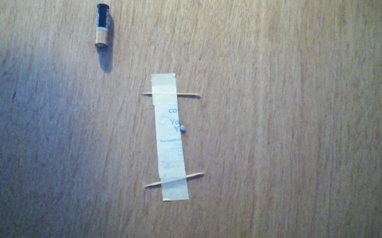

I thought I should explain the difference in sound that a strip of paper makes as it is not massive like adding large amounts of volume.
The recording I posted of the piano playing with recordings made in a tropical wood,is a good example.
I'm not sure if it was that exact track I was listening to,but this is my impressions of what I heard.
Without the strip I could here the water trickle and a bird making strange noises in the distance.
With the strip,the water seems to come alive,you could almost put your hand out and touch it.
The bird was still making the same odd tropical bird sound,(you can tell I know nothing about feathered birds,or any other types come to that) but now you could make out the reverberations through the tree's ,the sound went up and away ,way into the distance.
It was this spacial atmosphere and delicacy that I felt was missing from my ply panels,and the podiums,and heavy panels in general.
These low level sounds sounded cleaner and clearer with more realism as if you were there.
To be honest ,the first time I heard this CD on my eps panels I could not believe the clarity and realism of the trickling water,dml produces natural sounds so effortlessly.
Not just light delicate sounds,I have a test cd with close up machine gun fire!!!
I now know what it would be like to fire a machine gun in my room,a friend of my wife's who put his head round the door in disbelief said he could feel his teeth rattling in his head.
I'd also just like to make a point,that I don't just think this is a mutual conduction between the panel and the strip of paper like a passive ribbon,covering the whole exciter area doesn't work,specially.
At some point when sliding the paper across the exciter area there seems to be some sort of cancellation of the cancellations (General noise) going on in the centre coil area.
I have used this knowledge to help me deal with the problems on my lighter panels but in a different way.

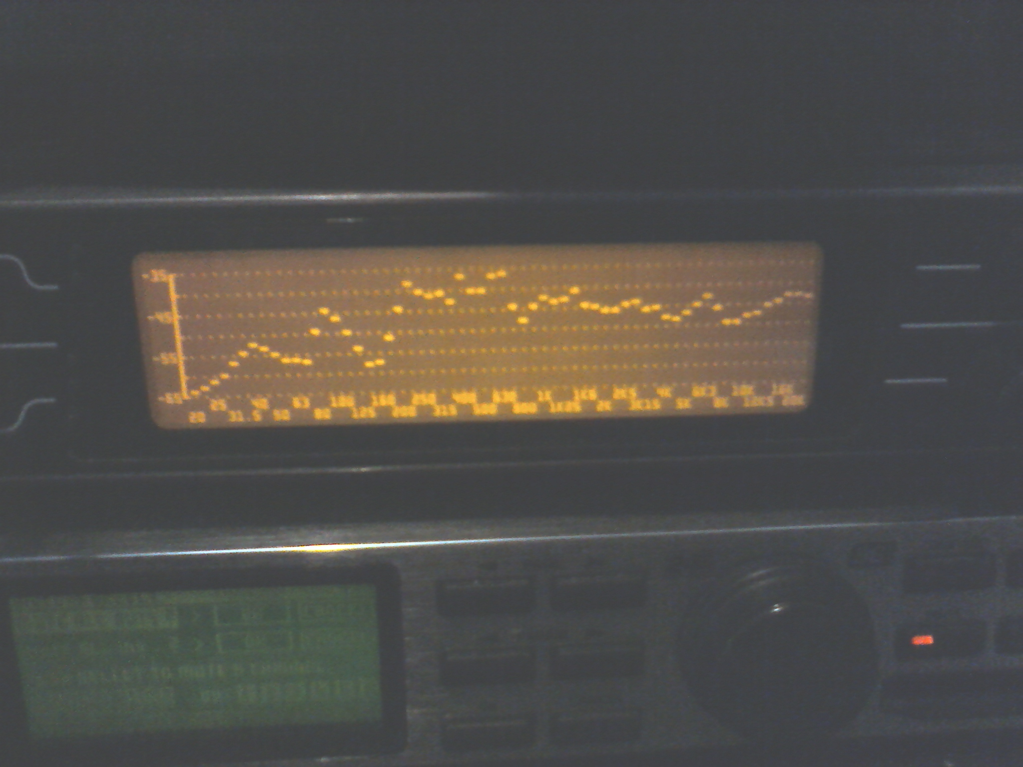

Burntcoil.

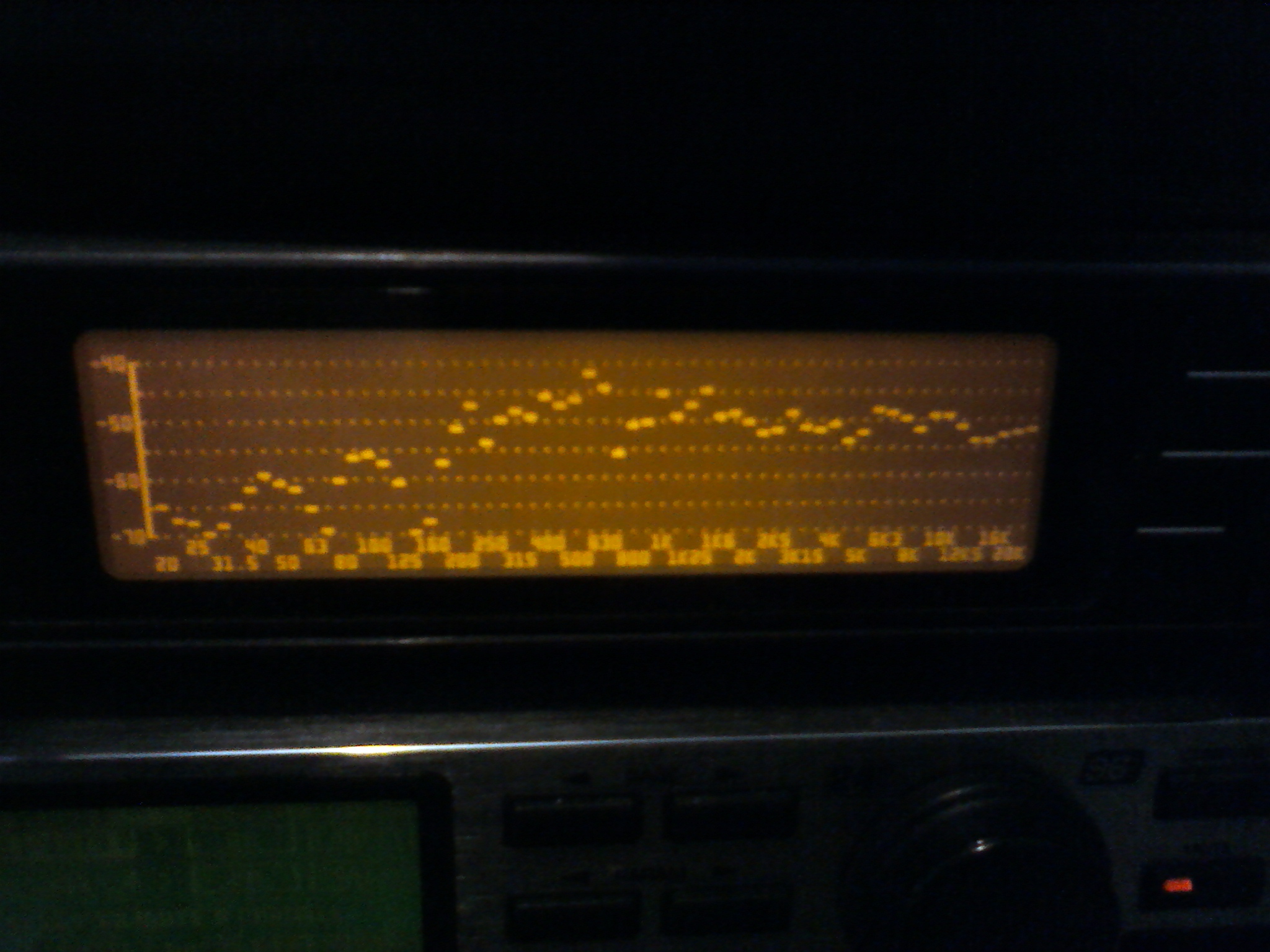

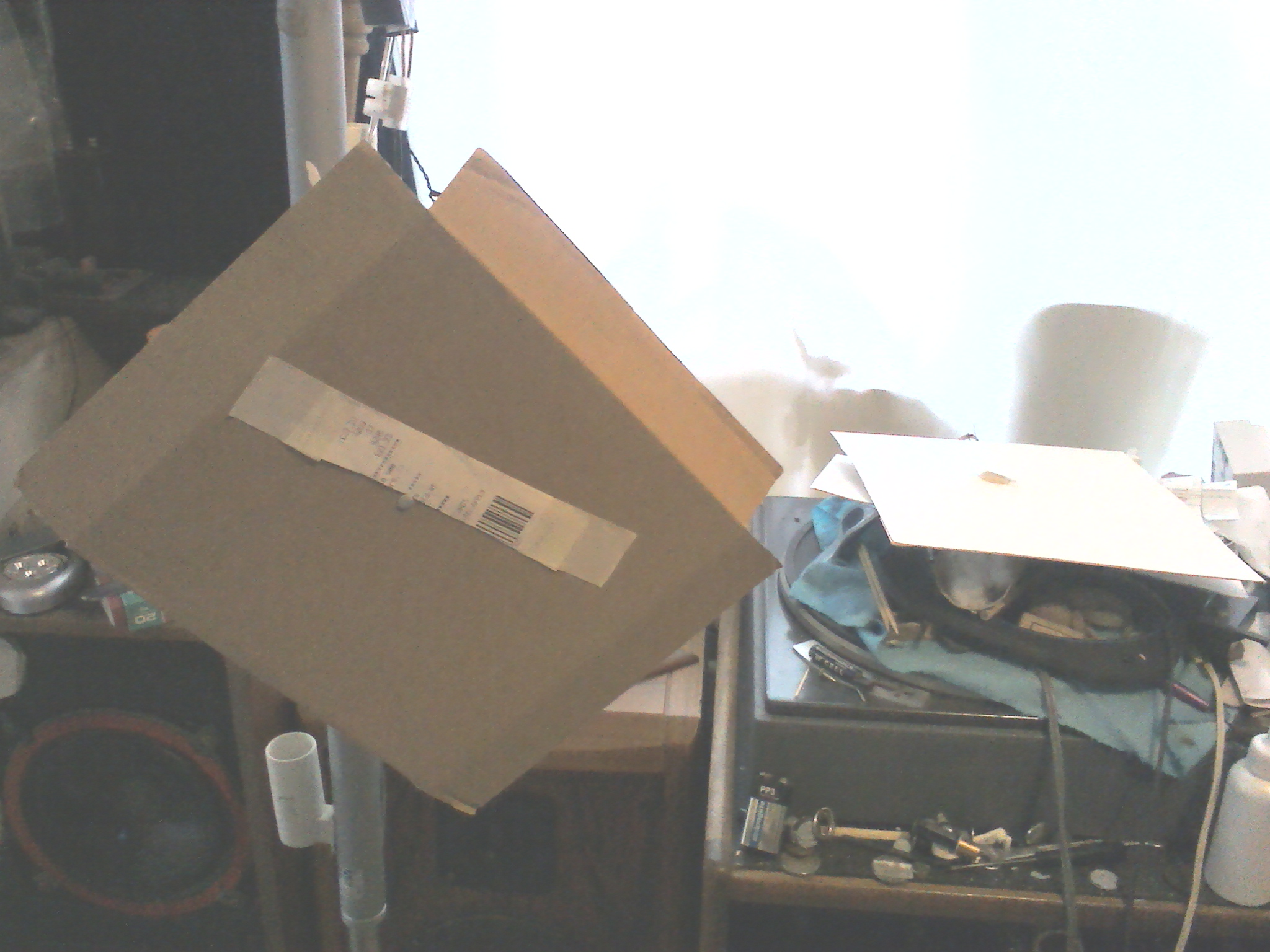

The exciter had fallen off the tall panel ,then I spotted a 7inch square cc board with flaps ,which was 2mm thick ,so for a laugh I hooked it up.
Same principle.
Turned out not so easy to move the strip about as the panel kept moving about as I was trying to look at the deq ,microphone and strip at the same time
and also the tape sticking to me and not the panel !!
It only takes a movement of a few mm to alter this response ,so with time maybe I could improve on this.
But as you see in the first deq pic from the left,there is a rising response from about 8 to 10k where there is a dip, the size and shape changes with different panels.
In the next pic you can see the response in the 8k to 10k region has increased and also we'll beyond 10k,the rising HF has been subdued.
This was why I was hoping you had a good response up to 10k , don't know how your eqing will affect this?
The 1inch strip is only half way across the 1inch exciter area !!
On some panels I have gone just over the half way point so this can change from panel and materials?
I do remember using one piece of tape and a shorter piece of paper about an inch or so but didn't follow up on this,I was more interested in my other panels.
I will see if I can do better on the ply panel.
Steve
