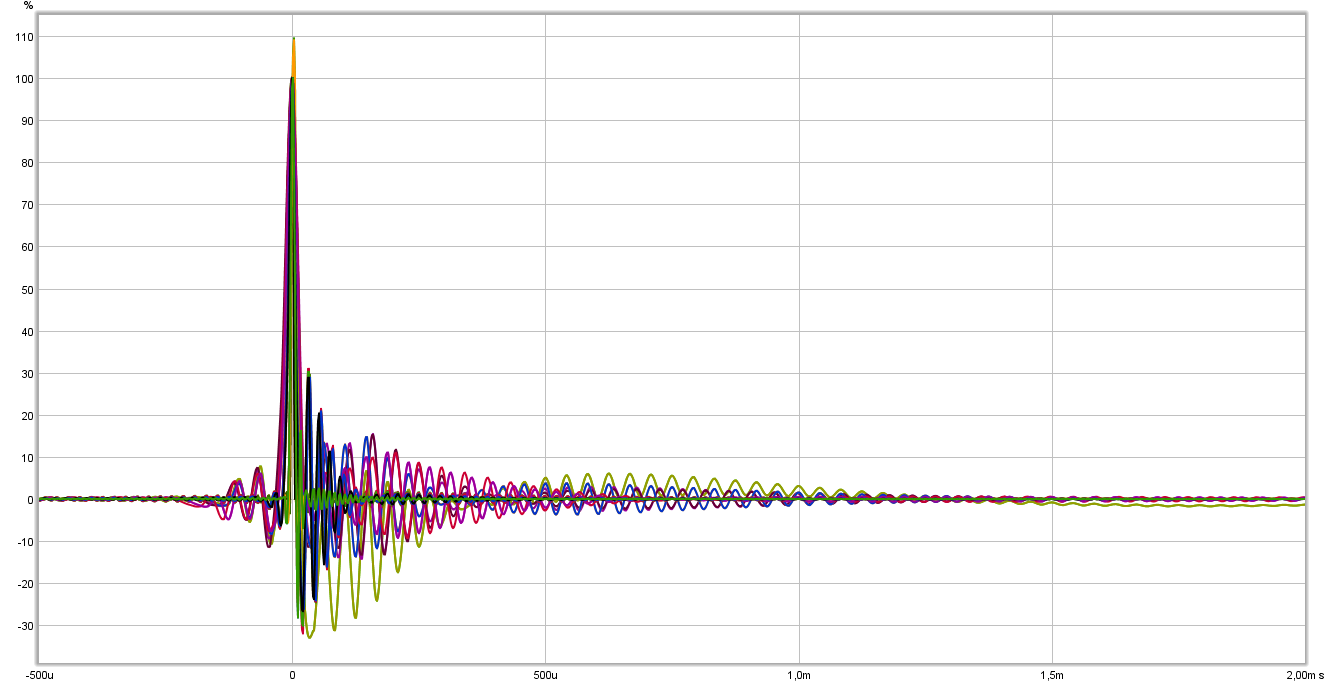

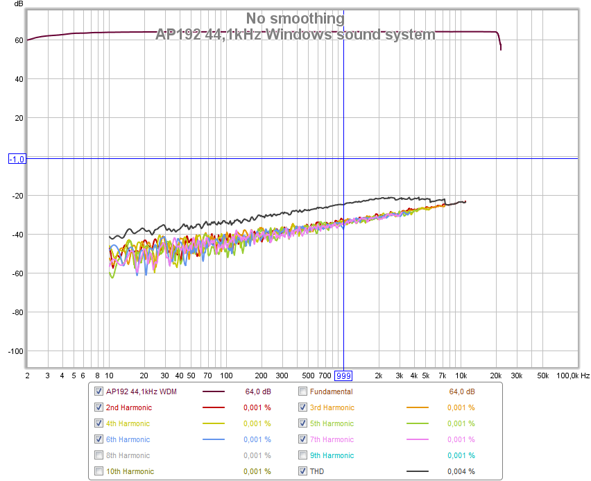

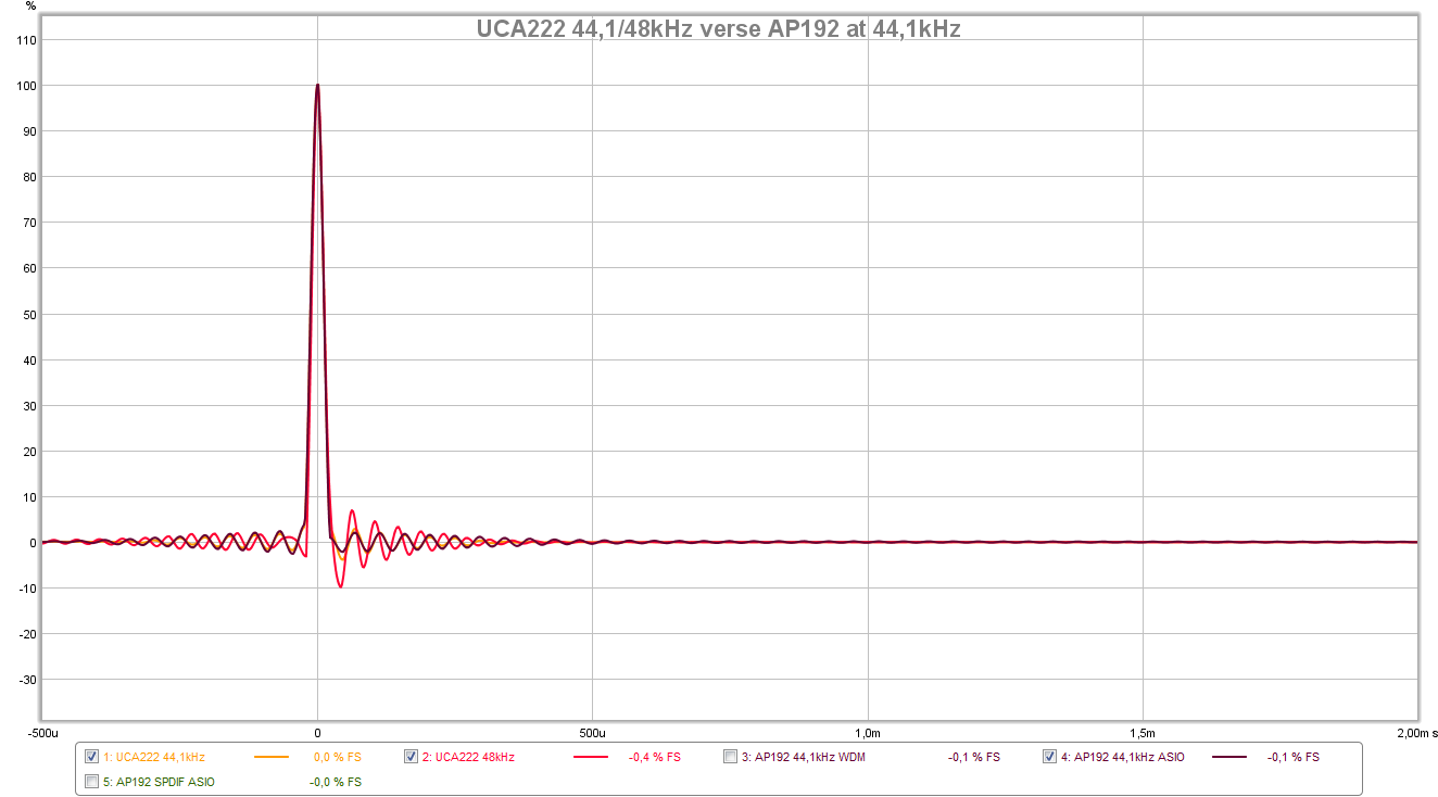

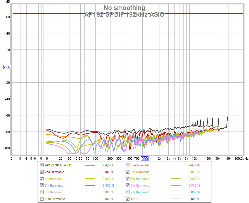

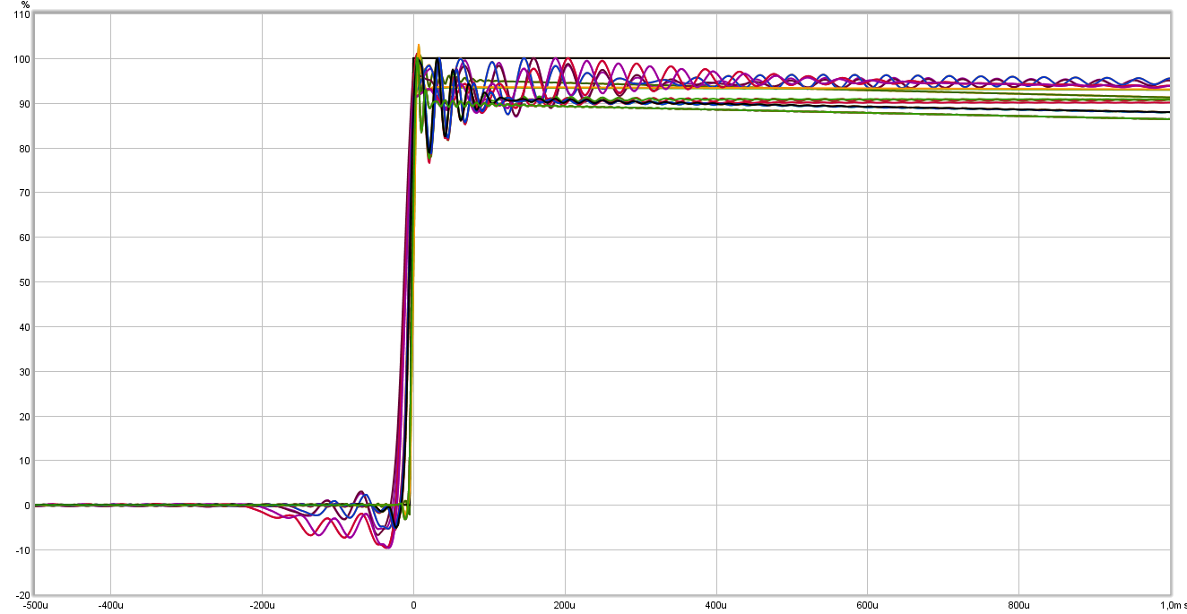

Have a UCA222 which is nearly same as UCA202 X suggested, think its really good performer for CD reproduction at low cost. A 16bit 44,1/48kHz device so if running advanced DSP and one wants more bandwidth to correct nasty's above 20kHz in a IRR filter to tame some peaks/dips for a full ranger or tweeter driver it has limit.
Picture 1 UCA222 running 44,1 and 48kHz looks good when compared to AP192 at 44,1kHz, FR plot is set high resolution 0,1dB per division as in post 186.
Picture 2 and 3 IR/SR the same three.
Picture 4 UCA222 HD where it loose compared to AP192 in picture 5 running Windows sound system, which again loose to same AP192 set as ASIO driver in picture 6.

Thanks for the electrical experiments once again. These are great. I need to try looping back my UCa202 to try this.
Why is 44.1k better than 48k on UCA for step response?

Yes be interesting try loop your UCA202 alone itself by hardwire analog I/O then after that try SPDIF out to the other DAC and back to UCA input and see if any improvement or degrading compared in overlaid plots. You probably know but cant stop saying it because its important to avoid sample rate conversion running windows sound system from Vista and up, remember go into windows sound control panel and change both input and output to the sample rate you intend set in REW to get true benchmark. For the UCA222 on Behringer website they offer a older ASIO driver but admit had never tried it out and maybe its available or same for UCA202, there is possibility it lowers HD by bypassing Windows sound system and another benefit running ASIO is if setting REW to ASIO and changing samplerate inside REW have exclusive access to sound device so one don't need the mess changing Windows sound panel setting.
Regarding UCA222 is better at 44,1kHz verse 48kHz don't hang me if wrong, but think they have relative same roll off filter to cut digital noise and that 48kHz have more bandwidth then seen with 48kHz eyes the roll off is steeper and steeper filters gives higher % attack step compared % point where decay starts, also look at pre verse post ringing is nice symmetri for 44,1kHz and as good as AP192 is, where 48kHz have unsymetri with a lot more post ringing visual both at IR and SR plots.
The differences in tiny ripple at HF are not the primary source in sound quality differences between DACs. High pass behavior of DAC and following amplification stages is bigger player. Looking at big picture of step response zero crossing, phase response/group delay <100Hz is more telling. In a nutshell, it's getting transient perfect response to low frequencies. Problem starts with high pass filter on electrical side, and continues with high pass behavior of transducers.
