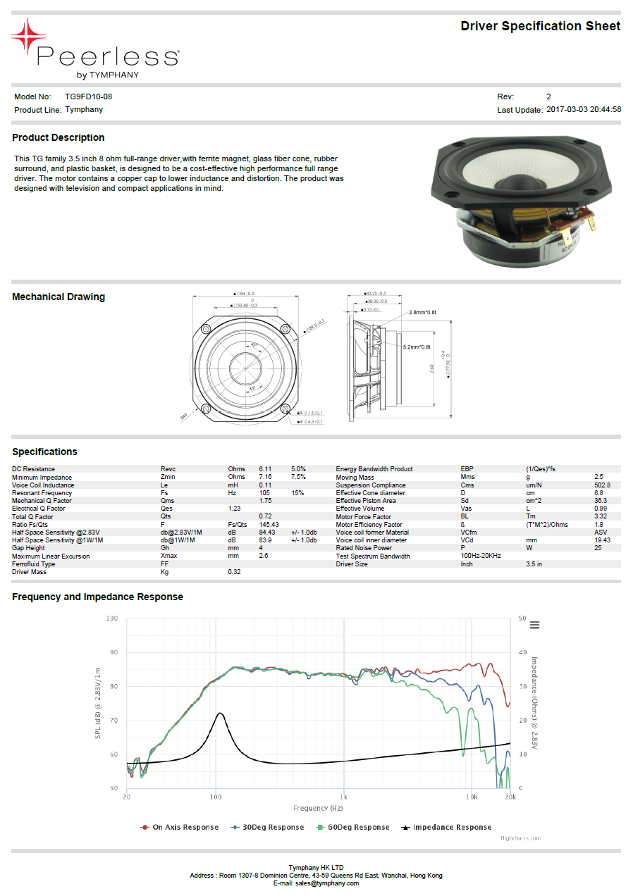

8 ohms TG9 out of box are fair smooth and inside budget so could be one suggestion Peerless TG9FD 10 08 (Vifa 9 BG 119/8 Fibre Glas) kaufen bei hifisound.de
Yes but TG9 are not full range (at least from internet frequency graphs). I hear up to 20kHz and I would like to use it

In general suggested 8 ohms TG9 because its inside your advertised budget and tested in comparison to be smooth out of box which is a parameter that often reflects its worth into other measuring windows such as waterfall and HD. Think 8 ohms TG9 are as much full range as other brands else you have probably looked at some wrong graphs somewhere, its important to get 8 ohm version because 4 ohm version have not same response. A year 2017 datasheet is attached below and also find its various measurements burried into round 2 and 4, here is links:

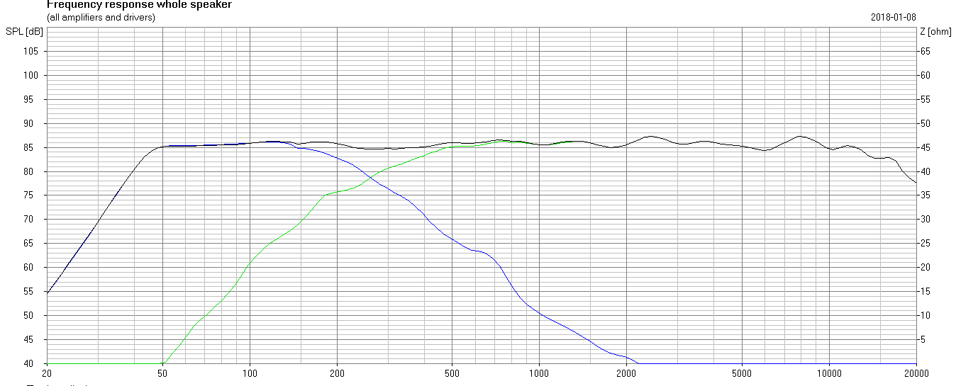

I played with boxsim for a bit and something like this came out:
Where is that graph of the FR from?
+/- 2 dBs from 500Hz to 12kHz, and a very shallow drop on the higher frequencies.... if that was true, they could sell that driver hundreds of dollars.
I have yet to find one that performs like that without a "doctored" graph, hugely smoothed data or heavy EQ.

It's boxsim simulation. Visaton program. Free to use.
I used splcopy to make frd files of drivers. I've made one set of speakers this method already and they sound very good. I can't here any holes or dents in freq.
That driver has +/- 2dB from about 150Hz. This graph is already with crossover. Download pdf from link and you'll see yourself

I take real life data from actual drivers, mounted on the baffle they are supposed to be in, then come up with XO and the likes.
Even flat recognized ones, like the TC9/TG9, or B80, do not come close to +/- 2dBs throughout their spectrum.
