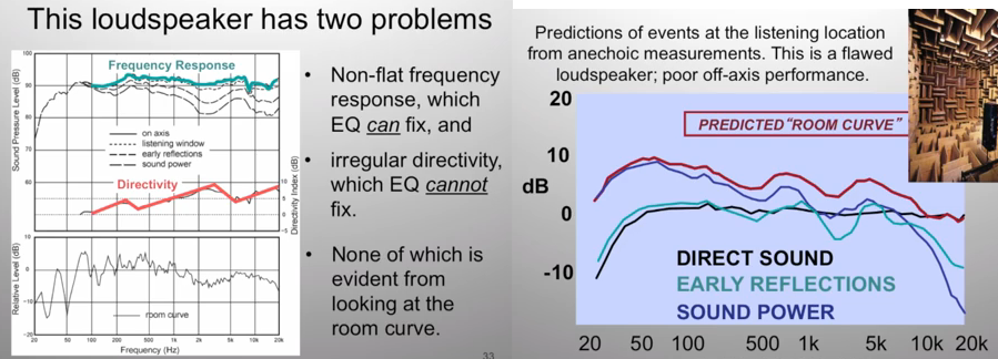

For those who think that a speaker's bad on-axis frequency response can be "fixed" by listening off axis, you might want to watch the latest work from Harman. I think you'll be extremely interested in this aswell XRK. Look's like Gainphile was ahead of his time.

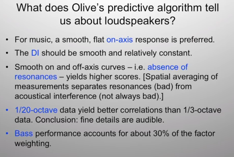

Below is a screenshot of Toole's presentation posted above, where Toole mentioned that we may measure the wrong things, or that our measurement may not be comprehensive enough to cover the important things, but here suggested what is important.

DI is not really important for a 3" full range because the only significant variation in DI is in the top octave - even if you have a point source the top octave or two will be attenuated substantially by the room. Where it would be important is if you plan to horn load the driver.The one with better directivity Index, or the one with smooth linear roll-off should be better.
In the top octave, there is significant variation (very attenuated response), yes, but it is the reason it is not important. We're looking for SMOOTH pattern of POWER response. And that means more than just 30 degrees off-axis.
In the low octaves (below 200Hz), it is mostly determined by room response, so little we can control through speaker design (or driver design in FR case may be??)
So it is the midrange that will have irregular early reflection or directivity.
The whole idea is that in room listening we cannot avoid listening to the (early) reflections, so to make the perceived sound to sound good we want the reflected soundwave (which is a function of off-axis responses) matches the pattern of the on-axis (which is smooth/straight).
True a good power response is desirable.
But is a flat on axis response always accompanied by a flat power response? I think not. Many cases exist where a rising on axis response produces a good flat off axis response and hence power response. This is how I understand many FR lovers use increased toe in to mitigate the rise but maintain a good power response.
I am also of the opinion that early reflections aren't good, especially ceiling and floor bounce. Due to increasing directivity at high freq I doubt much reflection occurs in the last octave.
Do you have experience with 10F/8424 because think it perform over average talking power response when tuned to a flat on axis response.
Example if by DSP set A10.2 or TC9FD flat on axis at mic point in space then when listening off axis or in the door into the room one need to add a kind of smile profile EQ at 1 up to 3 HF octaves to get power response to sound natural right balanced, into this 10F is special set it flat on axis as mentioned above and it need no more attention regarding power response and sound very good balanced even standing in the door into room. I have no measurements to backup this percieved performance all is based my subjective experience but maybe xrk971 can comment upon this, but guess it not to perform perfect response off axis as on axis response but a profile that is better or pleasing than most. For me this point together with other good specs for 10F make the higher cost a lot more fair. For info all three drivers mentioned above was setup as FAST systems.
