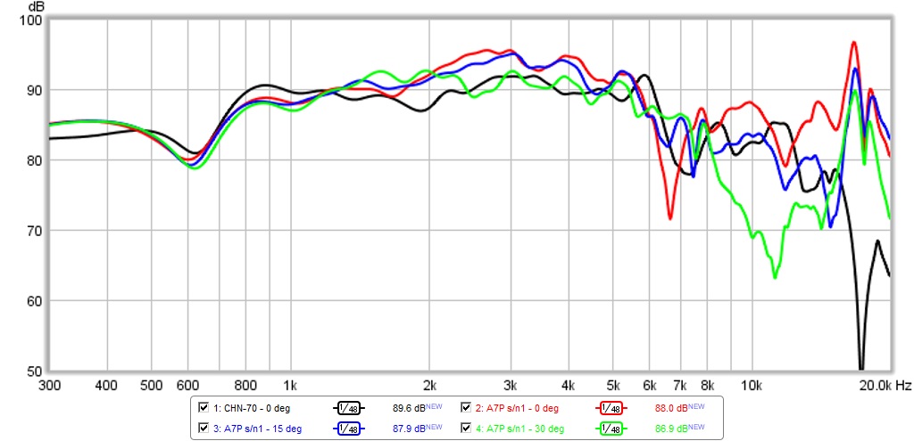

My amateur measurements don't show anything like the published data. In fact it resembles the CHR70 but with extended top end.
http://www.diyaudio.com/forums/mult...blind-auditioning-drivers-11.html#post4394509

Isn't that the CHN-70?
Look at the legends. It is superimposed on CHN70 to show similarity.
Yes, that is what I see. but you have mentioned CHR-70 in your post:
Is that a typo in the post?
I am not sure what you are asking about a typo? I show measurement of a A7P and CHR70 on the same graph to show similarities in the plateau that starts at 600Hz and the drops at 7kHz. On the A7P, it picks back up and has higher frequency response but there is a 20dB peak near 16kHz when listening on axis.
Sorry X, I can see only CHN-70 in your graph, no CHR-70!
Post #101:
Attaching the image file also for your reference.
Post #101:
Oh sorry. Yes typo. I meant CHN70 not CHR70.
