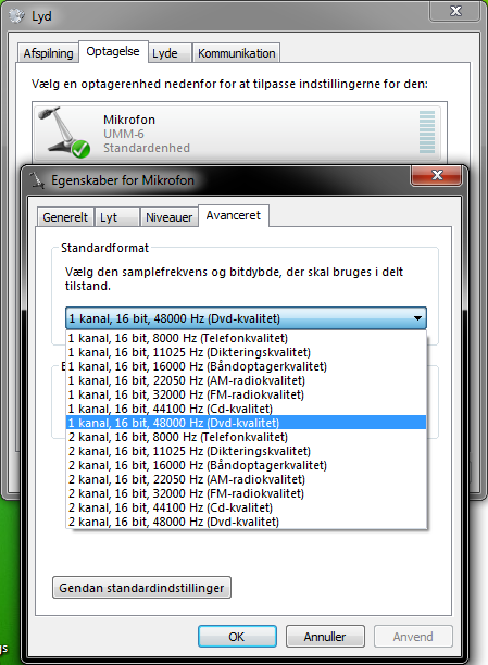

Personally have one ECM8000 without calibration file one UMM-6 and one UMIK-1 both with manufacture calibration files, for me they all worked good and reliable so far. Would although add a note of the USB types than UMIK-1 seems faster than UMM-6 on transients and make nicer and more consistent impulse/step response plots verse EMM-6, probably this is because of electric hardware described below.
ECM8000 verse the USB ones have possibility into REW to math time of flight by ticking "Use loopback as timing reference" when one need to find acoustic offsets and so on.
EMM-6 electric hardware is a 16bit USB class 1 sound card device with various settings for sample rates see picture one below.
UMIK-1 electric hardware is a 24bit USB class 1 sound card device locked at 48kHz sample rate and can not be shifted (Greyed out) as seen picture two below.

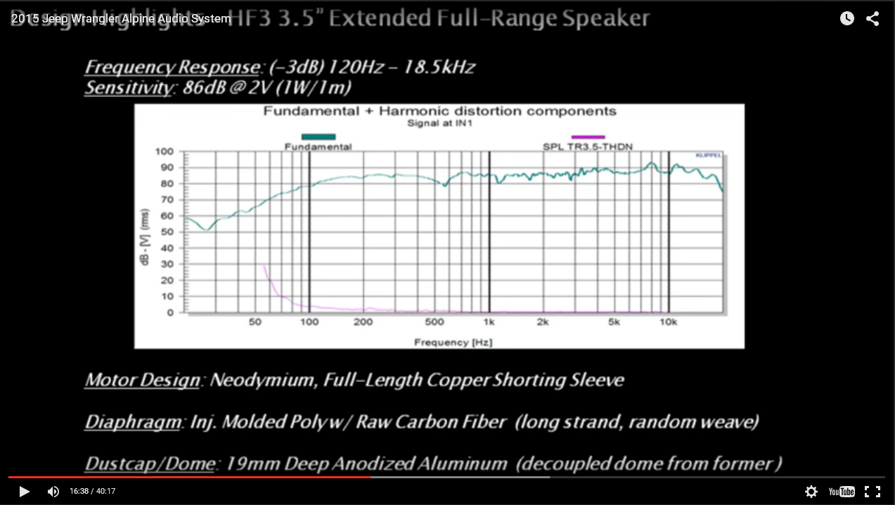

On the way (driver number 5) is the "Alpine HF3" a super cool new full range driver, mostly unbeknownst to this forum... a diyAudio member tipped me off to this driver which is an OEM 3.5in fullrange with a parabolic carbon fiber/poly cone, 19mm dia aluminum dustcap, Nd motor with copper shorting ring unit made by Alpine specifically for the Jeep Wrangler. This member is kindly providing this driver and should be here any day now. It has some interesting (and impressive looking) specs for the price ($18 to $22) and is available at any Jeep dealer (part number 68223392AA).
More info can be found here (go to 16:30 to see description of new driver):
https://www.youtube.com/watch?v=b25jj_zzINQ
Here is a screenshot of the frequency response:
502531d1441540925-subjective-blind-comparison-2in-4in-drivers-round-4-alpine-driver.png

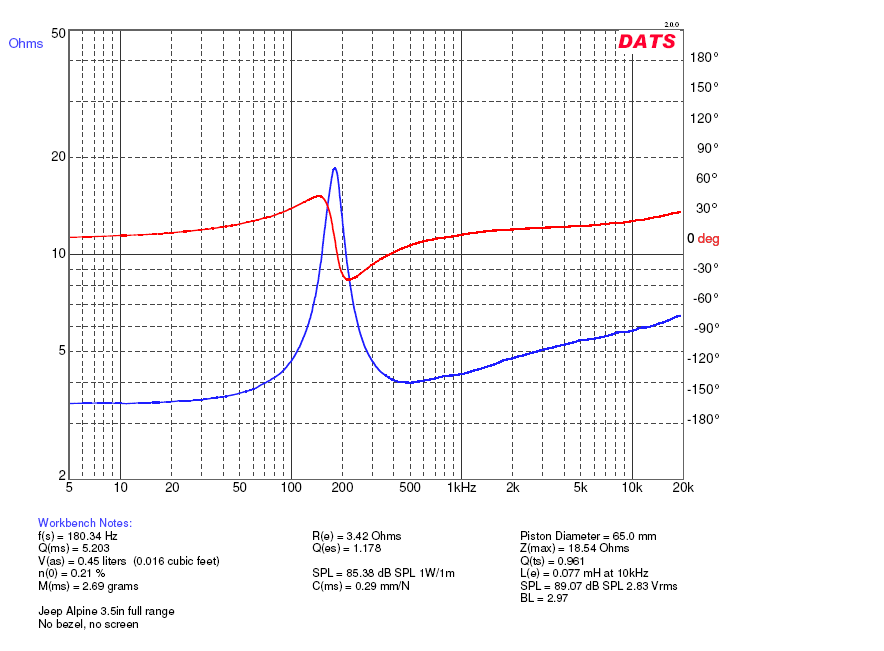

A member asked if TS parameters exist for this driver. I have not seen any published. Here are the TS Parameters for Jeep Alpine as measured with DATS V2 using added mass method on driver with bezel and dust screen removed:
fs=180Hz
SPL=89.07 dB at 2.83v
Re=3.42 ohms
Le=0.0773 mH at 10kHz
Mms=2.865g
Qms=5.203
Qes=1.178
Qts=0.9606
Bl=2.97
Vas=0.45 liters
533834d1456456718-subjective-blind-comparison-2in-4in-drivers-round-4-jeep-alpine-3.5in-ts-params.png
