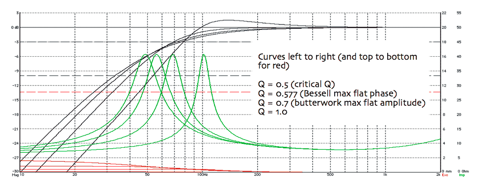

With a bit of EQ i've had SDX7 reaching 25-30 Hz in room (measured). A Linkwitz transform could be used with the smaller box (at a level/power requirement cost).
I usually look at the F10 as more indicative of how low these go.
Attached is the example sim i did for the sealed SDX7 (volume, 3.5/7/14/21 litres, no stuffing)
dave
