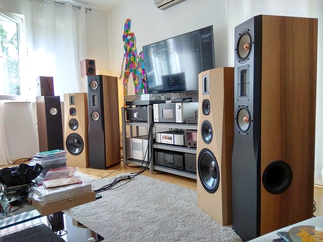

The Mona Kea is not as huge as it often looks in the pictures. 25m2 are no problem at all if the speakers are not squeezed directly into the corners.
I have a picture here with a two-way speaker with 6.5 "drivers in comparison:
This is the "Audimax Core" from the German diy magazine HobbyHifi. Without cabinet, they costs 2,700 euros per pair and could not keep up in terms of sound and sound pressure level with the MK.
The closed box will probably work better for you too, but that's always a matter of taste.
