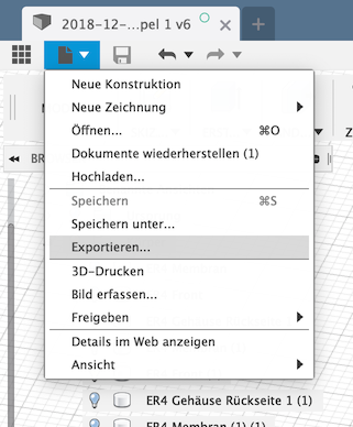

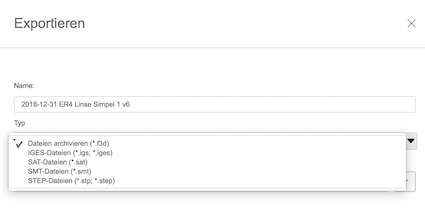

..one just should use stp or igs to go into GMSH and not stl as it already is kind of a mesh and not a good one. For DIY enthusiast I strongly recommend Fusion 360..
-what would be the best workflow for Fusion 360?
Hi Scott,
Basically you construct your 3D-model and export as stp-file. Which workflow specifically do you mean? I could post an example if helpful...
Just a general inquiry.
So that's:
Fusion 360(model) > stp file (export) > GMSH (mesh) > msh file (export) > AEBC3 ?
Export stp video:
YouTube
Fusion 360(model) > stp file (export) > GMSH > AEBC3 ?
Yes, exactly that's the workflow I'm following.
