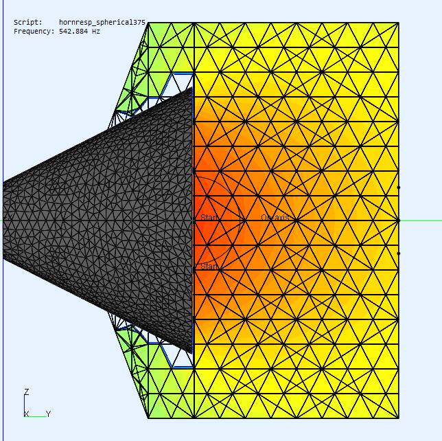

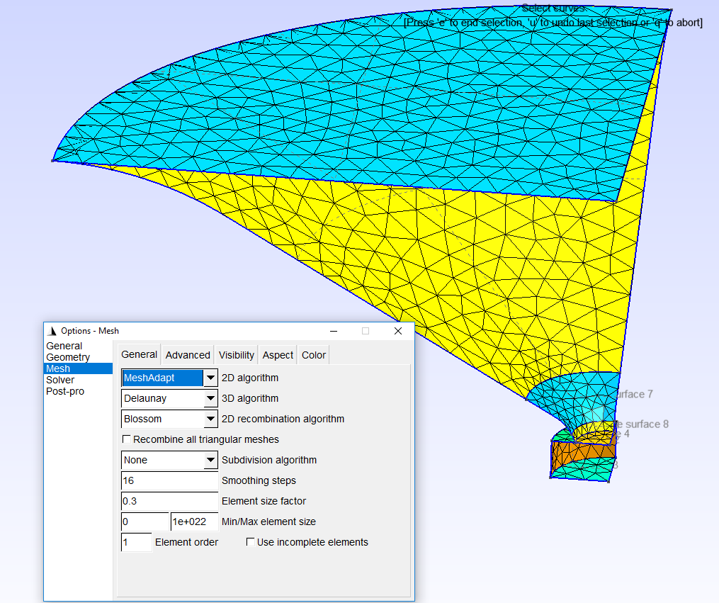

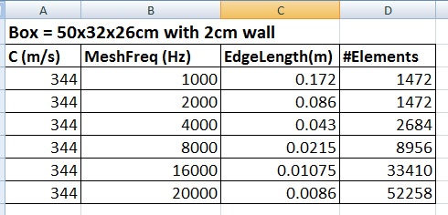

Easy enough to check. The box from post #102 will be used and its 50x32x26cm so approx 1/2 surface of your example. It has a 2cm wall so there is both interior and exterior. I used the formula from ABEC for the reqd edge length and used it to constrain GMSH max length. I know this will prevent ABEC remesh as it satisfies the edge length requirement. The results are in the table below. Even at 8Khz, with no symmetry, the #elements is in the range I could live with and I would use 1/2 symmetry to reduce it further.

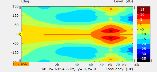

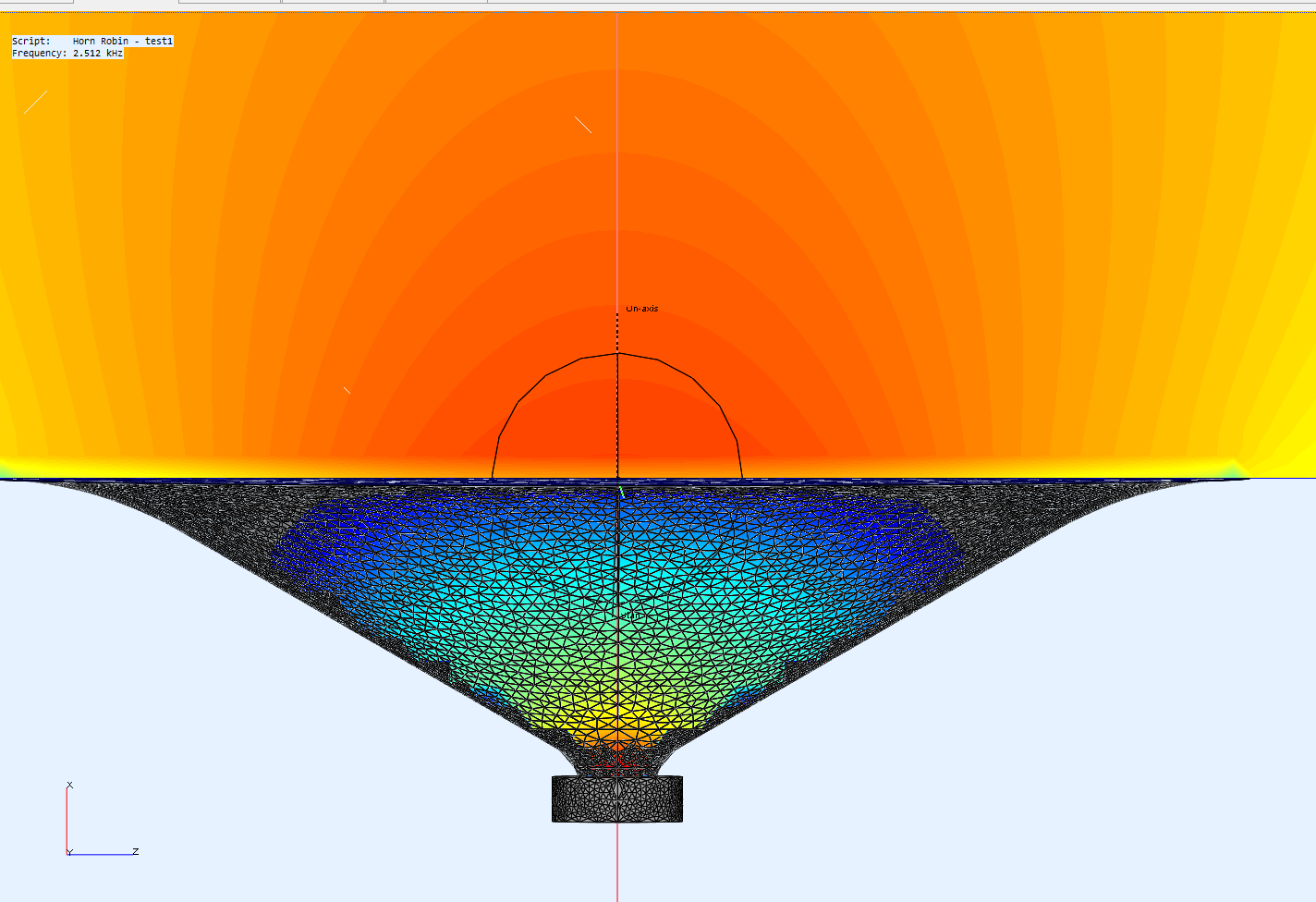

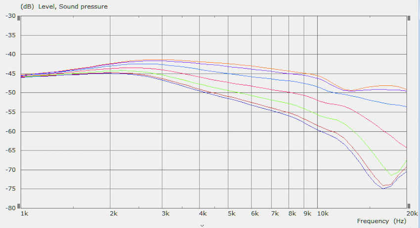

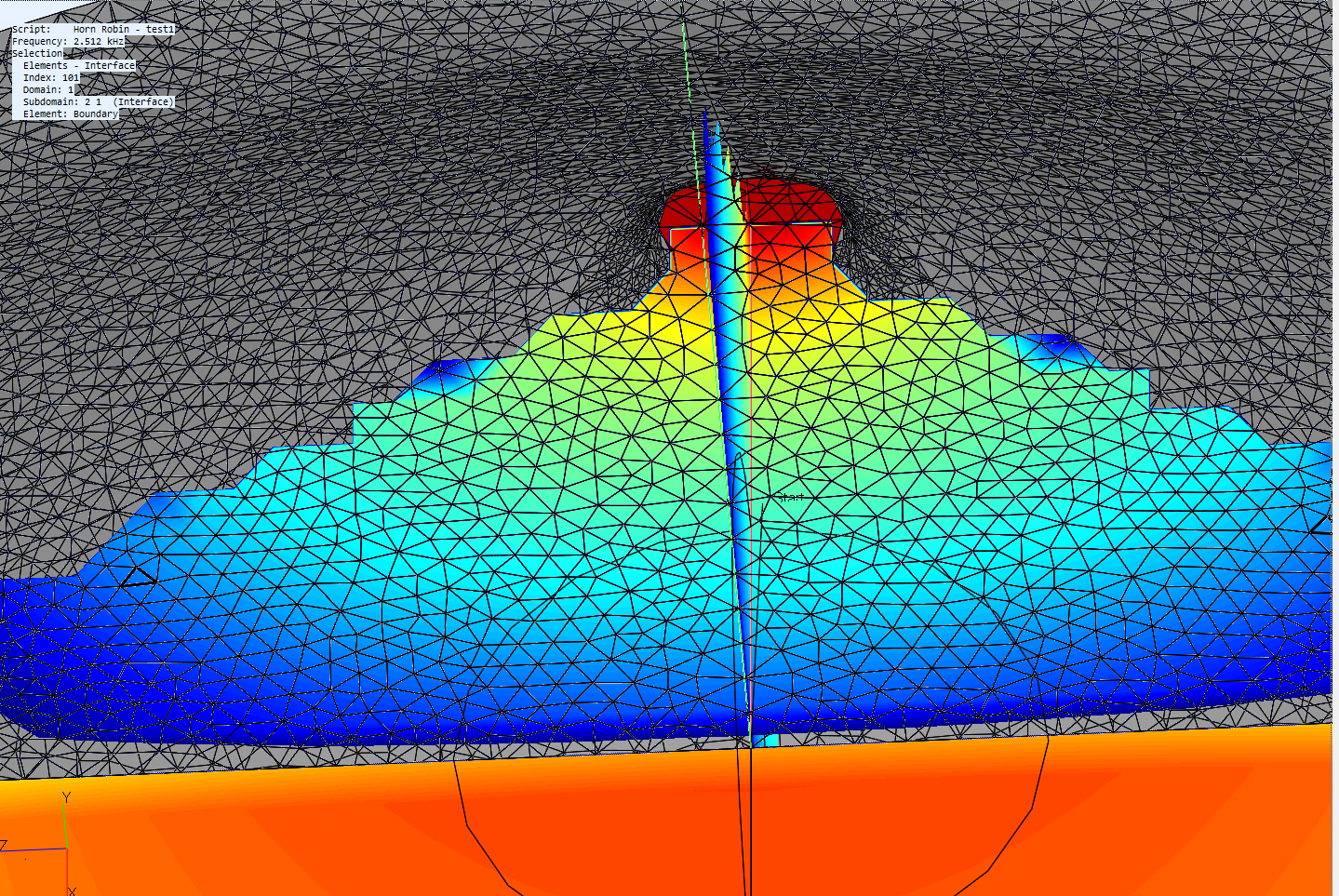

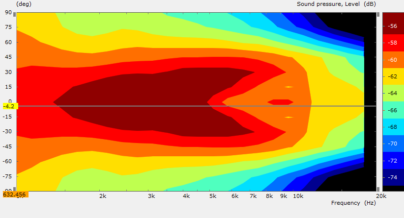

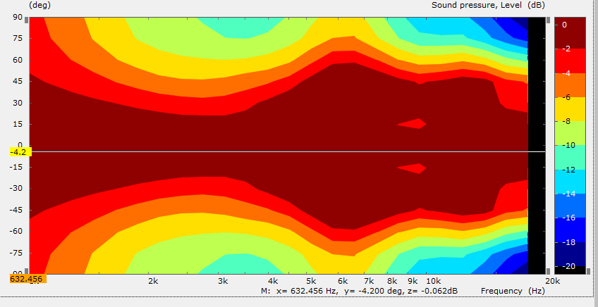

Hi everyone,
brand new ABEC user here, trying to simulate an elliptical OS style waveguide. I am using SolidWorks for CAD, gmesh for meshing.
I am having the same problem I've seen several others here have had. A jagged looking sound field near the waveguide boundaries.
I read that this is usually because of the mesh. To me it looks alright to at least for lower frequencies?
I tried refining it, especially the throat section where there is a radius, but it made no difference except that the simulation time increased from a few minutes to 1.5 hours, so a bit much for initial simulations with purpose of learning. jagged highes.PNG
I also think that the polar behavior looks strange at higher frequencies with large off-axis spikes 150-180 degrees at 6kHz, and I don't understand why the sound level inside the horn is so low compared to the outside of the interface...
Any ideas? I think there is something fundamentally wrong in my model, but don't know where to start.

Hi Frederik,
There might be not enough information rearding your simulation to answer all your questions, but I give it a try anyway...
- Jagged sound field near the WG boundaries: This happens - you can stay away from the boundaries with the sound field, you can refine the mesh of the WG and the mesh size of the field, at the cost of calculation time of course.
- There are some very good contributions in this thread on mesh size and calculation time by DonVK and others. They give a good indication on upper frequency limit of the simulation and calculation time....
This could be a property of the OS waveguide, i.e. a typical SPL-drop on axis due to the conical WG-walls (depending on size of the WG, distance of virtual microphone).
Other possibility for the irregularity might as well be the membrane/driver simulated at the WG throat (is this a flat, round membrane driven by acceleration, or did you try to simulate a compression driver?).

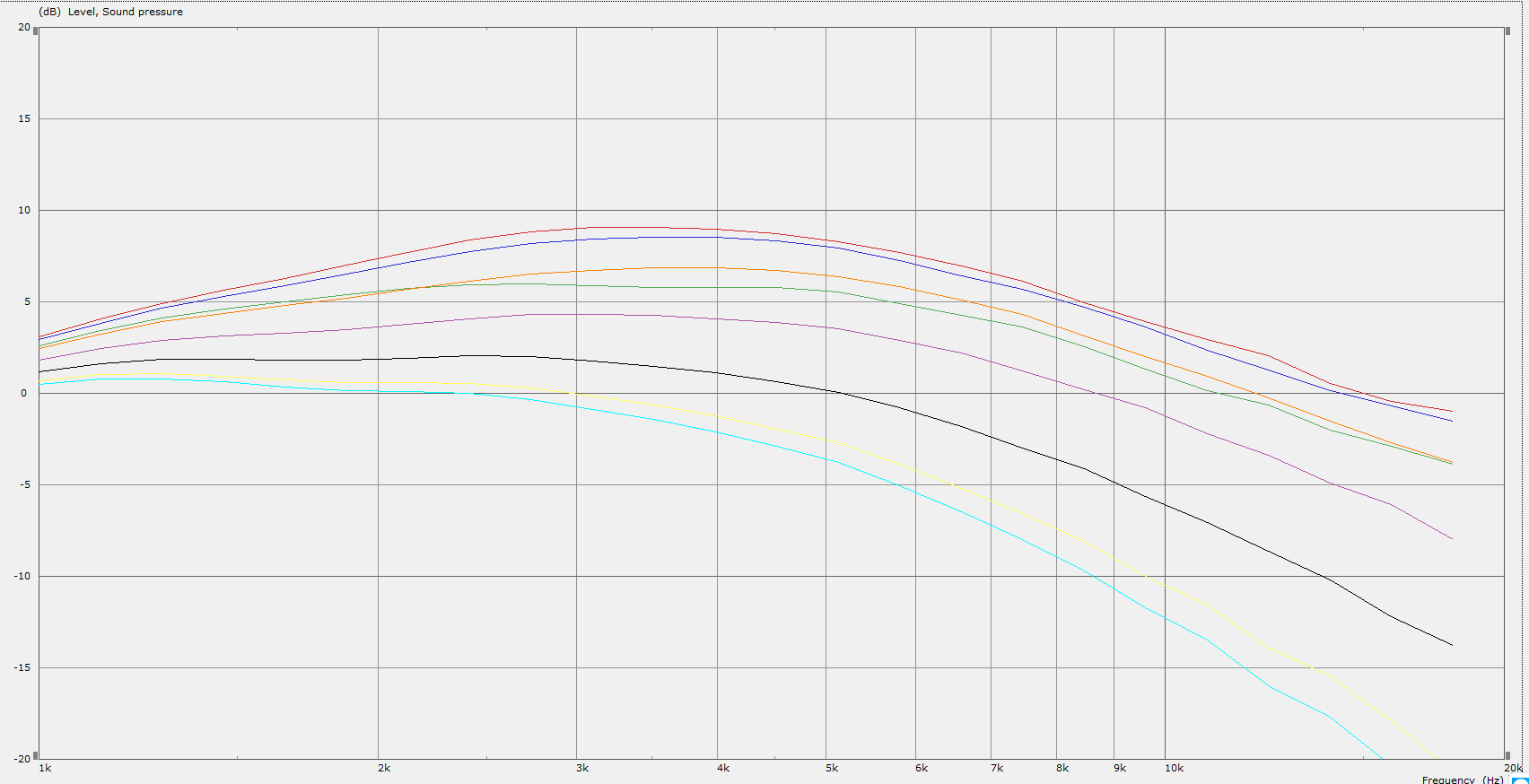

Did you check the range and sensitivity for both observation fields in your script?
Another question on your sim:
Did you simulate using an infinite baffle, or did you simulate with a back-enclosure?
From my point of view, your simulation is not fundamentally wrong, may be you can give some more details on your simulation...

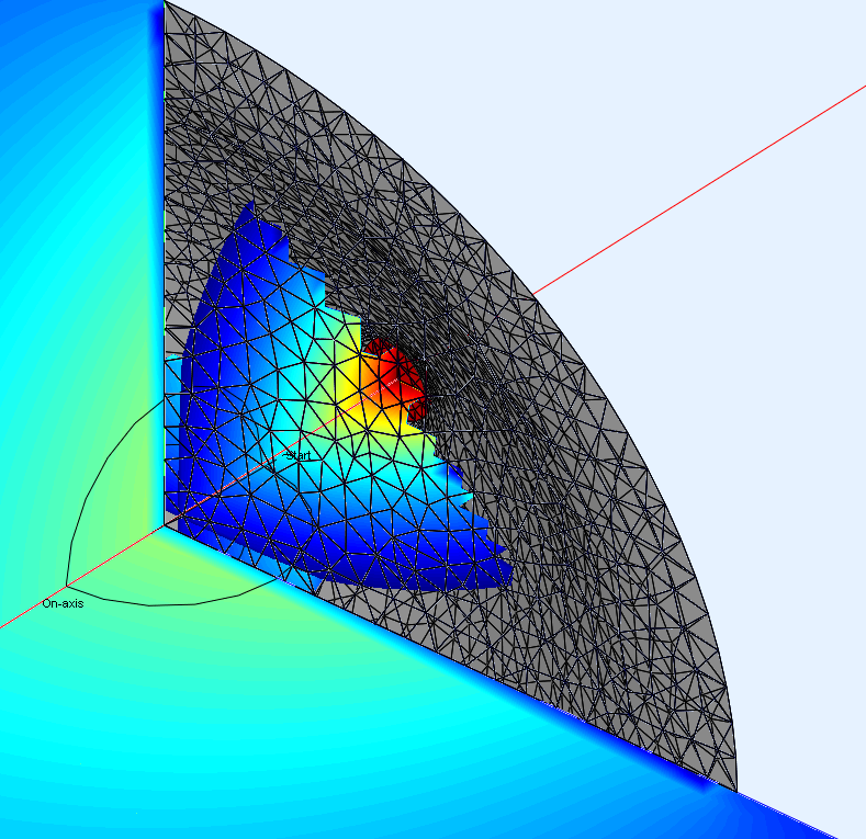

I am not an ABEC user but I am familiar with BEM. If I am reading your plot correctly, which I may not be doing, the jagged effect seems to be due to a vertex of your field mesh crossing your BEM mesh. The boundary integral being evaluated by ABEC won't have a value for such vertices and so something sensible is unlikely to be plotted without ABEC performing a lot of checking.
All the vertices in the field mesh must be outside the BEM mesh. Field vertices very close to the BEM mesh can also sometimes lead to wonky looking values and are best avoided as well.
Note this problem is independent of the computationally intensive matrix solution first stage which will not need to be repeated if ABEC stores the solution. Simply perform the second evaluation stage with a corrected field mesh.
Hi Frederik,
Hi Gaga, I was hoping you might show up 😀
You say:
1. stay away from the boundaries. How? Adjusting the angle of the observe fields? Isn't that like pretending it didn't happen? 😀
2. Refining the mesh size of the field: is this the mesh frequency? I currently use 20kHz
Yes, I will read everything once more to see if I'm overlooking something. DonVK has allreay been helping me out in a dfferent thread. I switched to this one, thinking this was the more appropriate place to post ABEC questions.
My reasoning so far was that mesh size and mesh frequency would be good enough to describe frequencies with at least twice the wavelength, but the errors seem to be there no mater what frequency I look at.
A good point. I might have skipped an important step I have used in many FEA softwares in the past, replicating a known structure and compare my results to others. I could try one of the waveguides you have posted and see if I get something that looks similar.

Code:

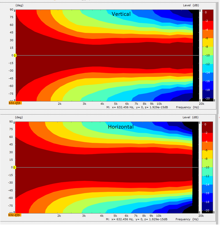

Bingo! They were different, and since my itnerface is at the origo, the rearwards field is what I see inside the WG. Thanks!
No infinite baffle. I tried simulating a enclosure just around the back of the membrane. There is no outside wall on the WG itself. Is that necessary?
Ok good, then I will try to simulate some other waveguide contours and see how that works out.
Thanks for the advice Andy. @Other ABEC users, is the field mesh controlled by the MeshFrequency parameter?
Anyway, it turns out that Gaga was right, there was probably not a fundamental error in my model after all; the polar plots I used were normalized and this gives that kind of shape for an OS profile of similar size when normalized to on axis. I also switched to an infinite baffle, which also seem to remove some of the funky looking results. It is also a more realistic condition, as I am trying to design an in-wall speaker.
Here is the same OS (aprox 10" size) contour again normalized:

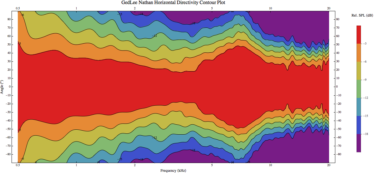

Here is a 10" OS WG measured and normalized to on axis:
Same trend in both, even though wall angle and throat diameter is a bit different. (mine is 60 degree and 0.75" throat)
Here is the countour not normalized:
So with some renewed faith in my model I started tweaking the design and it quickly got to this:
A good start I think. I am not sure I will try to model the CD. I might start off with just 3D printing the contour and see how much it deviates from the simulation after EQ on axis and take it from there.

Does anyone have code exampe for plotting several SPL curves like Gaga did here?
725110d1546031578-abec-experts-help-2018-12-28-abec-waveguide-vacs-spl-0-90deg-png
Really appreciate the input and previously published work in this thread.
Off-axis curves
Answering my own question in case it could be usefull to others:
In the Observe Spectra.txt I wrote the following:
Code:
  Nodes  "Spectrum"
    Scale=1mm
    5001      1600      0    0   // Point on-axis
    5002      1545      0    -415   // 15 deg off-axis
    5003      1385      0    -800   // 30 deg off-axis
    5004      1131      0    -1131   // 45 deg off-axis
    5005      800       0    -1385   // 60 deg off-axis
    5006      415       0    -1545   // 75 degoff-axis
    5007      0         0    -1600   // 90 deg off-axis
BE_Spectrum
    PlotType=Curves
    AnalysisType=Pressure
    RefNodes="Spectrum"
    GraphHeader="Sound pressure"
    BodeType=LeveldB;   Range=50
    101   5001 ID=5001
    102   5002 ID=5002
    103   5003 ID=5003
    104   5004 ID=5004
    105   5005 ID=5005
    106   5006 ID=5006
    107   5007 ID=5007
And got this in VACS:
Good to see you got it working.
MeshFrequency checks the edge length of all facets to see if they are at least 1/2 lambda. ABEC will remesh (subdivide facets) if there is a violation. It is also used to create the observation field meshes. It's a good way to check if your external generated meshes are fine enough. Set the MeshFreq to a low value, select mesh only in ABEC, then look at the #elements in the Solve tab. Change the MeshFreq to what you really need, then select mesh only in ABEC, and check the #elements in the Solve tab. If it changed alot (>10%) your mesh is not fine enough and you should remesh again in gmsh.
Hi everyone,
The jagged edge is from an observation facet intersecting another object and its not mesh aligned (as per @Andy19191, @Gaga). The facet cannot be resolved and its shown as a "whitespace". I just ignore them. However if you really want a clean edge, a) design your observation fields so they do not touch other objects or b) create the fields externally and mesh them so their facets are edge and vertex aligned to the waveguide/horn/cabinet. Increasing the MeshFreq will not prevent this.
A pic (field wires on) to show the field white space is a breached facet and the entire facet is whitespaced.
