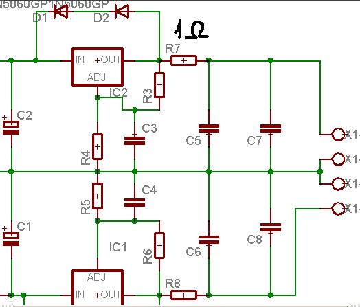

janneman said:
I hope you didn't put the resistor in series with the output (between output and load)?
Jan Didden
hmmm... yes I did, why not?
Well, you neatly isolated the low Zout of the reg from the load! Your reg (when implemented well) will have a Zout of a few milli-ohms. (An ideal voltage source would be zero of course). Now with the 1 ohms, the Zout will be 1 ohms in parallel with the impedance of that cap, but that varies with frequency. You more or less throw away the reg with this!
What you could do is leave the R, C in but take the load, as normally done, from the reg, on the left side of the 1 ohms!
Your R,C will still damp the reg, and you still have low Zout. Eat your cake and have it too.
Anyway, I think that 1 ohms and the cap is really not necessary anyway. Any old crappy electrolytic will do. The crappier the better 😉
