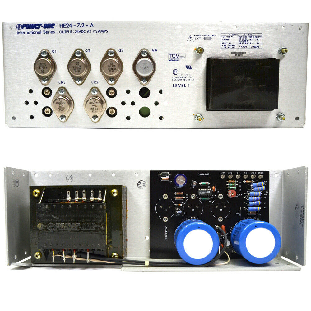

When I get to build this, I'm hoping to use one or two of three regulated linear PS that I bought used and have available. They are Power One or International Power 24V units that are either 4.8A or 7.2A. For those not familiar with them, they are industrial open frame supplies (often used in machine tools and the like) and if one is a bit patient, they can be had rather economically off of ebay. I bought each of the above for $35 delivered, and they were in very good used condition. An example is shown below.
I've used some lower-powered (0.8A and 3A) 15V and 24V versions of these units to power HD radio tuners and a TDA1387-based DAC, and have been very happy with the results. I am careful to power them off while not in use to avoid needless wasting of energy.

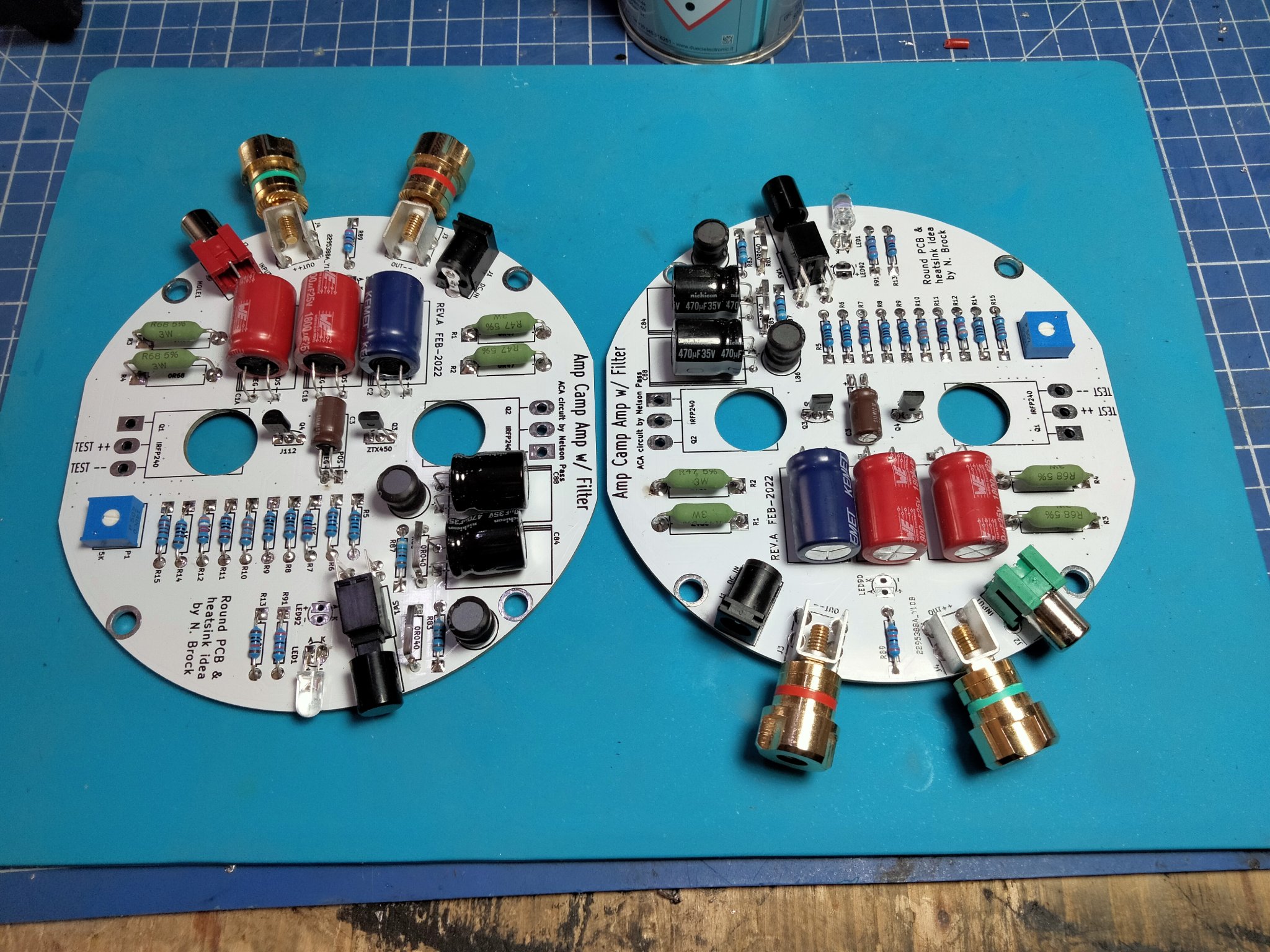

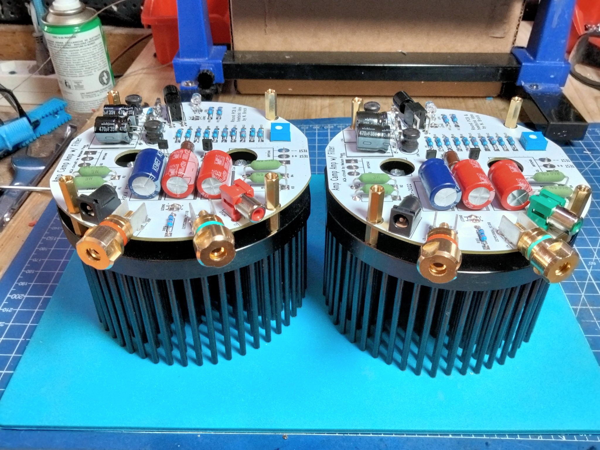

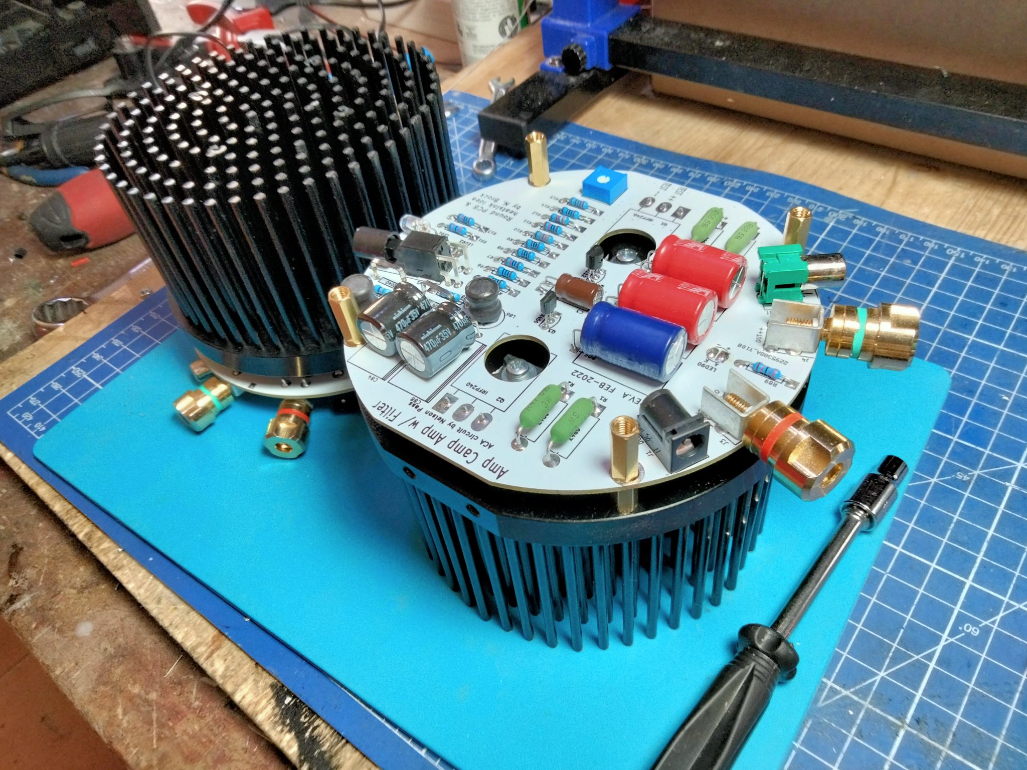

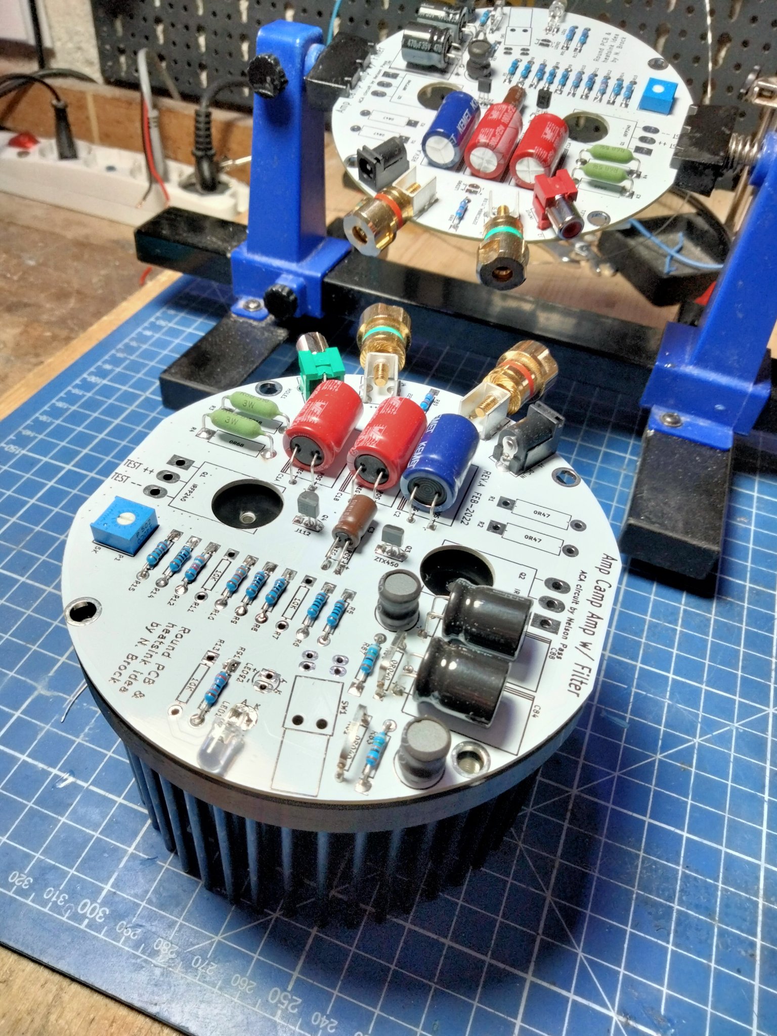

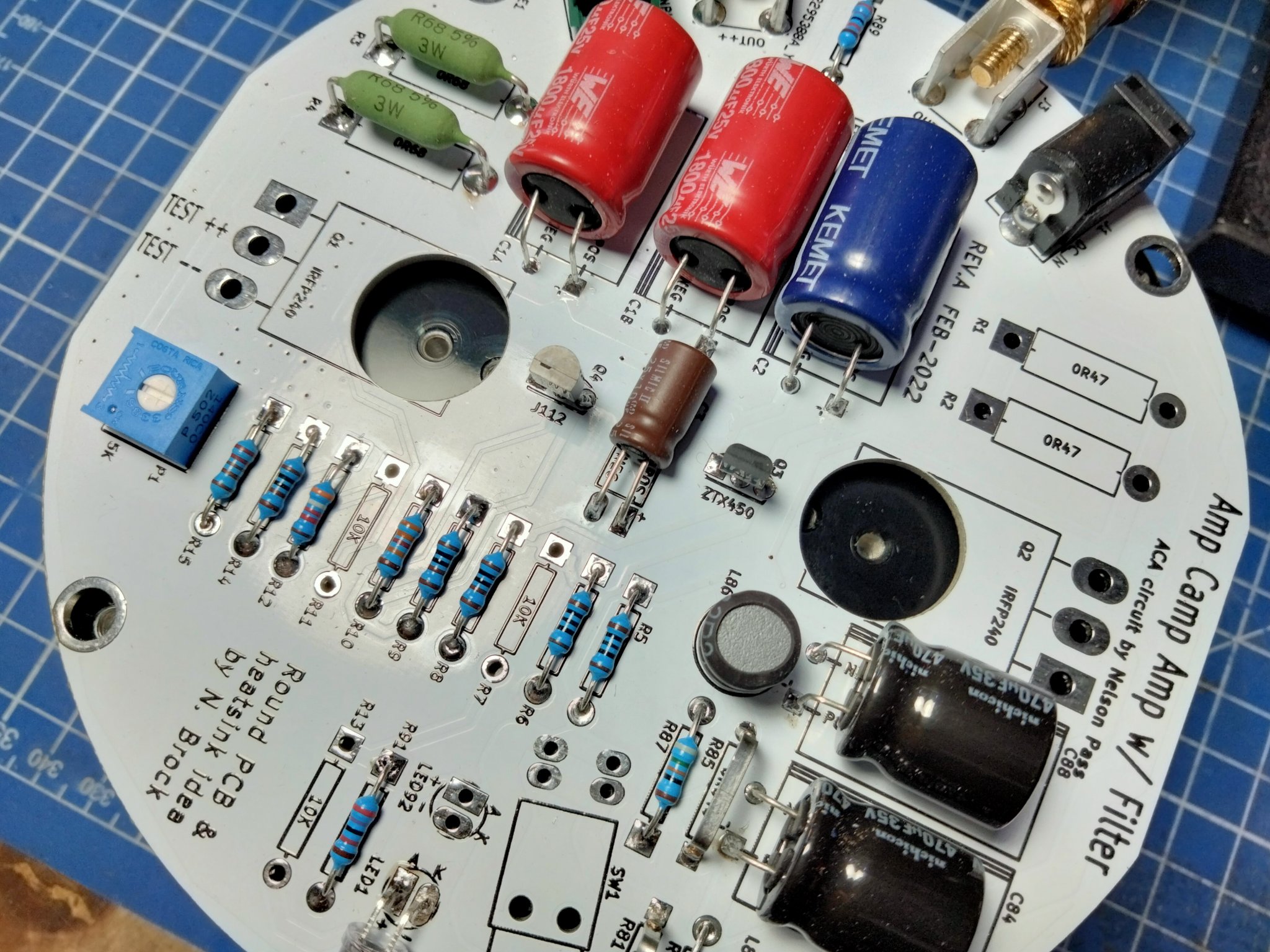

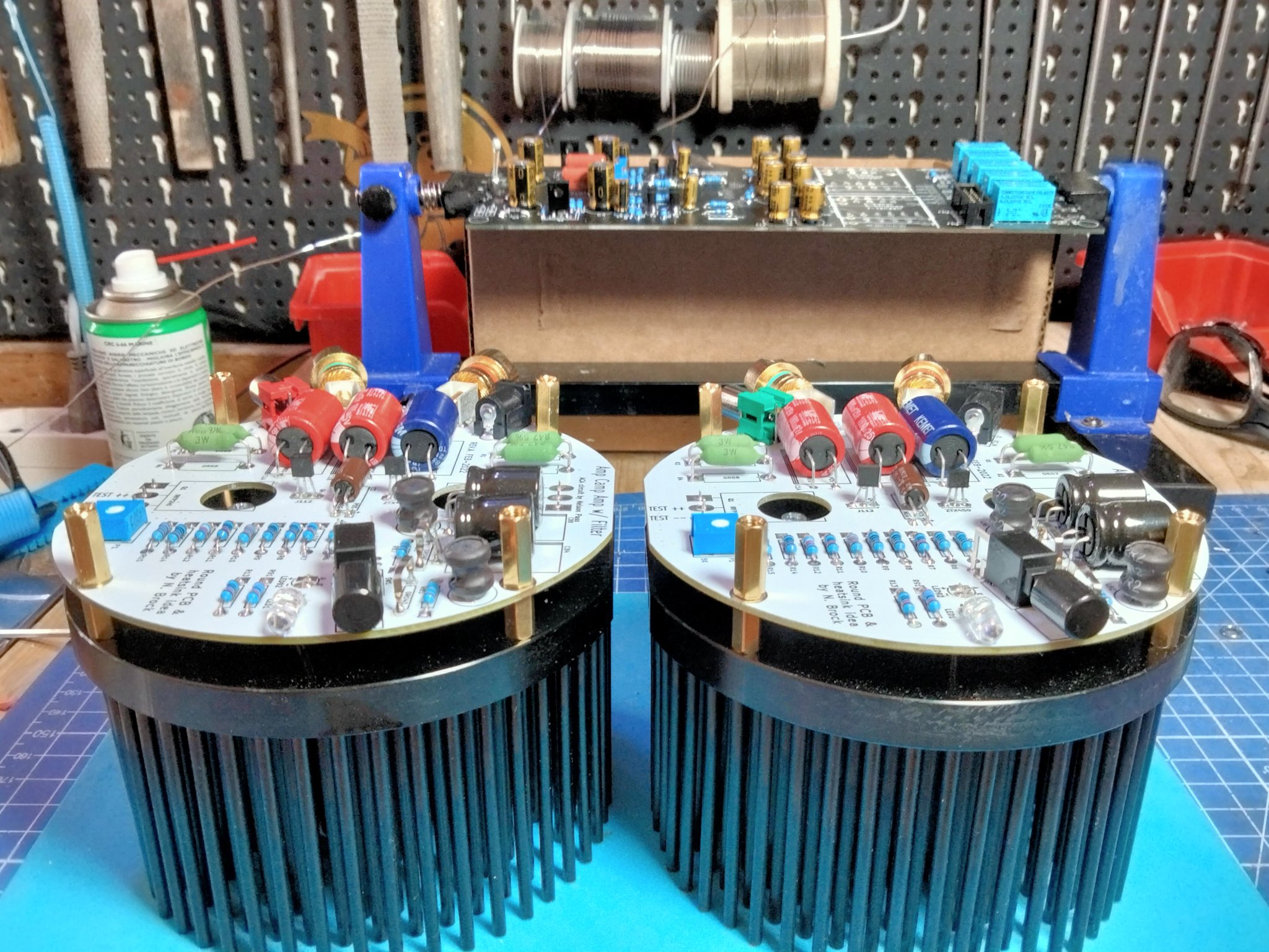

Progress with my build. I have 2 psu to try 25V 6A toroid into capmx. Or a MW 24v smps. One of the big fan cooled shiny ones. Will be interesting if I can hear a difference, or atleast if it is one worth bothering with.
Thanks to N.Brock for the concept and Mark for the boards.

These are indeed quiet supply but make sure to add the required external fuse.
Eric
Hi Eric,
Yes, of course. On these larger supplies, I plan to mount an IEC inlet with integrated switch and fuse to the frame. I won’t be making a cutout (the Al plate of the frame is 1/8” thick), but securely lashing the IEC module to the frame using sturdy zip ties through two of the appropriately placed holes that are already there. The IEC modules will also allow me to use up some of the many power cords I’ve accumulated from old computers.

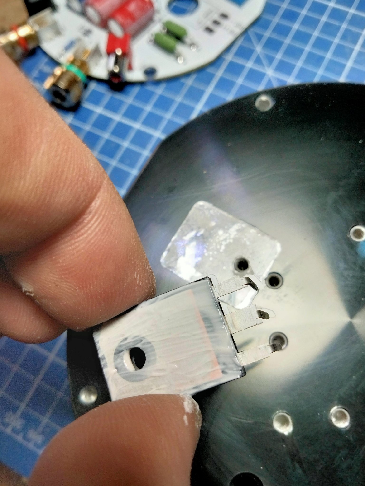

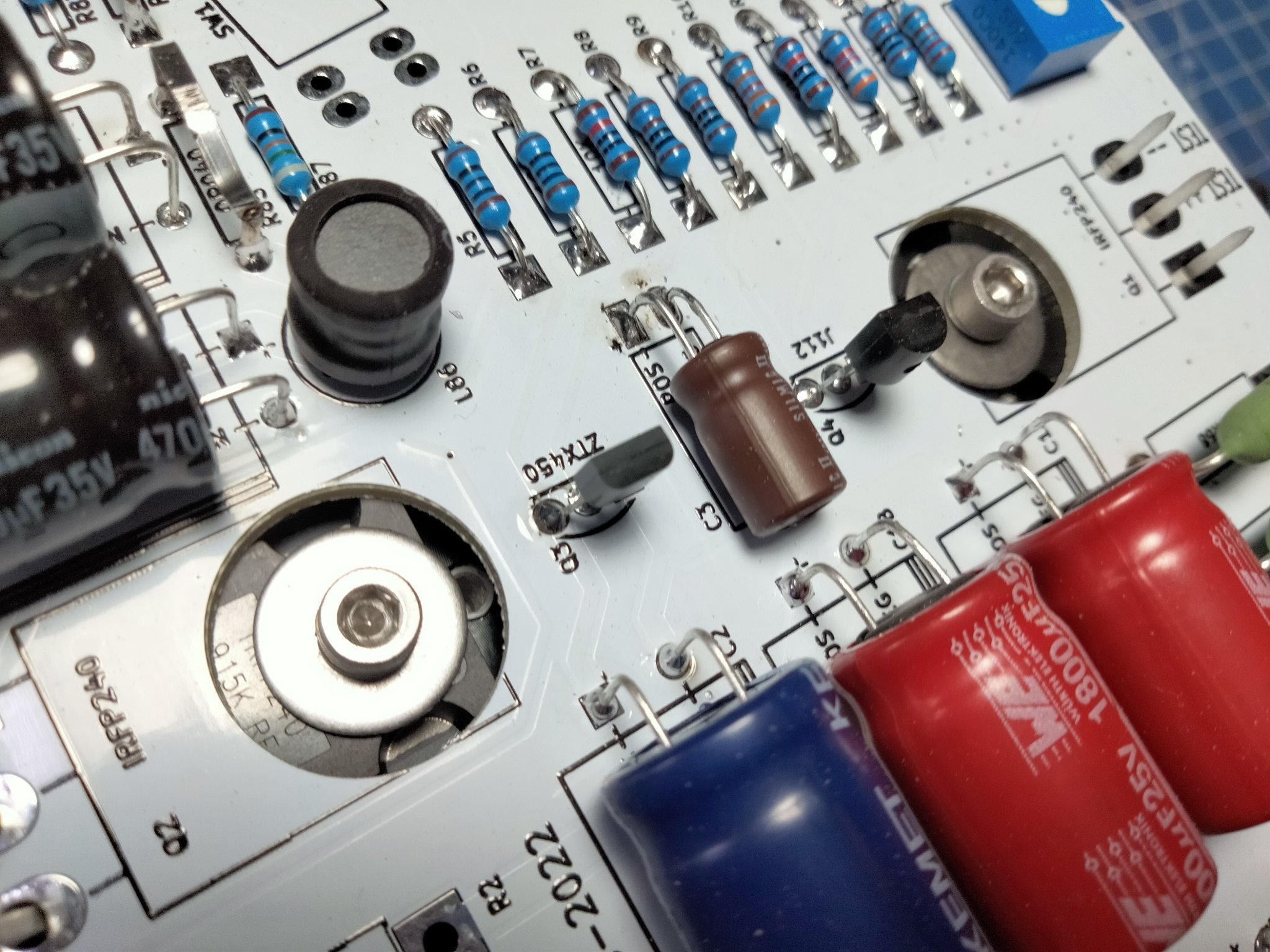

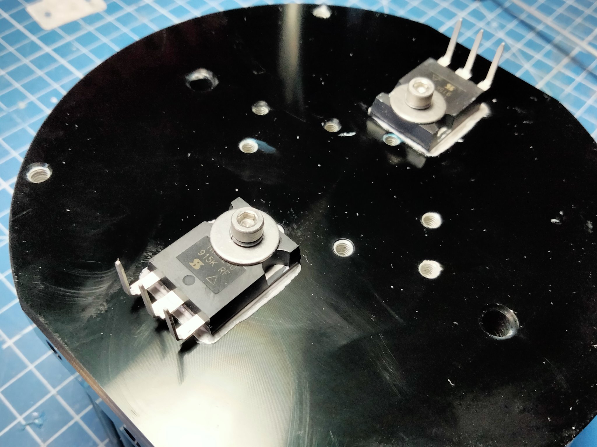

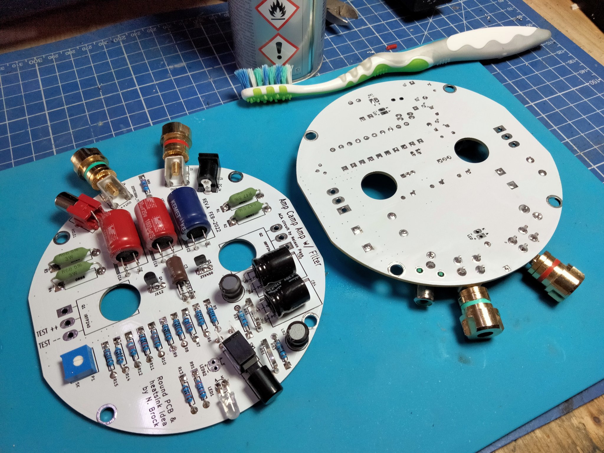

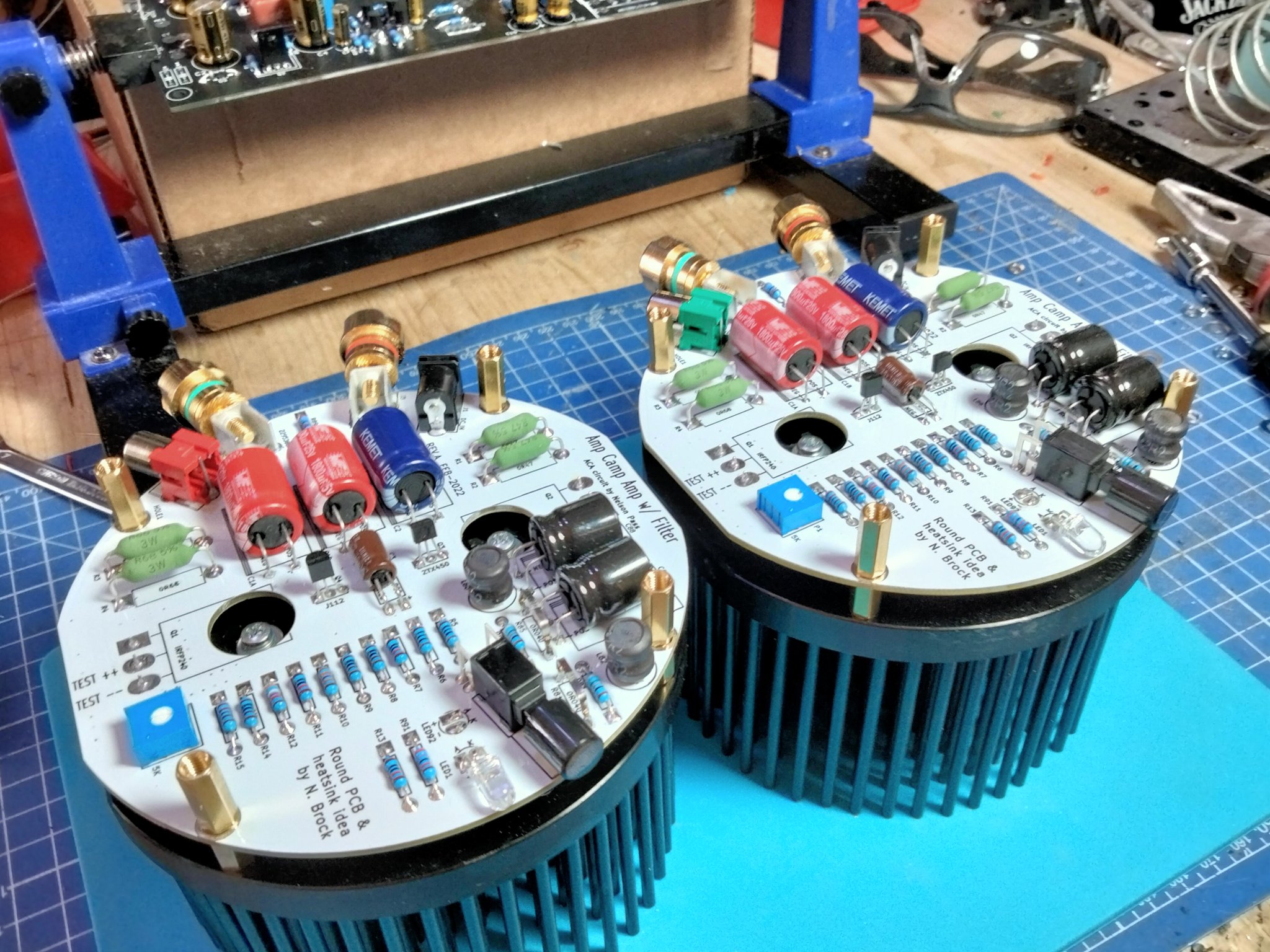

Good thing your MOSFET pressure-spreading "fender washers" are smaller than the PCB cutout holes. Now when you decide to remove the amp from the heatsink to install the up-facing "glow LEDs" and the power on/off switch, you have a pretty good chance of putting it all back together again. Especially if the fender washers are magnetic and you use a magnetic pickup tool to gently lower them through the cutout hole.
Awesome Mark! Thanks for getting this going so quickly. I've been a bit busy lately with moving to a new apartment and starting a new job which is why it's been quiet on my end the past month or so. Thanks for picking up my slack! I am still working on making kits, just a little slower than some would like (including myself!)

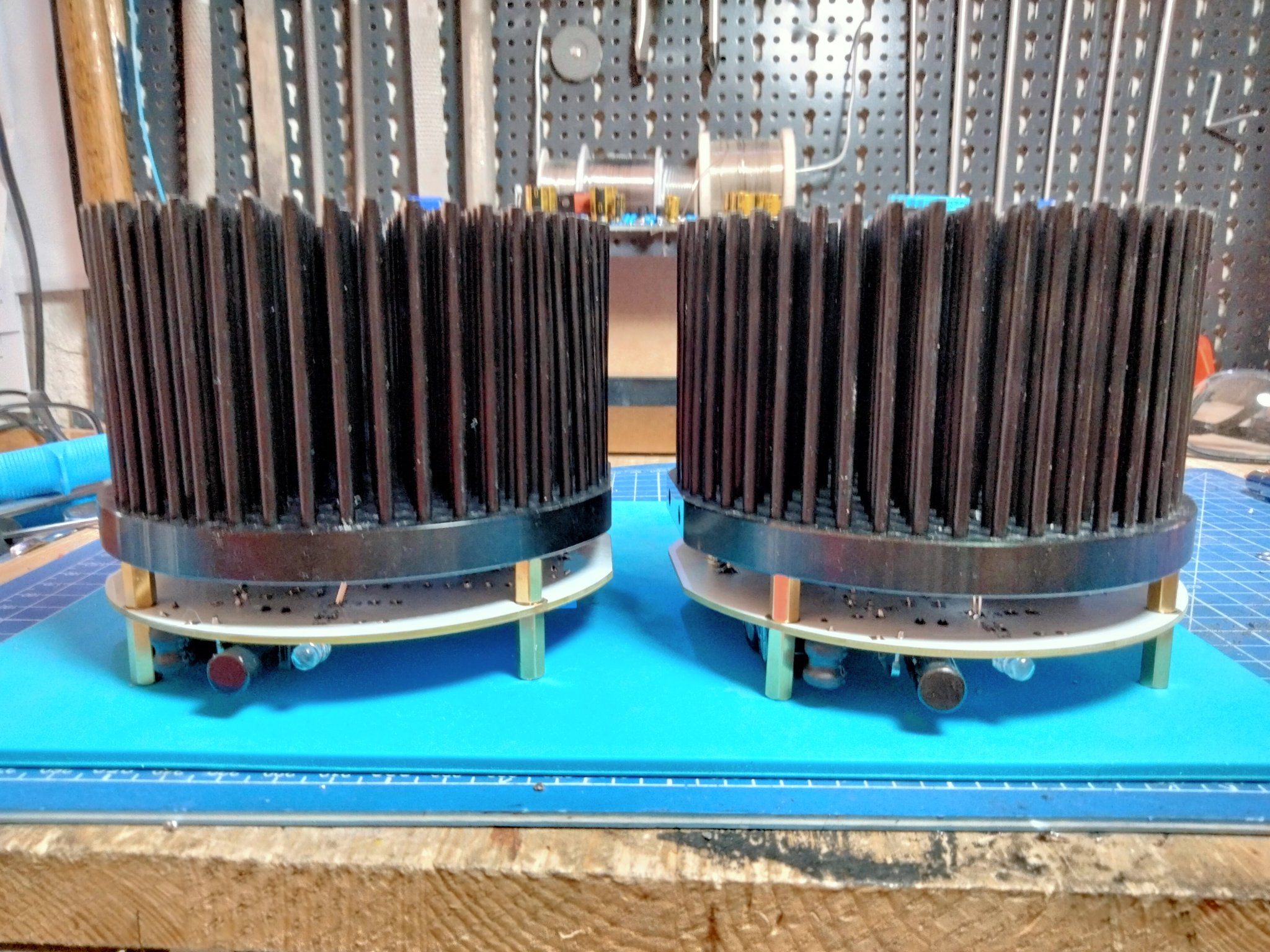

There's an strenage new world 🖖😁 of heatsinks for big LEDs...Hi N Brock,
Very nice work and amazing thinking to get us away from making a chassis or having to solder any wires. Bravo!
Some of them are very inspiring:
