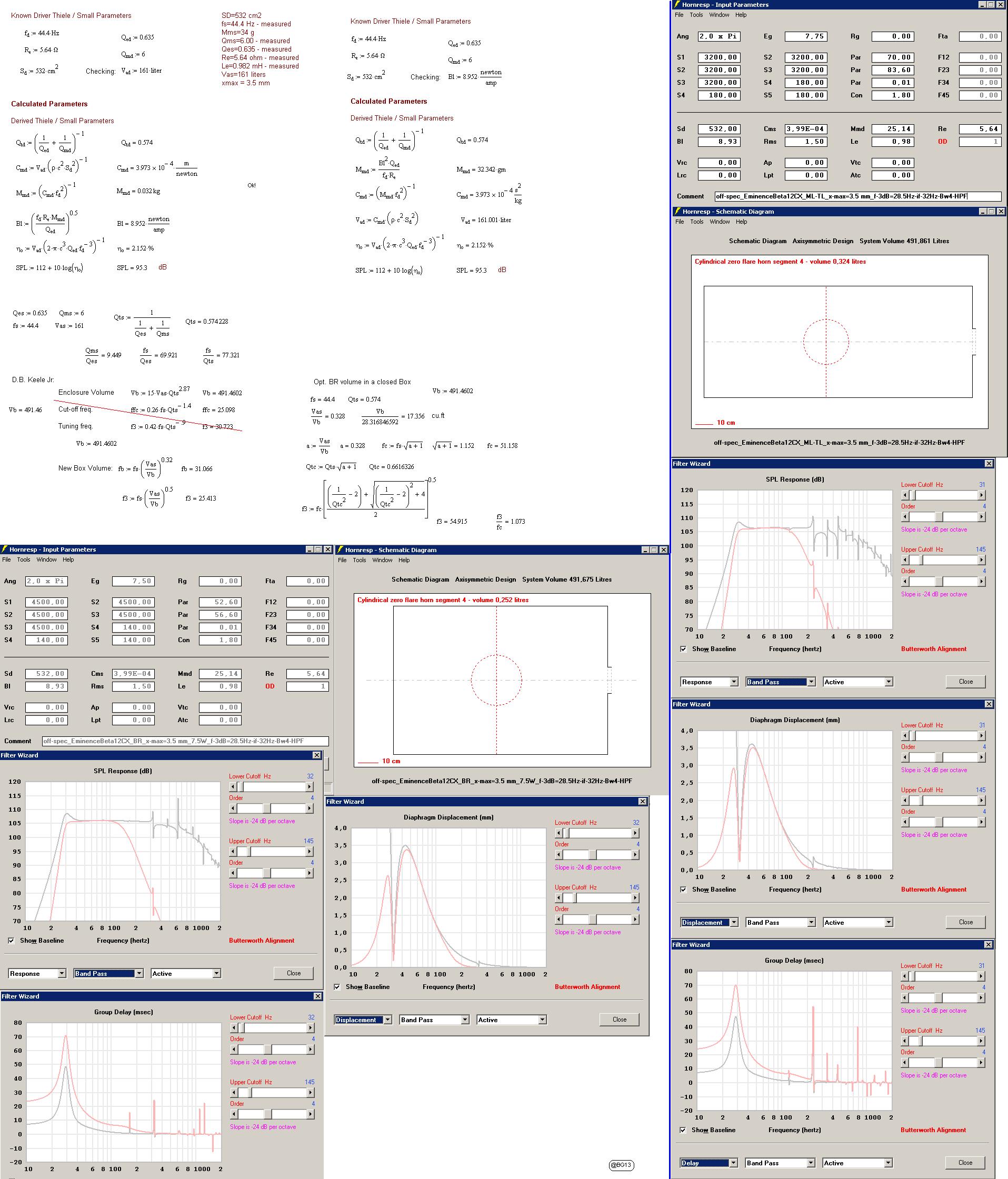

Bjorno,
Thanks for the simulation. If I am reading your Hornresp input page correctly, this says that you suggest a 700 square inch CSA (or 22.5 in wide x 31 in deep) x 43 in long TL with a 9.3 in dia hole in 18 mm (3/4 in) thick plywood as the vent? This makes for a shorter box but the CSA is kind of big and the location of the driver is only 21 in off the floor - not close enough to ear level. But the volume is the same as I have and it does show that you are getting a flat bass response down to 28 or 29 Hz. I am not sure how to interpret your second sim - the one shown in the Mathcad sheet.
X

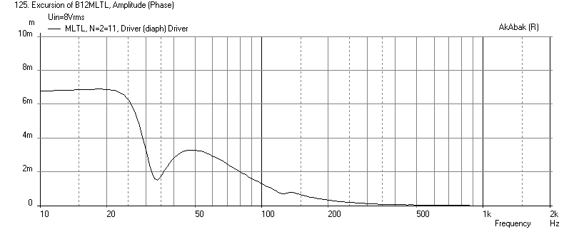

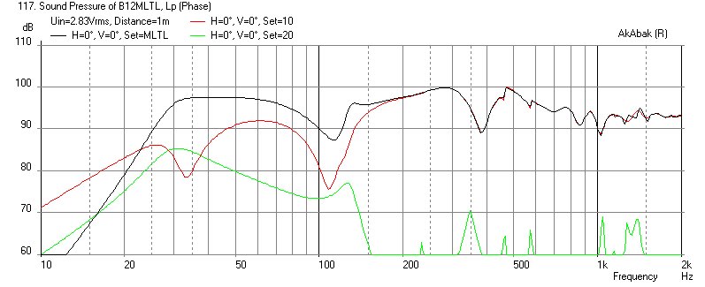

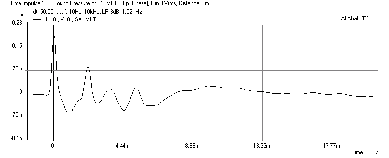

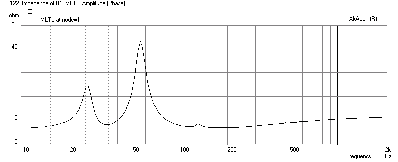

Btw, here is the freq response (again), impedance, cone excursion, and impulse response for my 60 in MLTL.
OK, WinISD calcs 0.574 Qts, 151.73 L Vas, 9.17854 BL. Adding a ½ ohm for speaker wiring and Qts = 0.62, making for a manly sized ~626.6 L/22.13 ft^3, 29.5 Hz Fb T/S max flat alignment. For sure, bigger than my speakers, fridge by ~2 ft^3 net.
GM
Thank you, GM. Confirms my suspicion of a need to use a refrigerator sized box. 🙂
But hey, the deep bass is really going to be good with a 95 to 97 dB efficiency.
One other question. With the Qts being higher, is this a good candidate for an open baffle? A CD horn in a 12 in coax in an open baffle is something I don't recall ever coming across before.

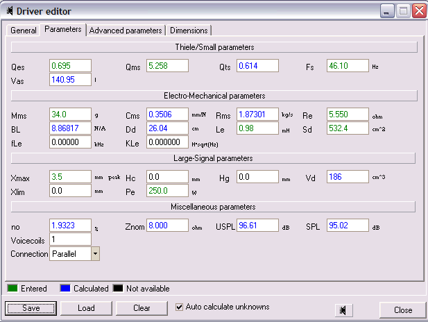

Sorry guys, I just realized I had a typo on the params I provided earlier. Also there are two drivers and they differ slightly so I averaged them out. How do you get WinISD to provide the BL and Vas based on the parameters I provided?
Here are the new averaged T/S params.
Thanks,
X
SD=532.4cm2
fs=46.1Hz
Mms=34g
Qms=5.258
Qes=0.695
Re=5.55ohm
Le=0.979mH

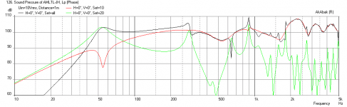

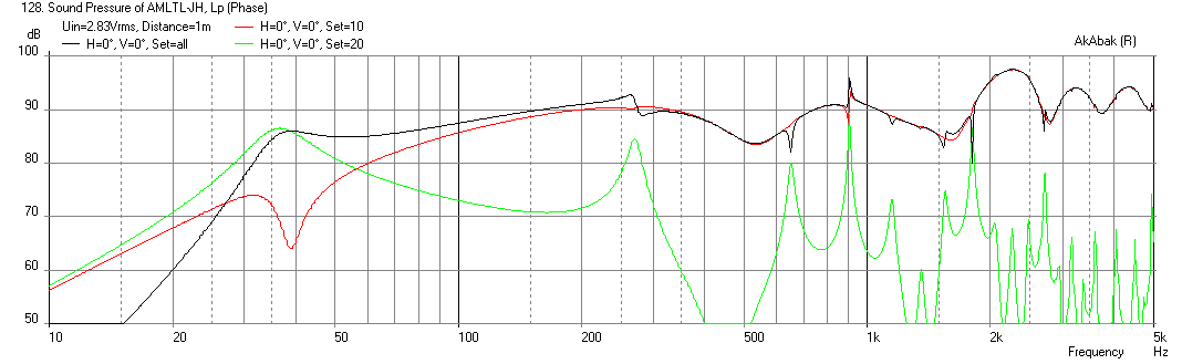

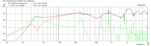

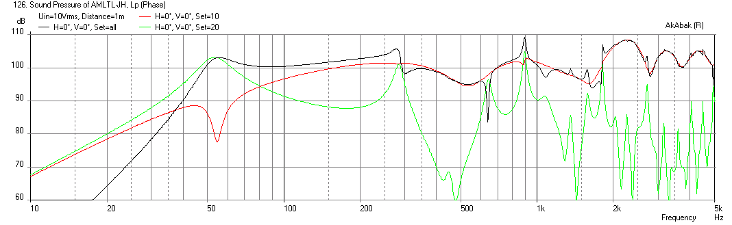

Jhutka,

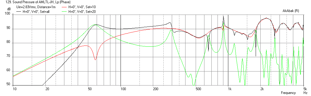

I ran a sim of your AMLTL design in Akabak and this may be a case where it does not seem to provide the correct vent dimensions. Your TL length is on the longer side and this may be pulling the tuning lower than usual. The 1 cm tall vent you have is too small and it will have an fb of around 39 Hz, which is way too deep for this driver and as a result the bass amplitude will be very low and not balanced. If you leave it rear firing, increase the vent height from 1 cm to 3 cm and that should balance it out. Or have it down-firing on legs. Alternatively, you can make a 11.65 cm long tunnel to feed it from the back to the front and in this case make the vent 3.5 cm high. This will give much better balance between bass and highs. The dips you see are from floor bounce cancellation and reflections, so final response will be placement dependent.
Here is the simulation of your design with the 1 cm tall vent with speaker placed near a back wall:
Here it is with a 3 cm tall vent:
Here it is with a 3.5 cm tall x 11.65 cm long vent and front firing:
423491d1402589369-accidental-mltl-technique-amltl-w4-1320sif-3.5cmx11.65cm-long-port.png

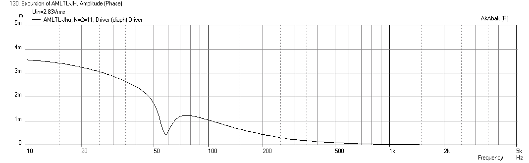

And here is the cone displacement, I think xmax happens at 7 volts so this is good for max SPL of 100 dB.
423492d1402589369-accidental-mltl-technique-amltl-w4-1320sif-3.5cmx11.65cm-long-port-displ.png
I think it can sound really nice and get decent bass extension. Just be careful with low frequency content below 40 Hz. If you place near a back wall you will not need any BSC even.
