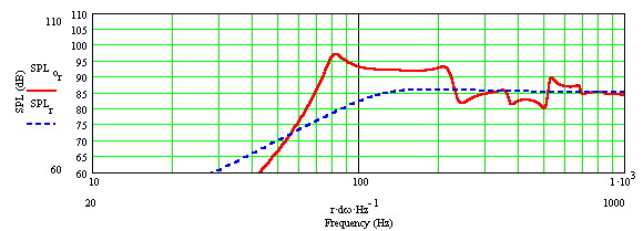

I tried running simulations in MJK’s MathCAD worksheets for the Vifa TC9FD and your dimensions for a Metronome. The results are not good. First chart below is what I got.

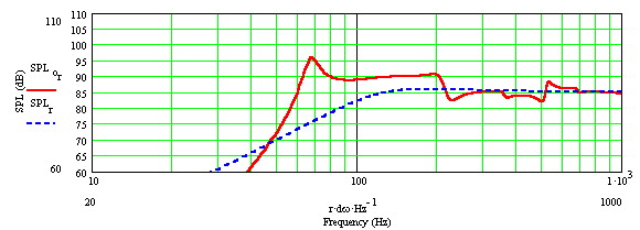

Then I tried cutting the port to 0.75”, which is the thickness of the plywood used in my Mets. The higher tuning freq is better, but still not good.

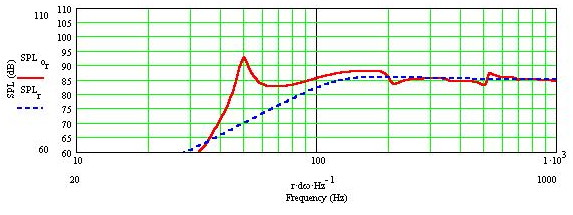

So I used a port 3” dia and 0.75” long. Again, better but not good.
Just occurred to me that the FC mini-FH3 could be converted to a Met by removing the bend. Which is how I modeled it, actually. Kinda weird looking, but it should sound OK. Probably sound a lot like what you already built, I suspect.

For the original case, there is a big overshoot at 50 Hz, but I think maybe more (denser) stuffing can calm that down somewhat - and can be tweaked via measurements and adding stuffing as needed. Alternatively, an overshoot can also be cured by tuning to a lower frequency by making port longer (like 4.5 in). This should reduce the peak and actually give deeper bass extension. The stuffing way may be the better way to go though as there is bass gain above the nominal 85 dB SPL, so if done correctly, can potentially provide built-in BSC. The rest of the response is rather smooth. Making the port bigger or shorter seems to make the rest have more suck-out from 200 to 500 Hz.
