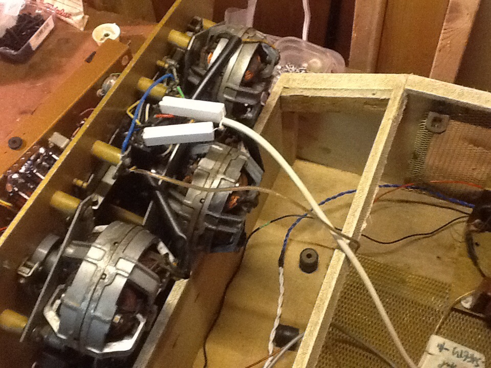

I have a Brenell MK5 tape deck that has 240V/50hz synchronous motors on it. I'm running it stateside here and am wondering if there is a way to adjust the motor speed outside of DC-AC inversion or someting along those lines?
Surely this must have been done at one point or another to play tapes recorded "across the pond?" The motors are 3W 1275RPM. Any help is appreciated.

The power supply has taps for 240, 210 and 110v. I have it set to 210V right now, giving me 6.3V-on the dot- for filament voltage. I think that the deck power supply was standardised and either 50Hz or 60Hz motors were provided dependent on the market. I definately have the 240V/50Hz model for the motors. The two series wirewound resistors are for keeping heat down on high speed setting.
The markings etched on the take up (right) and capstan motor:
3W RPM 1275 CCPE 0 40320
And the rewind (left):
5W RPM 1275 CPE D 40886
