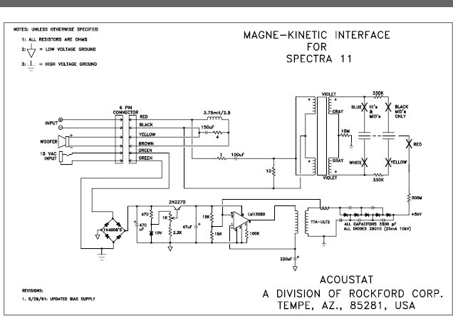

Spectra 11 maintenance.

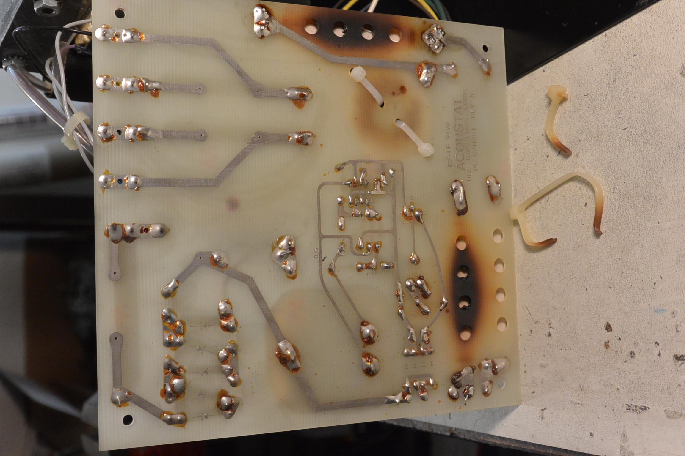

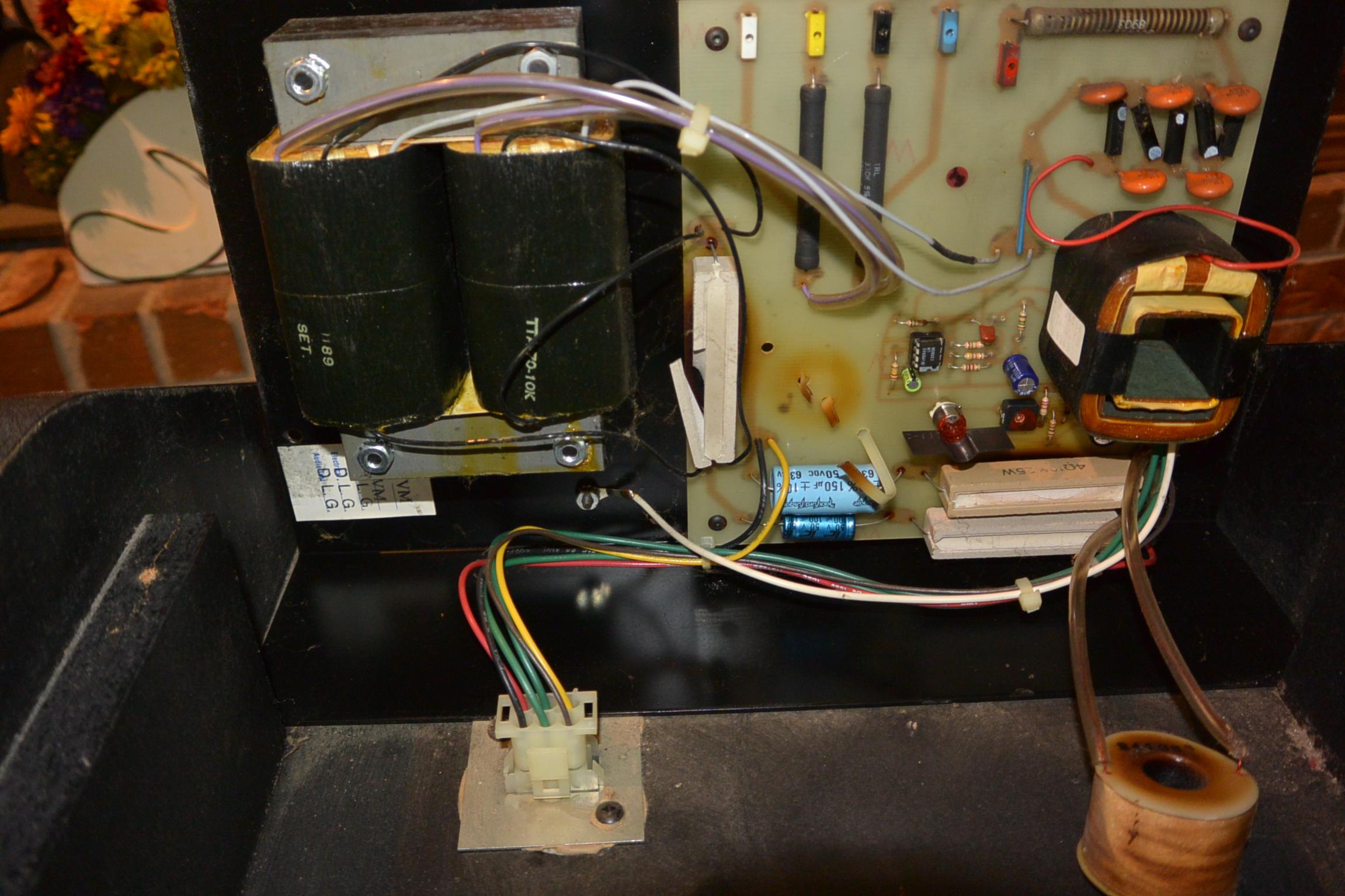

I have removed the panel and interface from my spectra 11. The board has been cooked!. Is this from cranking them too much, or using the wrong type amplifier, or? The speakers still seem to be working OK.
1. As found. The 10ohm 20W has cracked open. It measured 11.9 ohms.
2. The backside of the board.

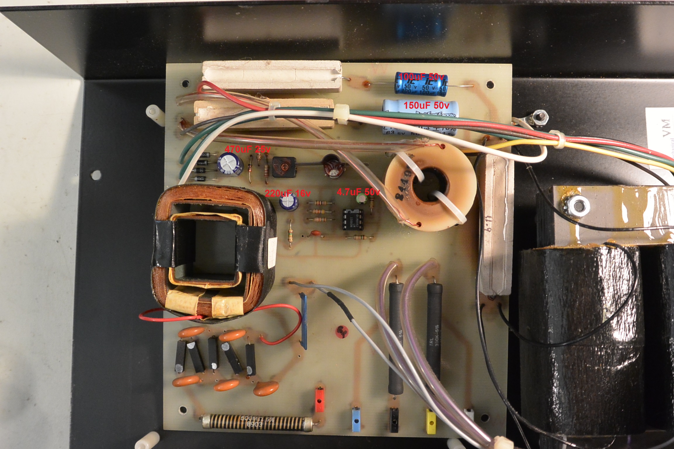

3. I re-mounted the inductor and glued the piece of broken ceramic with heatsink epoxy. The electrolytic caps are labeled for those that want to replace them.
Are there any recommended upgrades? I was thinking of bypassing the 2 crossover caps with some small (5uF ?) film caps.
