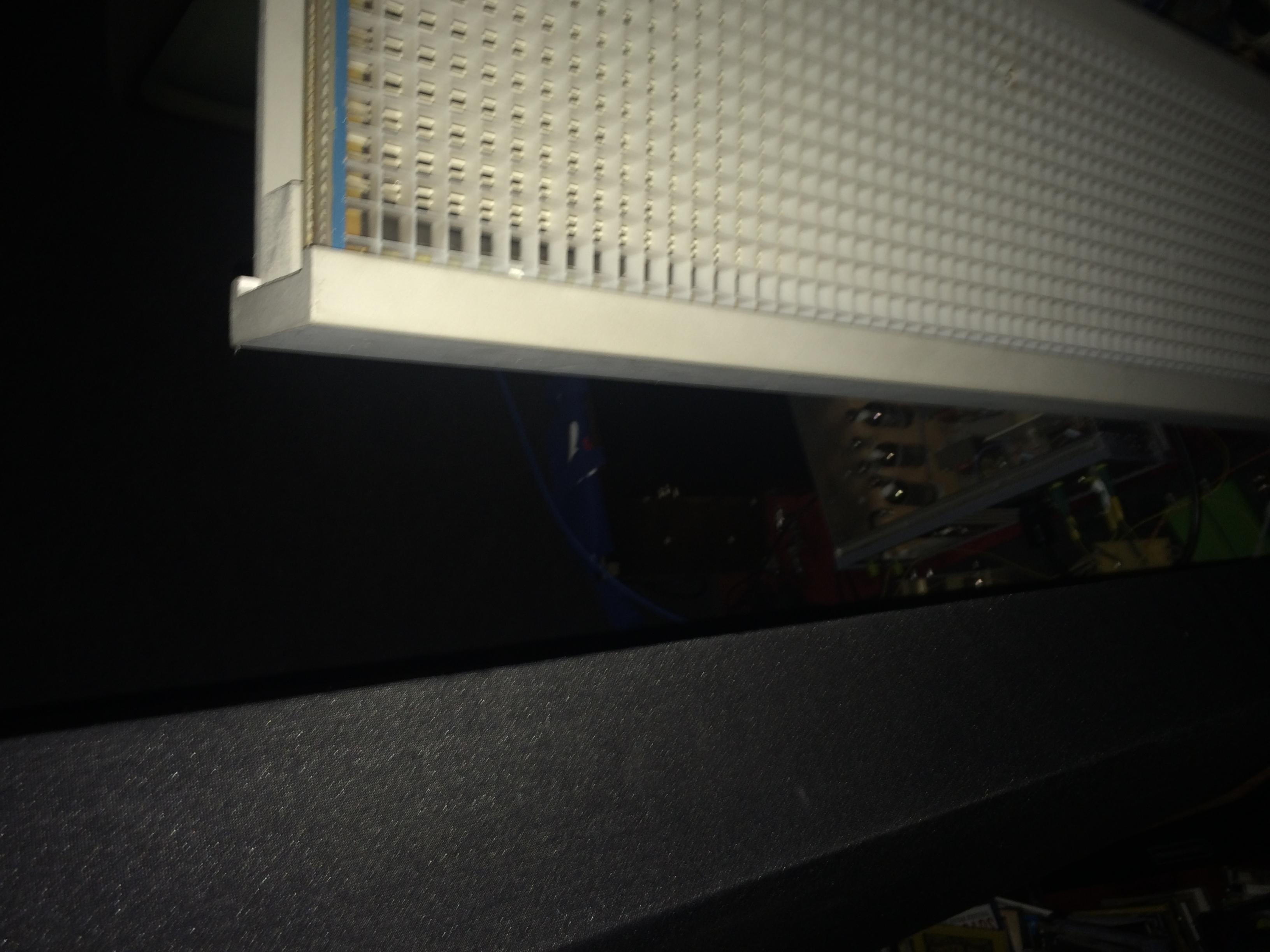

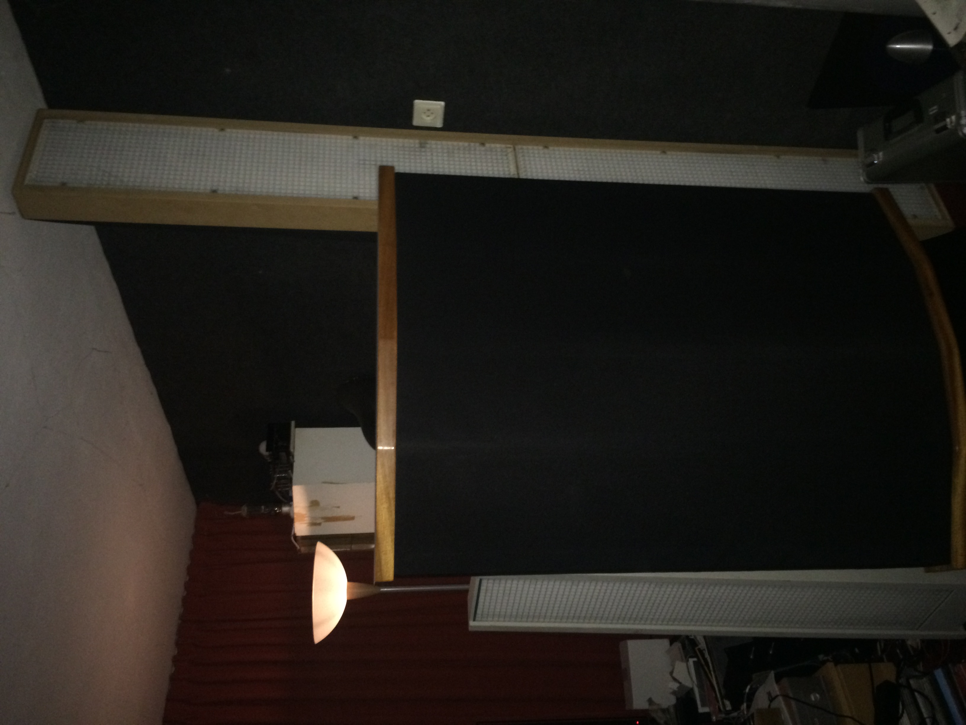

Some pictures:
Some pictures:
Ah understood.
Do you run all panels full range?
Quite an array there with Model 4's, 1+1's and that tricky little 7th panel.
I am looking to run split pairs from model 4's, a front facing pair, positioned like your model 4's, running full range and the second pair, bass only, positioned like you have your single inner edge panel.
Cheers
Grant

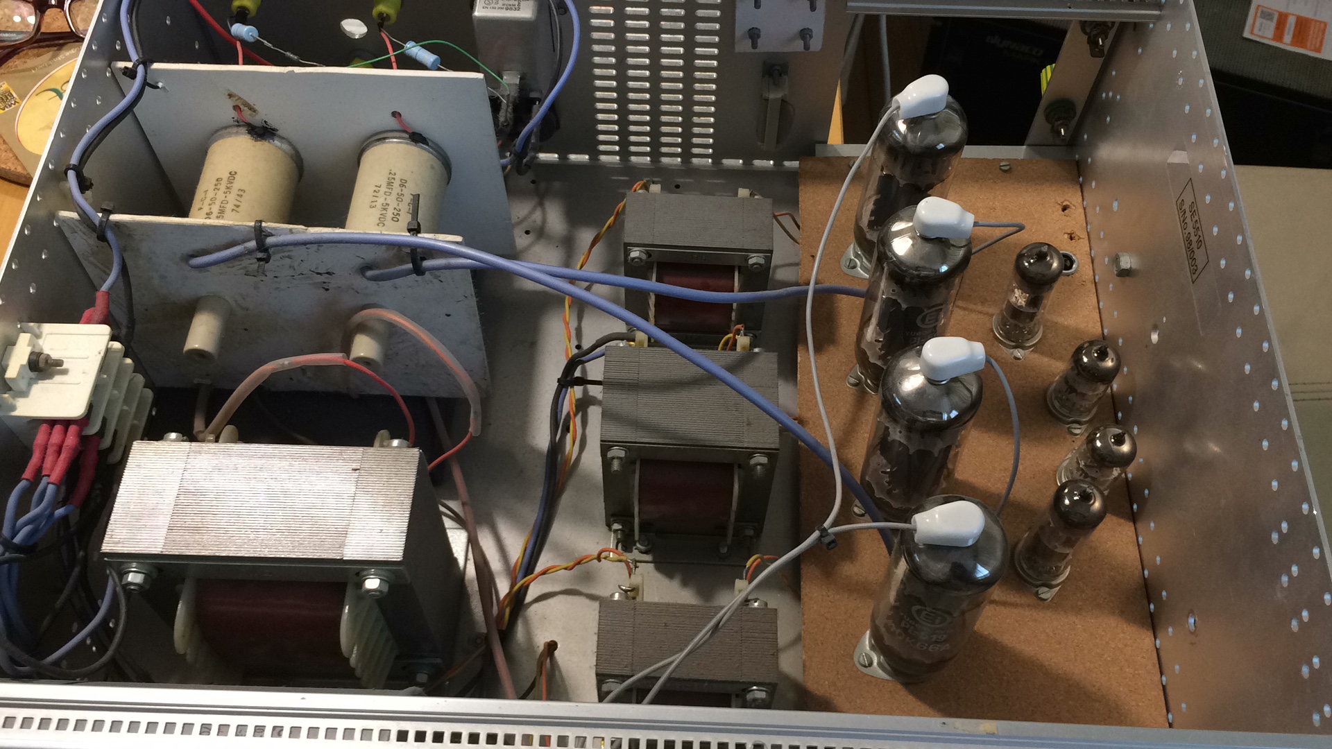

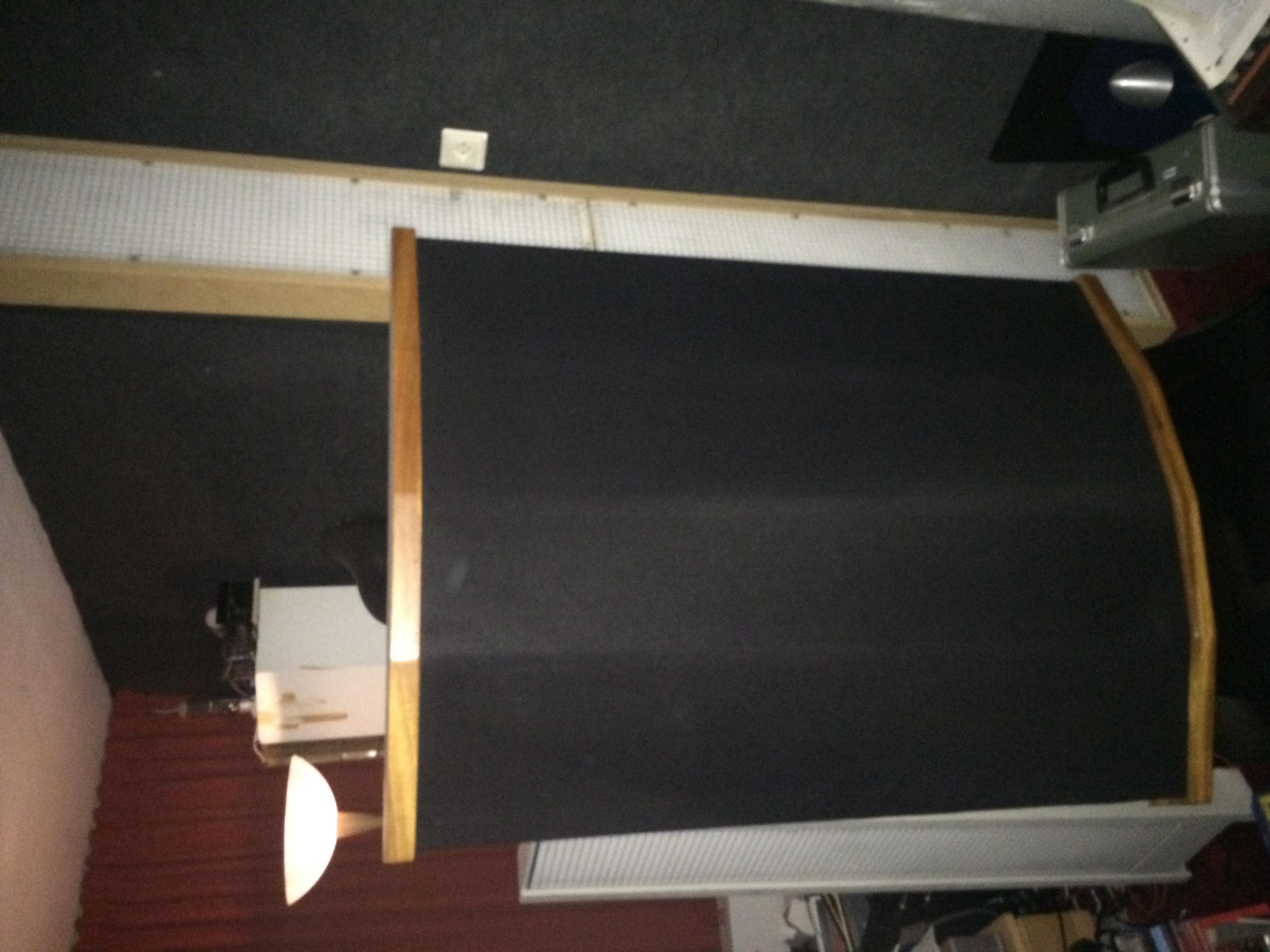

Yes, full range all panels. The OTL has no problems driving all and could even handle more. I have build it 15 years ago and use it on a daily basis. As the panels are balanced by nature my entire system is balanced from the D/A converter on. No phase inverters used (4 mono channels). For me it gives the cleanest sound and life experience so far.
Thanks for the replies. Wow, WAF off the charts (in a bad way.) Interesting ideas. If I understand correctly Lampie519, "not stacking all but 2" means the equivalent of a Model 2 adjacent to a 1+1? And if you close off the space, it would be like a Model 6?
I actually have Model 3s and Model 4s, so I could do what you have, but the 3s are non-Medallion and the 4s are Medallion, so there might be a little mismatch. I don't think I'd get it past the interior decorator department though. Is that 1"X3" wood used as a frame?

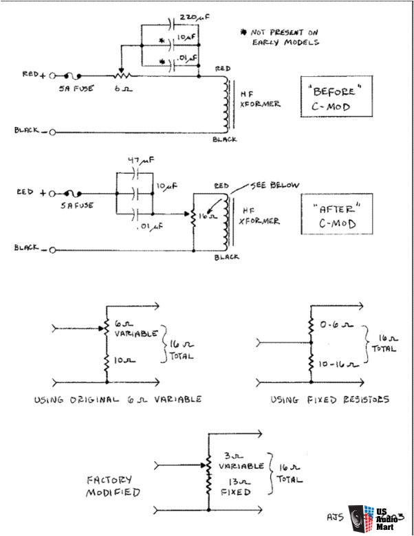

The Medallion transformer upgrade was available in the mid-1980s and replaced both the LF and HF transformers with transformers with better inter-leaved windings with superior sonics. It was around a US$600 upgrade that was factory installed by shipping your interfaces to the factory. A blue sticker was put on the interface to indicate the upgrade. A little later, the C-mod was incorporated which changed the "crossover" and impedance matching of the HF transformer which lowered the distortion by allowing less LF signal into the HF path. This was combined with the Medallion transformer upgrade and a red sticker was applied to the interface. There's lots more information on this thread if you search.
