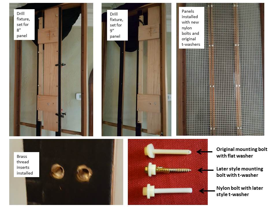

But this is About the Mid peak panel Fix... at least most of it....had to try find away to get this speaker working ... so I could use them...
Look at the pic of the 3 screws...See the plastic insert type peace…. on the one in the middle ....you well need 8 per speaker....pull the cloths down so you can get to the panels....pull the 8 screws out.....put the 8 inserts in the back holes... be sure they stay as you screw the panels back on...
Yes you could put any thing between the panels an the frame to change the sound of the peak...but most things I tried changed the panels sound to much....but this keeps the panels sounding the same ….just with much less mid peak....have fun with Acoustat

To be 100% clear, do you make 2 changes?...insert one in each panels back holes..
This well put a 1/16" gap between the frame an the panels when screwed back on the frame.
- Replace metal wood screws with brass inserts and nylon bolts?
- Put an extra t-washer between panel and frame?
The screws are perpendicular to and over an inch from the conductive coating on the mylar. I can't see them affecting the operation of the diaphragm at the frequencies involved, but OCICBW. Isolating the panels with spacers, however, is almost sure to change the sound in some way due to the change in how it imparts energy to the frame. It would be interesting to try very light springs or similar suspension methods.
The screws are perpendicular to and over an inch from the conductive coating on the mylar. I can't see them affecting the operation of the diaphragm at the frequencies involved, but OCICBW. Isolating the panels with spacers, however, is almost sure to change the sound in some way due to the change in how it imts energy to the frame. It would be interesting to try very light springs or similar suspension methods.
I well guess at why this works!...The t-washer is made of the same type of plastic. An works means sound like only the peak is lowered...Not the sound has changed.....your springs would work but...would add some ringing to the sound....I would like to get the best sound an make it a ezy fix...
All so I have done frame work with ML top of the panels ...an found the same with the spectra 11...the top frame peace can also make a peak...I have added cloth ….but it was to much...I have lowered the panels about 1/2"
from the top...In the end it the peak that has to go...for me it was a fiscal hearing pain....I could not play the speakers..
