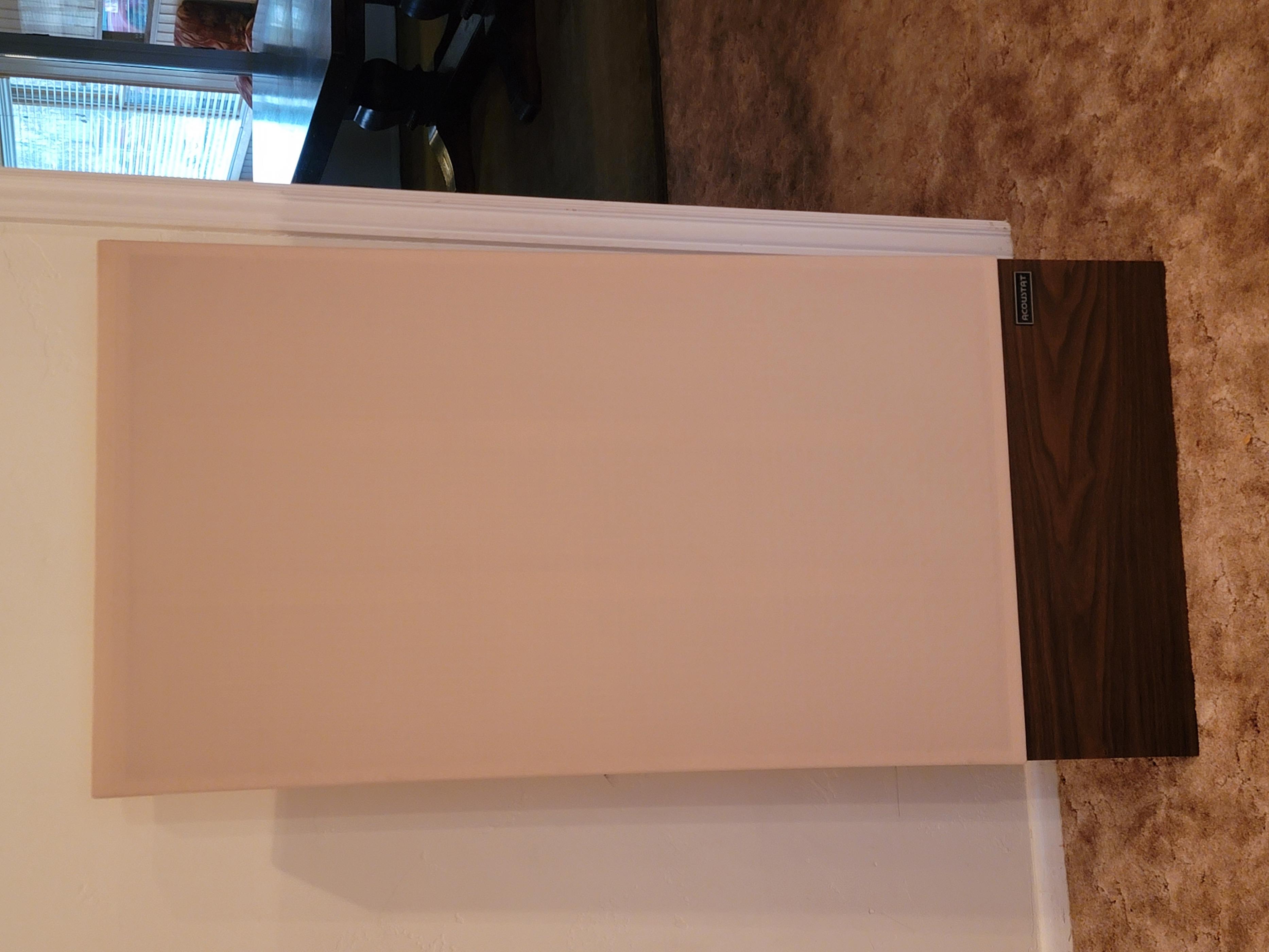

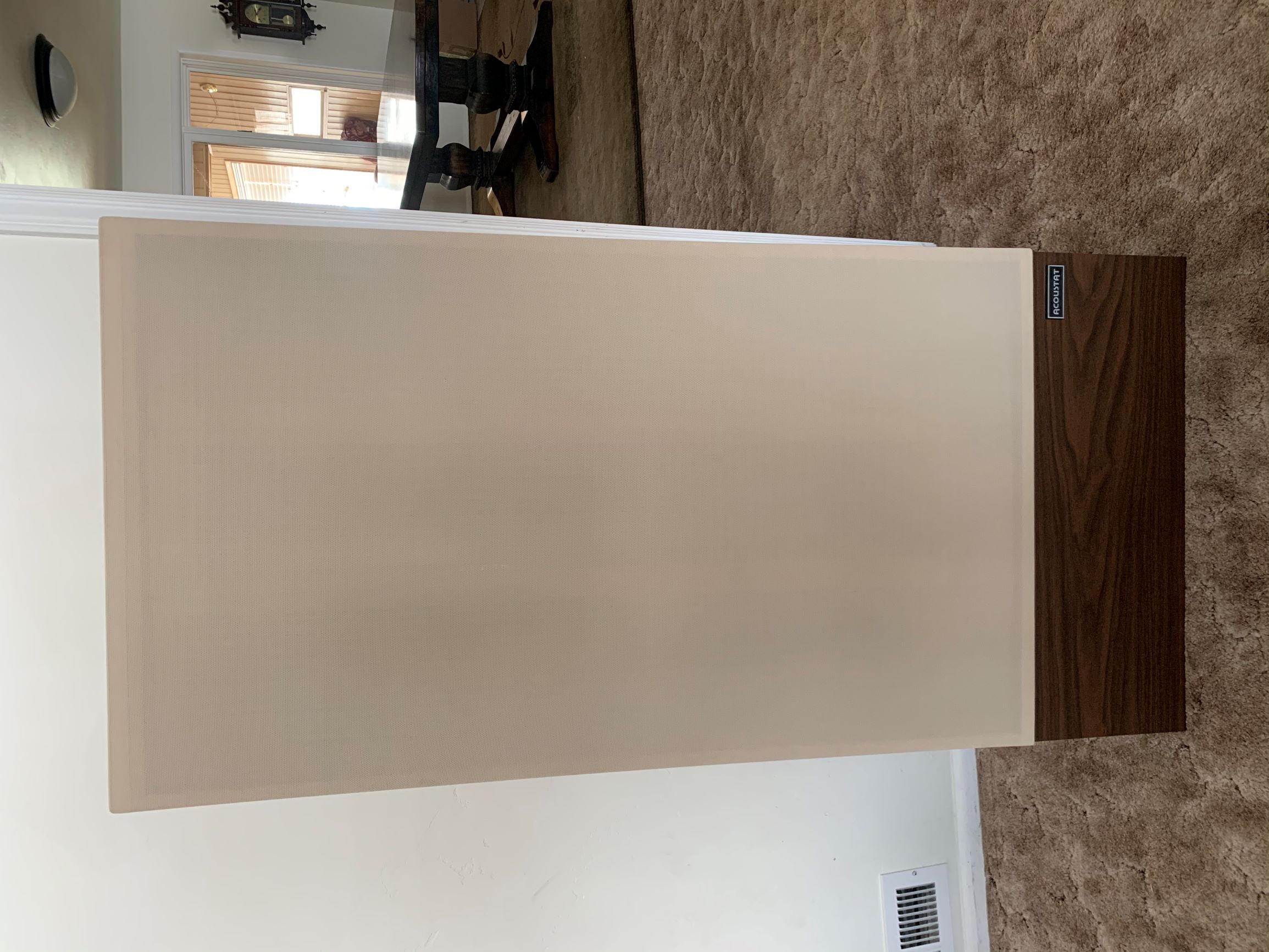

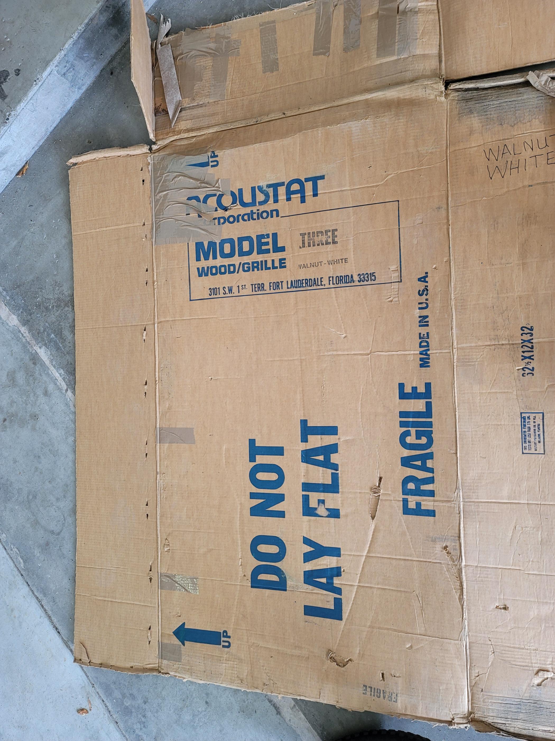

Howdy,
I have some Acoustat Model 3's in walnut and "white" but the cloth looks more off white than white. I as hoping someone knows where I can buy some "off White" color grill cloth so I can redo the socks on my Spectra 22's to match the 3's.
I Will include a few pics of the 3's and a pic of of the original cardboard box that the 3's came in. I hope that the color can be matched. The wall behind the speaker is a white wall. So you can see that the 3's are for sure not a bright white.
Thank you in advance for any and all help!
Jesse

This looks close, but may be slightly darker. Sample is only $1 though.
Beige Speaker Grill Cloth Fabric
Guilford Of Maine has a vast selection of acoustically transparent fabric. The original OEM fabric is long gone.
FR701(R) - Guilford of Maine
Legendary acoustic fabrics with a bang | Guilford of Maine
One person said they think this may be the OEM fabric:Guilford Of Maine has a vast selection of acoustically transparent fabric. The original OEM fabric is long gone.
DMD Acoustic Fabric - Acoustimac
The color that appears to match the light-colored OEM fabric is called "Stone".
One or two people in this topic, though, have said spandex is better because it blocks less of the sound than the OEM fabric does (when it's stretched enough).

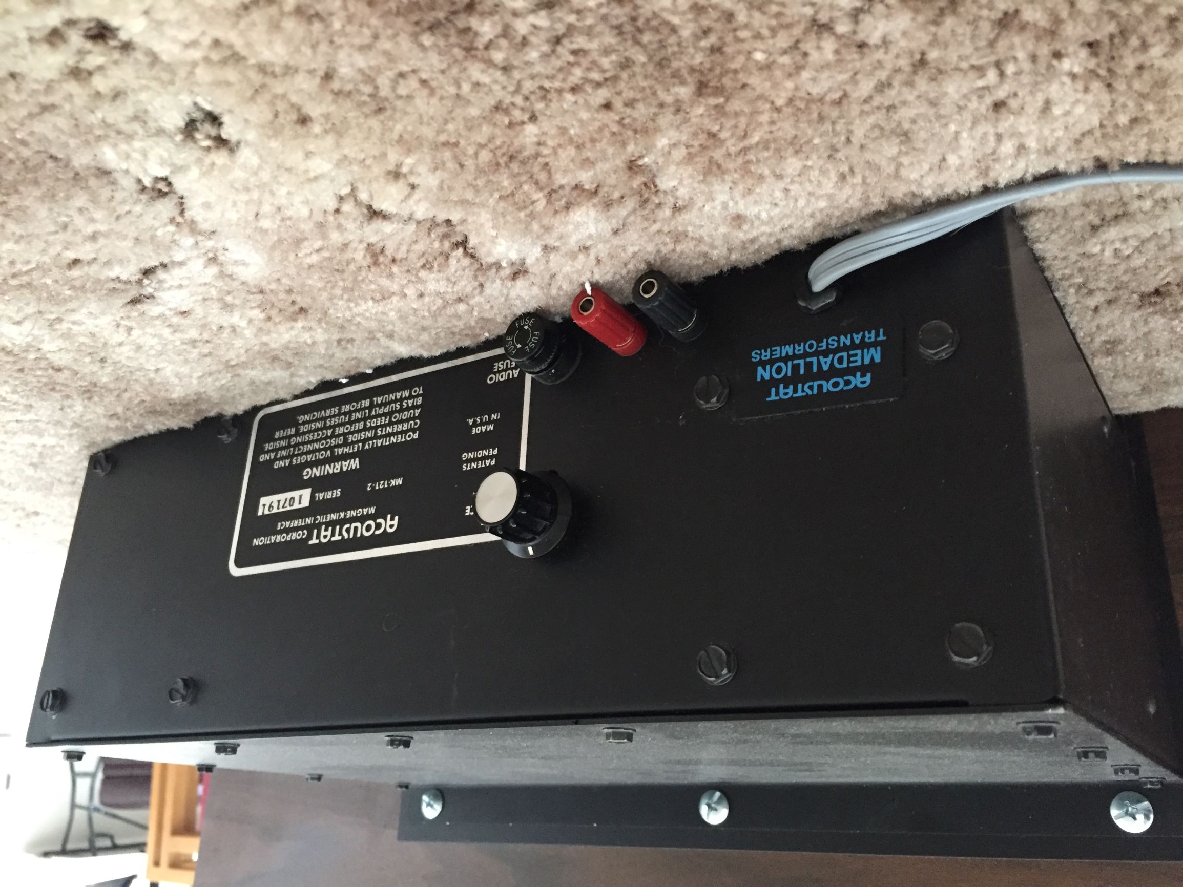

So, a quick background on my set of Acoustat 3’s and a few questions.
I have become the proud owner of a pair of Acoustat 3’s with the Blue Medallion interfaces. This is a fresh out of the box setup. Yep I am the first real owner of them. (according to the gentleman that sold them to me)
I got the pair still in the wrapping and original cardboard boxes from a gentleman that said he was a former Acoustat dealer. (I have a few pics of the speakers and box a few posts above this one, I am looking to match this color grill to my other set of Acoustat speakers)
This gentleman that sold them must be in his late 70’s early 80’s. He said he has had these speakers in storage for years and years. I am not sure if the Medallion interfaces were done by him or if they came from the factory already installed. (if anyone can tell please let me know)
The interfaces have the pretty blue sticker on the back, so I think that is a good sign. So, if the story that was told to me from the older gentleman is true these should be new 30ish year old speakers.
They look fantastic, sound as good if not a smallish bit better then my Spectra 22’s. I think 3 panels with high frequencies coming across all 3 panels make a difference compared to the 22’s. But I have not turned the 3’s up much at all.
I tend to think the story is true because of the boxes wrapping etc but even if its not all reality, I still have what seems to be a great set of Acoustat 3’s, but I have a few questions I am hoping I can get answered.
#1 I am guessing that these speakers are 30 or so years old, can anyone give a better age of the speakers? (ill post a pic of one speaker and 1 transformer to see if that helps) These look like the first versions of the model 3’s (if my research is correct)
#2. I have them hooked up and have been babying them. They sound fantastic but I am still a bit weary of the internals. If I let the power drain over night and take the interfaces off, What should I look for to make sure all is in great shape before I put a real deal amp on them and stop babying them? I am an IT guy I deal with computers and electronics all day long but have zero experience with high voltage stuff. I do not want to get mega zapped. I am willing to do what it takes to get the job done. But I do not want to go into a job blind. Any help on what to look for or a video or walk through would be very helpful. Not sure if this kind of thing is out there on the internet.
#3. I do not want to take the socks off unless I must, but do you think I need to before I stop babying them?
#4. Are there any mods and or must do changes for the 3’s I read that the Medallion interfaces are the by far most important mod to do? But are there others I am neglecting on these? And if there are other must do mods does anyone have a video or walk through for dummies like me?.
#5. I have the High Frequency Dial set to the middle on each speaker. I know it’s more likely a set to taste kind of thing. But anyone have some reference on what the dial does? I do not hear much of a difference unless the dial is almost all the way turned up or all the way turned down. All the way up the “tweeters” are much brighter sounding.
Thank you in advance for all the help.
Sorry for the sideways and upside down pics.
Jesse

From the OP (I added more line breaks):
All the details you need about the C mod are in this thread, including specific parts, diagrams, etc. There are also details about how to handle the panels properly, how to remove the socks, etc.
What I am mainly wondering about is the low frequency transformer insulation deterioration problem, which I recall reading is a bigger issue with pre-Medallion models. Internal arcing that can damage both the panel and the amp is something I'd like to avoid. That concern doesn't seem to apply much to your situation since you have a Medallion model and because it's in like-new condition.
edit:
The proper handling of the panels in terms of voltage discharge and the like is discussed in this thread. My recollection is that a few hours should be enough but I would read all of the pages if I were you. I still have some to read myself.
Since your speakers are apparently in like-new condition (such as no rust on the interface screws — in contrast to two pairs of 2+2s I have seen for sale recently that have quite a bit of rust on all of them) I doubt you have much to worry about as long as you have the right amplification for them and don't try to push them past their bass excursion limit. This is speculation on my part, though, as I do not have Acoustat speakers. I am still weighing the option of buying a locally-available pre-Medallion model with no C mod (and considerable corrosion on those screws and who knows what else). The high price of adequate amplification is also a concern for me, not just the transformer insulation issue (that, as I mentioned, I believe I read him say is one of the things the Medallion upgrade ameliorated). As for corrosion, my understanding, based on what I've read so far about these speakers, is their internals were designed to be quite resistant to deterioration from it, in contrast with some competitors' speakers that used things like copper wires. However, the rusty screws on the models I saw makes me wonder if there is anything on the inside that I should worry about other than the aforementioned HF balance control.
One person I spoke with who says he has had Acoustats since the 80s suggested keeping your amp's volume turned down all the way when powering things on.
I believe the OP said that unless you're noticing sound quality issues with the Acoustats it's probably not necessary to go hunting around for trouble inside them. For example, he said this at one point to someone:
The HF balance control corrosion issue may be an exception. I certainly can't speak for him and would read the rest of the thread, of course.
The Blue Medallion label indicates that the speaker has the much-desired Medallion transformers. This was an immensely popular and rather expensive upgrade program for Acoustat Speakers. Both high and low frequency audio transformers were replaced, and depending on the vintage, capacitors and other components were upgraded to state-of-the-art. Of course, many speakers were also factory-built with Medallions.
A while after the introduction of the Medallion transformers, a further improvement was made to the input circuit for the high-frequency transformer, the so-called "C-Mod". These speakers are identified by a red Medallion label. The improvement is not nearly as dramatic as the Medallion transformers, but it is definitely audible, and is inexpensive and simple to perform. In terms of identifying Acoustats on the used market, speakers with the red label have been fully upgraded (or factory-built) with all the latest improvements made by Acoustat before the line was discontinued.
Speakers with the blue label have been upgraded with the better transformers and other components, but not the "C-Mod". Instructions for upgrading these speakers to the "C-Mod" are shown elsewhere on this website.
Speakers with no Medallion label have not been upgraded at all. Finding transformers to perform the Medallion upgrade is likely impossible, and would definitely be very expensive.
In terms of monetary worth, Red labels are the most desirable, and should command the highest prices. Blue labels should be worth nearly as much, due to the low cost of upgrading to the "C-Mod".
Speakers with no Medallion label will be worth considerably less, as they are nearly impossible to upgrade. Nevertheless, don't overlook these unmodified speakers if the price is right. Acoustats with original transformers still sound very good, and can be an excellent value.
Keep in mind that the Medallion program does not apply to the Spectra series. All the good things that Acoustat learned in developing the Medallion transformers were incorporated in the Spectra transformers, and hence no upgrade is necessary.
if the panels have a bias wire that is yellow with a red stripe, that indicates the newer conductive coating, which does make a difference and is highly preferred.
Acoustat made a change in the coating in the late 80's, significantly increasing it's resistivity. The result was lower charge migration across the diaphragm, allowing the speaker to play louder bass notes before experiencing "crackling". Panels with the improved coating can be identified by a bias wire that is yellow with a red spiral stripe.
Acoustat also made improvements in the conductive coating (which all Spectra panels have), but that change resulted in improved dynamic behavior, and is generally not considered to sound any different except for its handling of large excursions (less crackling on bass notes).
edit:
Have you checked the integrity of the HF balance control? These have been known to develop oxidation (green stuff) on the exposed conductor and contact. Try loosening the adjustable slider and using fine emery paper to clean both the resistor's wires and the point of contact on the underside of the slider. These same comments apply to the older rotary-type HF balance control.
Also keep in mind that the speaker will rattle or buzz when it reaches its low-frequency excursion limit, so you may be asking too much from the speaker.
My advice would be to connect the panels, apply AC power, charge 'em up for a few minutes, and play music to verify operation.

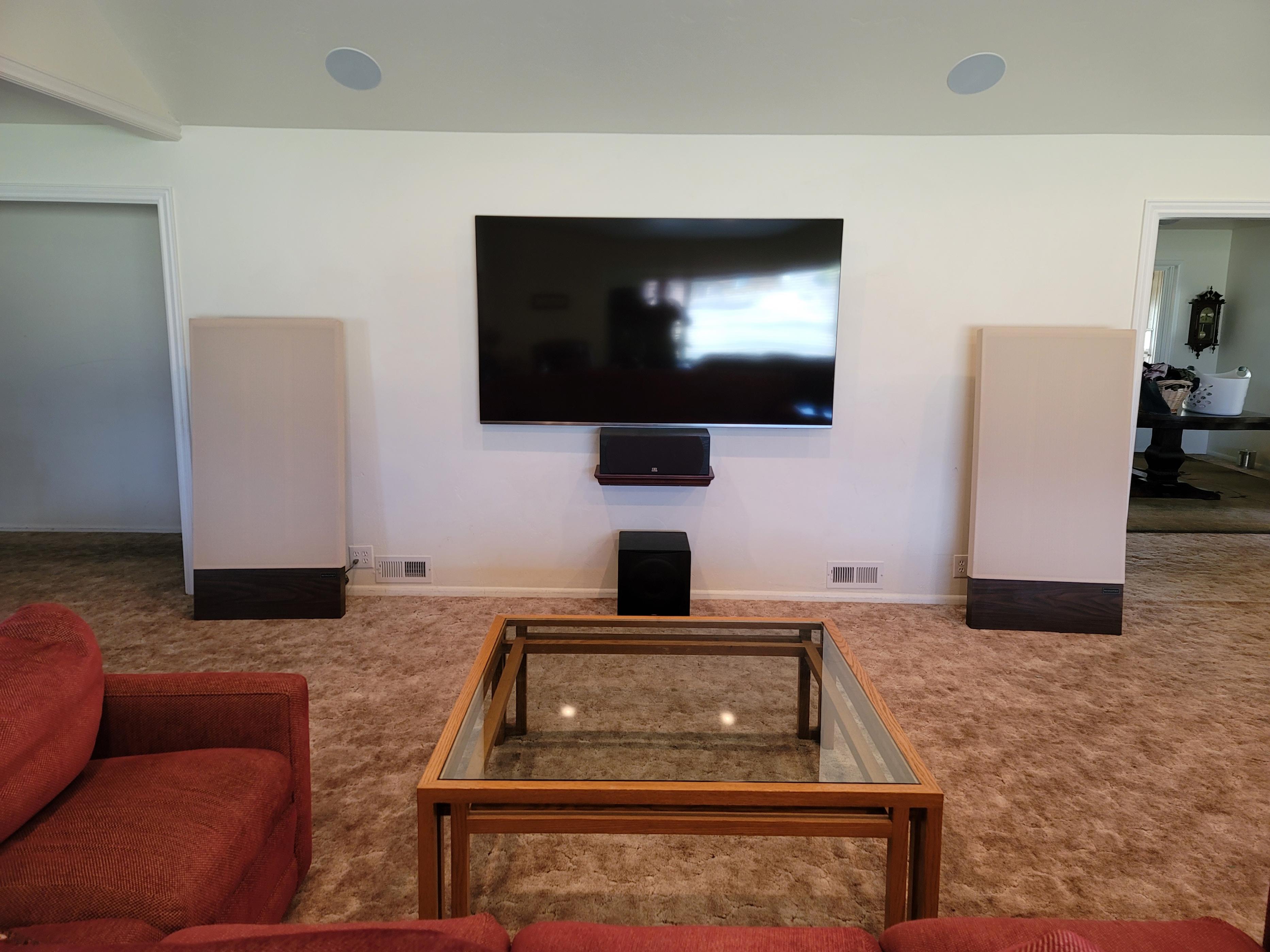

Thank you for the help,
I think over the weekend, (wife and kids allowing) Ill remove one of the panels and snap a few pics of the guts of the interface and post them up. Maybe people like yourself and others that contribute to the thread will be able to spot something that I would easily miss, and or say I am OK to start playing them for real. The Interfaces are in sequential numbered order as one would expect.
I have my Acoustat 3’s as part of my theater setup in a great-room that is almost 1000-sqft. I know this is not an ideal space for audiophile listening.
But with a wife to keep happy and 4 young kids still growing up, a dedicated listening space is not in the cards for me right now.
I use 2 sets of Acoustat speakers as part of my home theater setup in this room. I love the soundstage that the Acoustats throw out in this big room. So, I figured why not have 2 sets as part of the theater. (If there was an Acoustat Center speaker I would use it)
As for amplification, I am running Martantz MA500 monoblocks one to each speaker. I have 5 of them hooked up. (2) for my Acoustat 3's as front left and right speakers, (2) for my spectra 22's playing as the surround left and right, and (1) for my Monitor Audio Gold GLCR as center channel. I also have 4 subs integrated into this setup to help on the low end.
My Spectra’s 22’s were my front left and right before I was able to get the new 3’s. I use an Anthem Statement D2 preamp with ARC room correction for the theater DSP and room correction. And a MiniDSP 2x4HD for the 4 sub DSP integration and room correction.
I have an Earthquake Audio Cinenova Grade 5 amplifier on the way that should be arriving early next week. This new amp will be replacing my older Marantz monoblocks. I Think this new amp will be better than my current monoblocks by a large margin. (specs of the new amp below)
