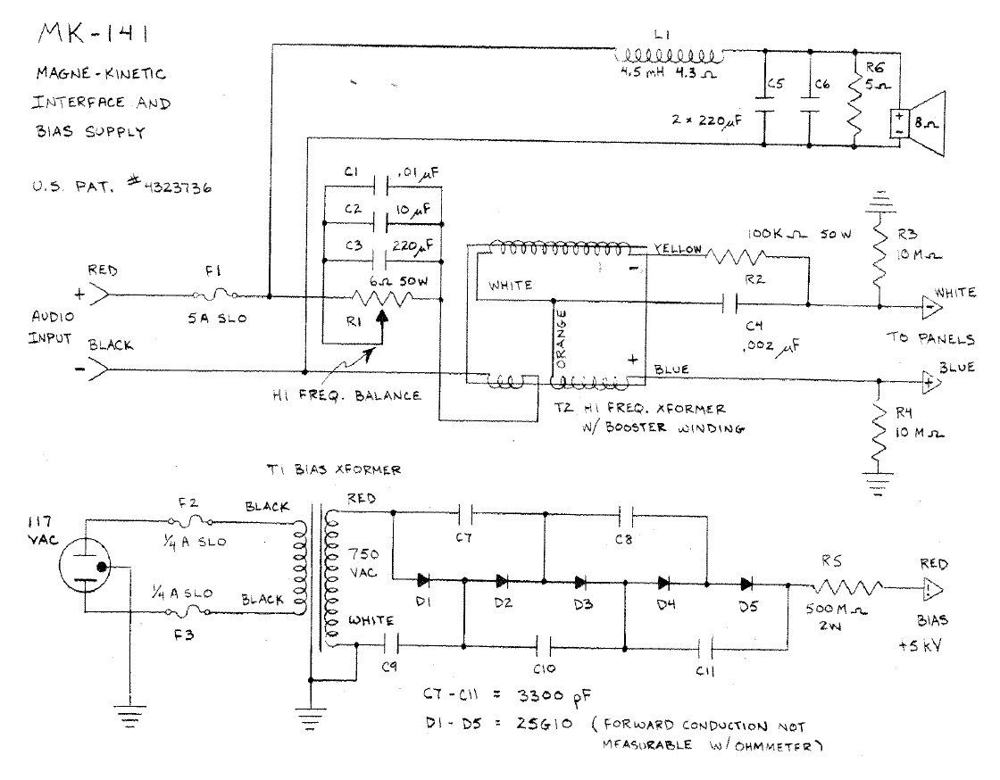

The Yamaha MX830 has a rated power of 200 WPC into 8 ohms. I didn't see any spec for driving 4 ohms, which would be a better specification to judge its ability to adequately drive the Model One (MK-141 interface). It will probably be okay, but certainly not the ultimate choice.
BTW, the Model One is a limited-frequency range speaker, and is designed to be used with, and was originally supplied with, a companion woofer module. Do you have the woofer module? Note the woofer and its crossover on the schematic above. If you don't have the original companion woofer, you will need some sort of woofer, as the main speakers don't have much output below about 150 Hz. Also, the original woofer was the weakest part of the Model One, so replacing it with something better is not a bad idea. Small steps!

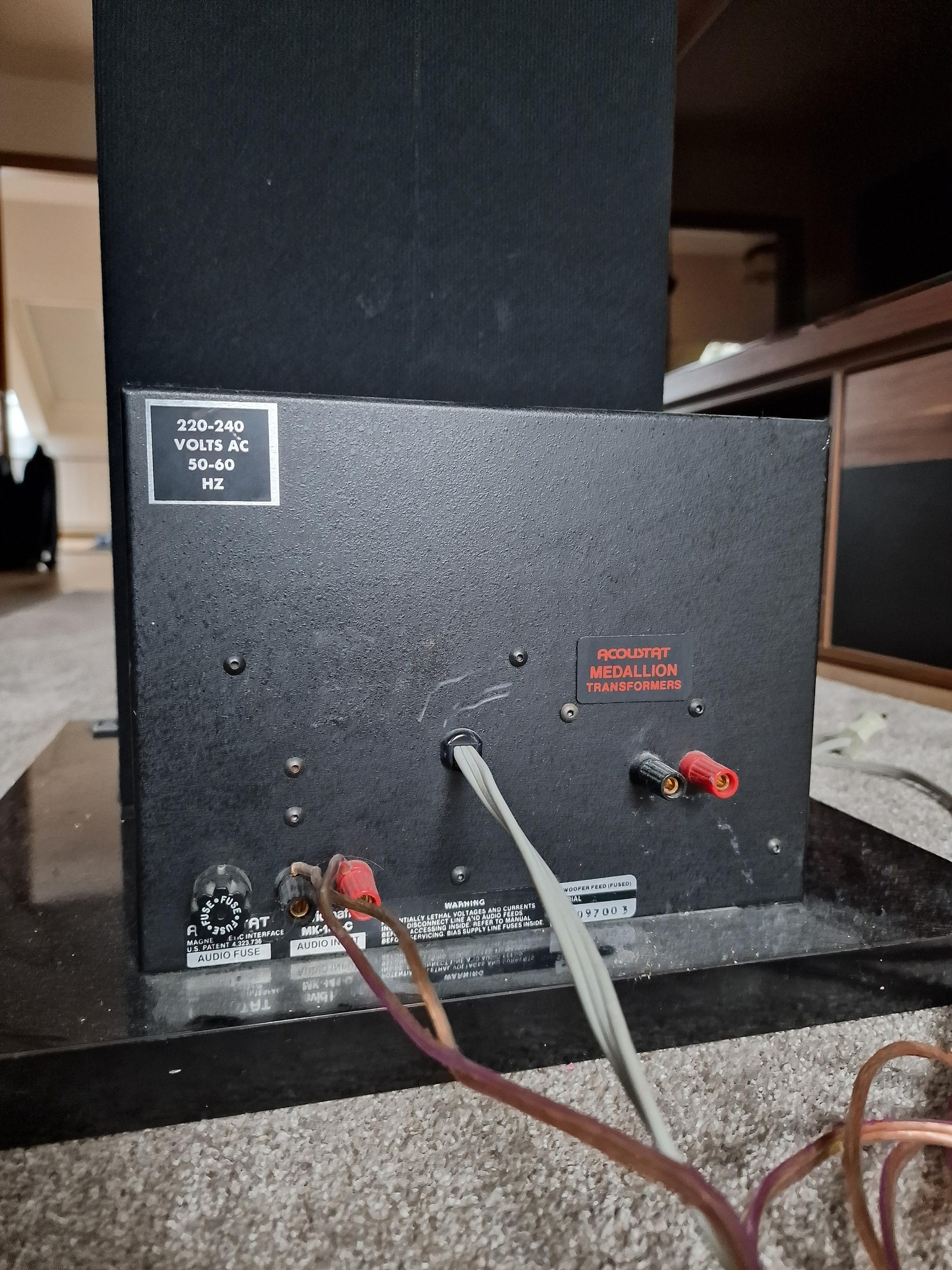

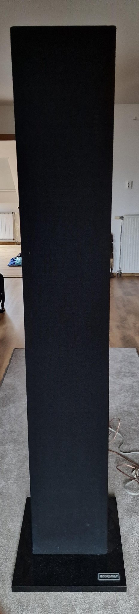

yager - take pic of entire speaker (front) and the back of interface - this will let us know what Acoustats you have...

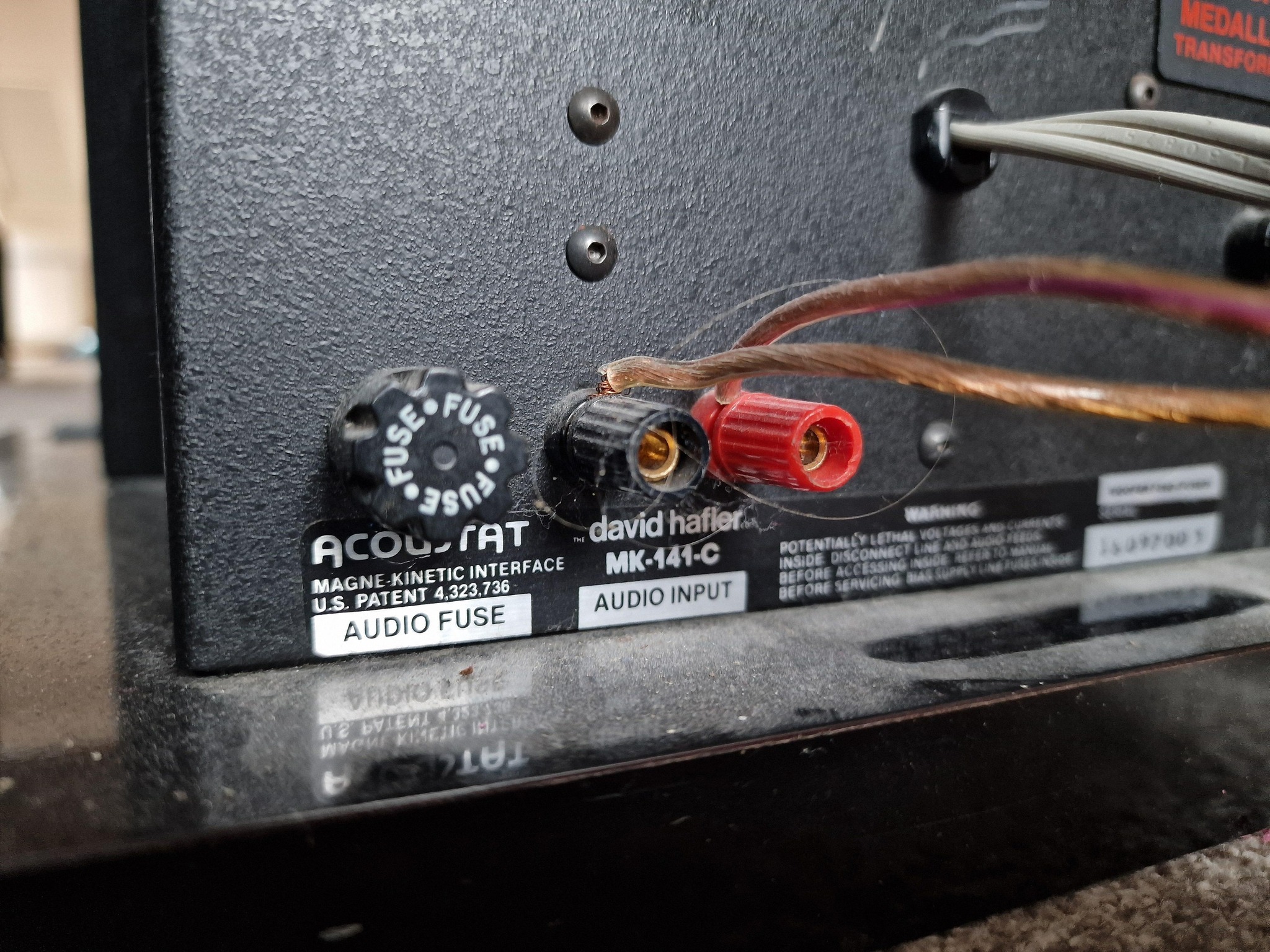

MK-141C is the interface (black box) model, not the speaker model.

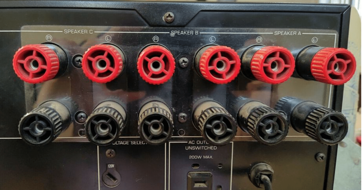

I made some photo (3pieces) about My speakers and looked for one pic about the Yamaha Mx-830 back. If I think correctly I will connect to my acoustat to the Yamaha's "A" speakers input to left and right side. I need 2 pieces passive (or) active sub what I have to line in to the Acoustat output? Or should I have to connect the sub to the yamaha's other input? The yamaha is an "end-ampifier" thats why I need to buy and DAC what would be the input for the Yamaha's. Is it good info...?
The Model 2 is a full-range speaker using the MK-121 series of interface. You may be thinking of the Model 2MH (a hybrid system with built-in woofer), which uses the MK-131 interface. The MK-131 is similar, but not identical to the MK-141.AAM - Didn't the Model 2 and 1+1 come with the MK-141C too?
The Model 1+1 is a full-range speaker using the MK-121 series of interface. You may be thinking of the Model 1+1S (a 3-piece system with woofer similar to the Model One's woofer). This speaker uses the MK-141B interface. The model 1+1S was discontinued before the introduction of Medallion Transformers or the C-Mod.

I looked one service manual about Yamaha Mx-830. I'm attached it. I hope you can check it and will write opinion for me. This price is very good for it - about 400EUR. My second target is a DAC - exatly Topping E30. I think this amp and this DAC would be good pair together with my MK-141C. After these item I need to looking for one or two woofer. But the first step will be the amp + dac.Attachments
