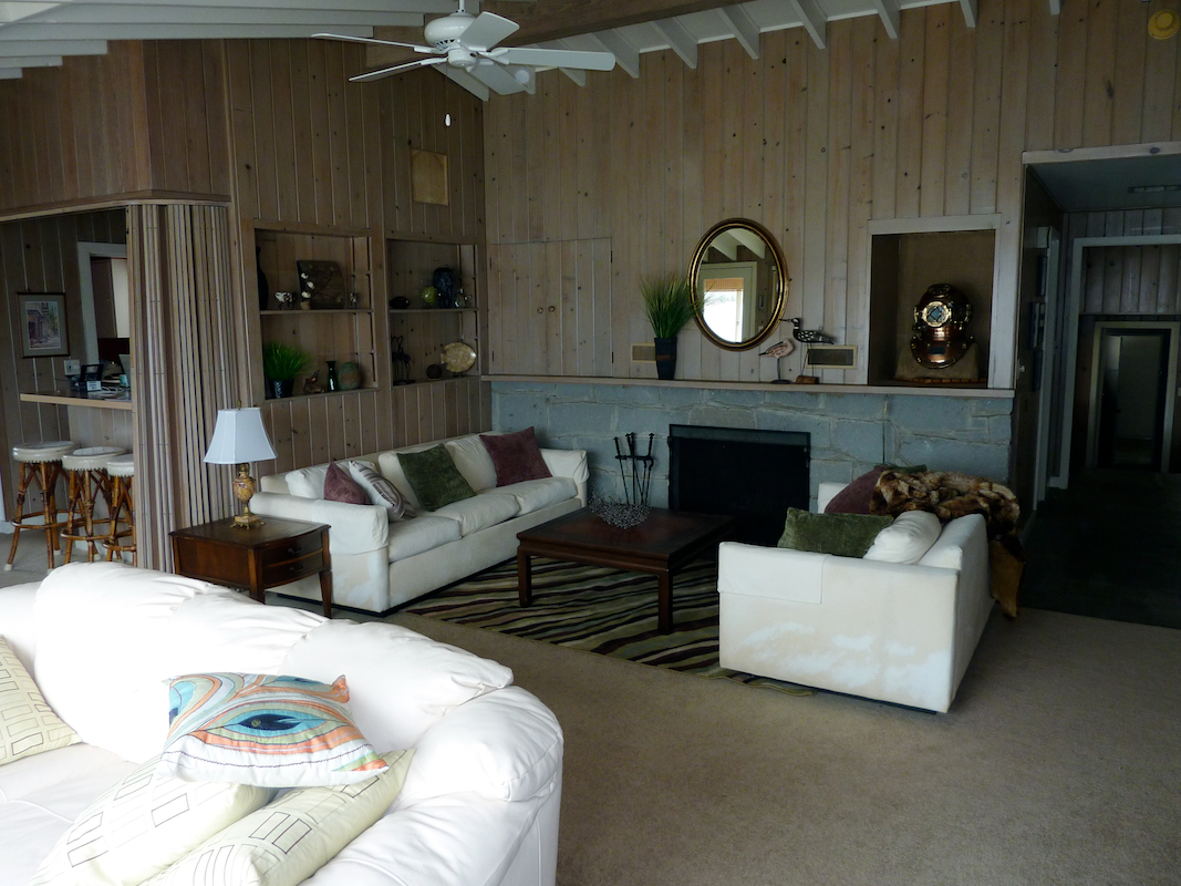

Has anybody mounted acoustics on or in a wall? I have a room without any possibility of floor positioning (see pic). There is a large wall above the fireplace behind which is attic space. Is it feasible to mount my model 3s or 2s on-wall, or in-wall, with the back being open to the attic i.e. infinite baffle? If so should they be angled down or toed in. I will be using a minidsp to manage room effects, and, if necessary to control a sub. If mounted on the wall will this introduce diffraction issues? Any input is greatly appreciated.

Infinite baffle would be perfect.
On the wall, only if you angle them leaving enough space for the back-wave to escape without reflecting straight back in to the panel.
Fortunately, with all old models being very directional (beaming), they like the heavy angling towards the listening postion, even as much as "crossing" the imaginary lines in front of you. In some cases (my room for example) they sound the best like that.
I kept the Model-3 pushed right into the corners as far as it would go at about 30 deg to the rear wall (60 deg to the side wall) for 15 years - it was the best I could do and they sounded excellent. On the down side, the sweet spot was about 10x10cm size. If your head is too big, you lose the HF response (ears are out of the sweet spot) :D
Fortunately the sound should be better than other options even for those not in the sweet spot. My 3s are in the middle of a very large room, with the back wall much further away than the listening position and the sound is fantastic. I am anticipating that with either in or on-wall, I'll need to keep the back open. My concern with on-wall is the diffraction that will be created at the edge of the speaker. Flush mounting them in the wall would avoid these issues.

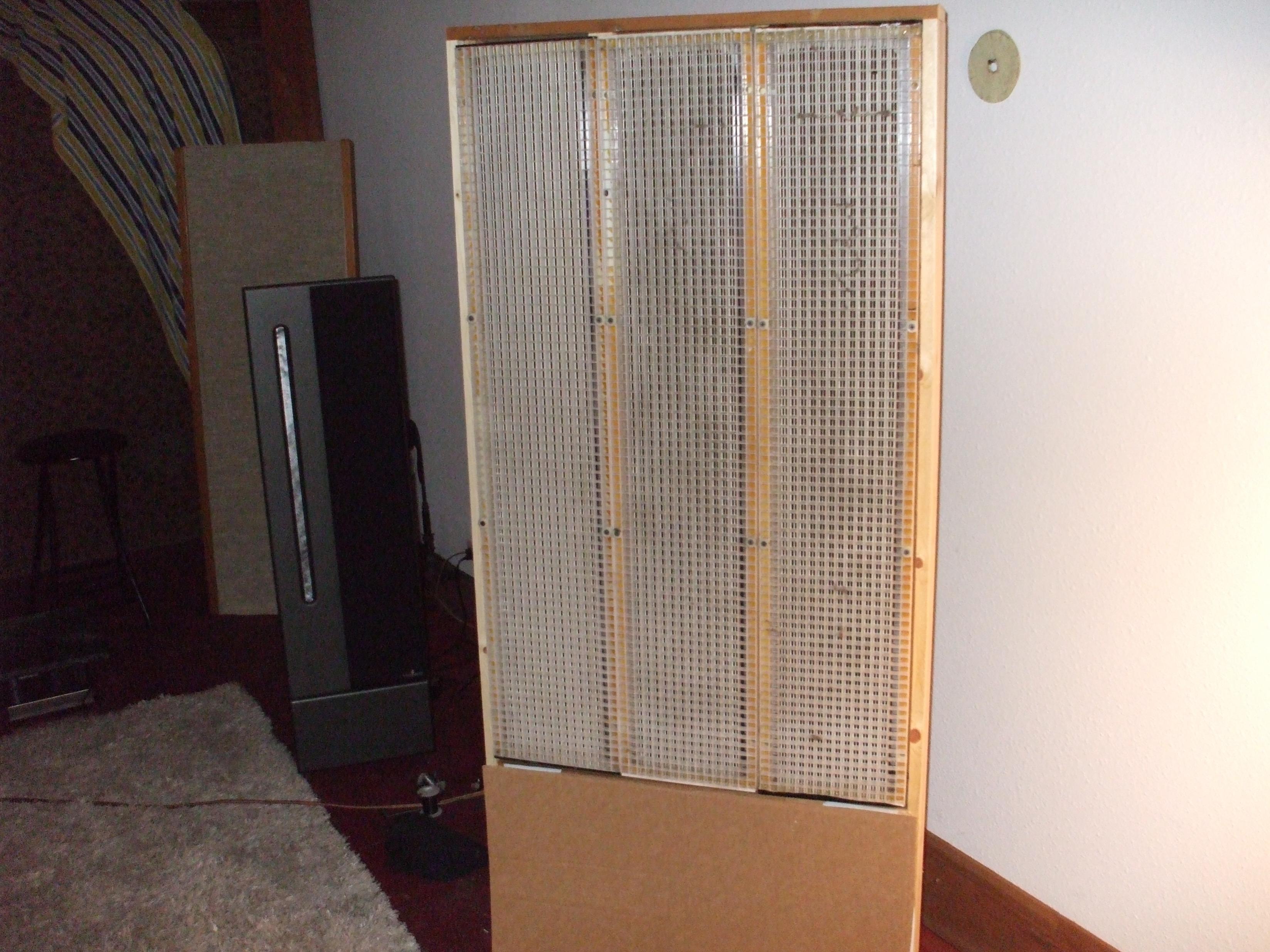

Yes I went for 3ea 9"panels only flat............best sound i have ever had......worket for the old quad 57s..........Sander like the none dispershion flat sound...for me hes right...
Lot of people say the 1+1 was the best of the olders setups.......so i just puled them up of the ground an went with a 28"
...i had the 1+1s ...2+2...M3...M4s...
but this sounds the best.........big stage.......sweet sound...
Long like Acoustat....panels anyway

I believe the question remains unanswered, if you mount them in wall, you are creating an enclosure. The results are unpredictable, I think! I have experimented with two panels bolted together sealed, both in phase and out of phase, using servos and interfaces. Neither was worth my effort. I do not know of any one ever bragging about enclosing the back wave like a common driver.
I do know for a fact you will loose sensitivity, every time I over compensated for rear wave, absorption, I lost at least 3 db, your completely isolating the back wave which will be significant.

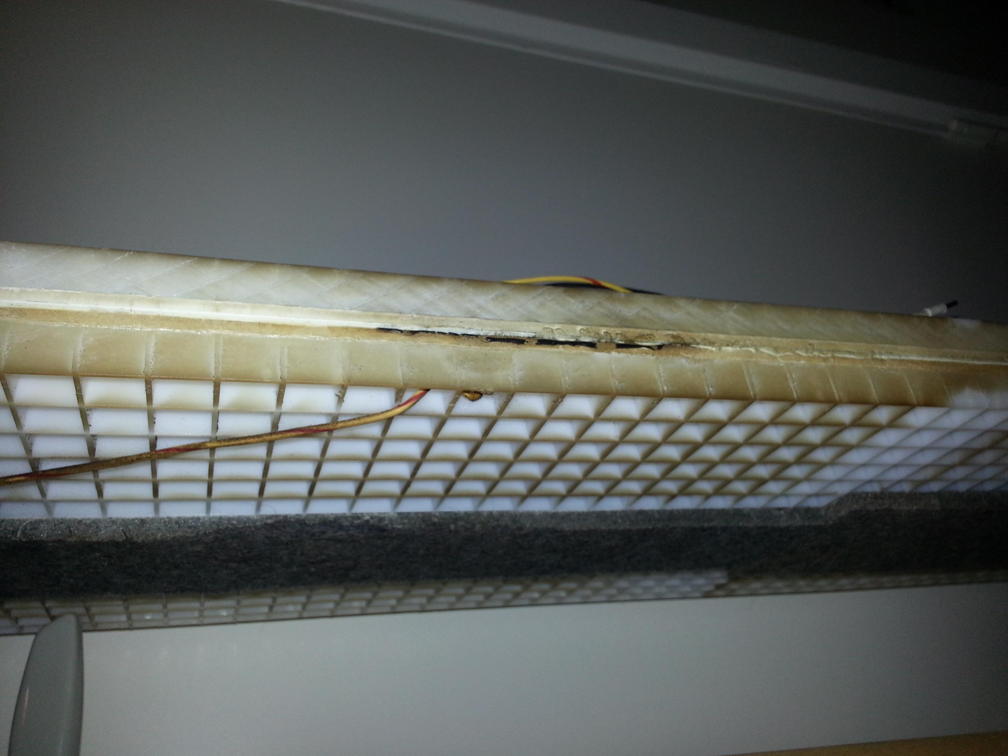

I noticed there is a burn mark in the plastic about where the yellow/red cable is attached in the panel (see attached picture). Is it something to be worried about, and if so what can be done to fix it?

The dark area around the bias feed wire may not be a burn mark - it's hard to tell from your photo. The panel does look like it has discolored quite a bit, which is not unusual: the high voltage tends to attract dust and especially smoke particles. The dark area may be just an accumulation of dirt, or it may even be a stray bit of conductive coating that got slopped on the edge of the panel during original manufacture. You might try cleaning the area with a mild soap and barely-wet rag. Otherwise, I wouldn't worry about it too much unless there are signs of actual burnt plastic or charred insulation on the bias feed wire. There have been virtually no reports of problems in the bias-feed area.
