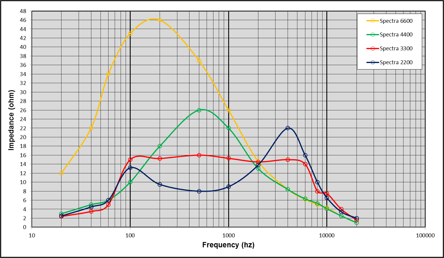

Attached is Zdata for the other Spectra models, and a crude overlay I made some time ago.
The 3300 impedance looks to be quite a bit "friendlier" than the 2200 in the midrange but no differenct at the LF/HF extremes. This is not particularly surprising since the 2200 & 3300 use the same interface(MK-2123) and only differ in the transformer secondary tap feeding to the midrange mixer resistor.
I would expect the 4400 & 6600 to have similar impedances as well since they both use the MK-2146 interface. I'm not sure why the 6600 show significantly higher impedance an LF than the 4400. My guess would be the 6600 impedance measurement was taken with a higher signal level increasing the core permiability and thus primary inductance. Impedance of transformer driven ESL is a moving target...

First point: most of the technical data on the Audiocircuit was provided by yours truly from my old Acoustat files. So in that respect, the Audiocircuit website is THE place to get Acoustat manuals and other technical information on Acoustat. They also have a Q&A forum in which I participate.
Second point: I created all of the original Spectra impedance/phase plots, but I remember very little of the method used. Furthermore, since they were done at different times, it is entirely possible that slightly different methods and/or drive levels may have been used. So the graphs are probably useful only for studying the relative variation of impedance/phase vs. frequency for a given model, not the absolute values. Therefore, the graphs are probably less useful for looking at the differences between models.
