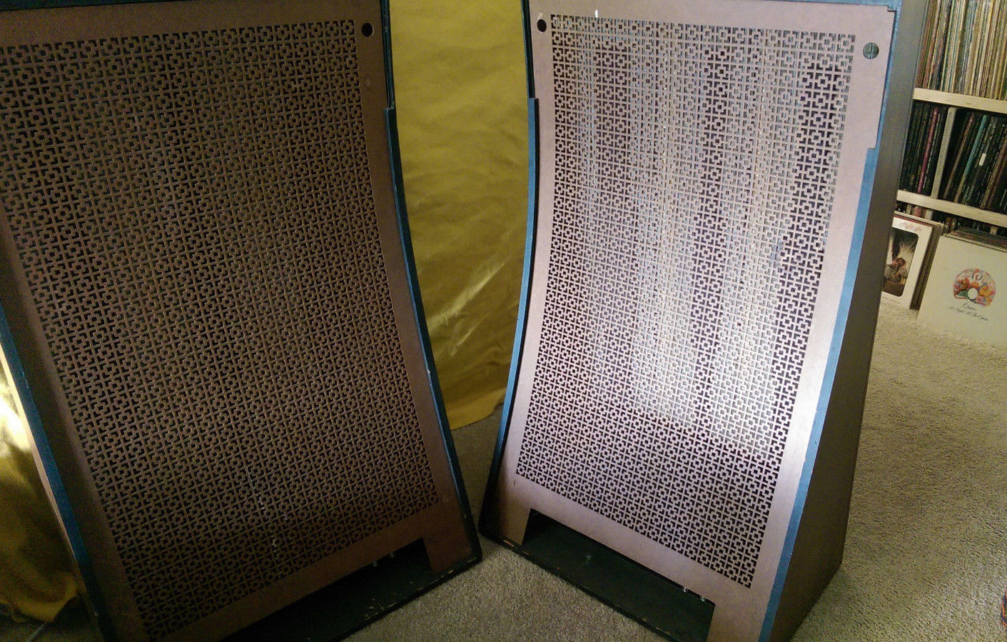

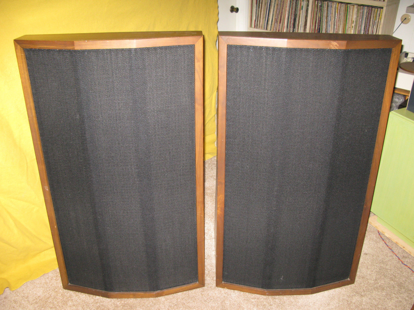

Reviving my 2+2's and have a bad panel, slight random popping (arcing?). We tried all options: vacuuming with cover off, banging, compressed air, and changed wiring from panel to panel to verify that problem is indeed in one particular panel. Any further ideas and/or sources?

This condition is usually caused by some sort of foreign body (aka dirt) caught in the gap between diaphragm and stator. It could be dust, hair, bug parts, etc. It does seem that you've already tried all of the usual remedies. My only suggestion is to try them again, as sometimes that's necessary. I might also suggest temporarily removing the felt blocks on the offending panel, as they may be restricting the blast of compressed air. Also, be sure the panel is completely discharged during the process so that there isn't any static field
holding foreign particles.
The good news is that an occasional random tick or pop is not doing any damage to the speaker. This is not a hard arcing...more of a 'partial localized discharge'. Annoying yes, but not harmful. And although not likely, it's possible that this condition may go away on its own.
The only other recourse is to replace the panel. These frequently appear on eBay and other sites.

Thanks for the reply. Will repeat procedures but we have tried repeatedly. Would playing them possibly help?
TJG55
A resounding YES!
My own Spectra 4400's, which I resurrected after the previous owner stored them in an dusty warehouse, improved significantly after just a few days of play. I thoroughly cleaned them first, of course, but they still had the occasional 'tick'. Playing solved the problem completely and they've been quiet since. I leave the bias supply always on.

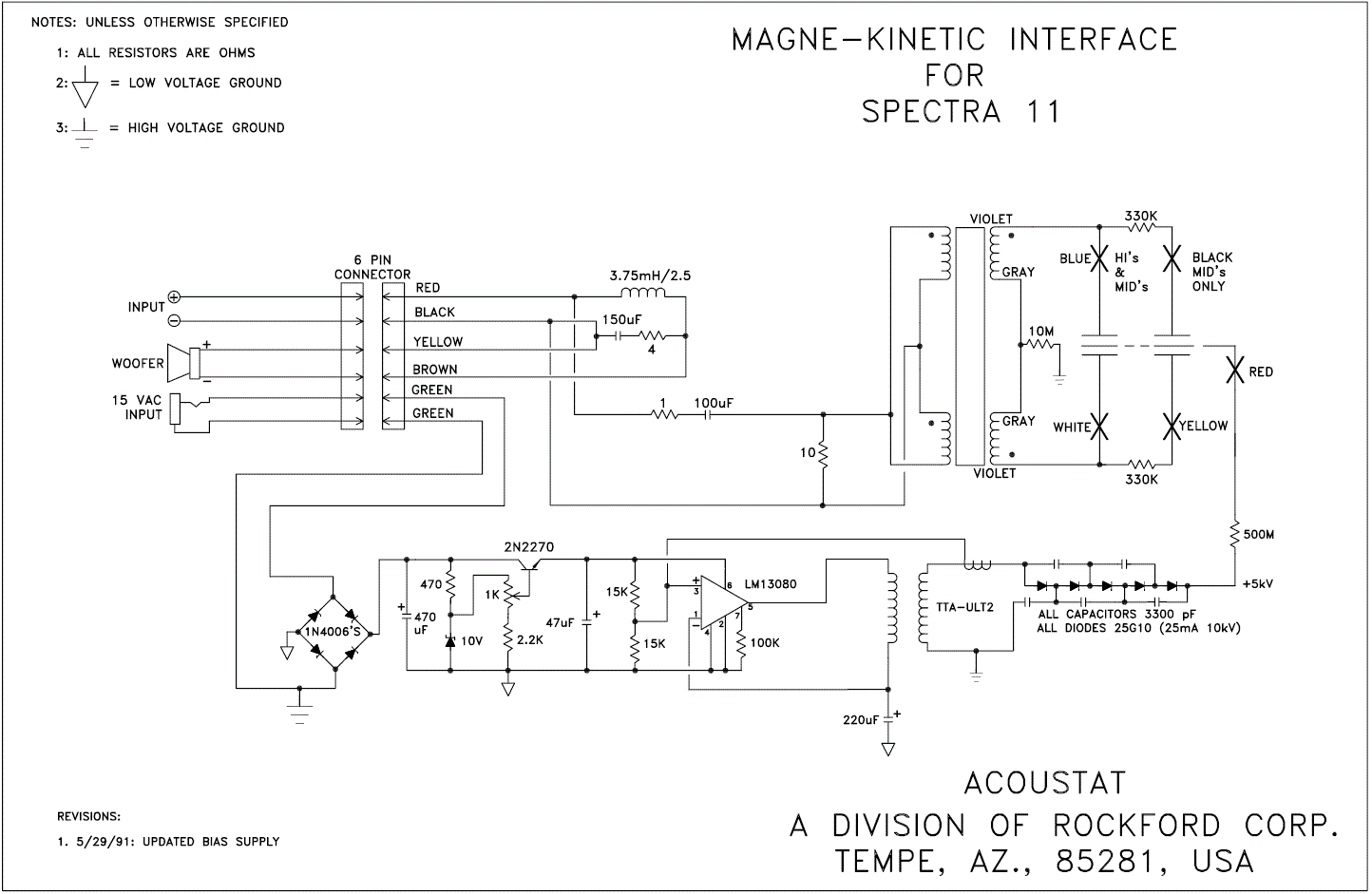

Hi Andy
A good friend has just bought a pair of 1100s. Unfortunately one of the speakers is not working correctly - there is no sound at all from the esl but the woofer is ok. He has swapped the panel over tho the "good" speaker and it thankfully is fine. He has also tried the wall supply and it's not that.
I'm going over to look in the next week or so - I guess there is a problem in the drive electronics somewhere. I'm not familiar with the design at all. Do they have a circuit like my Logan's that turn off the panel voltage when not no signal is present?
A bit like yourself I worked in pro audio for 20 years in test & dev , but now have a relatively boring job ! I miss the audio days
Any advice on where to start looking on these would be most grateful .

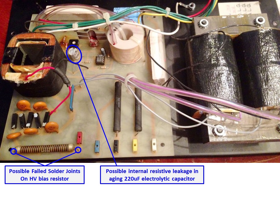

Raymondo, my SPectra 11 went out a few months back after I did the Ultrasonic fix.
Audio Haven | Acoustat
It worked for a little while (couple weeks), but then one speaker stopped working. I swapped everything and confirmed it was the interface. i rechecked my work and had no issues. I was pulling my hair out until I swapped the OPAMP LM13080. That was it. These OPAMPS are very rare and was fortunate to find some on ebay - bought two, needed one, so I have one extra.
Try that - swap the known working one into bad interface. Note the positioning in socket. If it is problem, and you cannot locate a replacement let me know.
I know Andy said these rarely fail, and mine could have failed due to my Ultrasonic fix. Either way, hope this helps...

No. HV supply is always on if wall supply is plugged in. (see attached schematic)Do they have a circuit like my Logan's that turn off the panel voltage when not no signal is present?
As a first step, check the DC supply voltage on the opamp(between pins 4 & 6).
This will confirm that the voltage regulator portion of the circuit is working.
As john65b mentioned, depending on the vintage of the speakers the ultrasonic "fix" documented by Andy may be what is required to get the supply working again if the voltage regulator part is working.
Some of the Spectra 11 bias supplies I repaired in the past had one of the following problems.
1) Severely corroded/failed solder joint on the HV bias resistor. Appeared to be caused by corona generation from end of wire sticking up out of the solder joint.
2) Aging 220uF electrolytic had built up enough internal resistance to keep the oscillator from working.
Guys thank you for the quick replies. Really appreciate it. Hopefully I can get these bad boys working for my friend . He says with only 1 stat running he can hear the quality - and he's a engineer / producer for many years .

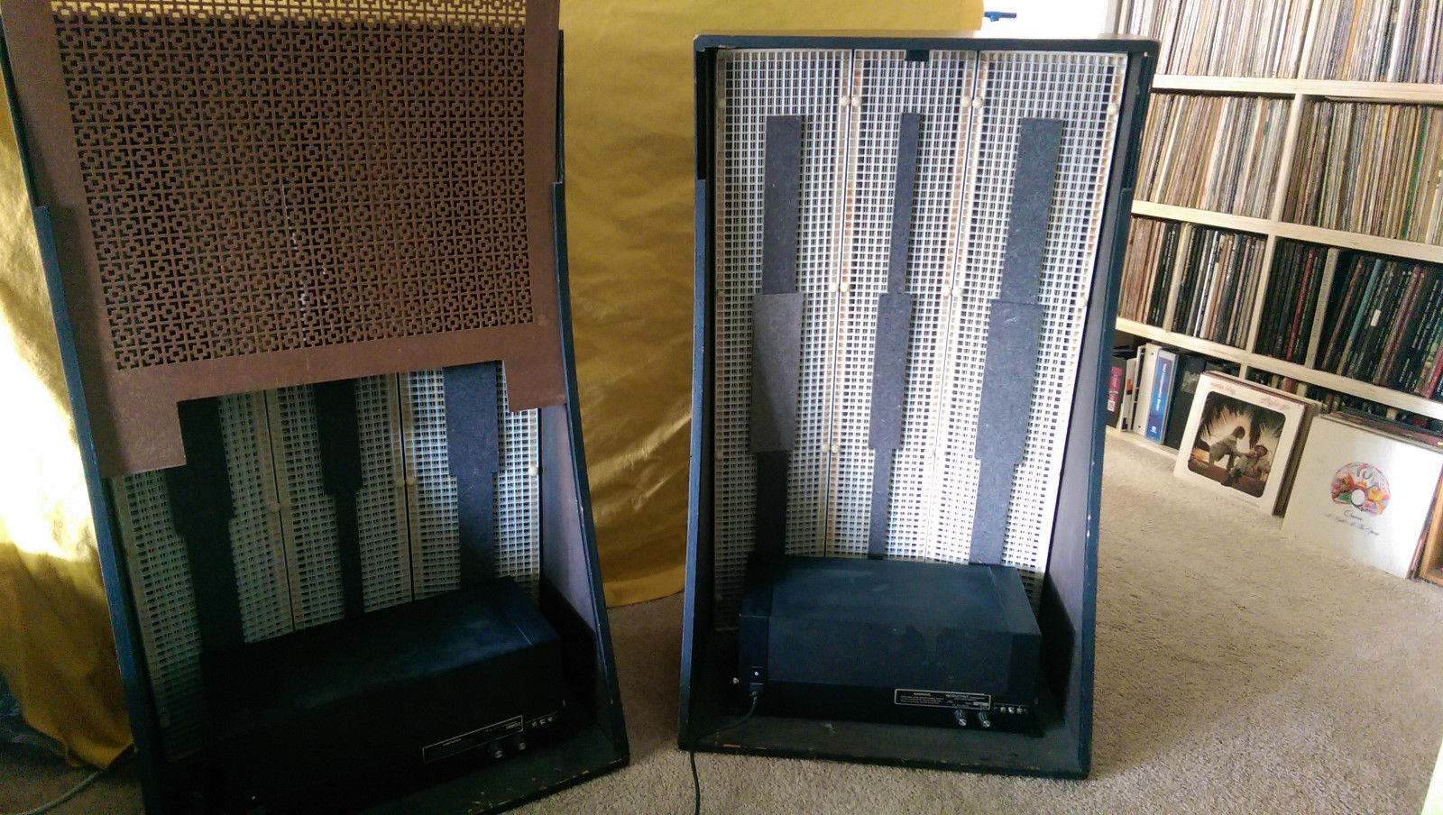

have played panel for 4 days and no change. with increased volume or stronger bass, panel has bad flapping sound. ideas?
TJG
Without hearing or examining your speaker, and assuming that this is coming from only one panel in the set, I can only guess that a "bad flapping sound"
is caused by a serious loss of diaphragm tension or torn Mylar. If you've already tried re-tensioning the diaphragm with the application of heat, try it again with more heat. It's a natural tendency to apply too little heat in the interest of not melting the Mylar (which is possible) but most folks don't apply enough heat on the first attempts. Also give the panel a good visual inspection under strong light - tears and rips can be hard to see.
Also make sure the felt blocks on the rear of the panel are present and firmly attached. Their purpose is to squelch low frequency resonances, and their loss can cause symptoms as you describe.
