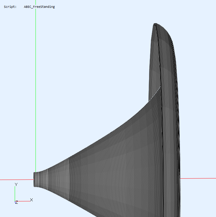

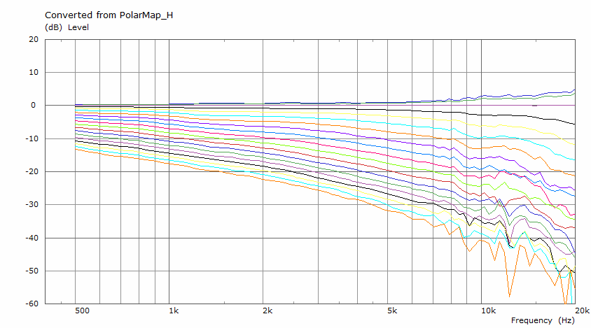

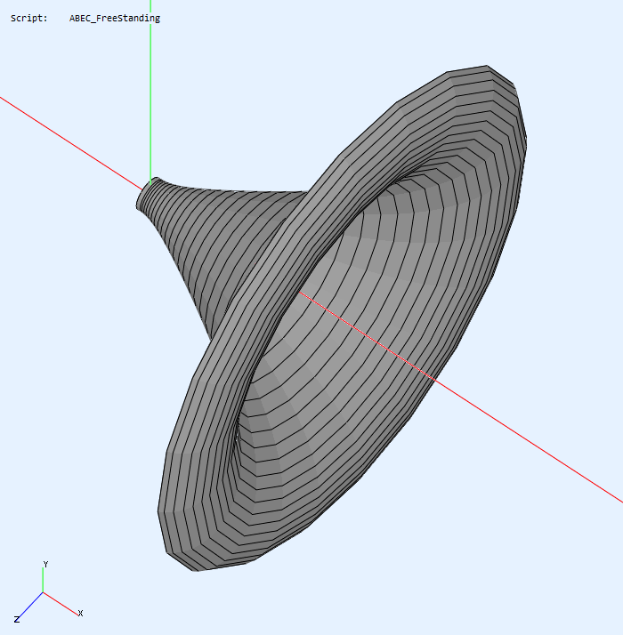

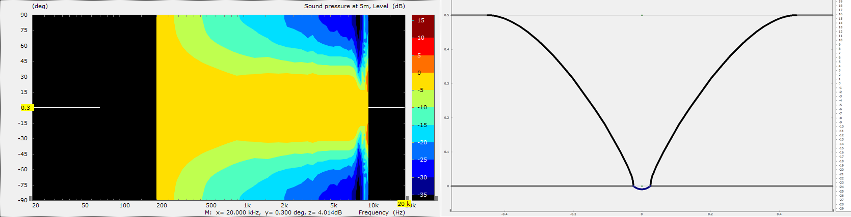

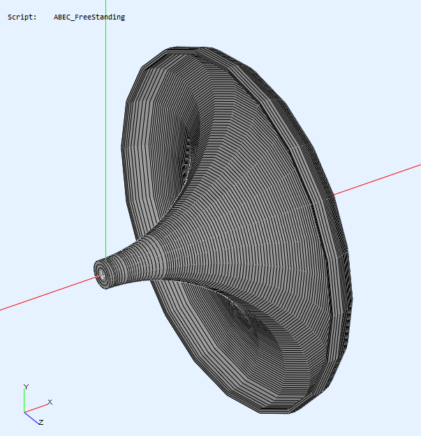

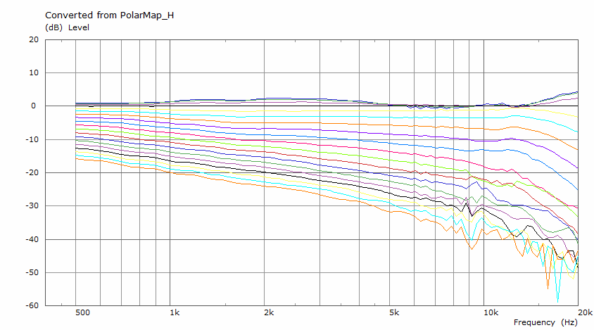

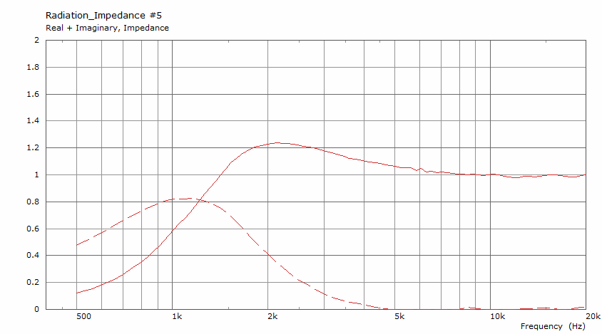

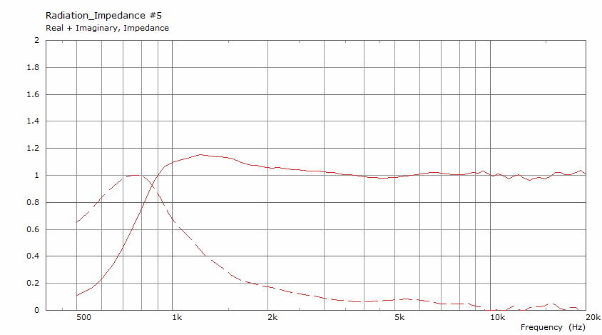

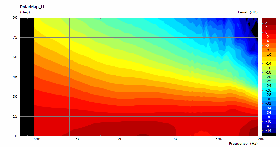

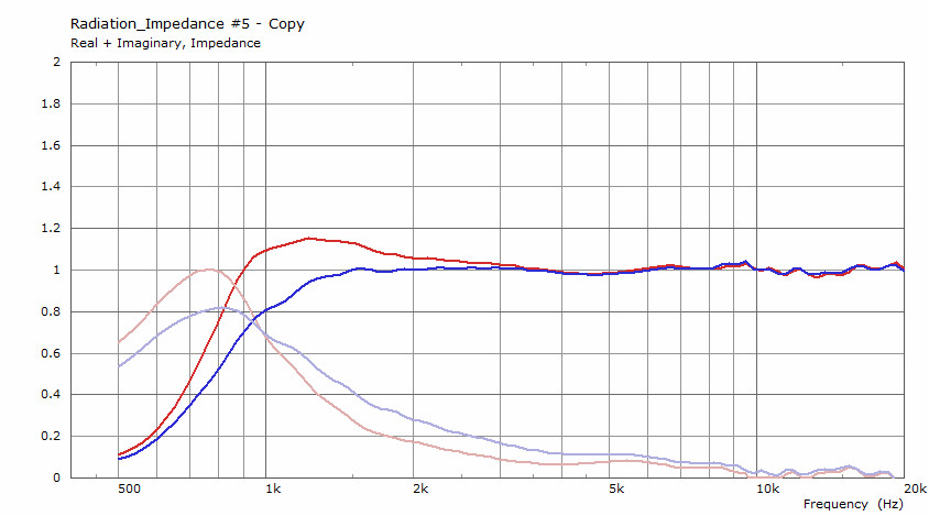

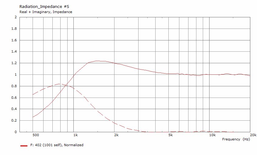

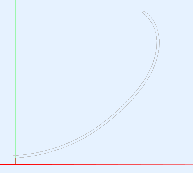

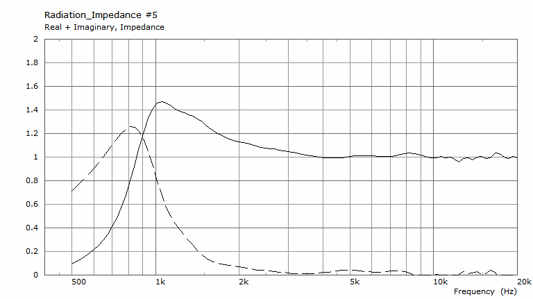

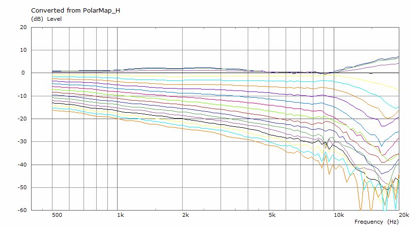

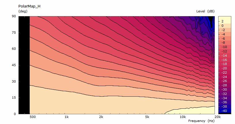

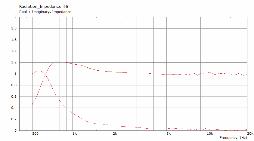

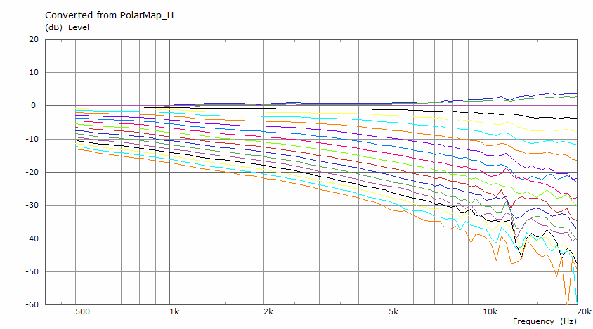

Free standing OS waveguide, 1.4" throat, ⌀980 x 430 mm :D
attachment.php

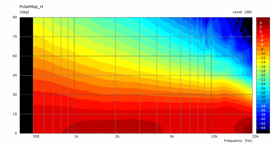

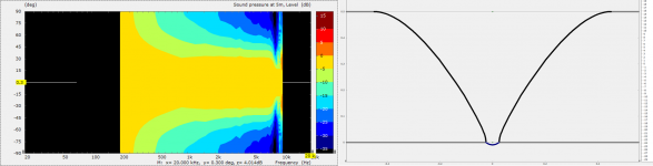

How to make flat enough a 3" in a horn ???
Faital 5FE120 with printed plug. Many advocates idea of true midrange driver in a horn or waveguide - WE15A lovers. Not many can afford Ale Acoustic D-125,
Goto SG 146, Community M4 (3-6k), Ale Acoustic 5500, Vitavox S3 or S2, Altec 288, JBL 2420 / LE85 / LE175, Atlas IED, PD-5VH, Klipsch 55.

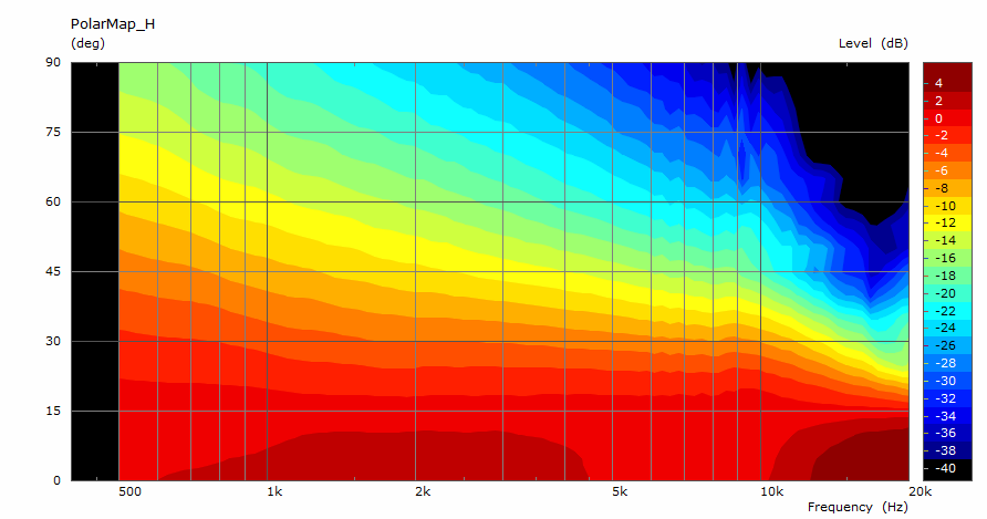

Marcel - very good better than mine :eek:

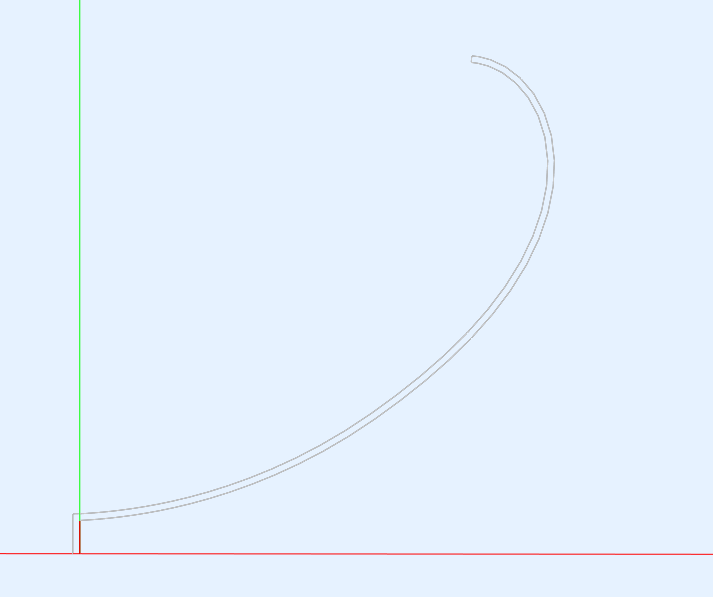

How to make flat enough a 3" in a horn ??? And people like Dr Gedlle seems against that : I mean not 3" compression driver but 3" cones. Which one are you talking about please ?
The 3" Faital in horn ?
