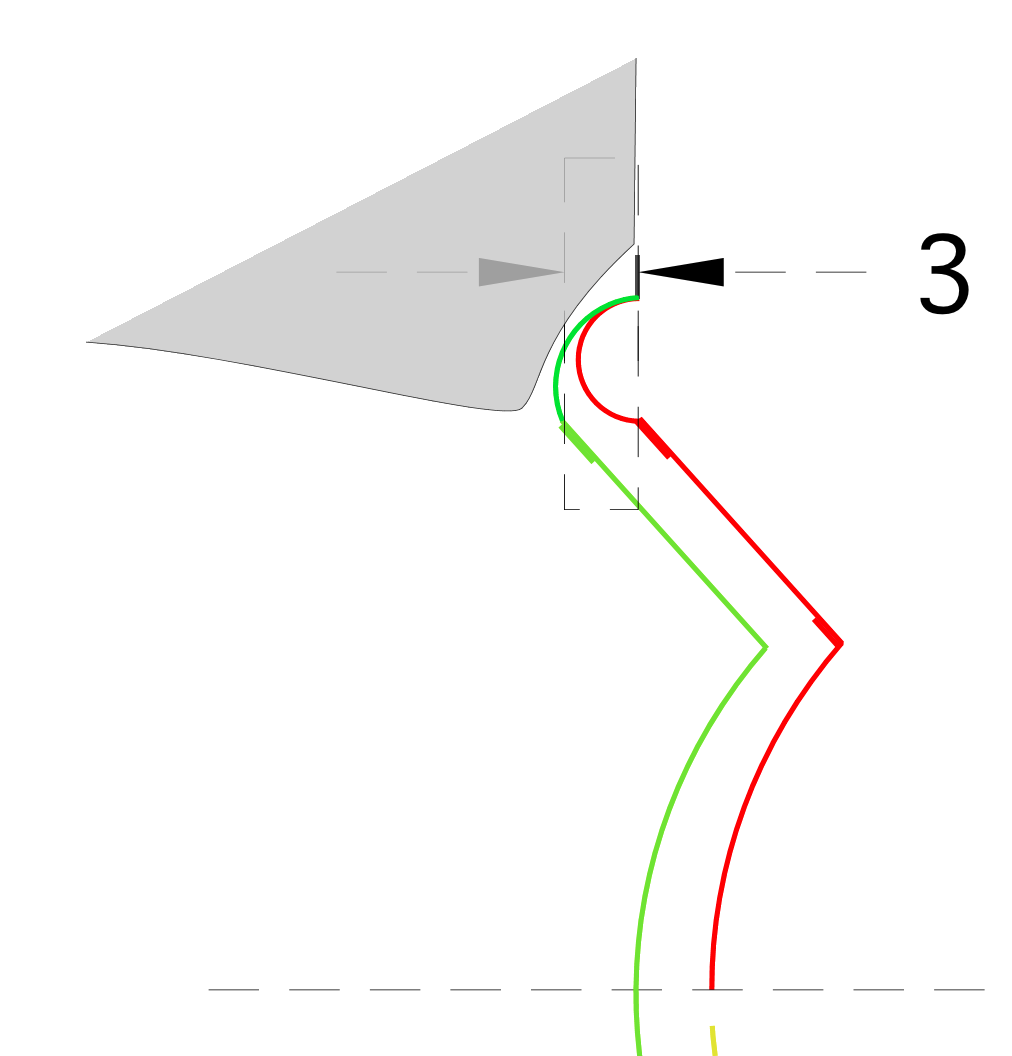

I tried that in the past, not exactly with this driver, and was a bit dissapointed with the results but generally I still like the idea. Now we can simulate it (to a degree) along with the source shape so if anyone provides a drawing of the cone+surround profile I can try too see what we can get.
Fullrange driver TC9 dimensions here along with some diy waveguide data https://www.diyaudio.com/forums/full-range/321666-waveguide-tc9-10f-3.html#post5428815
I've measured (with calipers) the Peerless TA6FC00 and Tymphany 830970 as well, and I'm planning on simulating and 3D-printing horns for them. Waiting for 3D-printer to arrive.
The 830970 (link) seems especially well suited for horn loading with its inverted surround and very shallow cone. Top of dome is in line with front surface/cone edge. Sensitivity is a bit low for use as tweeter, but maybe enough when combined with a waveguide?
Yes 🙂
I finally tried to load Ath4 on the only PC platform I have access to but it was to old. Otherwise I have had a go at it myself.
I wish you could, once you get your auto-optimizing system running, spare a few hours over a night with the task to get something usable out of that SB driver - and a bigger size is no problem - a lower fo would be desirable - say 4-600 Hz.
PS OK - I see if I can get an accurate drawing!

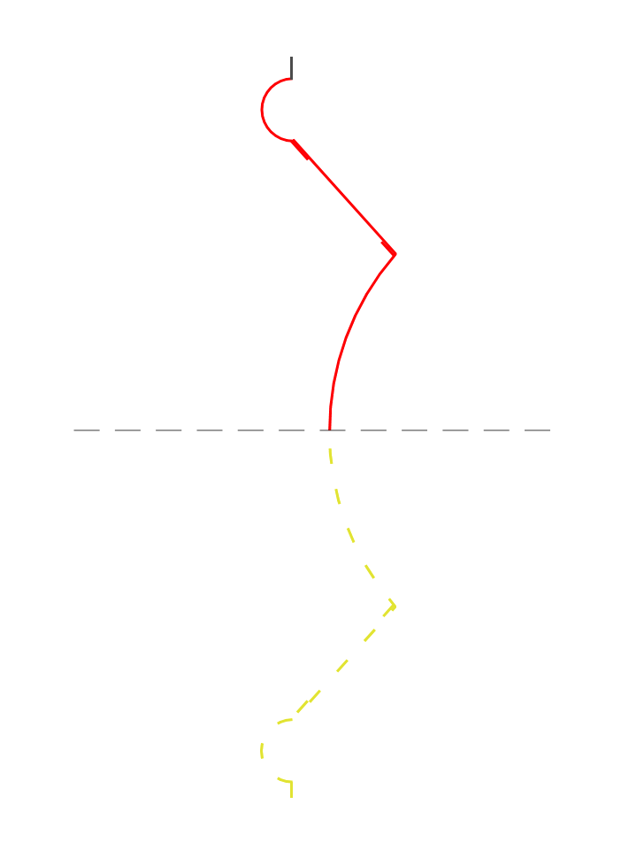

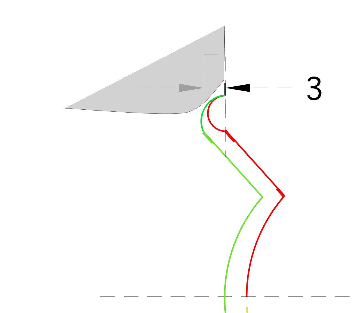

I had a wacked one which I dissected and together with the product drawing I made the profile attached. I hope you can read the files - shout if you need something different.
And then the question how the WG is to mate with the driver...?
Xmax/mec = +/- 3mm in picture....
