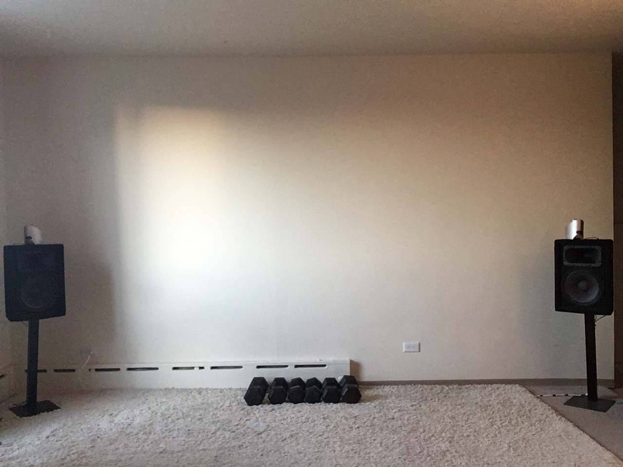

I did, but my system was set up inferior to how it is today so I really can't say. I use a 4K receiver now, so I can no longer use my miniDSP HDMI to add delay to specific channels.
Up until a month ago, I had the 'ambience speakers' (atop the stereo mains, pointed towards the front wall) hooked up as surround channels and ran Dolby Pro Logic IIz in movie mode (movie mode delays the surround channels, music mode does not)
Now I have a 4K receiver so Pro Logic has been replaced with Dolby Surround. I do the same thing but the front ambience speakers are set to 'front height' because I use proper surrounds now. I've set all channels to the PIR curve and reduced the output of the surrounds (DS sets them too high)
I endorse Toole when he says that straight stereo sounds a bit antiquated now. Up-mixed surround sounds better on >90% of my daily music listening. The secret is still having proper waveguides in front, so that the imaging doesn't suffer, and the delayed surrounds add spaciousness, and possibly help imaging. Audyssey XT32 was also a game changer. And of course multiple subs to even out the bass.
Excellent imaging in my room is probably aided by best design practices as well, which include minimal diffraction. As seen in the picture below, save for some dumbbells on the floor, there is nothing between the stereo mains and the listening position.
ps. That wall becomes a 4K 110" screen when the projector is on. Soon there will be a minimum diffraction diy screen with a proper center channel behind it as well.
