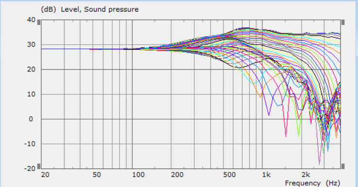

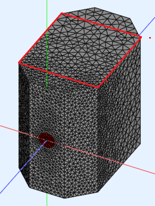

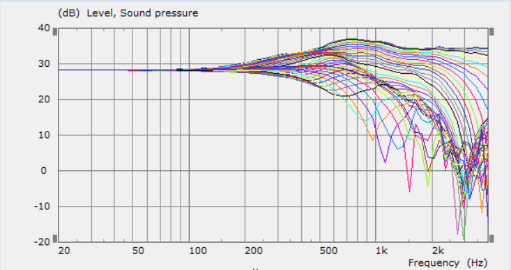

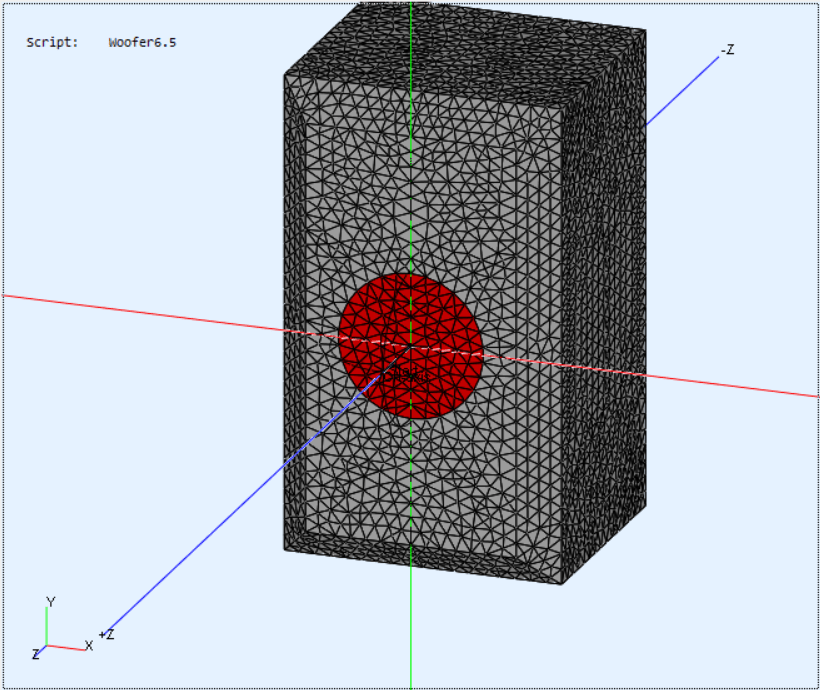

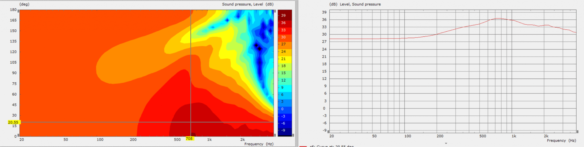

I worked with Fluid to start my own investigation into edge treatment. This is a little more typical than mabat's example above. Nominal 17cm woofer and either 32mm chamfer or roundover.

Is there square corner somewhere?
The box dimensions seem to be amplifying the issue.
This is like a worst case scenario where the driver is a small flat disc with virtually no directivity, the box dimensions are similar in width and depth and both sides being chamfered isn't helping.
Like in the images from augerpro above in many situations the differences between a chamfer and roundover can be much less pronounced

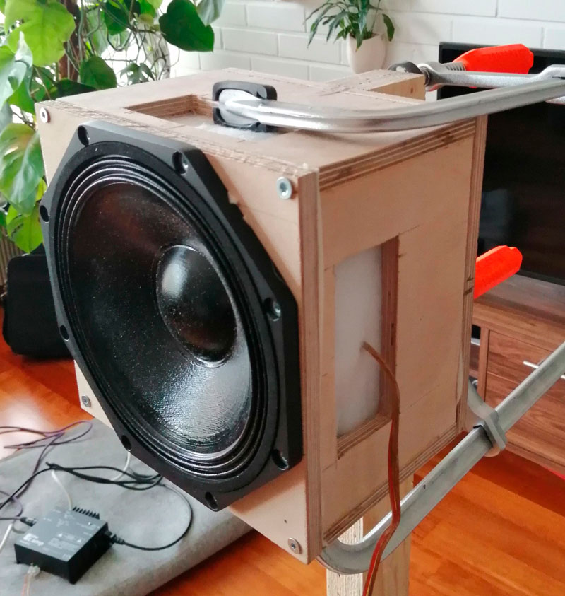

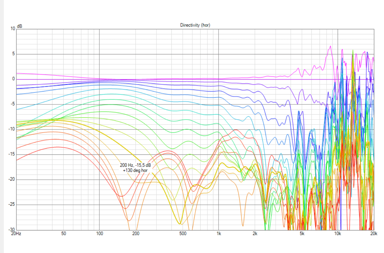

Yeah the d&d 8c for example has nice smooth DI. My box is not as smooth by the looks of the measurement results found online but very nice performance for not much bigger box than the driver itself (8"). There is about ~15db attenuation towards front wall at 200Hz from ~21x21x15cm object, not too bad :) "Flattish DI" around 6db from ~300Hz > 1kHz. Manipulating box internal and external dimensions I suppose one can adjust this more, perhaps deeper enclosure of the d&d 8c is optimized to extend the flat DI part lower than mine is able to. 8c seems to be very well optimized design and worth looking at. I wanted to keep mine as small as possible to make it couple with the wall as high as possible, it is for on-wall speaker system.
Attached is photo of the box on a measurement rig and normalized polar plot in 10 degree increments. Gated livingroom measurements.

Do you mean round box, as barrel or bullet? Why not, go for it, square box is easy to made so went with it. I'm having it identical on all four sides. Dimensions are rather small in comparison to wavelength except you might want to enlarge the outside while keeping the inside small in order to optimize both the (driver) front and back sound as you need to manage both to get them cancel out. Remember, on a dipole system the front and back idealy match each other and cancel very well, a nice wide bandwidth constant directivity. All we chase here is to change the pattern to remove some of the back radiation, right, perhaps have the null at angle we want to? Otherwise just use Open baffle.
You can find all kinds of information how a resistive passive cardioid box works but not much practical info how to actually build one. Like Linkwitz description that draws analog to electrical circuits, but I've imagined the system a lot simpler and never figured out what the resistance is for, for example :D Not sure if this is correct but here is what I've found out, if it helps:
all you want to do is to match the backside and front side response at the aperture (like dipole), perhaps to some optimal direction of your choosing. Count in what comes around the corner from the front, a low passed (bafflestep) with some delay to it. You could sim a closed box with equivalent dimensions to see what it is to an angle. Basically you need to low pass the back signal in order to match the frequency responses of both front and back. Then you'd need the amplitudes be the same (but opposite polarity, as they are) in order to have effective cancellation, maximum attenuation. Third thing is the timing, both should arrive at the port simultaneously, or more closely if nothing was done to the back signal you get dipole and as the back side is delayed the pattern turns from dipole to super cardioid to cardioid and anything between. And of course everything is frequency dependent (due to reflections inside the box and what not).
If you sum up these few basic concepts you'd want the back side sound low passed some, delayed some to account front sound coming around the corner + what is required for pattern, but not attenuated almost at all in order to have effective cancellation. Basically you manage the acoustic path length difference and frequency response but try to not attenuate any extra. This translates to real physical box like so: you'd want to exit all the sound from the box as soon as possible so keep the (inside) box as small as possible and apertures big and free flowing (open baffle performance). You'd want some damping material in order to reduce resonances and reflections inside the box. You'd want optimize transmission through the aperture damping by angling the damping material on the port to make incident angle normal to surface reduce reflection etc, anything to minimize sound from cone to box and maximize sound through aperture. For damping material you need something with suitable absorption coefficients for frequency dependent attenuation which also makes some (group) delay. Then you'd need suitable aperture size to inside dimensions to account some acoustic low pass (in addition what happens in the driver structure already). All these need to be orchestrated to get the frequency response (and delay) match what is outside. To get fine tune the delays you'd probably need to tune the acoustic path length difference. Experiment position of the aperture, as close as possible to the baffle is good start. To increase delay of the front wave, in order to compensate too much delay on the back due to damping and what not, you can mount the driver backside of the baffle like in 8c, for example.
These are easily tested with active cardioid if you wish, in order to get idea what is required, how much delay is required to catch super cardioid response for example or if the back signal is attenuated 6db how it affects the cancellation. You could figure out some metameterial / channel structure to make all this happen inside the box without damping material but at the same time there probably is some resonances going on so you'd want some damping material in there. This in turn adds delay and attenuation, both of which you don't want too much or you cannot reach the performance you are looking for. Getting too much delay and attenuation on the back signal is rather easy, and if there is damping material and additional structure you'd probably overshoot and end up with moot cardioid response. But, if you have both attenuation and structure accurately simulated, you can perhaps use the other to tune/compensate properties of the other to get wide bandwidth problem free response. When you find a system that has little attenuation and not too much delay you'll reach the very useful super cardioidish pattern with great attenuation and constant DI.
Anyway, million things seems to affect and interact but basic reasoning and imagination seems to get quite far. I'm sure simulating all this accurately is a lot of work but perhaps doable. I'm not able to imagine this further and cannot do more elaborate simulations than emulating the simple delays, frequency response manipulation and attenuation in VituixCAD. Hopefully you come up with something nice everyone can use!:D
edit. here is the 8c thread where I have posted all the details, emulations, prototypes, dimensions and though process, there are fluid and others commenting as well with some BEM sims https://www.diyaudio.com/community/...eaker-insipired-by-d-d-8c.369939/post-6763700
I must add I haven't done any distortion measurements of the box and suspect that perhaps at higher SPL levels the apertures would change operation some especially when the melamine sponges aren't glued up to the enclosure, they probably resonate and leak around. Well, anyway, I think this is better performance along with free standing waveguide than closed box mid I had earlier (mid and waveguide incorporated all together with bass to single enclosure) but the latest DIY achievement always sounds the best doesn't it?:) Everyone should do their own research if cardioidish is something that works with their own system and application.

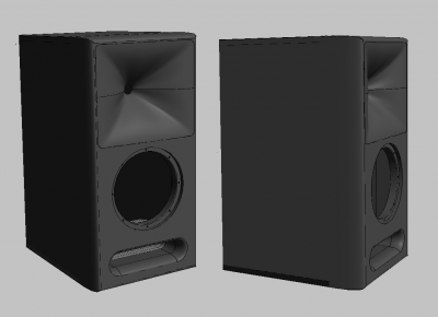

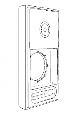

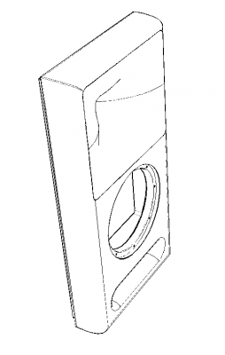

Thanks for the elaboration. Well I'm still working (VERY slowly) on one of my designs which is an all-passive three way. I didn't plan any back radiation utilization but it would be just great if I could make the midwoofer radiate in this manner. Just in idea. Otherwise I would make a whole new design built around that idea from the start, using also a free standing waveguide.
^^^ I suspect there is not much difference between any two well performing systems, or if there is the other works better on some other parameter than the other, for example on the cost. Just make a well performing speaker what ever it is, without obvious issues, and you are golden :) for on-wall application cardioid enables to reduce effect off the wall proximity quite a lot, at least in theory. Haven't confirmed by measurement, sims and listening seems good. Above frequency where the speaker is not close enough the wall to be within 1/4 wavelength it has attenuation south of -15db towards the wall specular reflection point greatly reducing its consribution. Aproaching in wall system but with toe-in, and without taking down the wall! All in all, direct to reverberant sound is increased as DI is elevated down to Schroeder.
Reactions: 1 user
Exciting looking design!

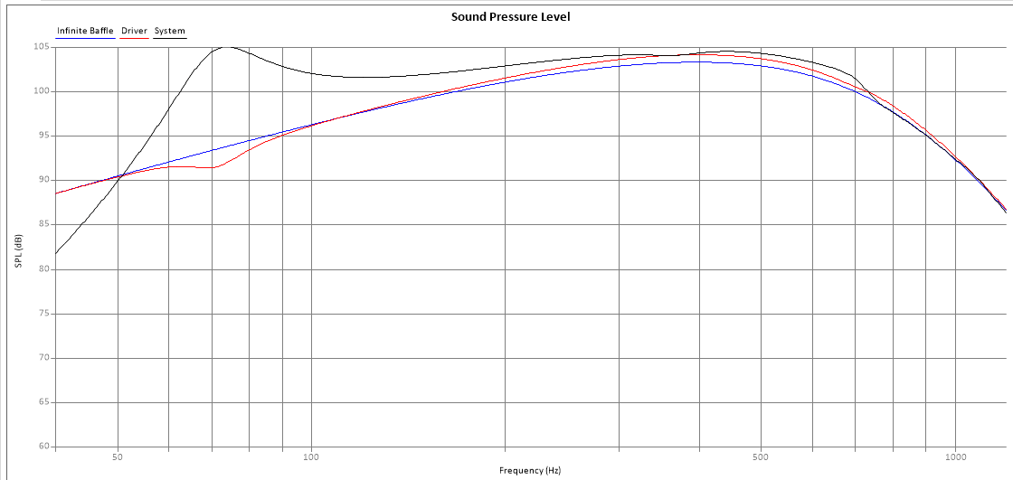

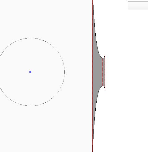

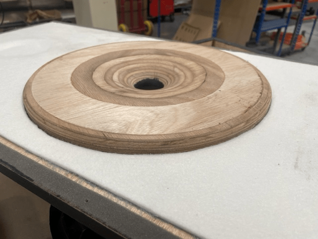

I've gone for a rear 2.8cm deep exponential aperiodic port. I use a machined open cell rigid foam (35kg/m3) to fill the grey highlighted volume. This port is directly behind the 12P80ND.
