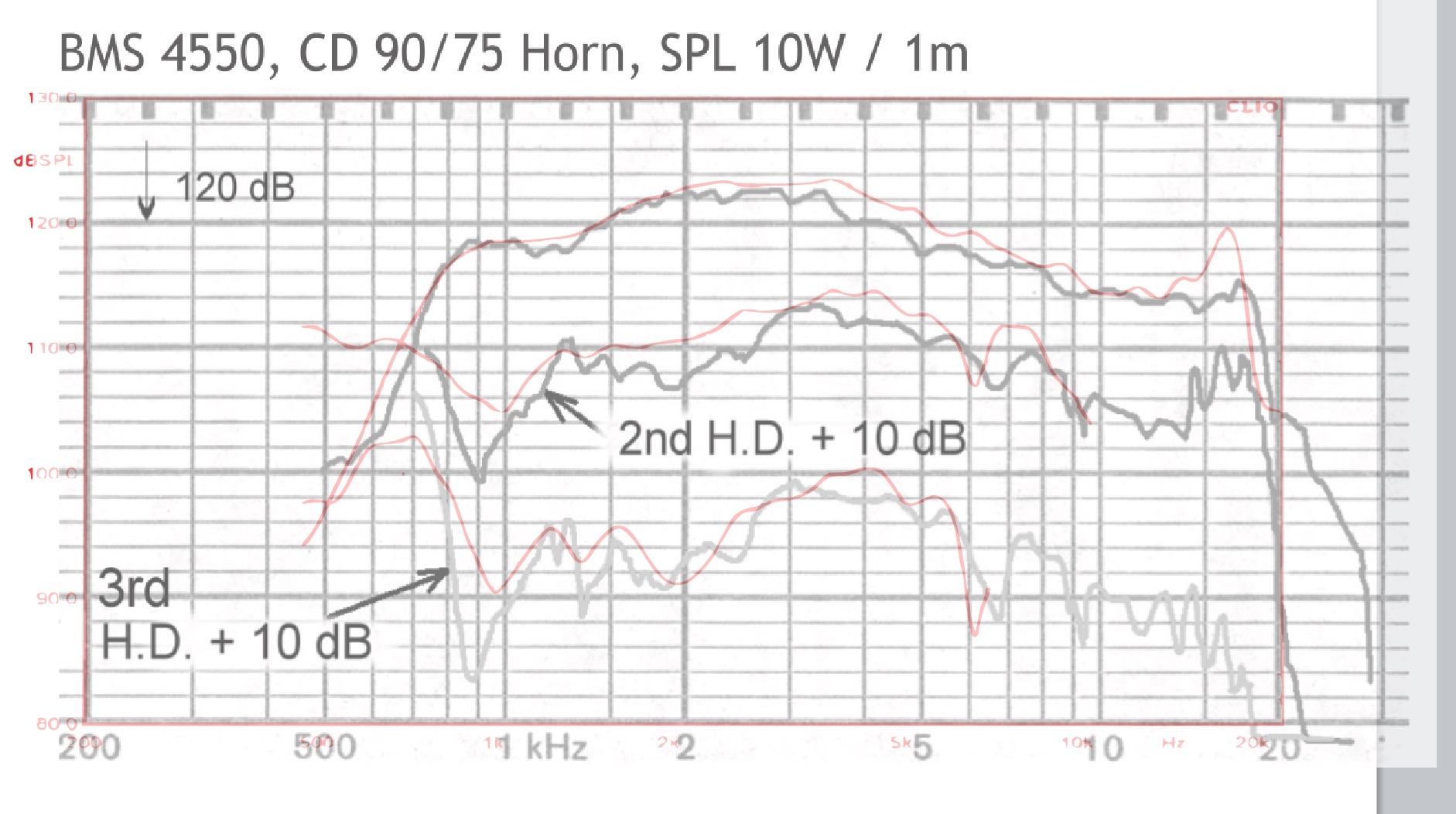

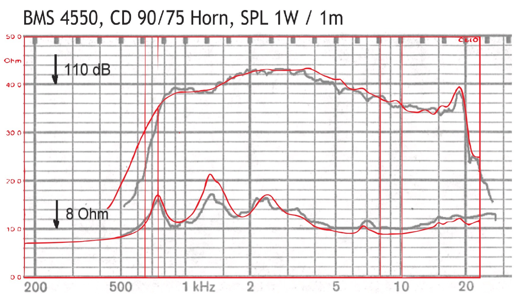

"My" BMS 5530 is not there but it seems that BMS just tried to do a small 4550 with the 5530? Would have been nice to see the Kartesian in this kind of comparison.
5530 in red below... the new employee (?) at BMS didn't bother to change the sound card to 96 ksps for the 5530.... :-/ lame!
The 18 Sound NSD1095N I haven't really checked out...

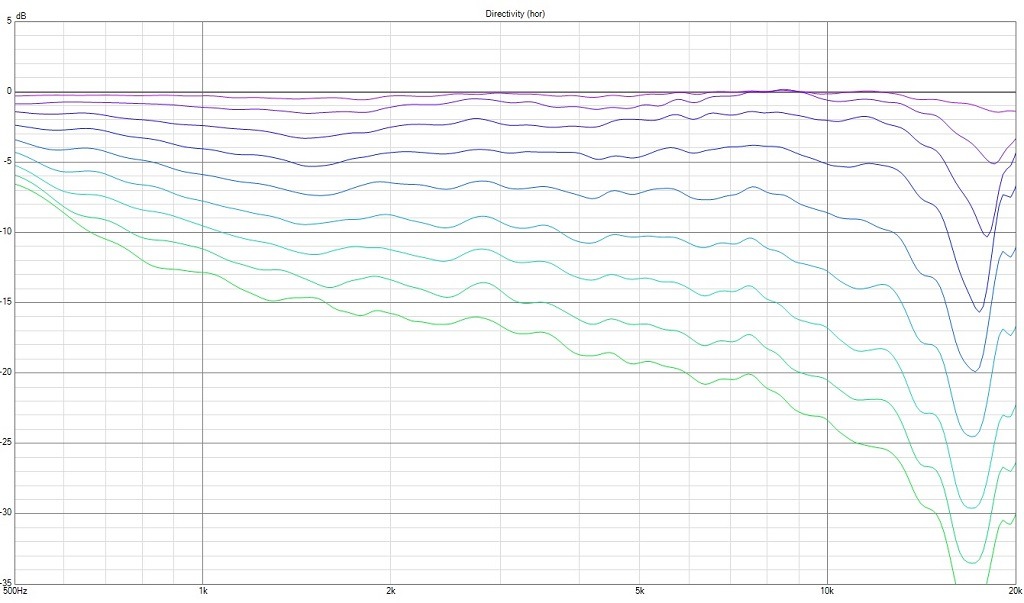

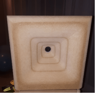

How about printing it? 😀

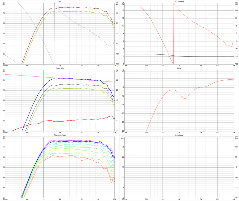

What is the matter with phase extraction from VCAS? Fluid said there was an LE script needed. How would LE be recalculated and can it be done "by hand", like in a calculator as in that of VCAD? Why I ask is, that my latest, lucky discovery only works due to the location and dimension of the vertical nulls. With the data extracted from VCAS, the nulls just take take away the excess energy which the widening of the pattern creates and therefore balance the listening window with SP and DI further down. If I could, I'd like to verify this before printing.
I also plan to look at the phase extraction closely, it should be possible. I only don't see what has a LE model to do with it. Both phase and amplitude are defined at the source (with or without an LE model, it shouldn't matter). A phase everywhere else should be simply related to the phase of the source, plus the propagation delay (which can be compensated afterwards - globally). A believe a complete set of complex polars can be exported for a further work in a crossover simulator, with the correct relative phasing needed.

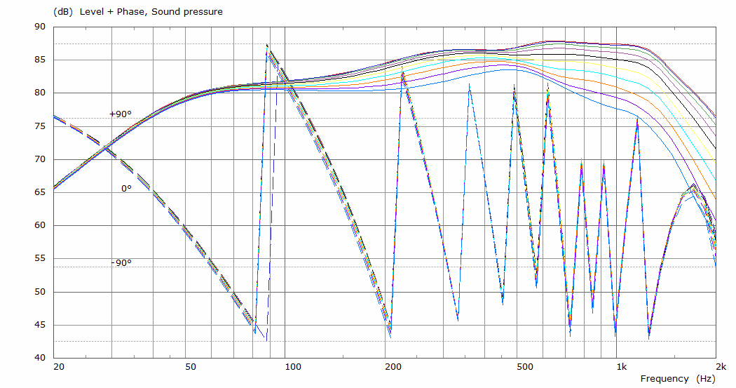

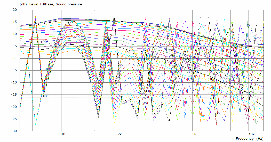

Using an LE script that gives driver rolloffs at either end makes for cleaner more realistic phase traces in VACS, it might not be necessary but it seems a good idea to me. Removing the propagation delay would still be necessary.

OK, but the point is that it shouldn't really matter. The final result should be the same either way, i.e. it's not necessary (and it certainly should not do any harm either). You show two different frequency ranges.
- On the pictures above, the connecting lines are of course rubbish but the individual points should still be correct - that is what's important.
