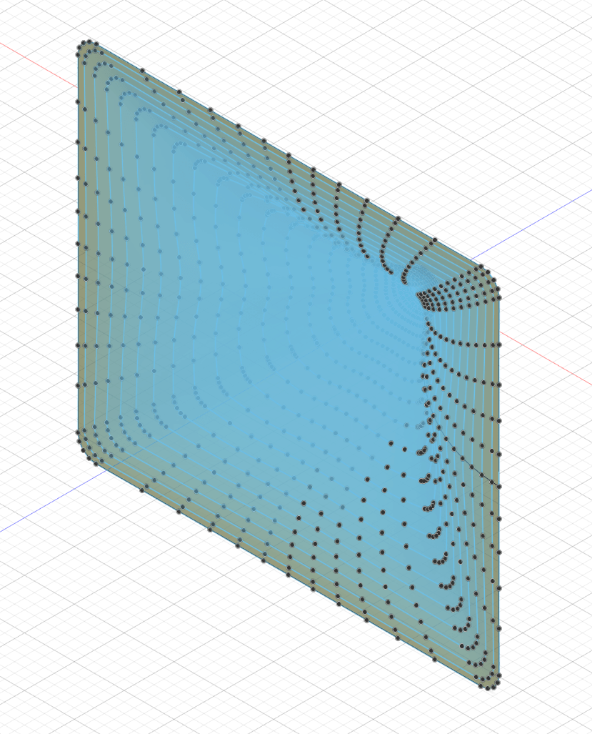

For axisymmetric devices the afp file option works best with it's associated plugin. For non axisymmetric devices the Grid export options and plugins is needed. Which one are you trying to use and how far have you got?
I tried a non axisymmetric (the Tritonia) and curve export. Got me a lot of dots in Fusion 360 but nothing further. I'll try it again in the next few days with grid export.
This is what I used in the config file for Tritonia
Code:
GridExport:f360 = {
  ExportProfiles = 0
  ExportSlices = 1
  Scale = 0.1
Then use the Ath4_SurfaceImport script and you will get this, turn all the sketches off to see it better, reverse the normal of the surface to make the waveguide surface the front. If you use Curves Import you will have to loft the sketches manually.

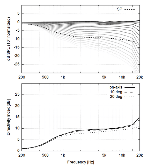

But you can't flatten a diffraction - that's why we try to avoid them in the first place. (Well, you can, but only in a very limited subset of the whole space, which is worthless.). For all the crossover/EQ work, always measure far enough from the mouth (>1m).
- Think of normalization simply as an EQ, which it really is. The amount of the EQ is equal to what it takes to make the selected curve a flat line - if you normalize the curves to 10°, you in fact apply an EQ equal to the difference between the 10° curve and a flat line to all the curves (which effectively makes the 10° response a flat line and all the other curves showing the relative difference from the 10° curve).

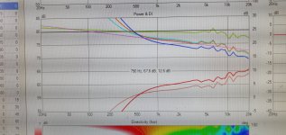

How important is early reflection directivity index in relation to the sound power directivity index? From alot of klippel measured, higher end speakers with waveguides, they show an ERDI about half that of the DI in terms of dB. Is there any design behind this or does it just naturally correlate with DI? From my understanding its a measurement of how spread out the directivity is: from all the sound power existing in a certain beam width, with zero sound power outside this beam width, to as smooth a change from 0° to 180° as possible, with both scenarios having the same directivity index, is this correct?

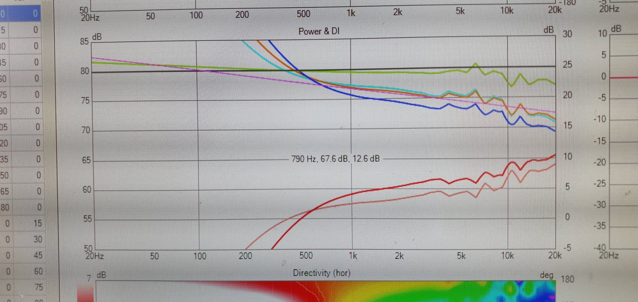

I've attached a VituixCAD window showing the DI and ERDI, red/light red, should I bother trying to further optimise for ERDI and lower it?
My assumption would be to keep ERDI as low as possible without effecting the listening window, as you don't want all your reflections to come from a specific place and rather everywhere, to get a better atmosphere, and less intrusion on locational information.

ERDI will almost always be lower than SPDI because it is computed from axes that are closer to the direct axis sound. As you move further away from the main axis the slope of the curve gets steeper. The difference in slope will correspond to the difference between the early reflections curve and the sound power curve. The more omnidirectional the speaker is the more closely those curves will be to each other.
The curves describe what is, if a specific directivity is desired then they will indicate whether the result is moving towards or away from the target.
Sound power is the total radiated sound of the speaker in all directions, so by definition it cannot be concentrated. DI curves show the difference between two curves, SPDI being soundpower and listening window, ERDI Early reflections and listening window. The higher the DI the more directional the speaker is, the more the sound is concentrated in a particular direction. For both curves (ERDI and SPDI) to have the same DI the speaker must be completely omnidirectional otherwise there will be a difference.
The difference between them can also be due to asymmetry of the horizontal and vertical axes. Because CTA 2034 treats vertical and horizontal equally in terms of weighting, any asymmetrical waveguide, for example an elliptical one will show a more steeply rising overall DI. The Horizontal only may have a flat DI, but both together show a steep rise towards higher frequencies. You can also check the Horizontal only DI's in VituixCAD.
If you want your speaker to be more omnidirectional then lower the DI if not don't 🙂
The difference between narrow directivity and less early room interaction vs lower directivity and more early room interaction is quite a personal choice. There are trade offs to be had either way and your exposure to different rooms and systems and preferred musical genre for listening can play a large part in which side of the fence you land on, one is not intrinsically better than the other.
If the radiated power was all concentrated to the listening window only, ERDI would be low (theoretically zero but that can hardly happen), even if DI was high (and it would be high in such case). There seems to be a big difference in how these two are actually calculated:

Look at the top chart below, the "SP" is the power response curve. What it actually shows is a frequency response of an ideal omnidirectional source that would radiate the same total power as the examined device. So the power response is real, only its presentation is related to an imaginary source.
The DIs, e.i. the bottom chart, then show how the device deviates from omnidirectional (the differences between selected polars and the power response curve).

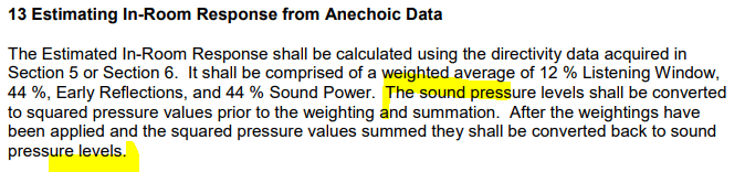

That is not how I read what the standard says. I was trying to be helpful but that does not seem to be working. Below a direct quote to avoid misinterpretation.
"Sound power represents all of the sounds arriving at the listening position after any number of reflections from any direction. It is the weighted rms average of all 70 measurements, with individual measurements weighted according to the portion of the spherical surface that they represent. Sound power is a measure of the total acoustical energy radiating through an imaginary spherical surface with the radius equal to the measurement distance. Thus the on-axis curve has very low weighting because it is in the middle of other closely adjacent measurement points (see the perspective sketch at the top of Figure 1) and measurements further off axis have higher weighting because of the larger surface area that is represented by each of those measurements. Ideally, such a measurement would be made at equally-spaced points on the entire surface of the sphere, but this simplified spatial-sampling process turns out to be a very good approximation. The result could be expressed in acoustic watts, the true measure of sound power, but for the purposes of this standard it is expressed as sound level, frequency response curve having the same shape. Any bump in the curve that shows up in the other curves (on-axis, early reflections, etc.) and persists through this ultimate spatial average is a notable resonance. Calculation of the sound power curve begins with a conversion from dB to a scalar magnitude. The individual measures of sound pressure are then weighted according to the values shown in Appendix C and an energy average (rms) is calculated using the weighted values. The final average is converted to dB."
