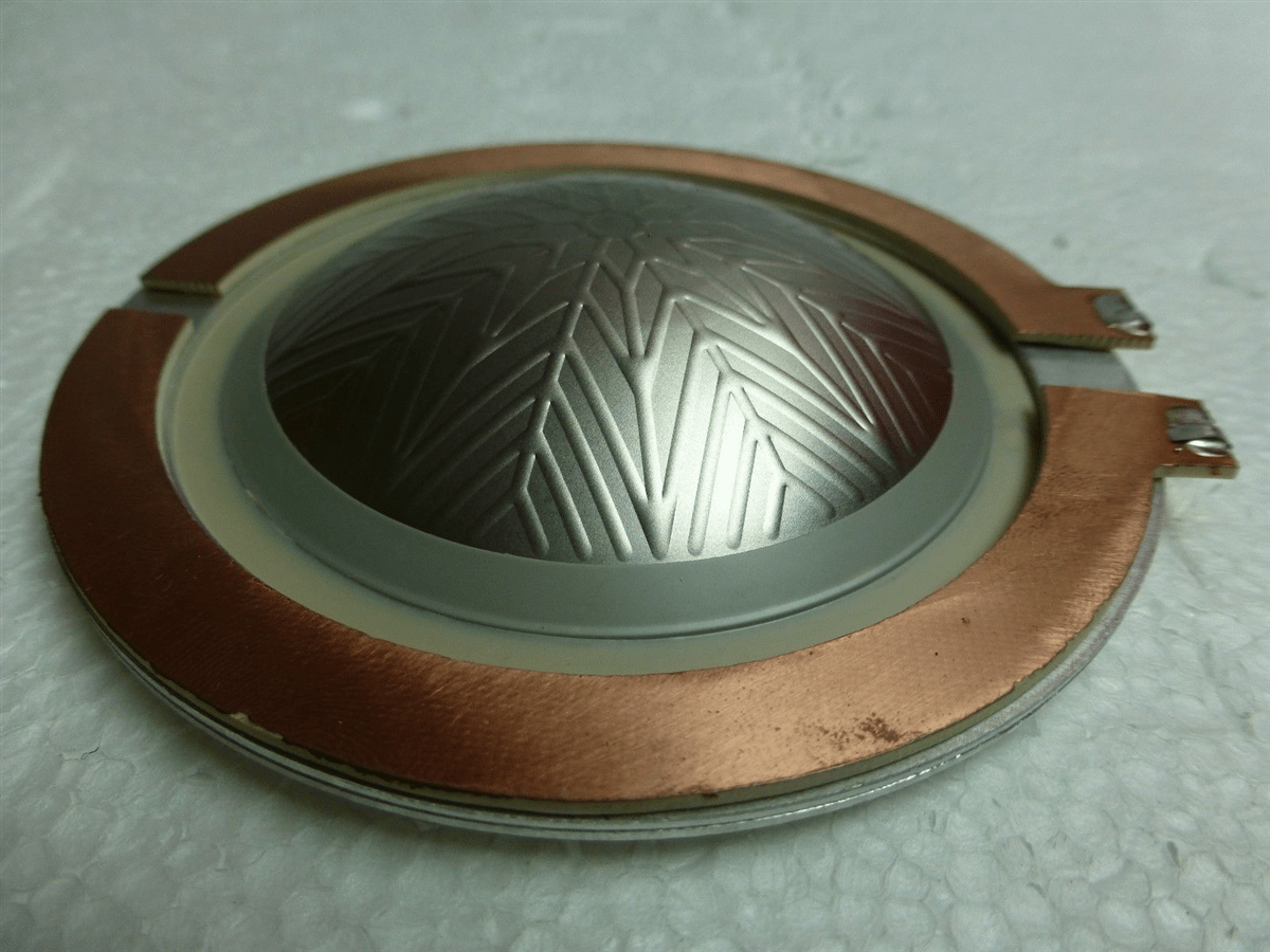

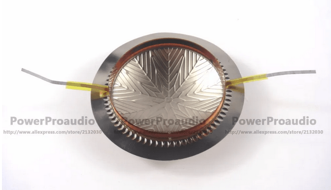

Mylar would be better.BTW, it's possible to buy the sole diaphragms+coils for (e.g.) the D2500Ti. What could one expect when clamped this between two rubber rings? Wouldn't there be some advantage over the stiff surround for home use? That's what I intuitively feel but maybe it's not a good idea (?) so it's not even worth a try.
This looks like it, but it's the 3" brother:
Aftermarket alternative (1.75"):

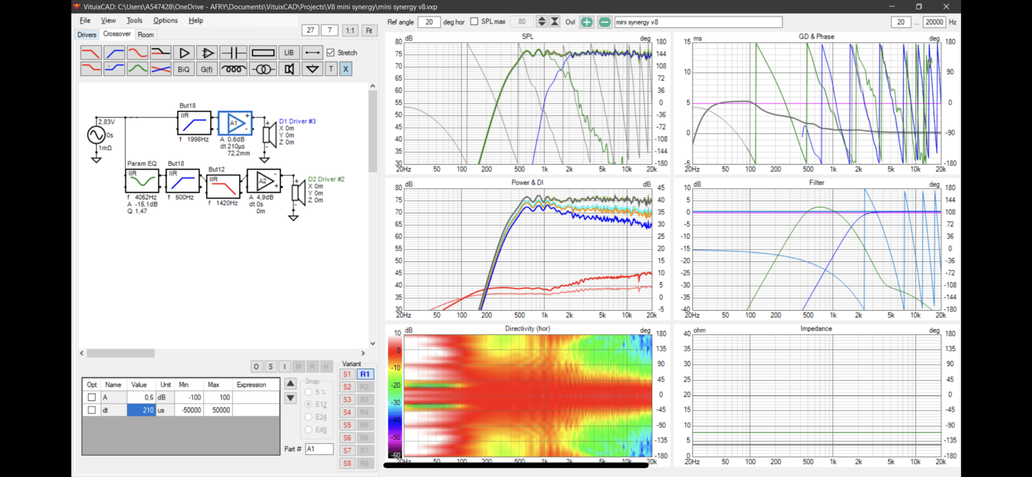

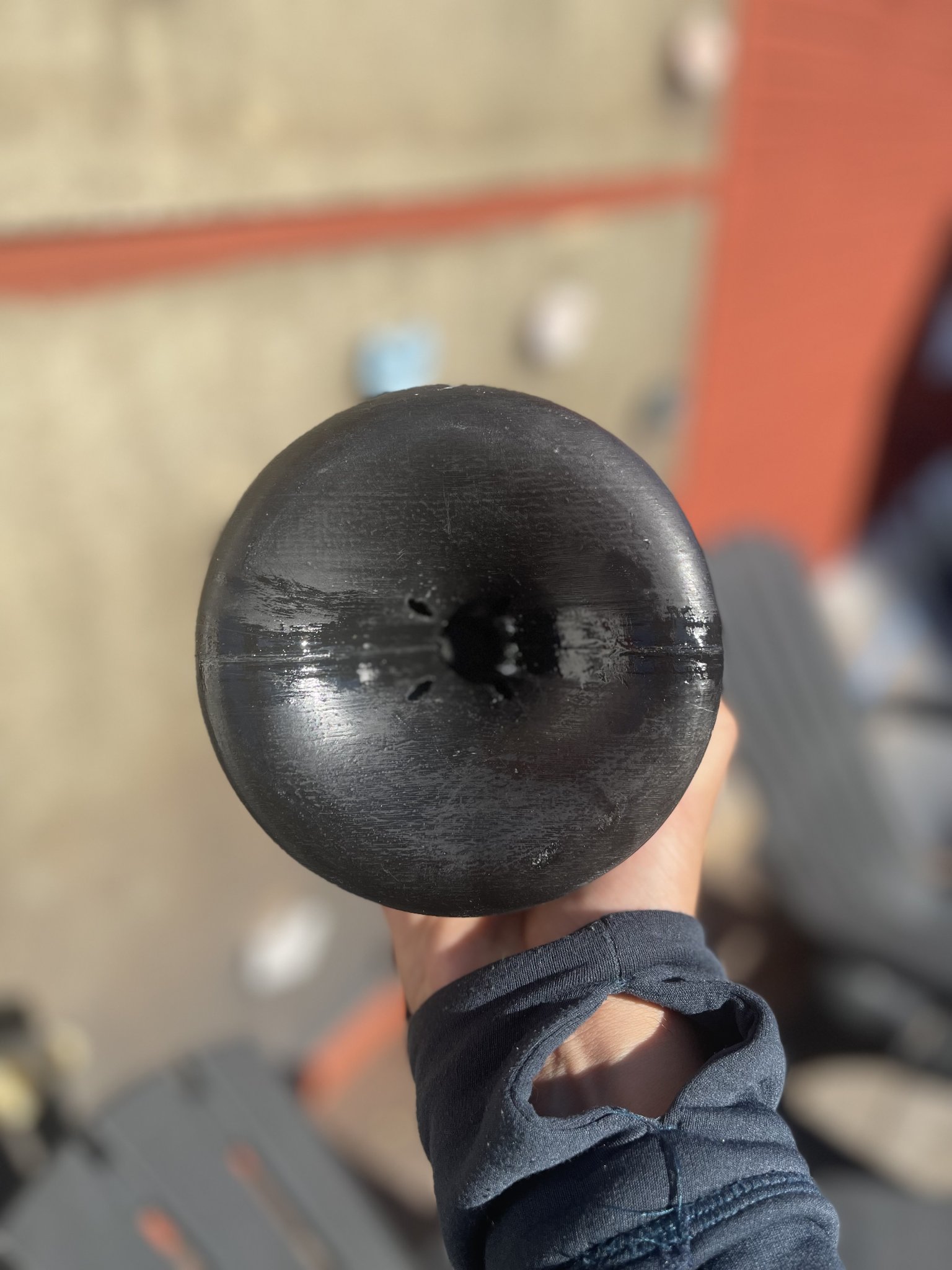

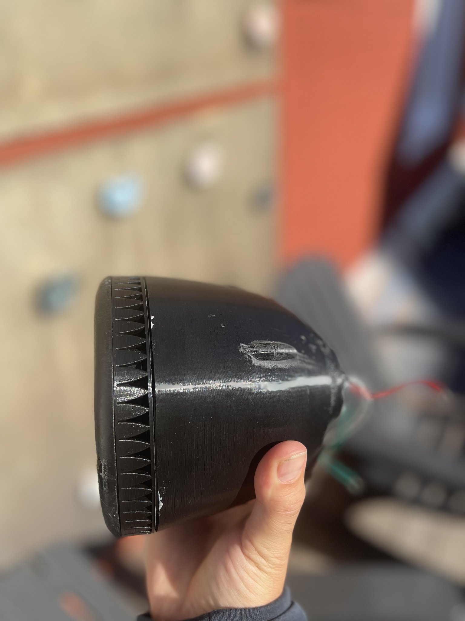

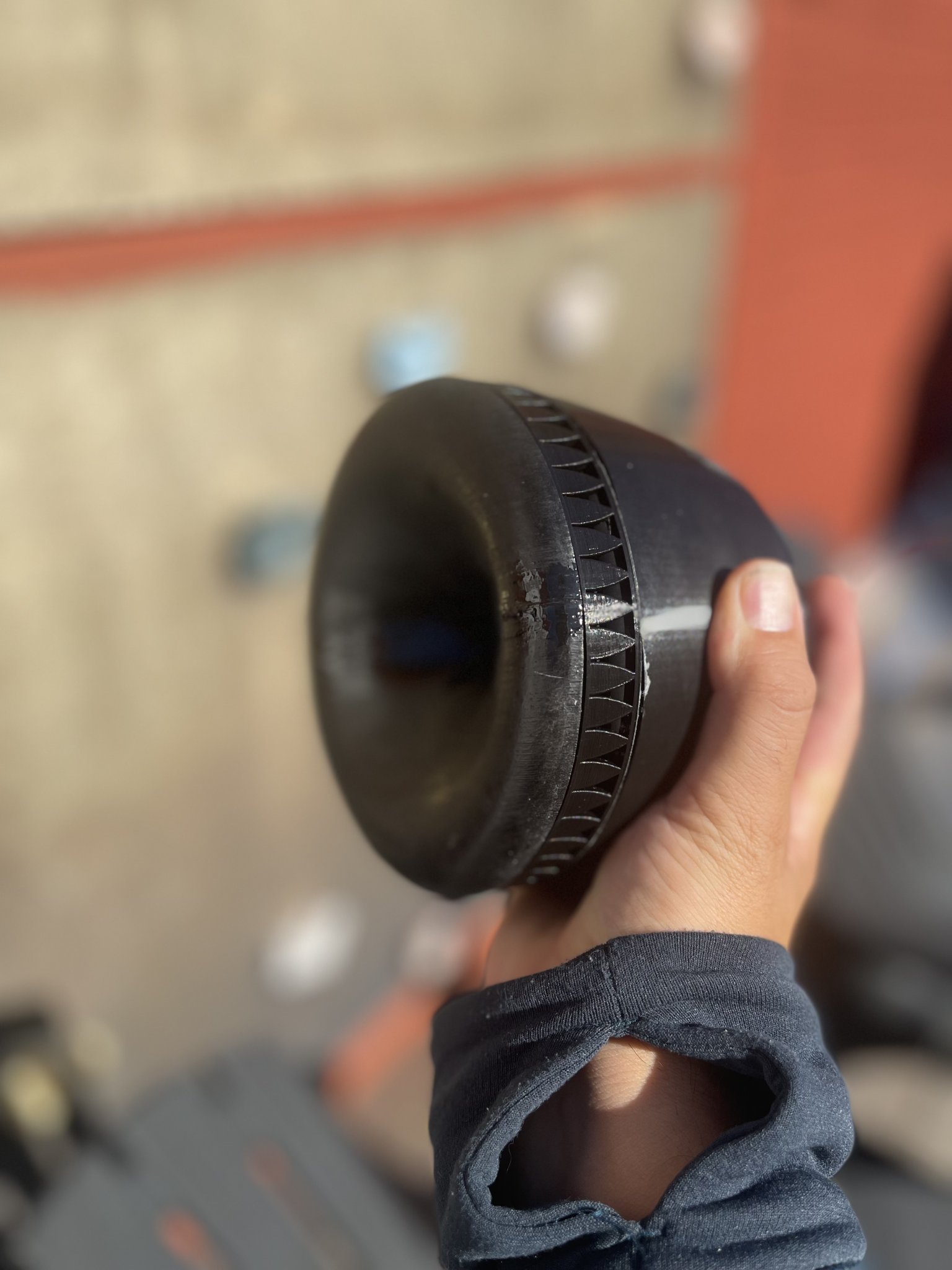

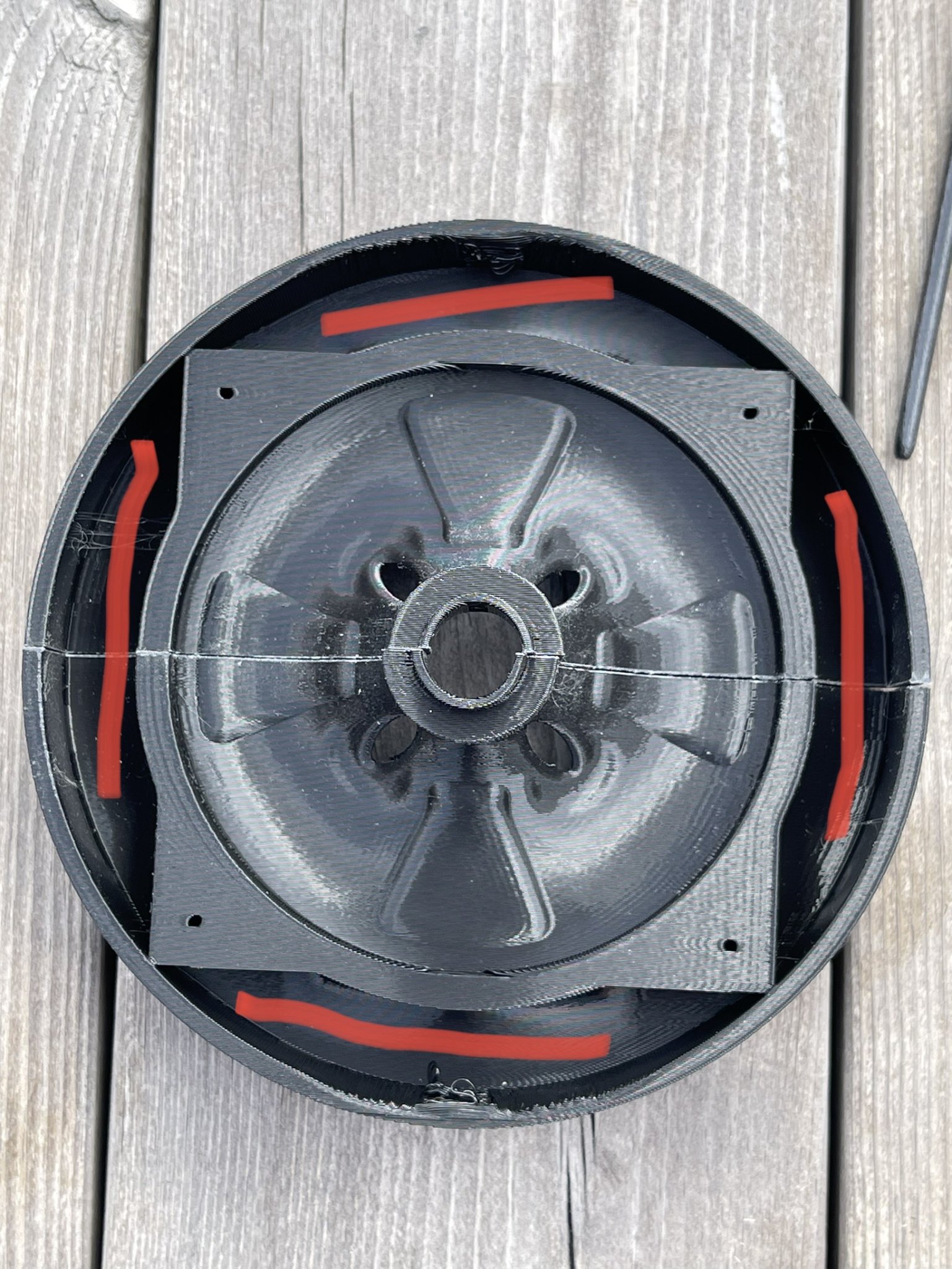

This is where I’m at with the little one.
Close, but not done yet.
I’m so curious and hopeful about it.
I assume this is a passive cardioid design.
Sidelobes in the 1k region might be caused by resonances in the enclosure.
Playing around with damping material behind the cardio ports might improve things.
Super nice design!
Super nice design!

You’re assuming right and you are exactly right on what the plan is for the future.I assume this is a passive cardioid design.
Super nice design!
There is melamine foam in the whole back enclosure, but nothing between the cone and the opening on the sides. So the space marked in red is next to be experimented on.

I use Really from Kvadrat for the resistive ports.You’re assuming right and you are exactly right on what the plan is for the future.
It's pretty flow resistive 70% fabric and 30% polyester compressed material and does a perfect job.
https://www.kvadrat.dk/en/really/solutions/textile-felt
A good exercise is to do a close mic measurement of what comes out of the ports.
You only want sub 1000 Hz frequencies, since the horns takes care of directing everything above that.
When high frequencies come out of the ports they mix up with what comes out of the horn and create the pattern you see.
It's quite nice already!
Just find something with more flow resistivity and put it there against the holes. Make sure air doesn't go around the material, but through it.
I have a few materials in mind, but was initially hoping that I would be able to print a micro perforated surface that would be more precise and reproducible than various stuffings and flow resistance materials.

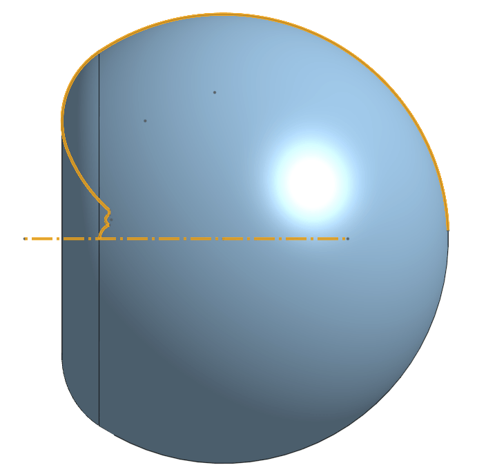

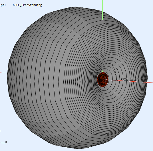

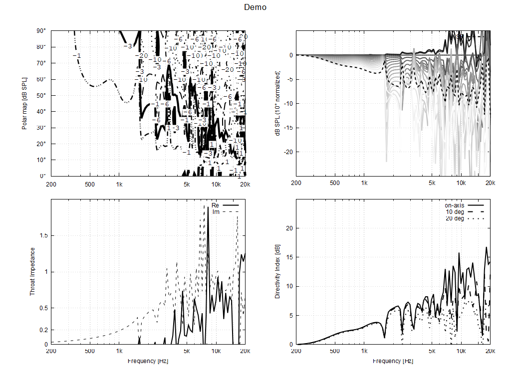

Is it possible to use ATH to simulate a fully "source defined" axisymmetric enclosure? I've drawn a spherical enclosure for a coax driver in CAD but exporting it to Akabak for each iteration feels slow. Simming a quadrant seems to work though I can't seem to input arcs in the rear correctly ("control points are not cocircular" no matter what I do) but axisymmetric would of course be nicer
It's possible to add a user-defined rear spline (cubic Bézier) to a waveguide (with or without a user-defined source, that doesn't matter):
https://www.diyaudio.com/community/...-design-the-easy-way-ath4.338806/post-7228432
If it's axisymmetric, I'd suggest to use an axisymmetric model as well, it will be much faster.
Problem is, I also have the waveguide user-defined. I can match a small R-OSSE and a Bezier to the coaxial profile but it's kinda burdensome and I keep failing to make the Bezier work from the Desmos script anyway...
It seems I got axisymmetry to work though with the whole thing user-defined, and meshing problems I had are gone. The enclosure in ABEC however looks pretty rough to me and there doesn't seem to be a way to control the resolution. Not sure if that's screwing up the results or if I'm missing something else...
The looks don’t matter, axisymmetric is very high resolution.The enclosure in ABEC however looks pretty rough to me and there doesn't seem to be a way to control the resolution.
In my experience, resolution is normally at the end of the line. For example, 50 in the following line.
point P0 114.3 0 50
You can also control resolution in the mesh statements. (These might not be used in CircSym, I'm not sure.)

Your simulations might be squigly due to your ABEC settings rather than resolution.
; ABEC Project Settings
ABEC.SimType = 2 ; 2= Free Space, 1= Infinite Baffle
ABEC.SimProfile = 0 ; 0 = CircSym
ABEC.MeshFrequency = 33000
ABEC.NumFrequencies = 100
ABEC.f1 = 500 ; [Hz]
ABEC.f2 = 20000 ; [Hz]
I don't always use high resolution for running simulations. I might only increase it to create the STL file for printing. If you post your config file someone could probably show you what to try.
Page 50 of User Guide.
In the CircSym mode the items defining the mesh resolution are ignored. We could leave them without any
effect, delete or just comment them out:
; Mesh.ThroatResolution = 4.0 ; [mm]
; Mesh.InterfaceResolution = 8.0 ; [mm]
Page 51 of User Guide
Figures 24 and 25 show the resulting circular mesh as displayed in ABEC. The number of profile points (P1 -
P20 in Fig. 24) is still controlled by the item Mesh.LengthSegments:
Mesh.LengthSegments = 20
In this particular example it seems high enough but generally the number of points (i.e. number of line
segments approximating the profile) can be increased greatly - we want a high mesh resolution anyway.
So it looks like Mesh.LengthSegments is what matters in CircSym.
