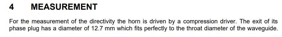

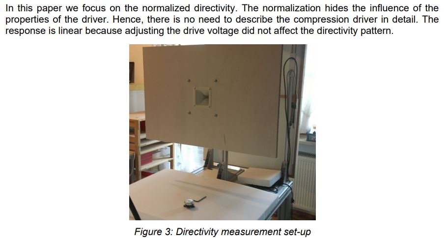

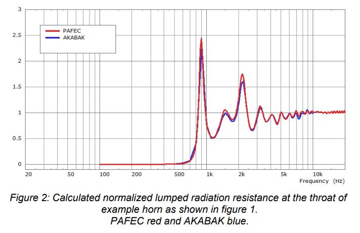

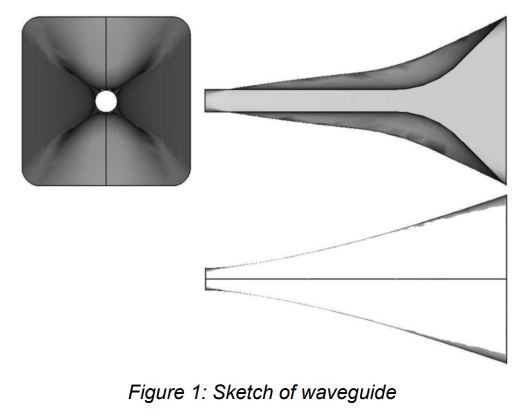

Nov 2023 paper by R&D Team Panzer J, Macey P: Experimental and theoretical investigation of an unusually shaped horn; IOA Reproduced Sound RS39, Bristol UK, Nov 2023
I don't understand any of this. Is R&D trying to figure out how to model a device similar to the LF extension? It places the horn at the exit of the phase plug and examines simulation methods of the throat impedance. They plan further work on modeling the compression driver to simulate absolute pressure values. (PDF attached)
That would be great, as something is definitely missing. I would love to proceed with this as well, but I'm simply not competent enough. It would be great to be able to measure a real driver and make a corresponding model usable for this kind of optimization. Maybe some damping added somewhere in the current models is all it takes, who knows.They plan further work on modeling the compression driver to simulate absolute pressure values.

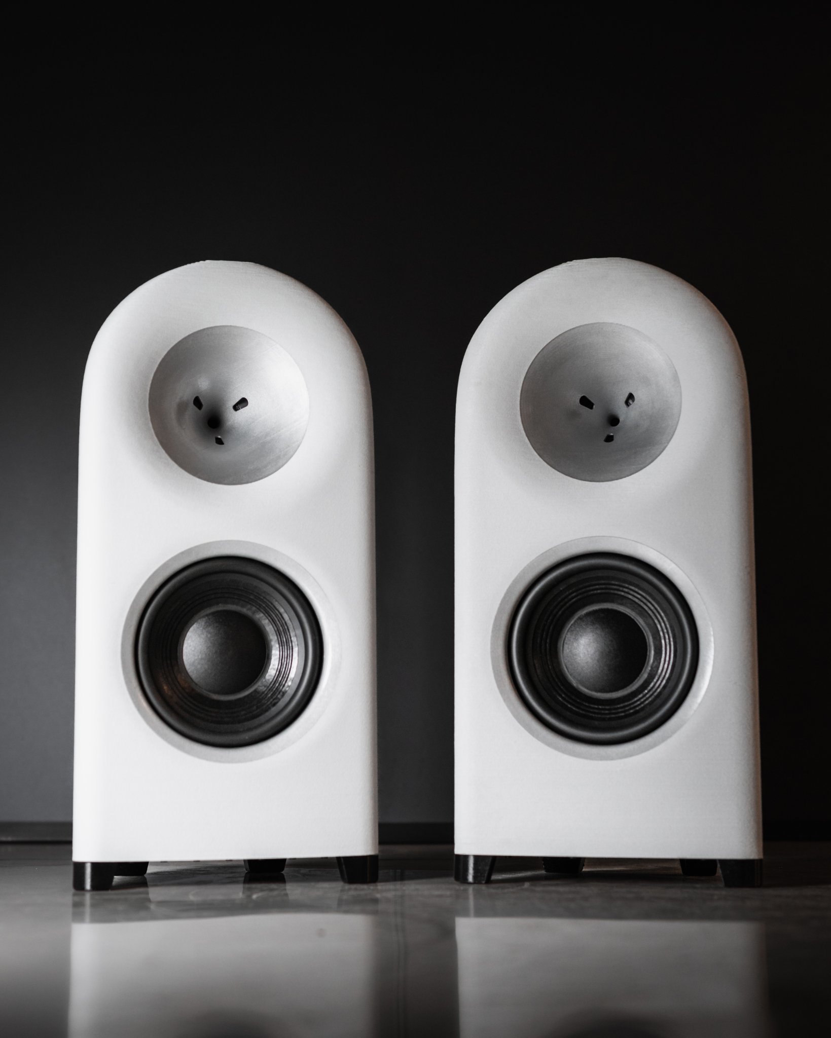

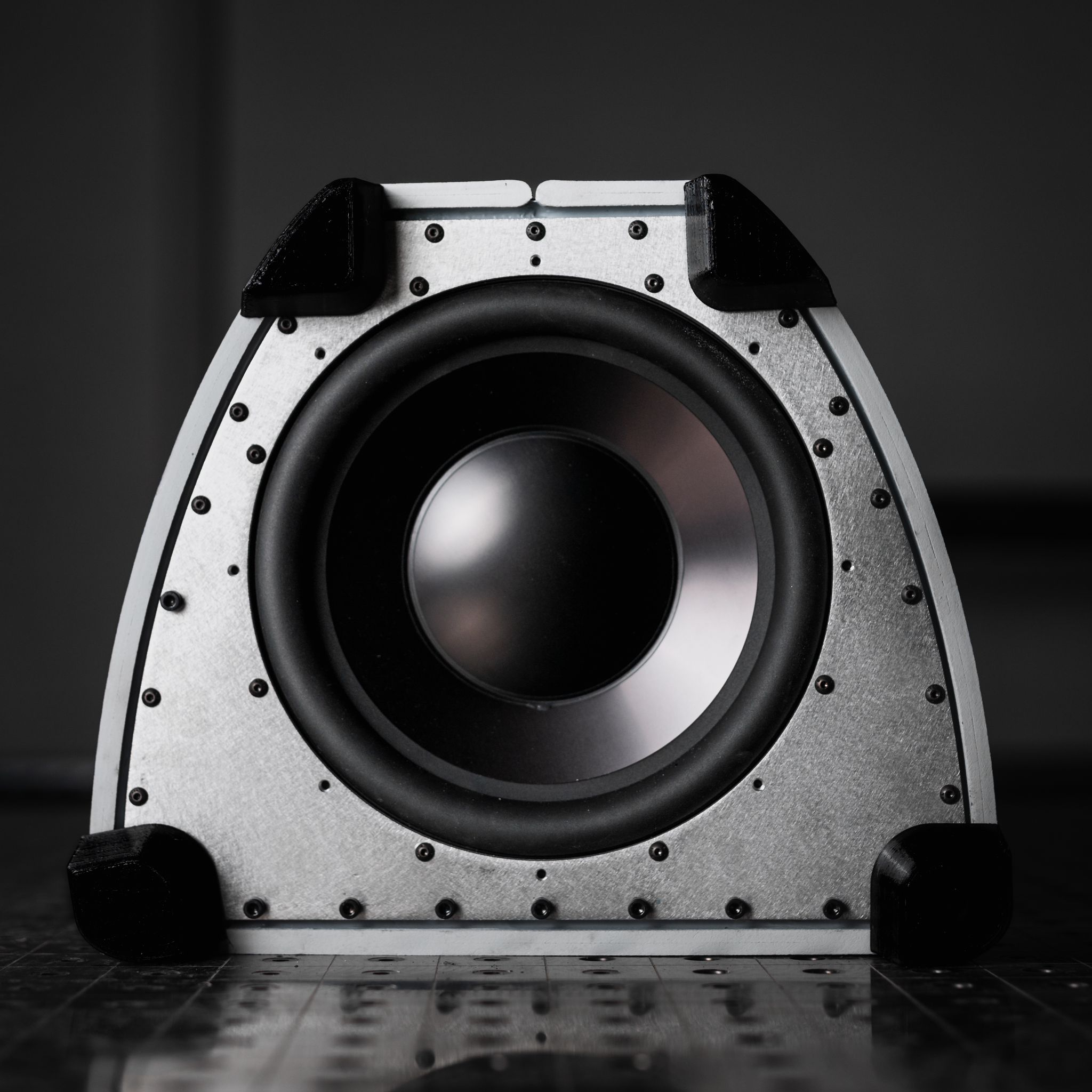

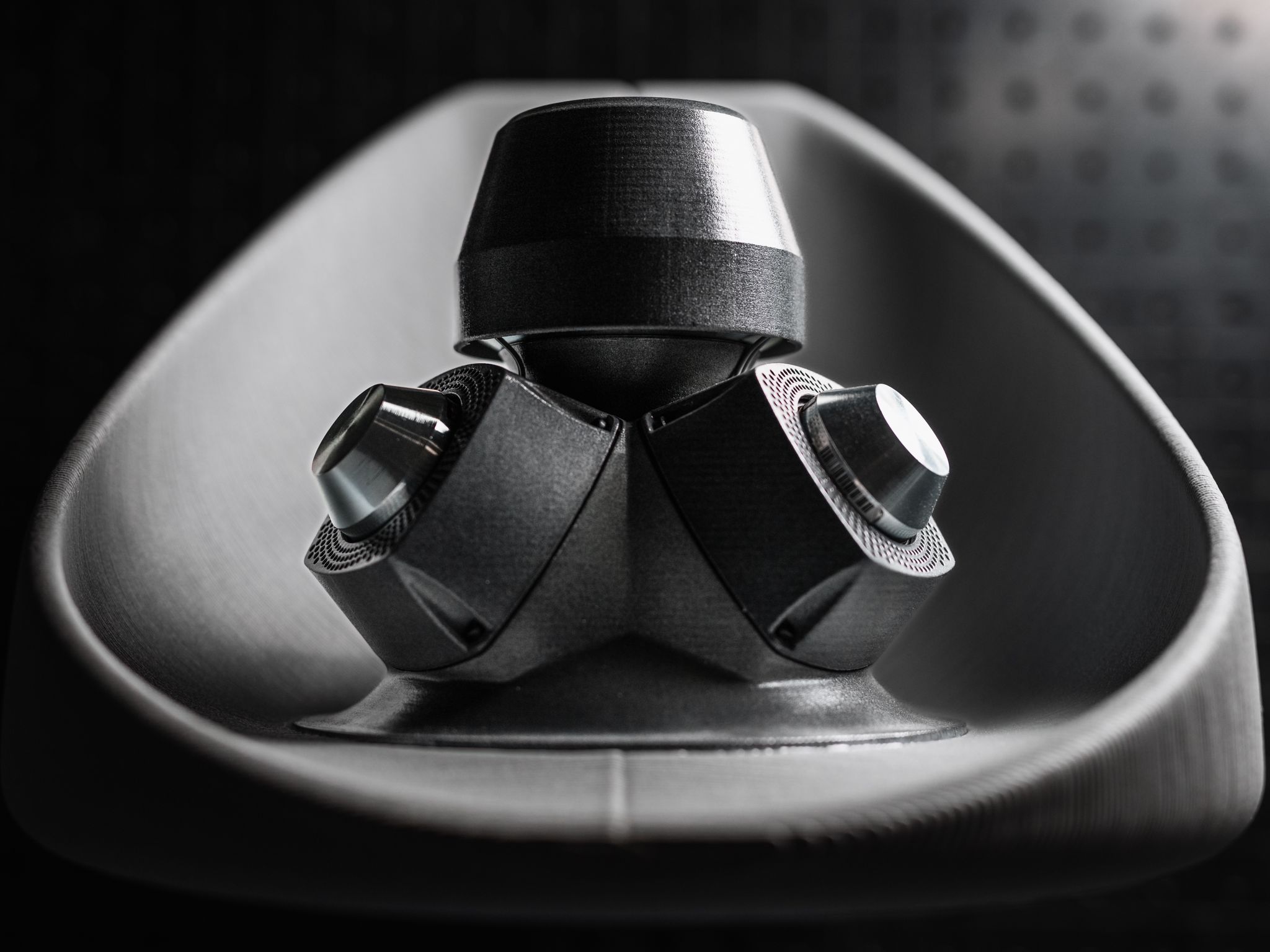

hey, we wanted to share the birth of another ATH MEH horn loudspeaker with you.
A 440mm ATH horn with throat extension was the basis with midrange ports for 3 4" mids. A 12" driver with a 12" passive radiator takes care of the low end. It's a 3 way design with amplification and dsp onboard.
If you'd like to get the .cfg files from which the horn is generated let us know. We can share them here.
We've posted some build details in the ath-practical-way-thread. Thanks @mabat for sharing your work and @bmc0 for your directivity scripts here

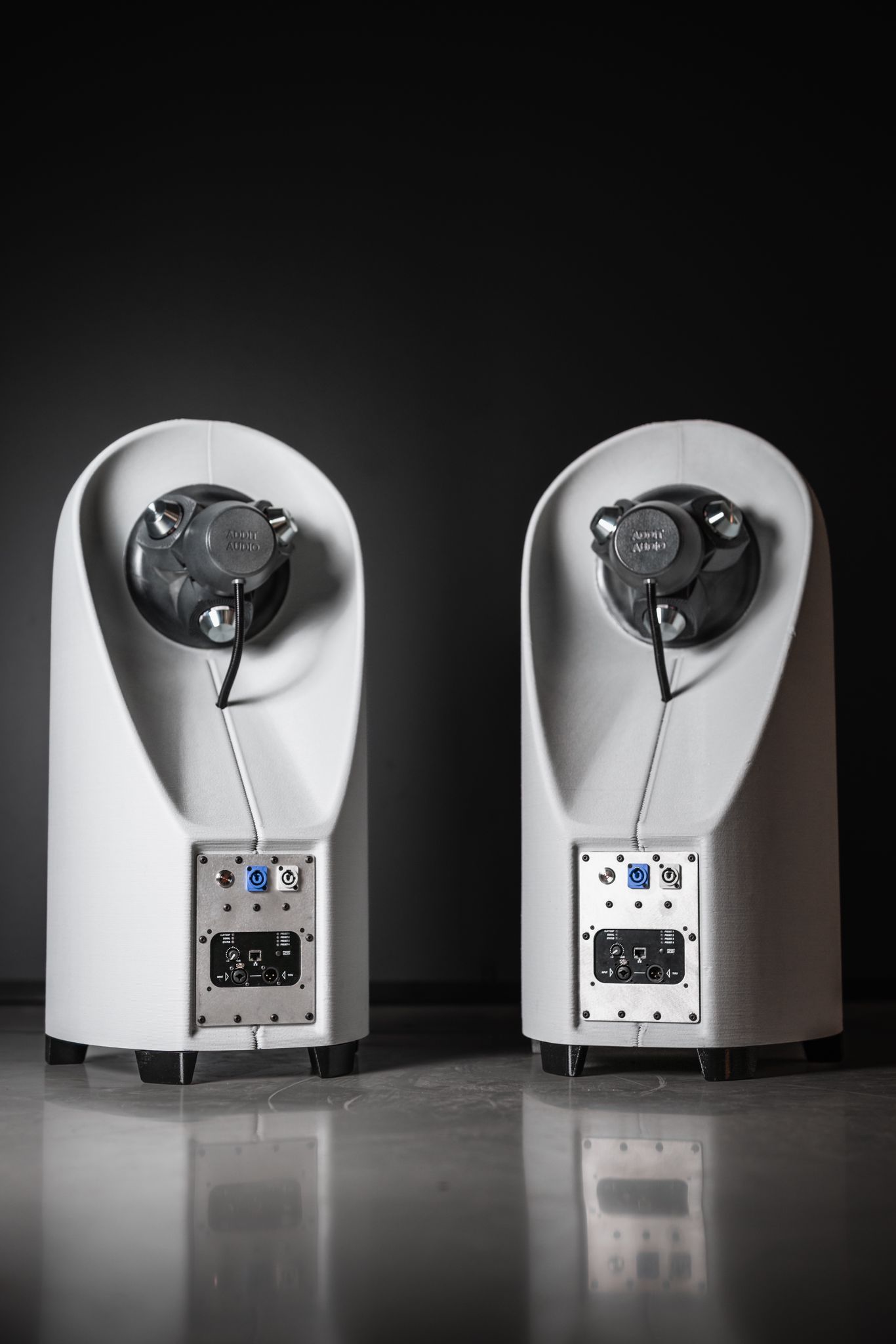

I really like the back of the horn:
It looks like it is autogenerated somehow. It should make the waveguide pretty solid and non-resonant.

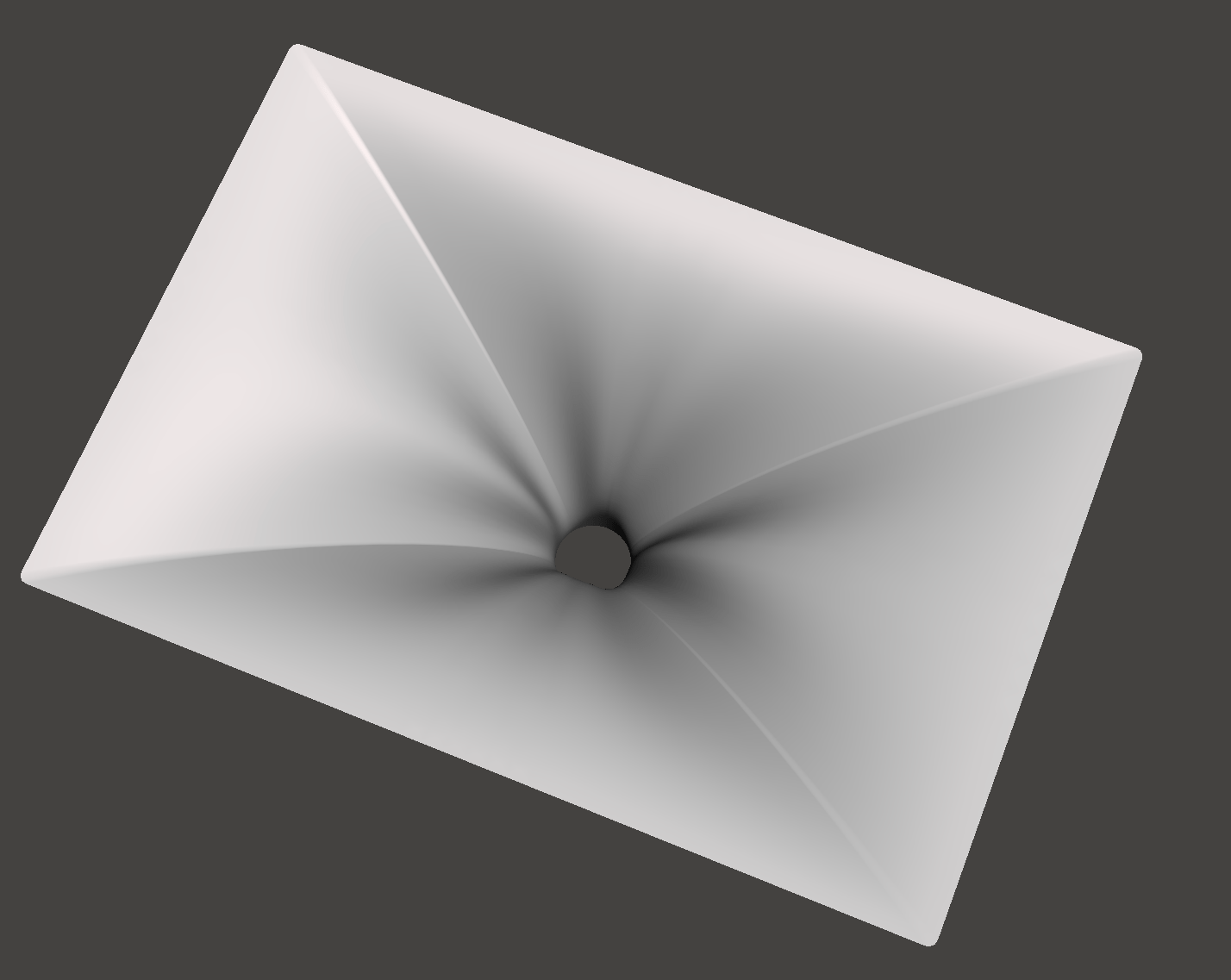

It's hard to believe it's not based directly on my work but I'm sure they would mention it, at least 🙄
Code:
; Tritonia Waveguide-X / Ath script code
Throat.Diameter = 36 ; [mm]
Throat.Angle = 0 ; [deg]
Throat.Profile = 1
Length = 140 ; [mm]
Coverage.Angle = 38 - 20*cos(2*p)^5 - 25*sin(p)^12
Term.s = 0.7 + 0.2*cos(p)^2
Term.n = 3.7
Term.q = 0.995
Slot.Length = 20*sin(p)^4
Morph.TargetShape = 1
Morph.FixedPart = 0.0
Morph.Rate = 3
Morph.CornerRadius = 4
Morph.TargetWidth = 400
Mesh.AngularSegments = 100
Mesh.LengthSegments = 26
Mesh.CornerSegments = 4
Mesh.ThroatResolution = 5
Mesh.MouthResolution = 10
Mesh.InterfaceResolution = 8
ABEC.SimType = 1
ABEC.f1 = 400 ; [Hz]
ABEC.f2 = 12000 ; [Hz]
ABEC.NumFrequencies = 40
ABEC.MeshFrequency = 1000 ; [Hz]
ABEC.Polars:SPL_H = {
MapAngleRange = 0,90,19
Distance = 2 ; [m]
ABEC.Polars:SPL_V = {
Distance = 2 ; [m]
Inclination = 90
_ABEC.Polars:SPL_D = {
Distance = 2 ; [m]
Offset = 145
Inclination = 42
Output.STL = 1
Output.ABECProject = 1
Report = {
Title = Tritonia-X
PolarData = SPL_H
Offset = 145
NormAngle = 10

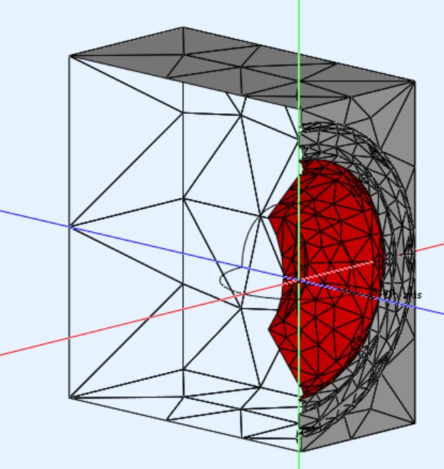

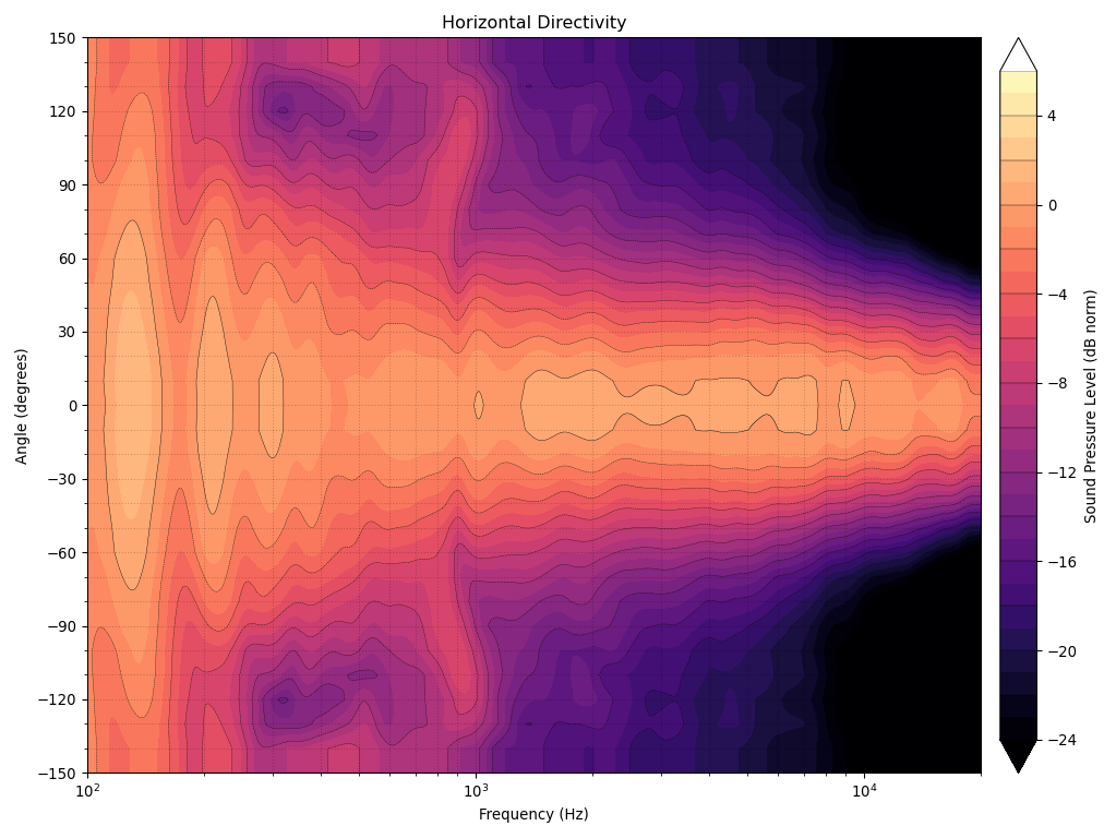

I wonder how they managed to get away without any traces of baffle related waist-banding or if their sonograms are taken from the biggest 15"/40 cm device.
These are from @NicoB who uses COMSOL, so it is quite likely that COMSOL tweaked the geometry to match a targetIt's hard to believe it's not based directly on my work but I'm sure they would mention it, at least 🙄
https://www.diyaudio.com/community/...nd-bem-simulation-results.382115/post-7508971
Confirmation: the sonograms show a 44 cm wide device. Very good for a wide baffle approach as with the Grimm Audio LS1. And at the same time benefiting from a narrow pattern: would be interested to see a 120 degree device, especially on a narrower baffle like 30 cm or so.

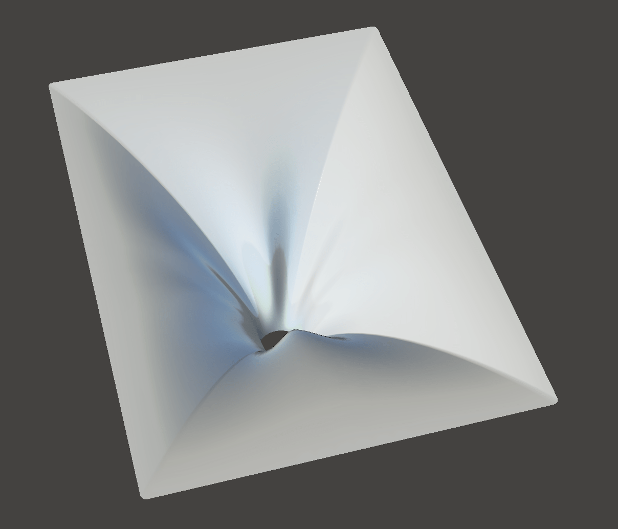

That's just how Tritonia waveguide behaves:
https://www.diyaudio.com/community/...-design-the-easy-way-ath4.338806/post-6541384
https://www.diyaudio.com/community/...-design-the-easy-way-ath4.338806/post-6548452
