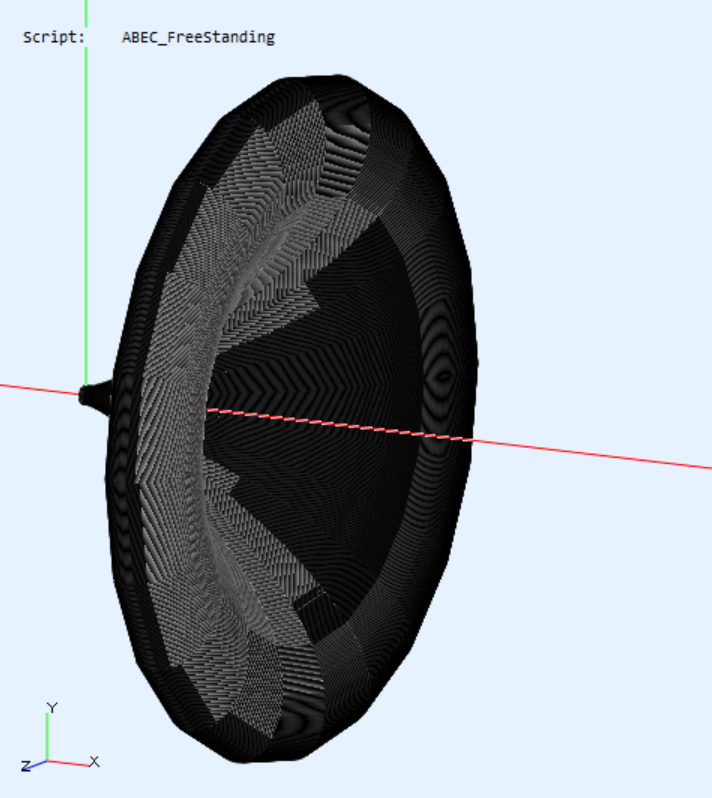

Oh btw, that's simulated with FRDs exported after generating in ABEC. Which is why I was thinking FRDs might be more valuable than the configuration file for 3D prints. The effects of the enclosure on the OSSE was a beast to simulate. If you lack computer power (large multi core) the config file won't do what you really want. At least that's my intuition.

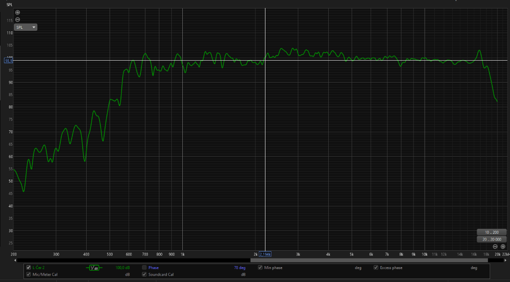

I can't resist and must share something (not mine). It's a preliminary measurement, obviously not anechoic and on-axis only, but anyway:
You wouldn't have guessed: it's B&C DE250 with ATH280EX-MK2.
We can make bets whether it's possible or not.

I got one on your recommendation. Made a huge difference. That's why I was able to simulate that OSSE inside an enclosure. Before that I could only simulate free standing in circsym or lower frequencies at low resolution in an enclosure. I haven't used it very much yet but the ability to quickly iterate is instructive with regard to how enclosures work with or against OSSEs.

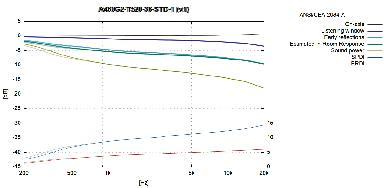

BTW, with a bit different mouth shape, I was able to reduce the waveguide diameter from 520 to 460 mm while keeping the performance virtually the same down to ~600 Hz:
(light gray = A520G2, color=A460G2)
It may not seem as much but those 6 cm are a big difference visually.
It is almost 25% less visually occupied surface

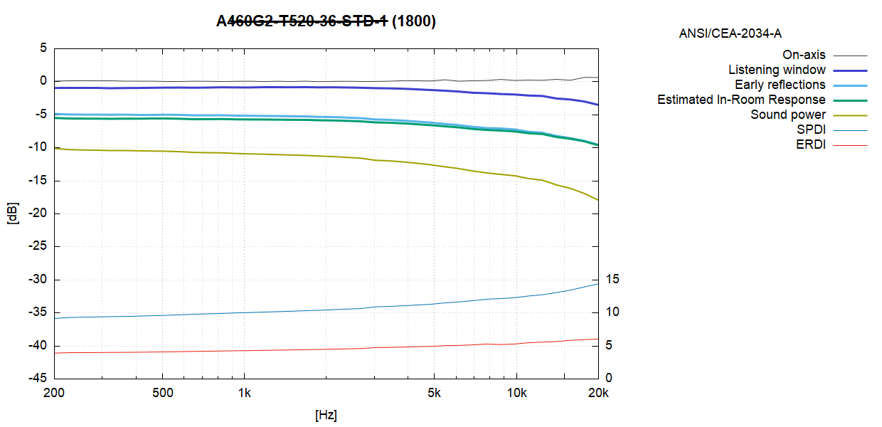

How would it look for a huge horn, for example A1800G2? (If it is easy to simulate)
What else would you expect?
But it has a little practical value, I'm afraid
