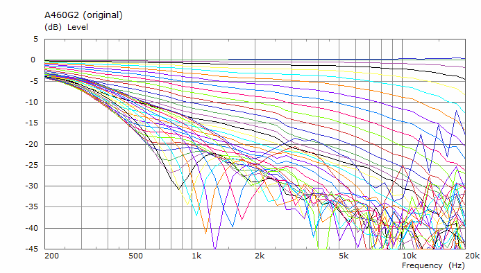

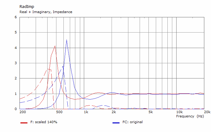

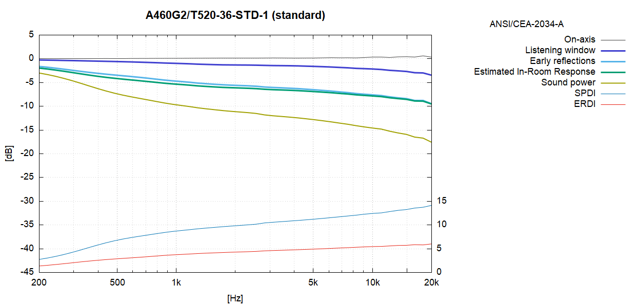

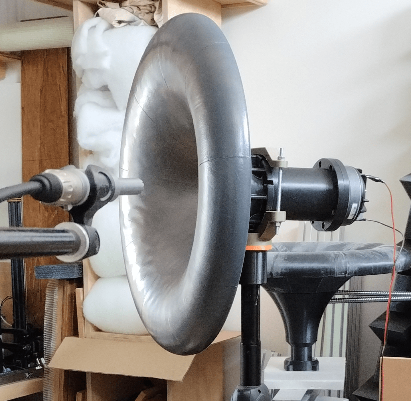

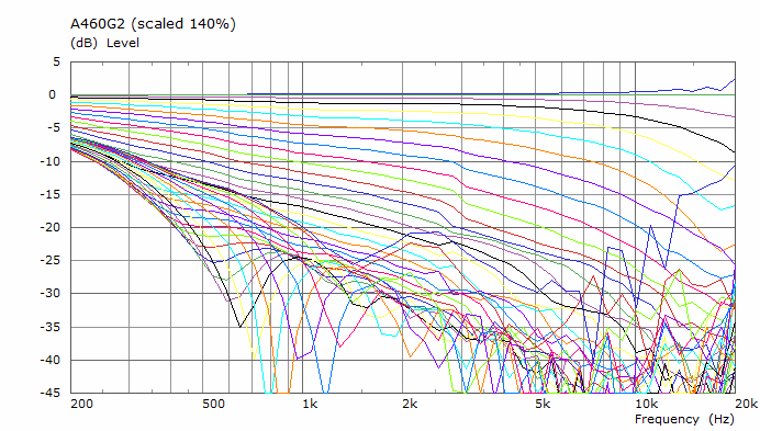

Hi @mabat, I have a question. If I upscale Gen2 WG and adapter for a 1-inch driver up to x1.4, what kind of HF directivity can I expect? Will it be about ~1.4'' driver or ~2''+ driver? I'm considering doing something like this with a MEH to achieve ~100Hz with WG directivity. I'll be fine with a rough answer without any modeling.
Maybe it's time for me to start learning how to use ATH soft...

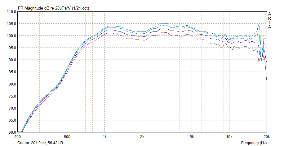

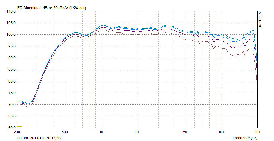

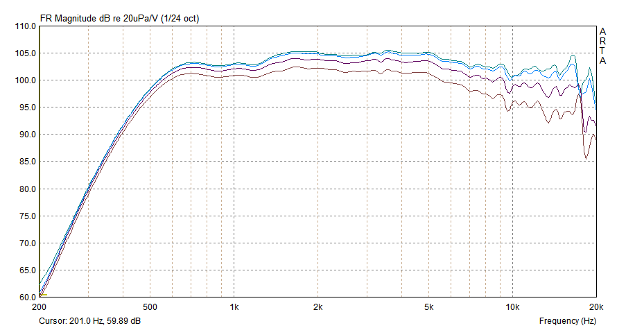

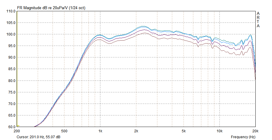

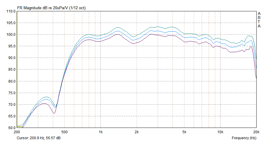

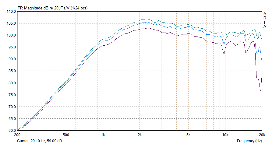

DF10.171K + ATH280EXmk2
(on axis and some arbitrary off-axis angles)
It seems that the (built-in) extensions in these smaller WGs may have too abrupt terminations (due to their wider coverage angles), I don't know. Of course with a DSP this is no issue, but still...

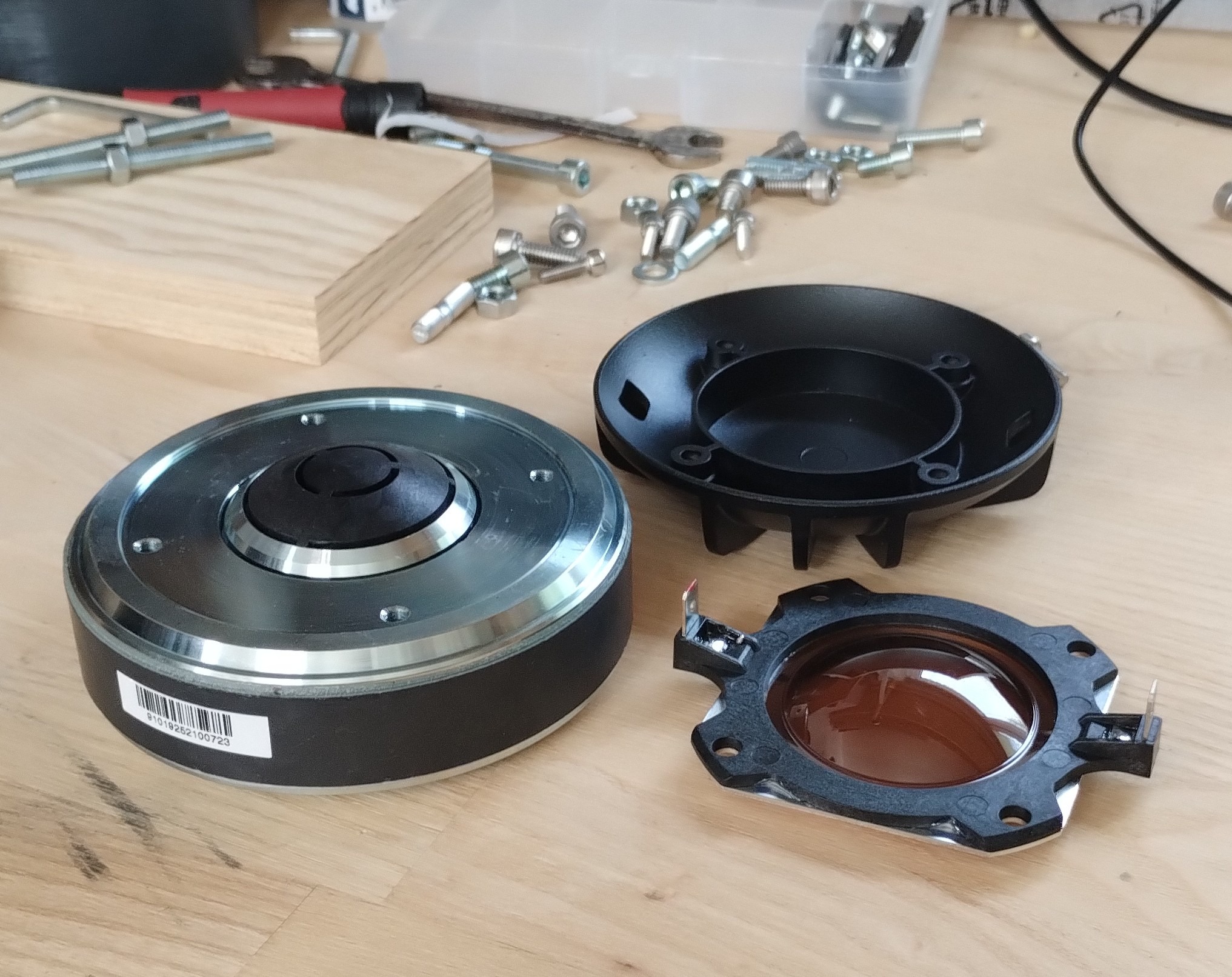

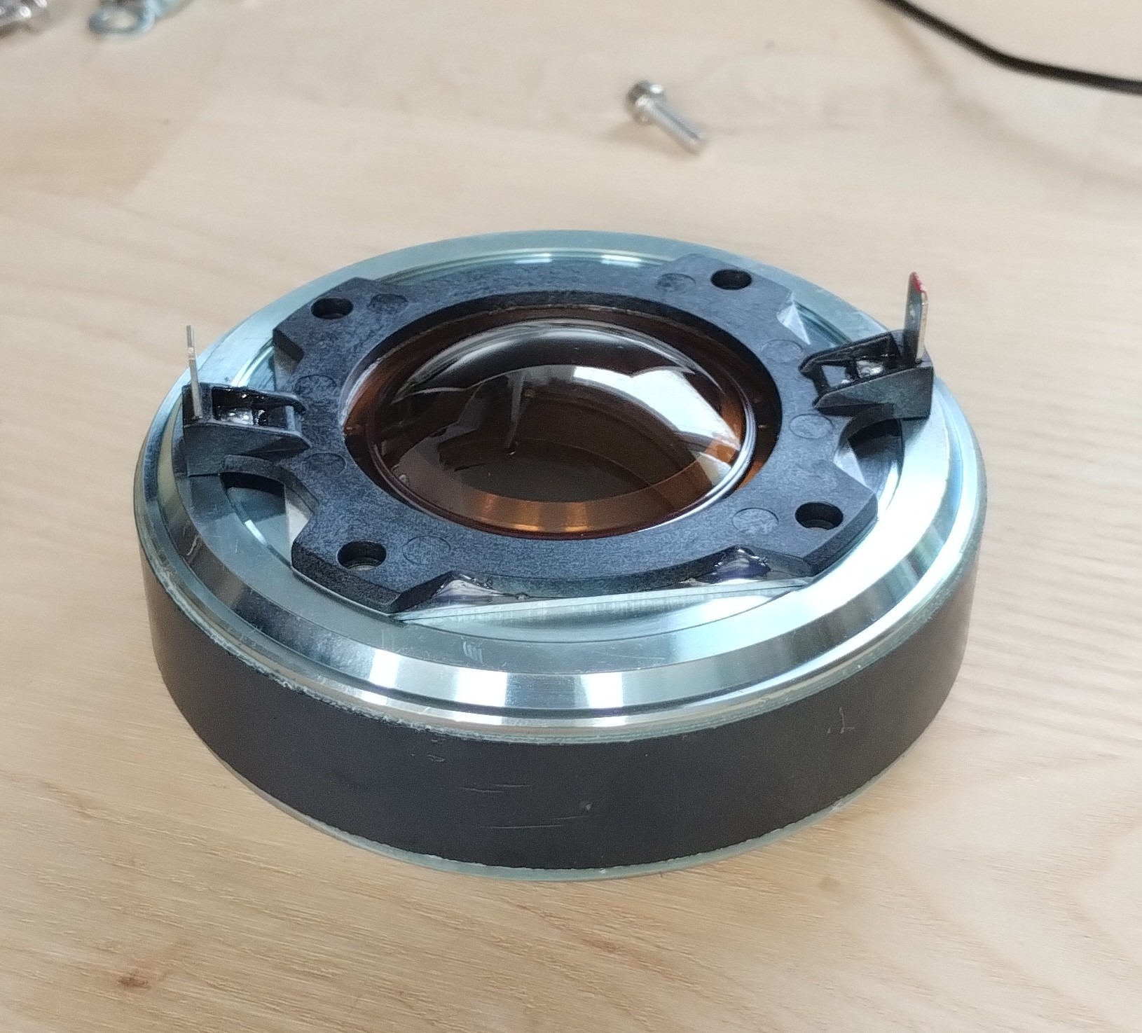

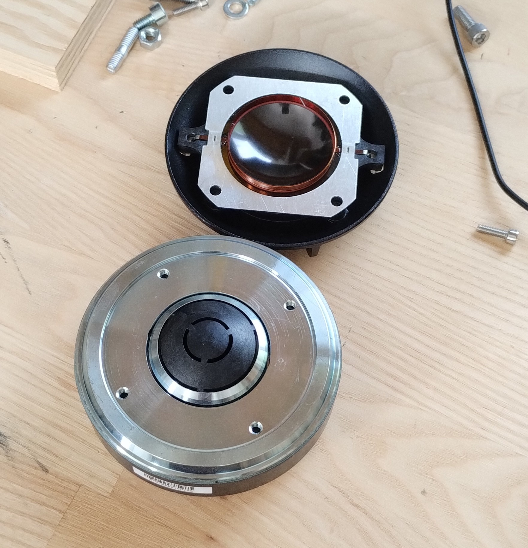

I must correct this. It seems like a single slot from the exit side just by a brief look but it's actually a 2-slot design... the Lavoce a 1-slot phase plug.

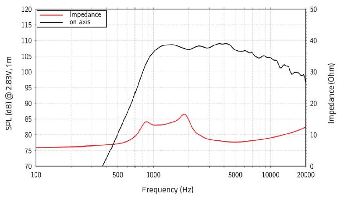

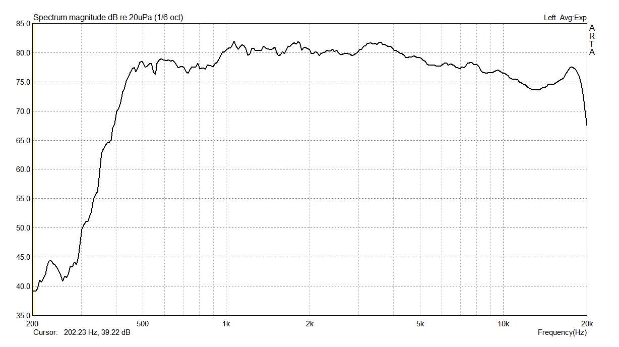

The DF10.171K:
Anyway, obviously the exit wavefront is really well behaved. They claim a FEM optimization and I believe them.
The back chamber is without any damping and it should be easily possible to make a custom rear cover for this driver.
BTW, there's a similiar driver, DF10.171M, with a different diaphragm. I leave that for others to try.
Overall, I think this is a pretty good substitute for the (no longer available) Peerless drivers.
