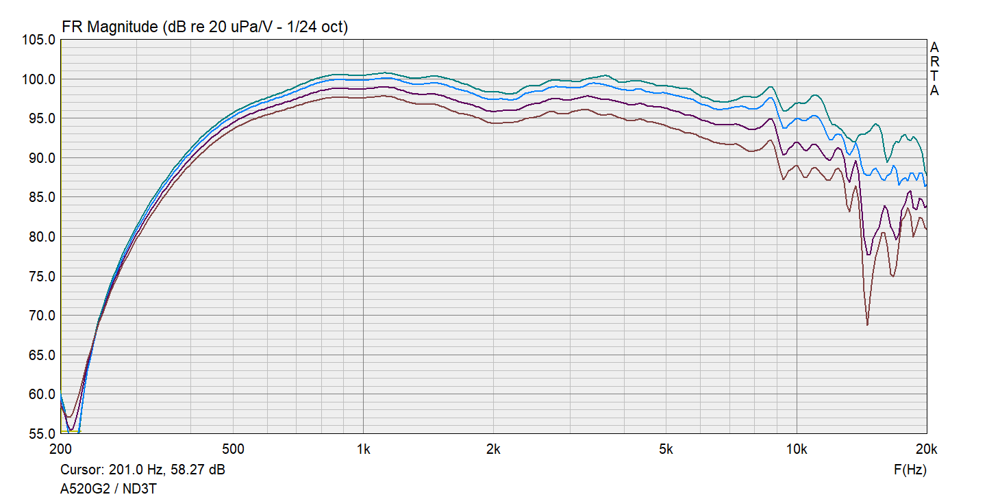

And with ND3T + the latest 1.4" adapter.
I'm reposting ND3T with the standard adapter from post https://www.diyaudio.com/community/...-design-the-easy-way-ath4.338806/post-7814257
And ND3T with the ND3N throat section optimized later adapter from post https://www.diyaudio.com/community/...-design-the-easy-way-ath4.338806/post-7815139
for easier comparison. The latter looks more orderly, but both start deviqting about at same frrquency so not sure if sound actually differs, need to test. Top of my mind is, how identifiable the on-axis is audibly, and I'd pick the one whose on-axis is not identifiable to ear, at least thats the ideal, not sure if it is possible.
What are the axis by the way? 10deg steps so 0-30?

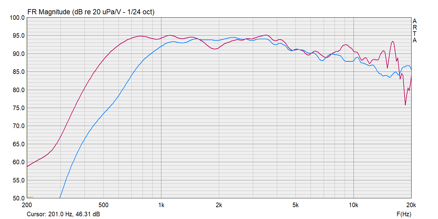

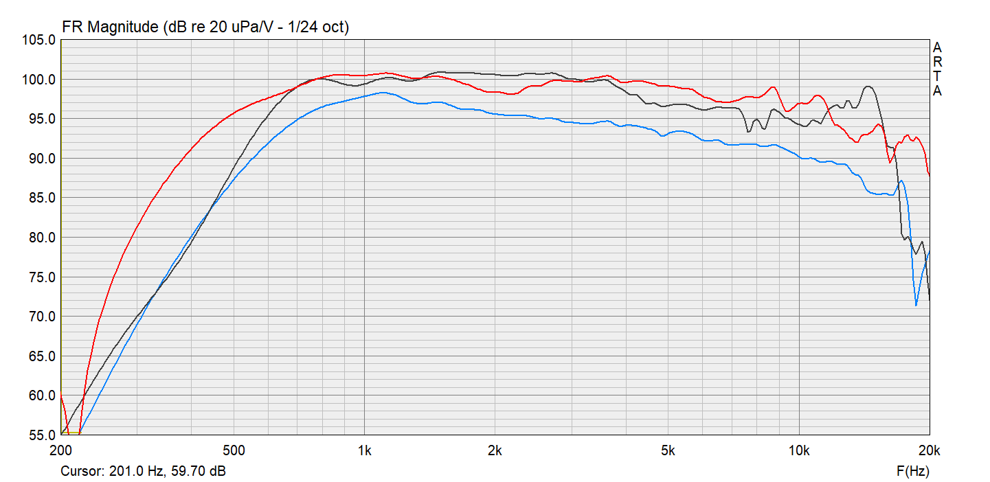

I have also some very very quick measurements/comparison of ROSSO 65CDN-T and BMS 4554 with a basic adapter of 33.1 deg angle.
(I didn't have the right bolts so this was only put loosely on a stool.)
A520G2 waveguide, everything same for both.
(65CDN-T = red)
BMS 4554 alone:
Here you have a driver reaching 20 kHz with ease. Not so much at the lower end though.

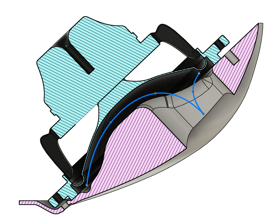

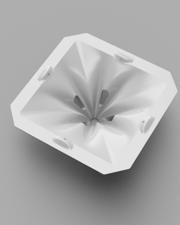

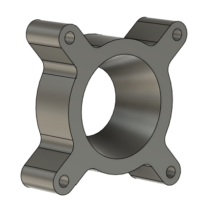

Updating this thing with taps located on the "knuckles" in the hopes that moving them from a high impedance area of the profile to a low impedance area will result in less disruption of the CD wavefront and maybe a measured polar response that is more consistent with the simulation.
Doing this increased the path lengths of the taps, resulting in more volume of air in the bandpass chambers. To counteract the effect this would have (it would shift the woofers' rolloff lower), I'm integrating cone fillers.
Right now I'm debating on whether I should keep the tap "straight" or angle it so that the entrance is located central to the cone. I've gotten good feedback from others on the pros/cons of this, but it seems to all boil down to:
1. Moving the tap entrance to the middle of the cone will result in more equal loading of the cone, meaning less stress/risk of tearing, and less cone deformation - possibly resulting in less nonlinearities (distortion). Because of this, I can safely bump up the compression ratio and make the exit area of the tap even smaller, resulting in even less CD wavefront disruption.
2. Keeping the tap straight and at the edge of the cone means that there are unequal path lengths that the sound has to travel from one edge of the cone versus the other (see sketch lines in above screenshot). This will result in cancellations once the wavelengths become short enough in relation to the cone diameter. However, in MEHs this is a feature not a bug, as that's the mechanism by which the taps provide an acoustic lowpass filter that removes unwanted distortion above the XO frequency.
I think the move at this point is to make a test baffle to compare tap placement at the edge of the cone versus centrally located.
That's one thing I'm still a little unclear on to be honest. Because it looks like hornresp simulates the tap in the center of the cone as there's nothing I'm telling it to indicate the tap being at the edge of the cone, meaning the low pass is a result of what you describe being a bandpass/helmholtz resonator effect. So maybe the cone filler creating unequal path lengths isn't really a major factor.
Either way, I think a test baffle to A/B would be good for me as a learning exercise regardless.

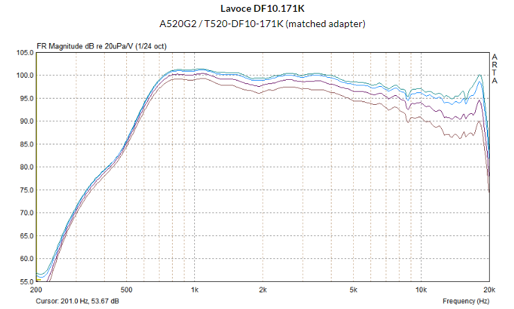

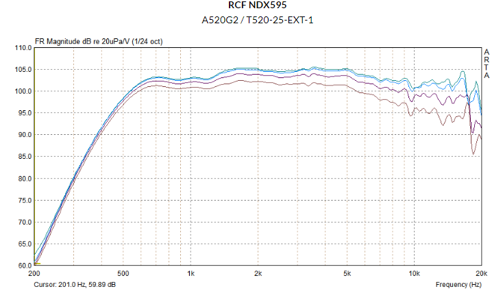

BMS 4554 extended, with an adapter starting right at the exit of the (ring) diaphragm, which is roughly ⌀16 mm.
Still keeping the directivity of Gen2, I think this is actually pretty cool.
Shaping the response is no issue with a DSP. Perhaps it could be further optimized in the adpater, hard to say.
(Measured with A520G2; at two different distances from the mouth.)
- Did a quick sweep for harmonics, at two different levels, just to have an idea:
2nd, 3rd, 4th:
Seems to me like 700 Hz would still be no problem.
Given the 4554 is available for around €135, this would be hard to beat, IMHO.
