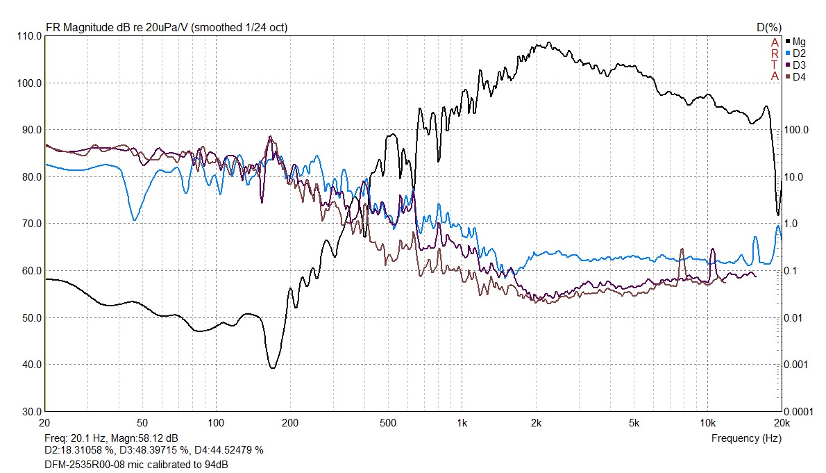

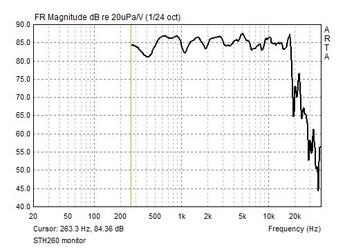

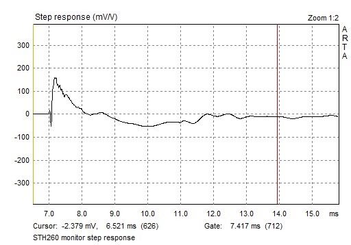

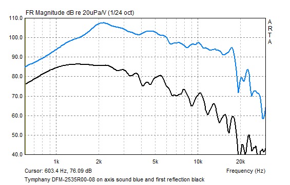

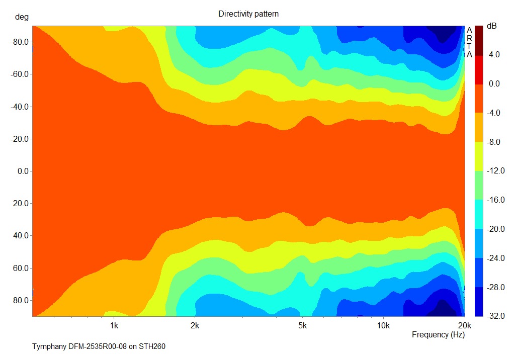

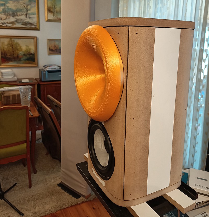

Working on speaker for my father. STH260 with Tymphany DFM-2535R00-08 below.
Reactions: N173MM and Naturlyd

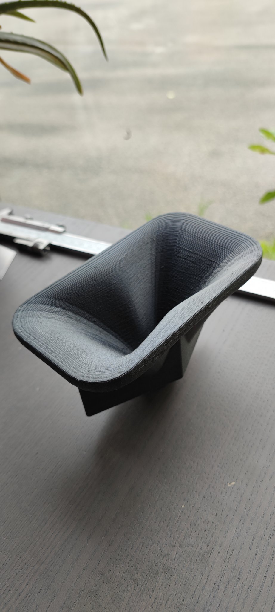

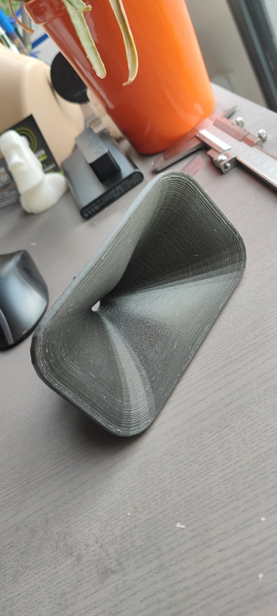

Is it correct that this is still not included? Could you maybe let me (us) know how a Fusion 360 import can be done with the current version? I cannot find the import scripts within the ath package.
