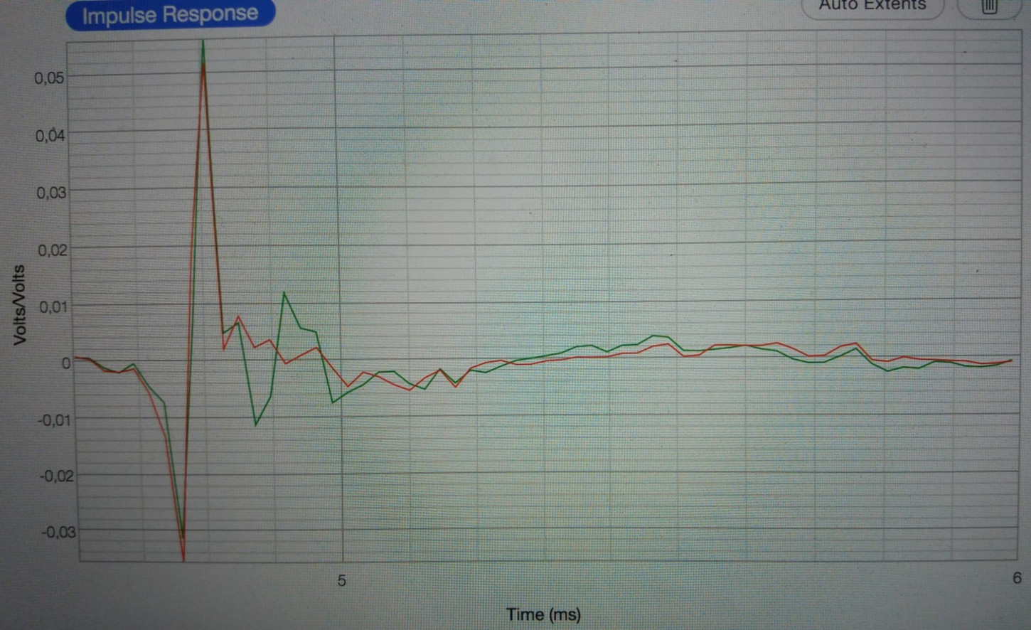

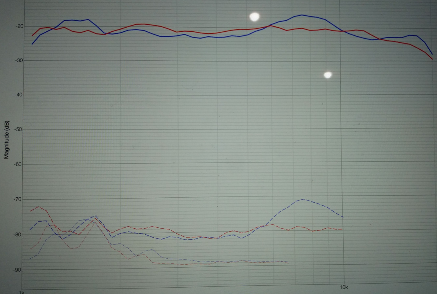

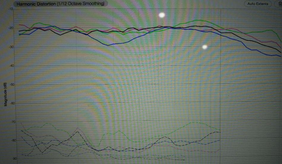

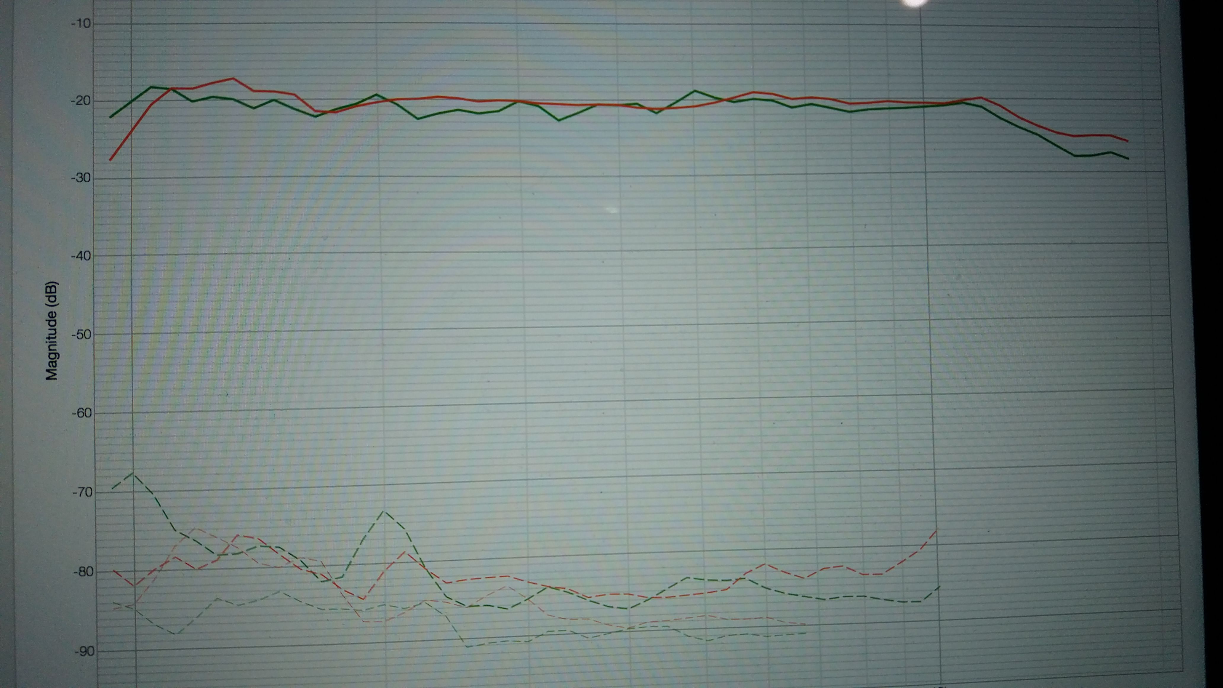

TPL 150 in dipole the 2º harmonic distortion drops 20dB, but have a big peak in the 8kHz range frequency response.
You can see in this tread:
https://www.diyaudio.com/forums/multi-way/142015-baffle-dipole-beyma-tpl-150-a-9.html#post1993491
You can see in the green impulse response a double oscillation. The period coincides approximately with 8 Khz. peak.
8 Khz. Wavelength 4,3 cm. Time period 0,13 ms.
A notch filter R // L // C in series corrects the 8 Khz peak response, but not these small impulse oscillations, in addition you have a peak in the impedance just at 8 Khz.
Acustical 8 Khz notch filter can corrects these small oscillations. You can see in red impulse with acustical filter. And the 8 Khz peak also in red in frequency response, in addition you don't have an 8 Khz peak in the impedance. And better harmonic distortion
I am going to summarize the steps that I have taken to obtain it.
The first clue is 1,1 cm. the 1/4 of the 8 Khz. Wavelength.
TPL-150 impulse response.
Green only dipole. Red with acustical notch filter.
TPL-150 frequency response

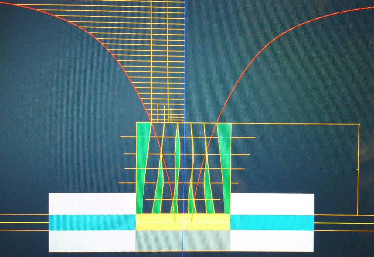

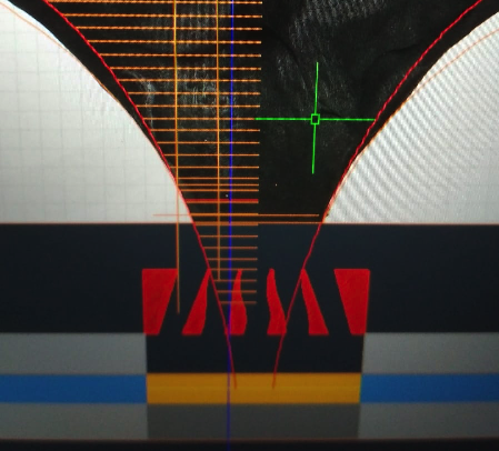

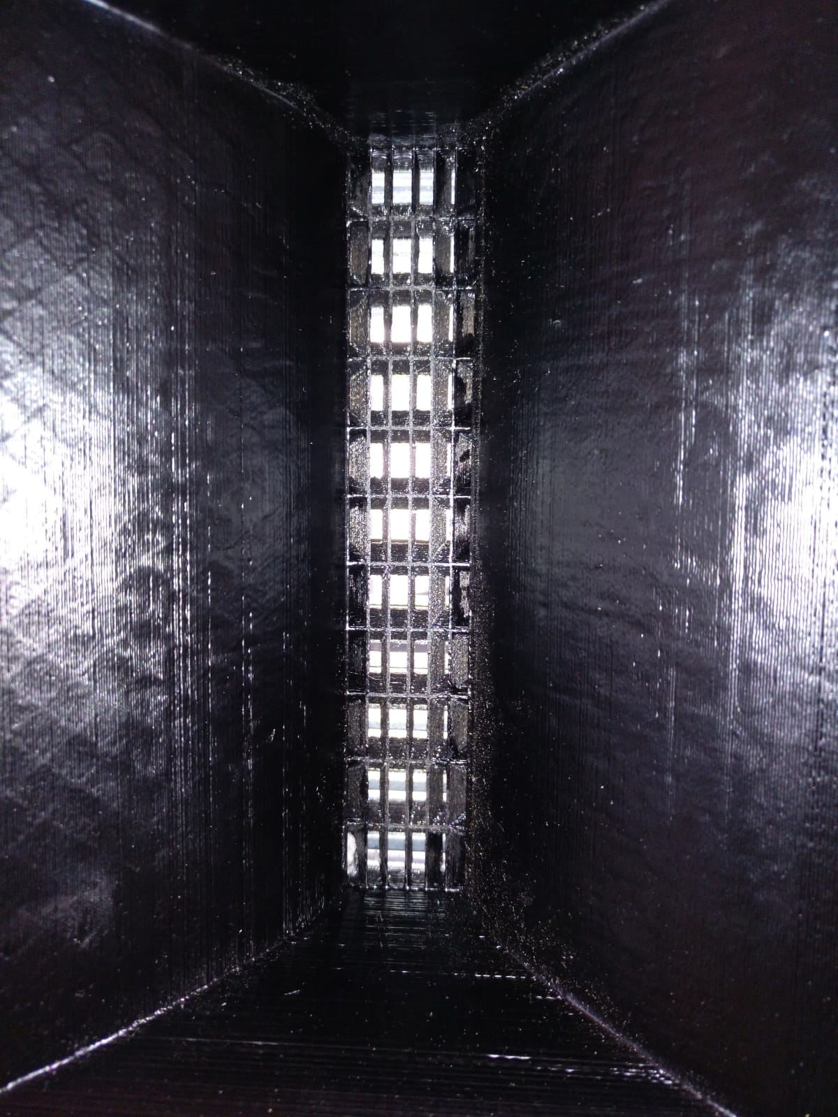

I had made many 1,1 x 12 cm sheets. Of aluminum, cardboard, plastic, was
other:
Silicone mold to make polyester filter.Obtained with piece manufactured manually in wax
I discovered that they did not work. You need to oppose acoustic resistance. And I did this by placing a horn in front and reducing the 3.5 x 12cm section of the tweeter to 2.5 x 12cm at the throat of the horn.
First horns.
other:
First horns.

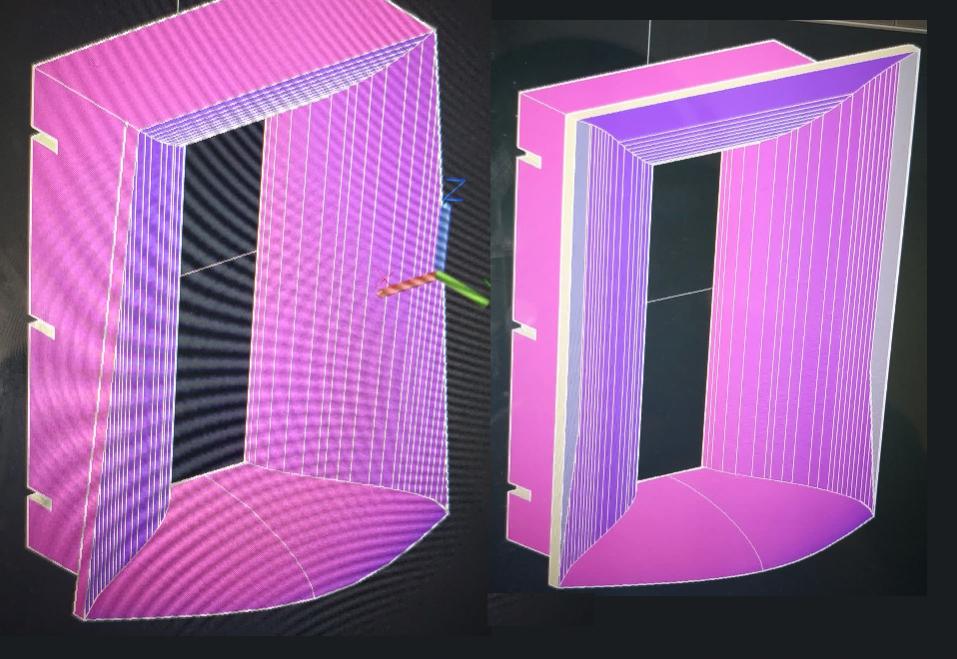

Profile of different filters.
Different filters in 3D printer.
Different measures of each one.
Different horns.
Filter detail
Different horns.
Filter detail
I agree. It's interesting to note that part of your filter resemble what Oscar Heil did with the focus plates of the original big heil AMT. Both sides (vertical) of the plates narrowed the throat. This mass loading, around 8k, reduces the diaphragms energy on the edges toward the center as the frequency goes up ... this according to his patent. Your filters additional structure show further smoothing of the response using technique not available in 1974. nice.

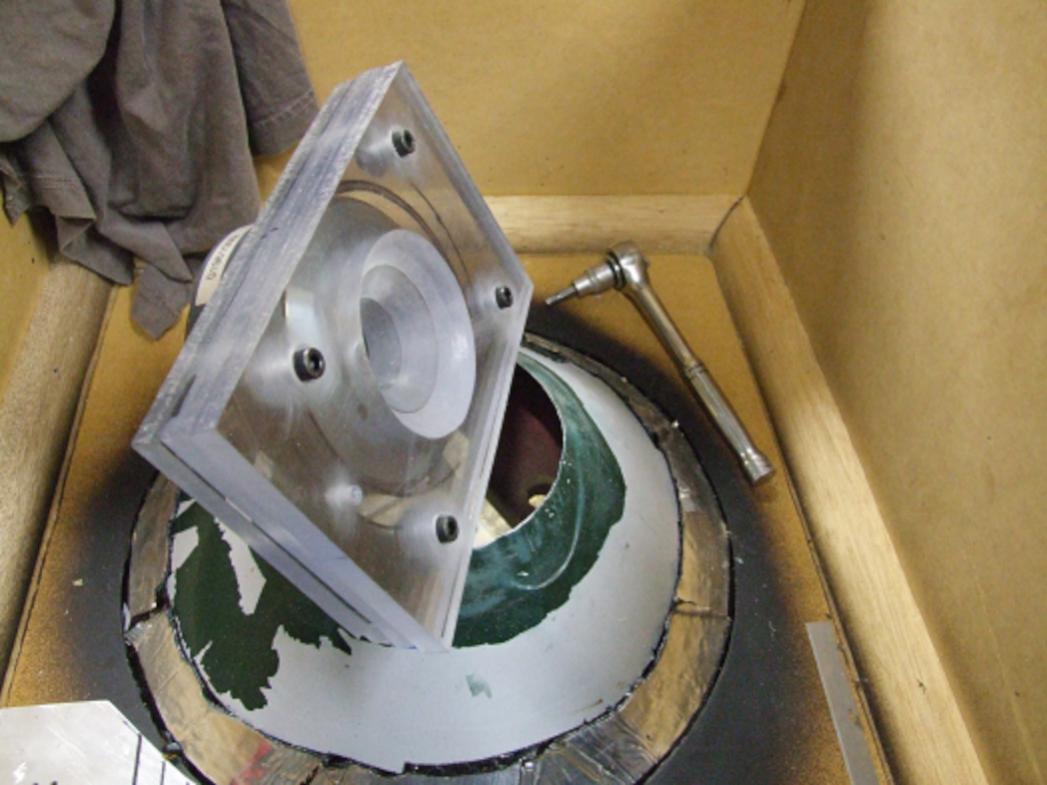

I came to the same conclusions with the TPL150 back cover. It raises the 3rd order THD along with that nasty bump at 8k, which I suspect they did to artificially lift the top end. Some thicher medium density wool felt gets rid of it and really cleans up the entire FR. Most closed back planars (as well as alot of other HF drivers in general) suffer from inadequate rewr chamber design.

It works in dipole, without rear camera. And also if you put a large rear camera. I have tried one about 10 times larger than Beyma's and stuffed with polyester wool. And it works too. I don't know if that one you put is good.

You can put TPL-150 without horn and without filter notch, and correct 8000 Hz response with DSP without problems.
If you mean to use my notch filter without horn, it won't work. It only works if you use a horn.
The Beyma waveguide is constant directivity, but without the coloration that these types of trumpets usually have. It has little coloration. Mine tractrix horn or "bi-eliptical horn" sound better in my opinion. It has no coloration.
