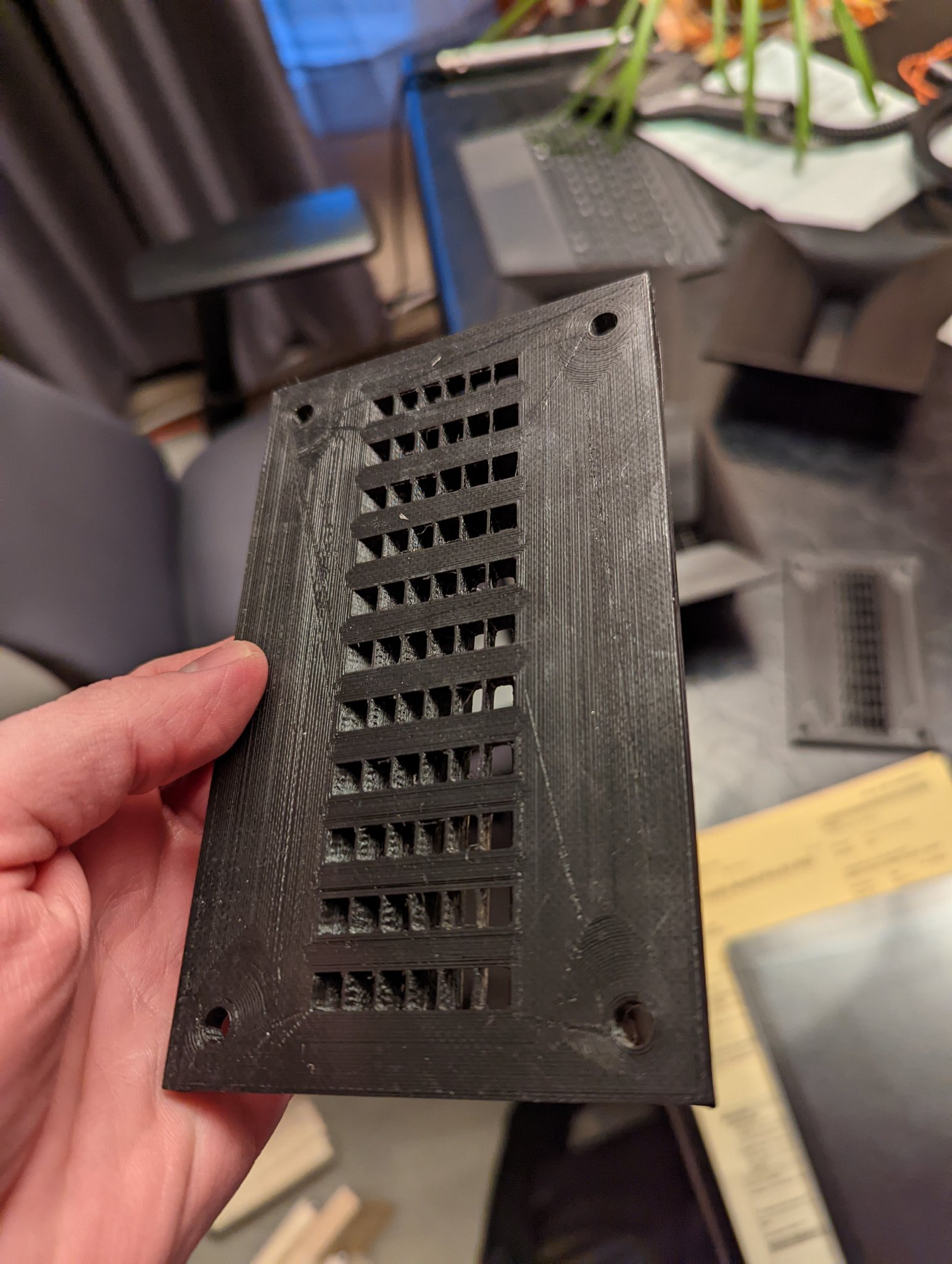

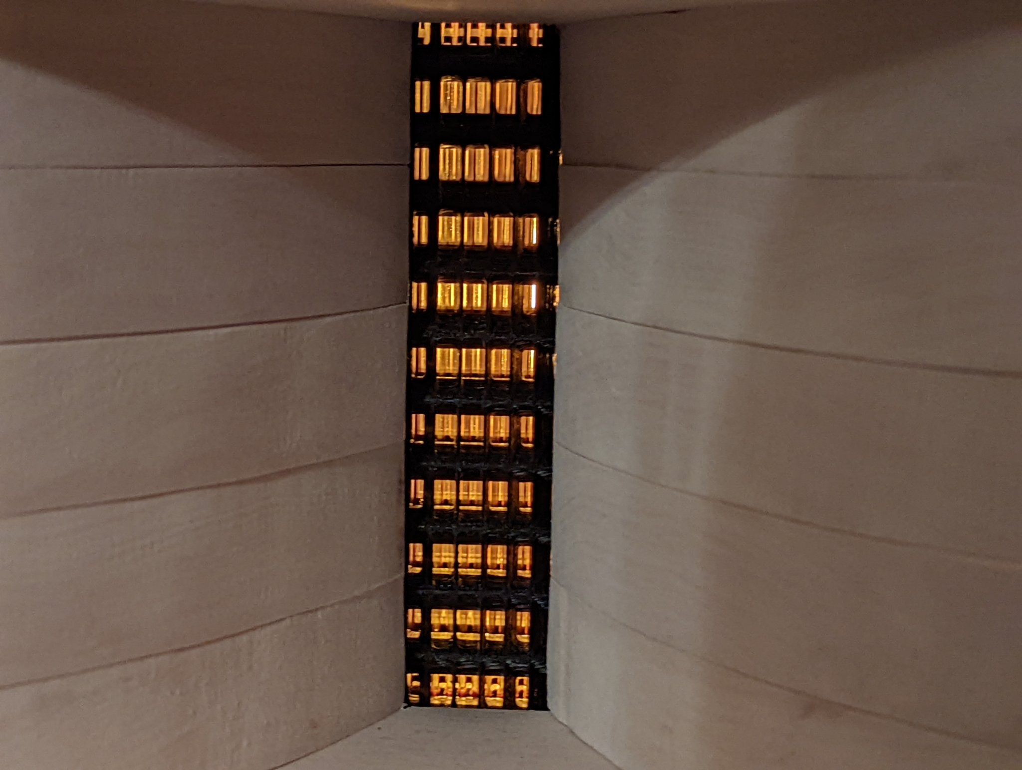

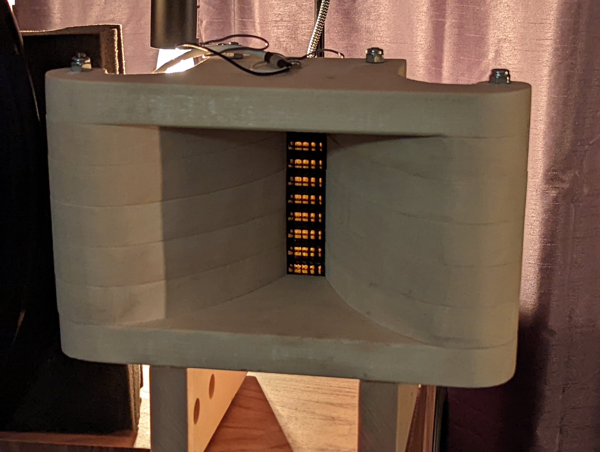

Oneoclock generously sent me parts to experiment with my horns and his acoustic filter.
The results are amazing, the problem I had mentionned earlier in the thread is now gone, the tweeter have a more relax presentation and now need next to no correction. They sound so good they are now staying in my system and I will be looking to rebuild my temporary horns with probably an expansion on the vertical plane.![PXL_20220117_213616317.jpg PXL_20220117_213616317.jpg](https://www.diyaudio.com/community/data/attachments/928/928424-4039714a037acfe53fe2d28b3d45b8e7.jpg)
![PXL_20220131_011217791.jpg PXL_20220131_011217791.jpg](https://www.diyaudio.com/community/data/attachments/928/928425-ba6f702a31377e6c39dacf7d06843127.jpg)
![PXL_20220131_011209819.jpg PXL_20220131_011209819.jpg](https://www.diyaudio.com/community/data/attachments/928/928426-a71969580cc8aac596953c990b10e6e1.jpg)

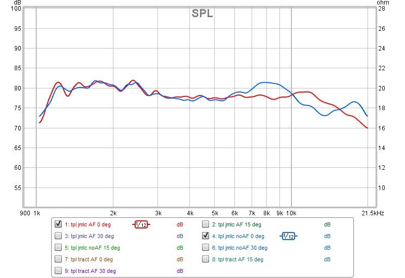

Some measurements :
Red is with the AF installed, blue without (1m)

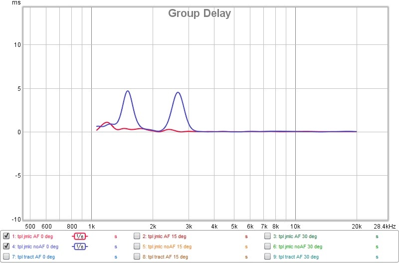

Something is happening to two peak I had in the GD, they are now gone

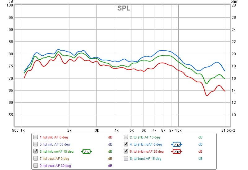

This is without the AF 0-15-30 degres (1m)

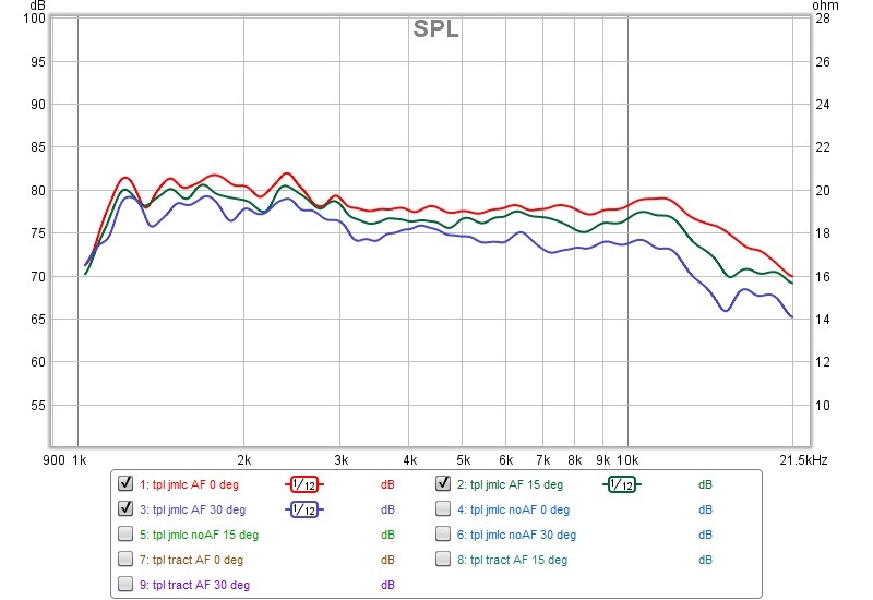

This is with 0-15-30 degres (1m)

I also have experimented with Luis horns, they do better than my JMLC in the vertical plane but the JMLC off axis are better. I will be experimenting with his dual horns setup next and see if it beat my JMLC with the acoustif filter.
I'm really happy to have found a way to get good performance with the tpl-150, thanks a lot Luis for your hard work on this.

I installed the front filter with the original Beyma waveguide. It was easy - just required trimming about 1mm in a couple of finns. No big deal.
Disassembly and reassembly was easy too (make sure your bolts are long enough or have new bolts readily available before disassembling.
I didn't take pictures.
Filter done on plastic - I didn't ask which.
