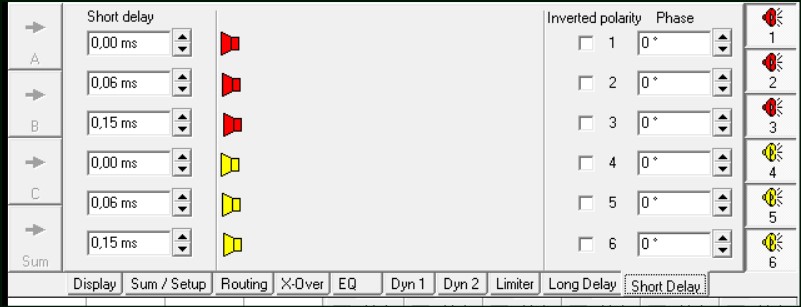

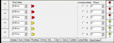

I have done two speakesrs with Minidsp and one pair with Hypex FA123. I use REW and UMIK-1 for measurements.
Johan, you must set baffle step compensation for the woofer and perhaps or the mid too - nearfield measurement misses baffle diffractions! Delay settings should be measured at 1 - 1,5m at listening axis. Reflections and room modes will make analysis difficult, but gating the measurement for 4ms per mid/tweeter and 8-12ms for woofer-mid works quite well.
In all of my speakers delay for woofer is 0, around 40us for mid and 42us for tweeter. LR4 xo must have same corner frequency and responses equalized straight at least one octave past xo (half/double Hz)
Start delay setup by playing only mid and tweeter, with same polarity. Look at spl response and step response (Impulse window, toggle Step) ideal step response shows peaks of tweeter and mid impulses combining snoothly. Then add delay to tweeter and take a new sweep, then compare to previous and take notice on changes. Then take third measurement with different delay and compare to previous - this way you learn to see and analyze changes and find the right delay. Verify and fine-tune dealay with new measurements with reversed polarity o the tweeter 8there should be a sharp dip of spl at xo. The dip is off and smoother from xo if delay is full cycle wrong.
Then play only woofer and mid and repaet the previous procedures. This is harder because of reflections messing responses.
When W/M is ok, change tweeter delay to match the M/T delay´determined earlier. Then measure the whole thing WMT response and also with M in reverse polarity (you should see two dips in response)
Learning and understanding wil take time, lots of time! Be patient. Save different dsp settings and respective measurements!

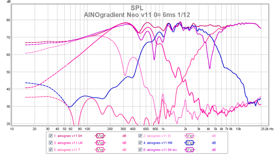

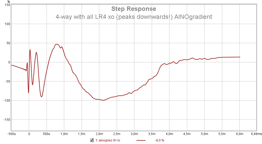

Your delays in post #10 looked odd to me. I was about to write a response and then saw Juhazi's post 14. I agree completely with his post.
In my active 3 way with Hypex FA253, the 12 inch woofer is in a separate cabinet which is further from the listening position than the mid and tweeter. However, if the woofer cabinet was brought forward so its baffle was in the same plane as the mid and tweeter, I would get the following delays:
12 inch woofer: 0 us = 0 mm
6 inch mid driver: 288 us = 100 mm
1 inch dome tweeter: 416 us = 143 mm
The contribution of these variations itself varies. To put it simply, the compromise can be somewhere between the close up response and the in room, but a better situation is to focus only on the speaker when crossing, but treat the room. Better still is to design the speaker to deal with the room.suggest that correct phase alignment in the crossover sections are more important than a flat SPL curve which is "destroyed" anyway by the in-room reflections.
