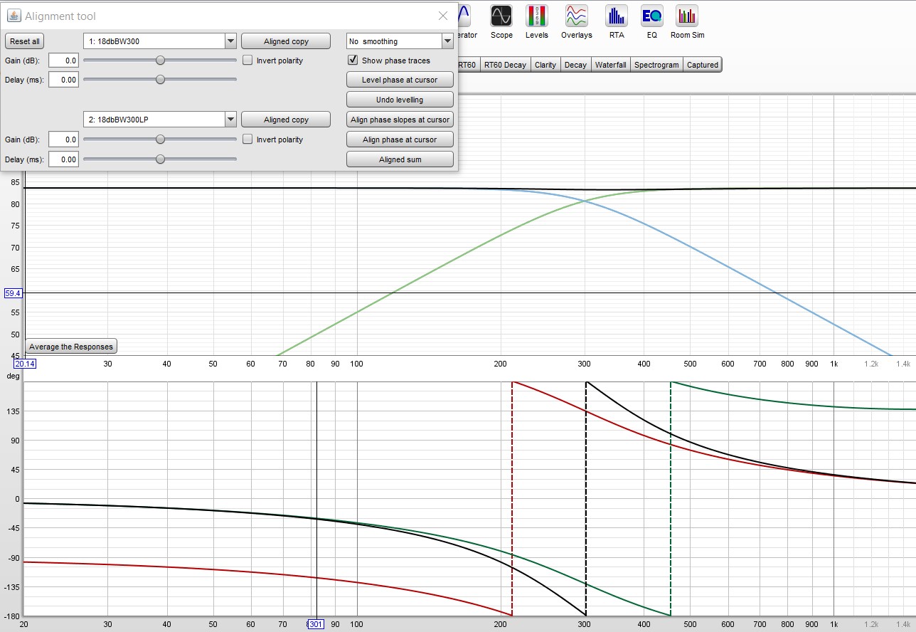

Thanks for pointing that out you are of course right and REW just plotted what I told it toREW is wrong on this.
To display phase one needs to set a reference point in time.
What RWE is doing :
It takes the IR of the Low Pass and finds the peak, uses this as reference to plot the phase of the LP.
Then it uses the peak of the HP´s IR ( which is different ) to plot that phase.
To compare two phase traces, one always needs the same reference time ( delay ).
Why is this easy to spot:
In simulated HP/LP there is no time of flight involved, therefore the phase trace should always be going down ( except for REW)
The phase plot of REW for the LP generates negative Group delay, which is second best to time travel![]()

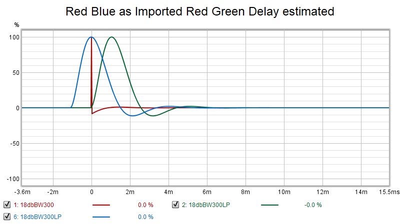

I took a shortcut and didn't estimate the IR delay I just made REW find the match point for me.
This is the impulse difference
Then in the alignment tool no delay is necessary, sorry if I confused anyone. The relative differences still apply just not the specific delay numbers. This is another example of why time locked measurements are necessary.
