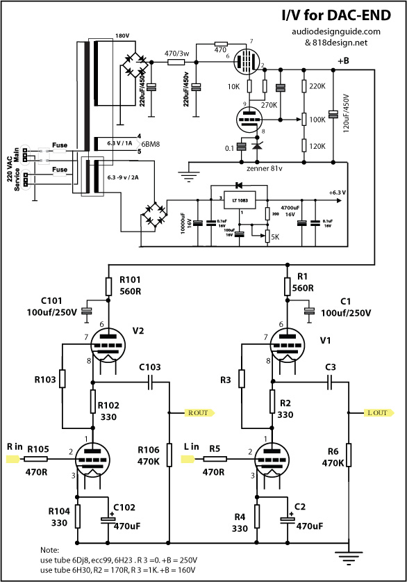

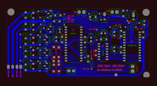

Ad1865
Hi Audiodesign !
I design you cricuit DAC to layout,
The soud is very good, i like it, But I want output by tube not use tranformer. You can show for me exaple what tube can use for thi DAC!
Thank you very much
You can se my layout
