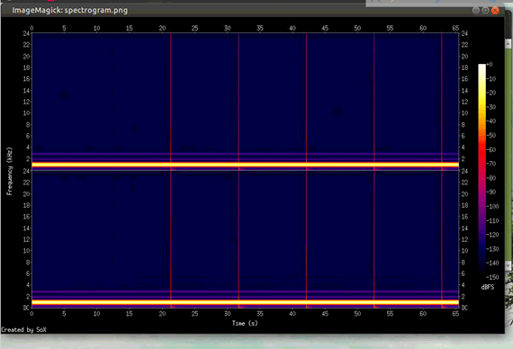

It really depends on the USB clock vs. master clock difference. RTX6001 (also XMOS based) uses implicit feedback. Before implicit feedback was enabled for RTX6001 in the linux usb-audio driver, one PC -> RTX6001 setup experienced buffer underruns every 10 seconds.But I doubt your errors are caused by feedback packets. IME it is possible to run without any feedback packets for several minutes or even hours before buffer under/overruns.
Implicit feedback ignored:
Incoming USB packets: 931,484 48-bytes long, 684 40-bytes long => relative samplerate 47,994.1298 Hz
Outgoing USB packets: 932,168 48-bytes long
Implicit feedback respected (running on a different PC):
Incoming USB packets: 712,393 48-bytes long, 479 56-bytes long
Outgoing USB packets: 712,393 48-bytes long, 479 56-bytes long
Another setup with a different PC and different RTX6001 experienced the glitches spaced several minutes apart. Enabling the implicit feedback in the driver fixed them completely.

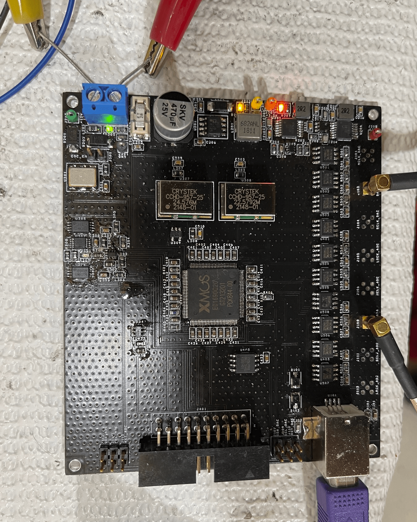

A new board version solved all problems. I implemented all suggestions above, and then some:
Not sure, but I suspect the clock synthesizer was at the root of all troubles. Frequency much different from the PC could lead to buffer under/overflow. I'll check the exact frequencies on the old board. Anyway, UAC2 transfers @192kHz ran perfectly overnight, in a digital loop, no crashes.
Now, on to the next phase, integrating the ADC and DAC.\
- XE216 XMOS chip plus a 8Mb flash mmory
- Replaced the 24.576/22.5792MHz synthesizer (starting from a 24MHz clock) with two Crystek CCHD oscillators
- Used MMCX I/O connectors (got them from China, not expensive).
- Changed the USB connector to a Type B.
- Fixed the solder mask bug
