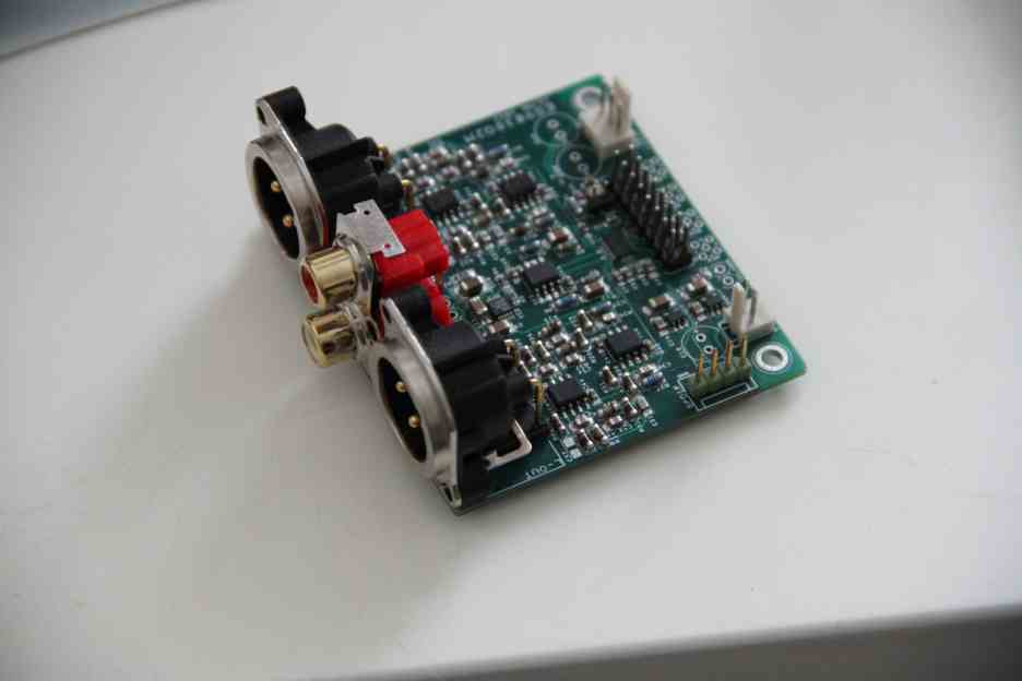

How many layers does your board have? I design a ES9038Q2M board with ADP151 for AVCC and Opa1612 buffer for AVCC_L, AVCC_R on 2 layer pcb, one layer is solid gnd plane and only get one channel 2nd harmonic at about -110db, 3rd -120db, another channel is -120db, -108db respectively, opamps for IV and SE converter are also opa1612, do you have any suggestions?My own board. My other DAC boards share the same format so they are interchangeable. Forget about ebay boards as most of them have design flaws which cannot be fixed by hacking.
My board has 4-layers. Like I mentioned earlier in this thread I did not get very good results with op amp buffer for AVCC_L/R. Also for some unknown reason I have not had great success with OPA1612 in my ES9038Q2M dacs which is why I switched to OPA1656. In my ADCs OPA1612 work better. The ADC used in loopback measurements needs to be good as well as otherwise you may be measuring ADC distortions instead. Lowering the level to -10 dBFS or below may work better with some ADCs. Good ADC is also required for THD compensations of ES9038Q2M.
Could it be that the OPA1656 is better at handling the load from the differential amplifier/filter?
The I/V op-amps look into a 215 ohm load from the next stage. Combined with the 820 ohm feedback resistor each op-amp (IC6 and IC8) will have a load of 170 ohm. Quite a tough load for an op-amp.
I think that to adjust the compensation of the DAC a notch filter is needed. This will relax the requirements for the ADC.
The input of the ADC may not be a simple resistive load. Its more like a sampling gate which could grab significant current pulses on every clock. I think that's why many ADC's need a cap at the input. That can be harder to drive than a resistor of the same approx. value.

Yes, I use 5% C0Gs and 1% 0204 melfs and based on the results without major issues.altor, why do you believe he needs so crazy tight tolerance yet? In my LPF(SK version) I used 5% C0G and 1% 0207 Viking without matching attempt.
Edit: some of the melfs are actually 0.1%. As I'm not selling these the price difference between 1% and 0.1% melfs does not matter.
what for, to get H2 -180db? I tell you, 5%/1% is just fine to get -150db.for the balanced output both it's outputs must be equal.
