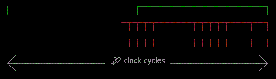

Regarding the diagram above, and the correct protocol and number of bits for your dac chip, rfprw said your it is configured for, "16 or 18 bit LSB/Right justified." The two modes are not mutually compatible, if you choose the wrong one it won't work properly. Examining dac clock frequencies with a scope should give you a certain answer.

Looks like the JP is in the high/high mode (e.g. 18 bits parallel), as at least there is something going to the respective pins (high > 0.7 V).
But I am wondering a few things.
- Are there more bits of audio to the left side of the MSBs that could be used?
- Is the amount of the bits to the left side constant?
- Why/what are the extra bits to the left on the stream in the first place?
And what should the location of those extra bits be in the output I2S stream?
The data sheet also details a configuration where the clock stops during the extra bits. How likely is this scenario - did rfbrw rule it out already?

The setup for the JP-8000, chart 4, is 18 bit data clocked in in parallel.

For standard RJ PCM there are no extra data bits. The MSB for each channel is sent last, LSB first. The Frame clock up and down edges indicate when left and right channels are alternated. For 18-bit stereo there should be a total of 36 data bits per frame clock period, 18-bits times 2-channels.
Pins 1 and 3 are configuration pins. Their state is permanent unles a change in configuration is required. They set the operational configuration of the DAC. In this case pulling pin 1 high by connecting it to V+ configures the DAC to accept left and right channel data on a pin each (L=pin15 & R=pin14). Connecting it to ground (low) would configure the DAC to accept left and right data in serial on one pin (L and R on pin15). Pin3 configures the word length. 16 bits for low/ground and 18 bits for high/V+.
To the left would be the sample that preceded sample N. Sample N is the current sample. Sample N+1 is the sample to come. Each sample in the case of the JP8000 is 18bits long.

Stopped clock mode would be a function of the source. The only way to know would to use a 'scope.

The empty part of the frame is sometimes used for other data as the data does not fill the frame which is typically 32, 24 or 16 bits long per channel but it can be as low as one clock cycle per data bit long or as high as 64 bits per channel long. If what holds for the JP8080 holds for JP8000 each frame is 32bits and the sample occupies the last 18 bits.

In this specific case data is converted on the falling edge of WDCK. As the data is in parallel LRCK is not required define left from right.

The JP8080 manual... genius. Ok, so F_s is 44100, Bclock = 64*f_s, wclock = 2*F_s. The actual output is 88.2 kHz, so indeed the block has a length of 32 samples, 14 extra bits per "block".

The sample is 18 bits long.
