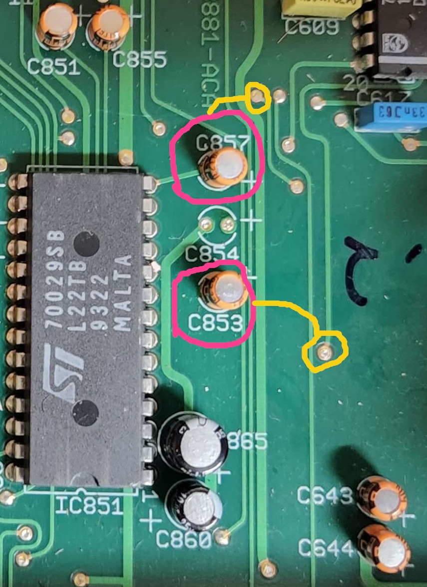

I'm no expert on car cassette/radios, but my inclination would be to break into the circuit as late as possible. My first thought was to find the volume control - but as far as I can see, IC851 is responsible for volume control and other audio processing.
Can you identify this IC851 on the board? If so, find C857 and C853. If they are through hole devices this makes life somewhat easier. Try desoldering the end of these capacitors that is not connected to pin 14 or pin 10. Your audio from your Bluetooth receiver would then go to the now-unconnected side of these capacitors, L to C857 and R to C853, and don't forget to find to find a ground point for the screens of the cables from the Bluetooth receiver.
This will only work if you disconnect one end of the capacitors mentioned - don't try to take a shortcut and simply insert the signal at the nodes labelled TAPE+L and TAPE-R as the Bluetooth receiver will see the low output impedances of IC601 rather than the required high input impedances of IC851.

So I can see 857 and 853. There are some sort of posts (sorry if that isn't the name), am I desoldering and then removing those and then soldering the left and right wires of the bluetooth receiver in place of that? Or am I supposed to soldering from the other side of the board? Again, sorry for my lack of understanding.I'm no expert on car cassette/radios, but my inclination would be to break into the circuit as late as possible. My first thought was to find the volume control - but as far as I can see, IC851 is responsible for volume control and other audio processing.

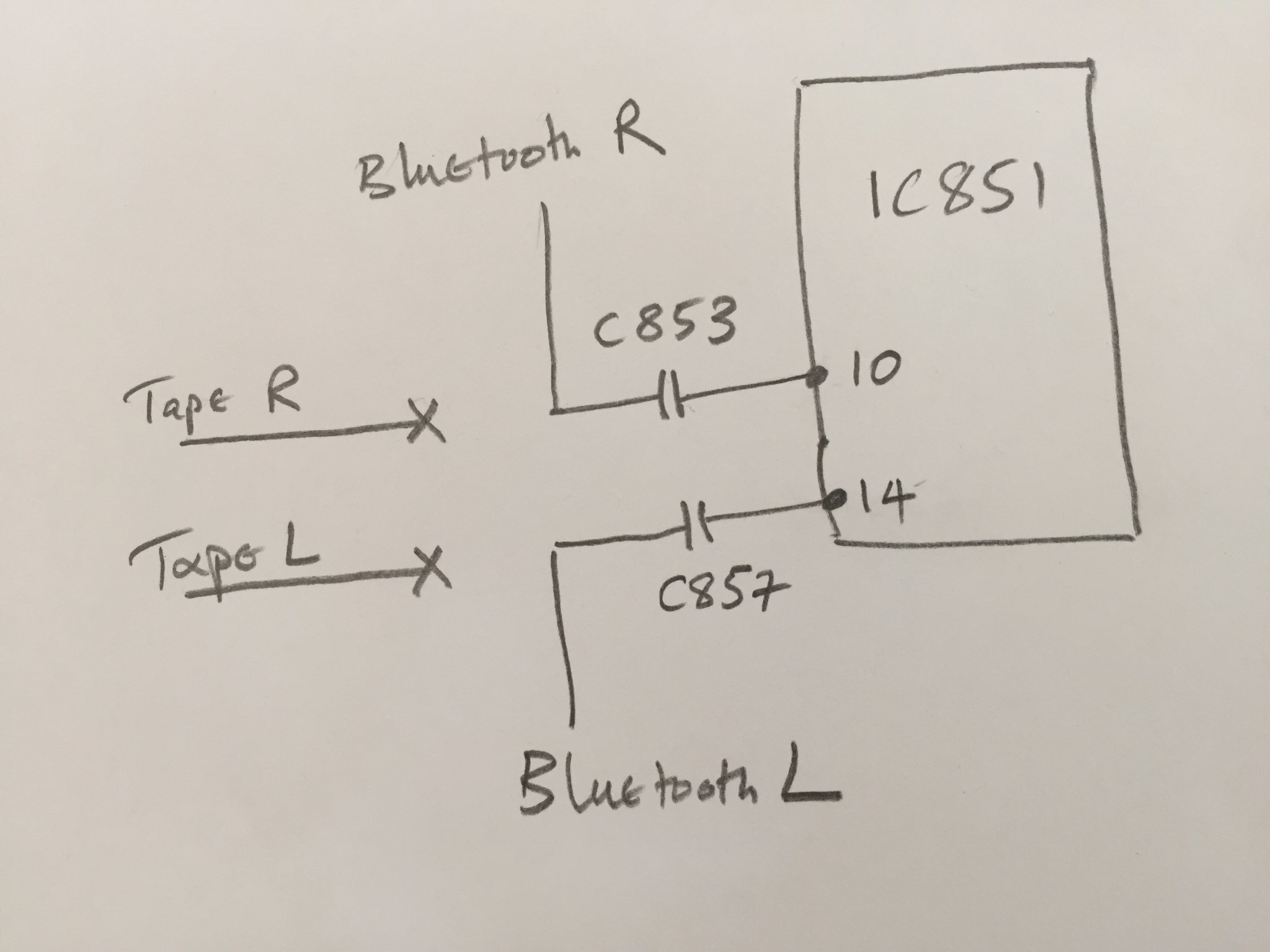

With regard to your reply about the capacitors, it's not clear to me what you are describing. Are the capacitors really connected to "posts" (i.e. pins)? I've attached a sketch in case this makes my initial suggestion easier to understand.
However, as NareshBrd points out, the alterations I showed are just the beginning. There is a lot of work involved, and an FM transmitter will do just what you want without making any alterations to the stock unit.

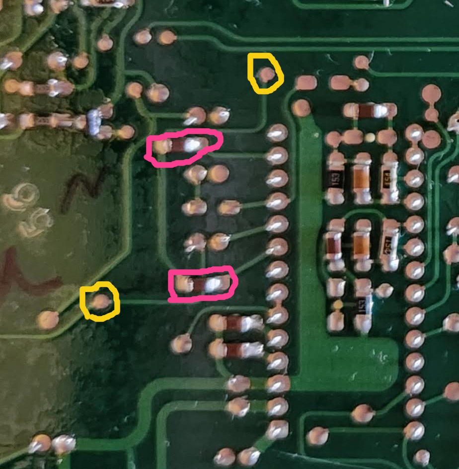

Ludus, those "posts" I was talking about are the capacitors (to really out myself on my lack of knowledge).
I am attaching 2 photos that will show where I think I'll be soldering the wires. The pink circles indicate where C857 and C853 are, and the yellow circles indicate where I think I'll be soldering the wires. One from the top of the board, and then the corresponding spot on the back of the board. My hope is that I'm able to solder the wires to the spots on the top of the board. Am I on the right track here? I do understand if people bail out on this thread.
