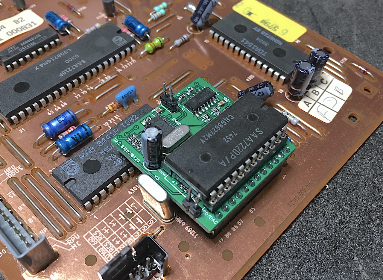

Too many adjustment pots![]()
they are not even sealed pots... but without a schematic we've no way to know what's going on here. There's this metal plate you can see with 'YBA' written on it that is glued onto the pcb and what looks like a footprint for an i.c. on the silk screen. But looking at it there's no evidence of anything underneath the thin plate, no i.c. whatsoever as the plate appears to be in direct contact with the pcb. Perhaps something SMD on the underside of the board.
What I do know is, it sounds darn good. With a Chesky recorded CD playing it's nigh on perfect.

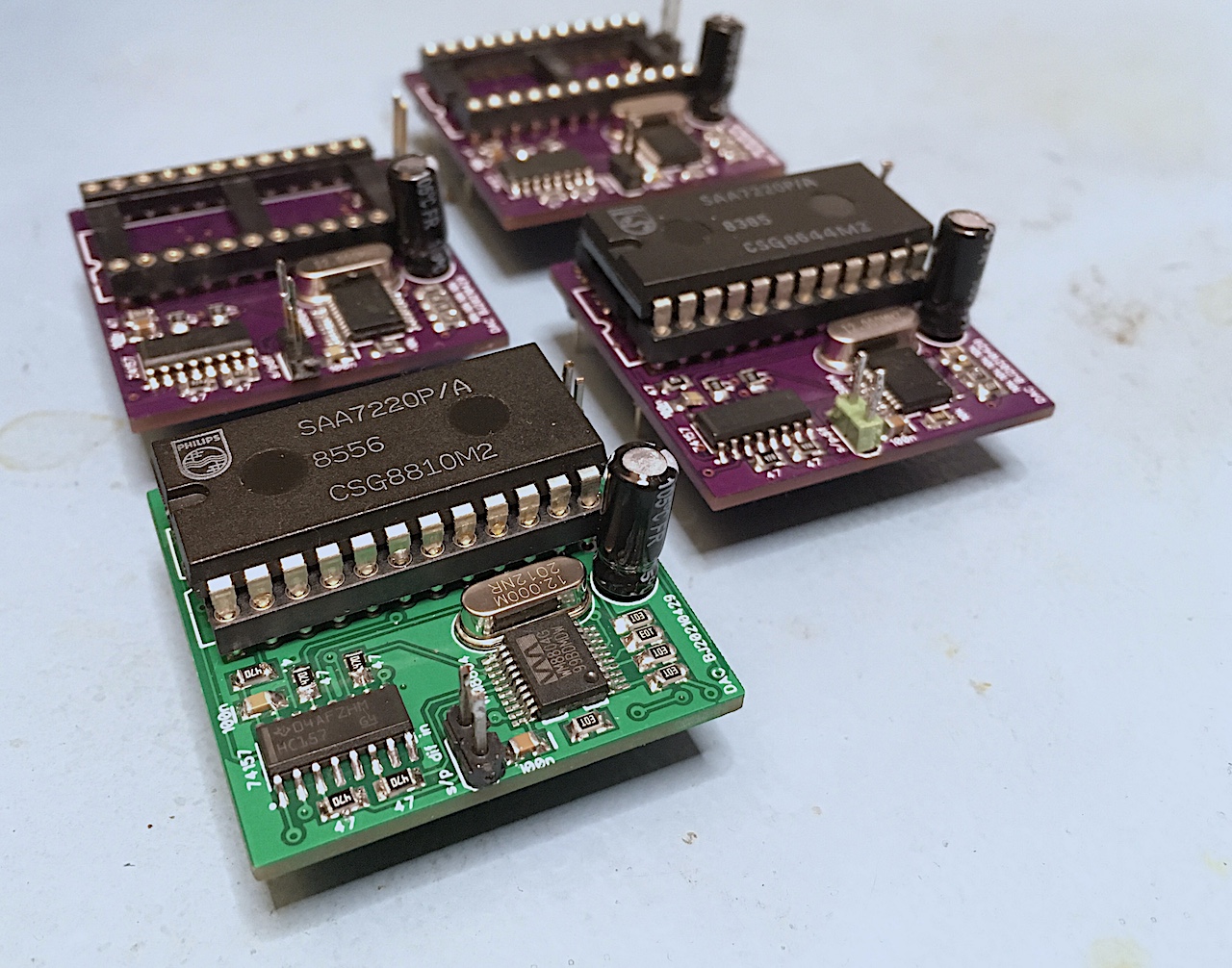

It was the Sony DTC1000ES and the PCM2500 (Player unit) , both have the TDA1541.
I created a small adapter board that add a digital input in a SAA7220 based cd player, when the player is in standby is becomes a DAC when there is a spdif lock.
when a CD is started it swithes back to CD mode

Good idea. Good design. Beautiful work. Respectful with original design.
This I guess Sanyo servo board was used is several players , Parasound , Audiomeca , Audio Aero etc etc . It's time to do full re- cap and to take care of those burned traces on Zener diode supplying display voltage. The boards are notorious for going bad. Can you post the dac picture ( I didn't read the whole thread )I broke in....![]()
Ps non of the pots need to be touched
