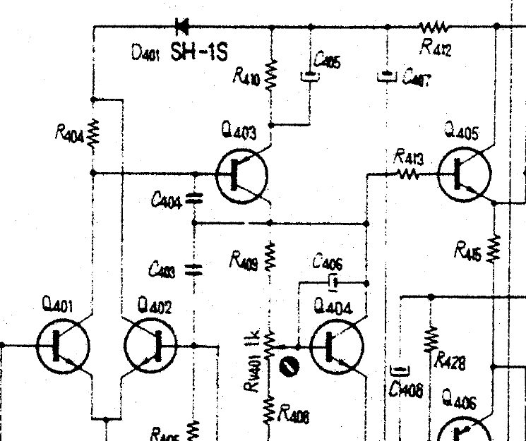

With V(B) > V(E) Q403 should be completely off. So something is causing Q403's collector to be pulled to the negative rail. I wonder if Q411 has turned to slag.
Q411 (2SC678) had turned to slag. It was shorting and the reason why DBT stayed bright. I replaced it and Q311 yesterday with KSA1015. DBT goes dark quickly now.
Your reported Q403 base voltage is 30.45 V, and emitter is 27.5V. That's about 3V of reverse bias on Q403 b-e junction, which suggests it's not conducting any current. You should reconfirm these measurements. A more direct measurement is to look at voltage drop across R410 as indication of Q403 current flow.
I rechecked voltages at Q403 base and emitter. I am now seeing 27V at Q403 base not 30.45V and am now seeing 30.43V at Q403 emitter not 27.5V. Those numbers may have gotten reversed the first time I measured them?
Voltage drop accross R410 measures 0,0mv.
Current source is basic bootstrap R407/ 406 / R408
check them.
Cap C48
R407 / 406 / 408 are bang on the resistances they are supposed to be R407 & R406 are each 3.3K and R408 is 1.2K.
I think C48 is missing a digit.

So from base to emitter on Q403 is about 3 V? Then Q403 is blown. That shouldn't be more than 0.6-0.8 V. It's a PN junction after all.
I wouldn't be surprised if Q404 is dead too.

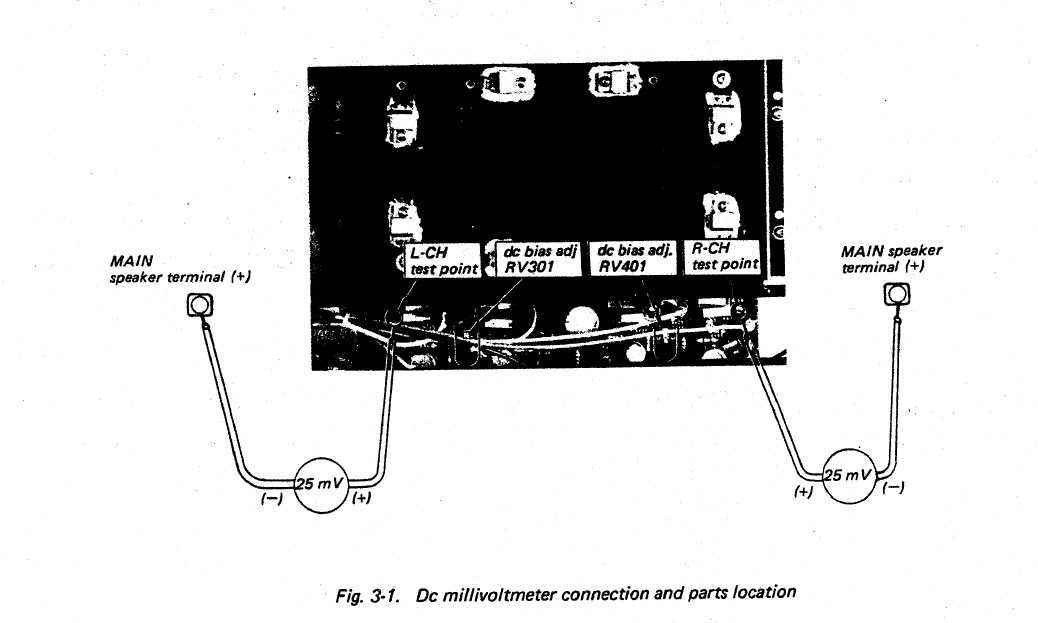

Yes, I followed service manual directions for bias measurement - speaker negative and built in test point. .
You need to take a step back here...
The correct point is from speaker positive, not negative. If you measured from the negative then you are simply measuring from ground and if the emitter resistor were OK then you are just measuring DC offset... which at 25 volts shows a problem.

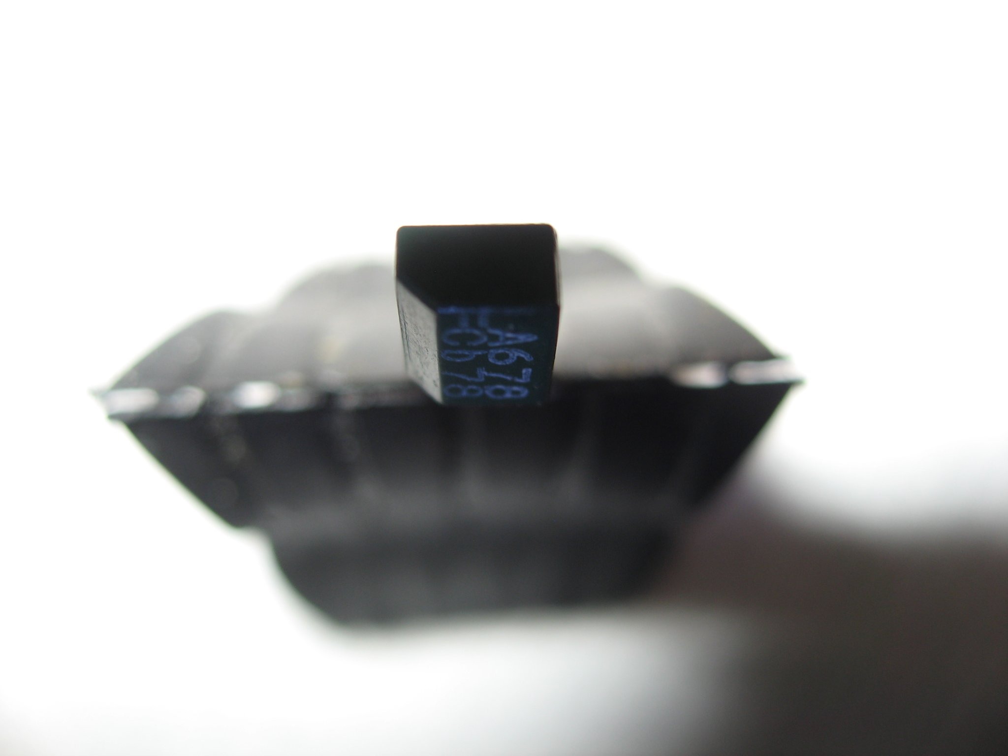

I took a close visual look at Q403 last night before bedtime and I noticed I made a mistake.

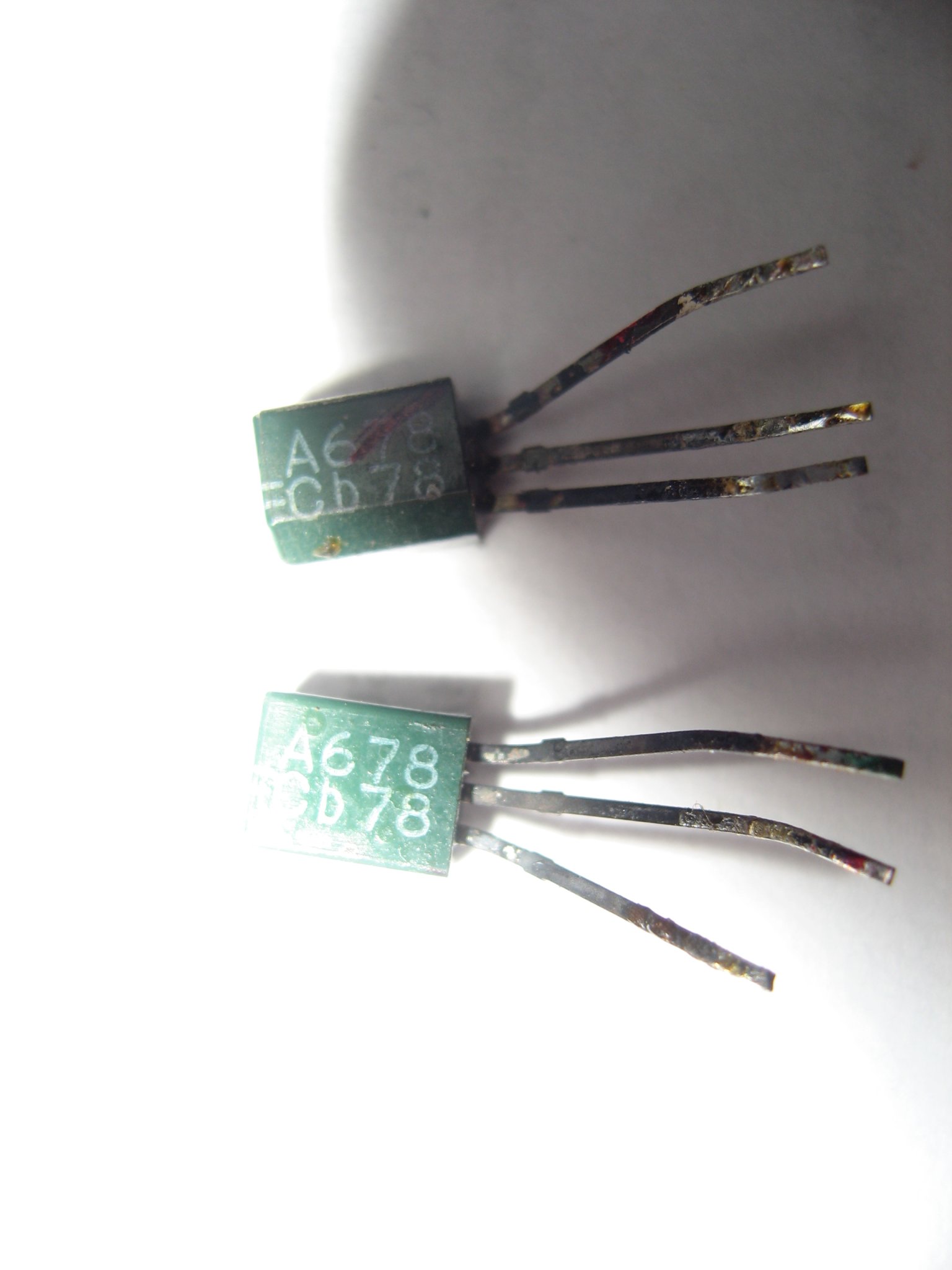

As mentioned before, the original transistor at Q303 (2SA678) was faulty and I replaced it with a KSA1015. Both have the same pinout. What I did not see was that 2SA798's has printing on both sides. That failure to notice caused me to install the KSA1015 backwards. B-C-E instead of E-C-B.
I waited until after dinner tonight to correct this blunder. I removed the KSA1015 and installed a fresh one. The DBT was in place and I intended to make those voltage measurements again but I could not as within 15 or 20 seconds, the DBT went full bright.
A very disapointing development as I was hopefull that correcting my transistor install faux pas solved the problem.
Pic is both sides of a 2SA678.

Thank you for pointing out the correct speaker terminals for bias measurement.
The amplifier is not near my computer so I was following a printed copy of the SM instructions. The clarity is not good and that (+) sign by "speaker terminal" was hard for me to see and I overlooked it. My vision has gotten noticably worse over tha past year or so.

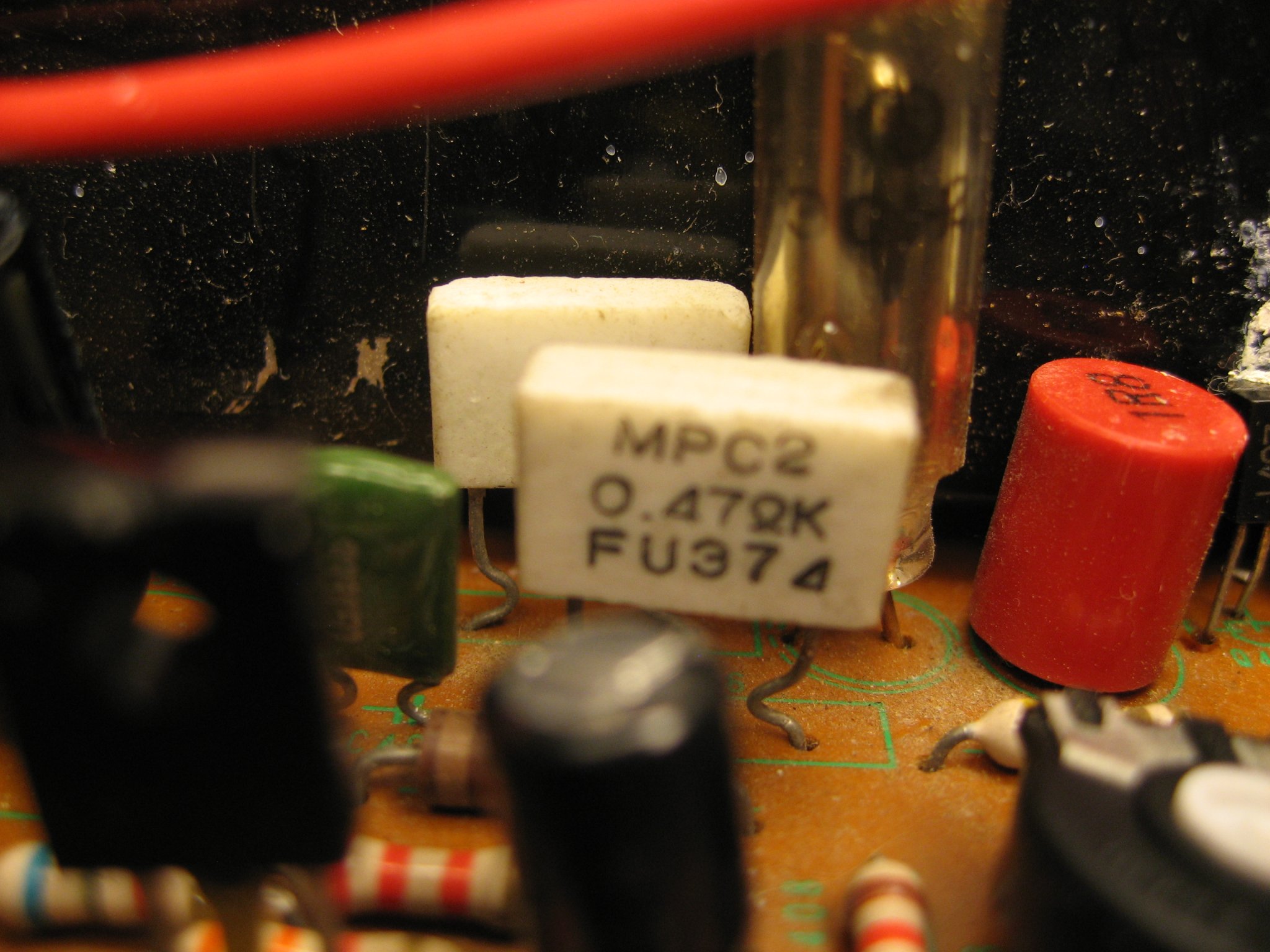

Tonight I did measure the emitter resistors. Except for R319, all of them measured over 1 ohm. 1.1 ohm to 1.4 ohm
R319 measured 0.4 ohms. I took the photo below to show what type of resistors they are. The SM parts list describes them as 0.47 ohm 2W metal oxide but I did not expect metal oxide resistors to look like these.
Should those emitter resistors be replace with new 0.47 ohm 2W or is 1.1 to 1.4 ohm good enough?

If they are genuinely high in value then they should be replaced but first be absolutely sure they really are out of range. Low value resistors are not always easy to measure because any oxidation etc on the leads can stop the meter probes making a true 0.00 ohm connection. I would check them again making sure the meter probe contact is good.
With the probes shorted you should read the lead resistance (say 0.1 ohm) and that has to added to the result.
If you can measure from the solder side then press really hard into the solder to get a good contact and if they are high then they all should be replaced.

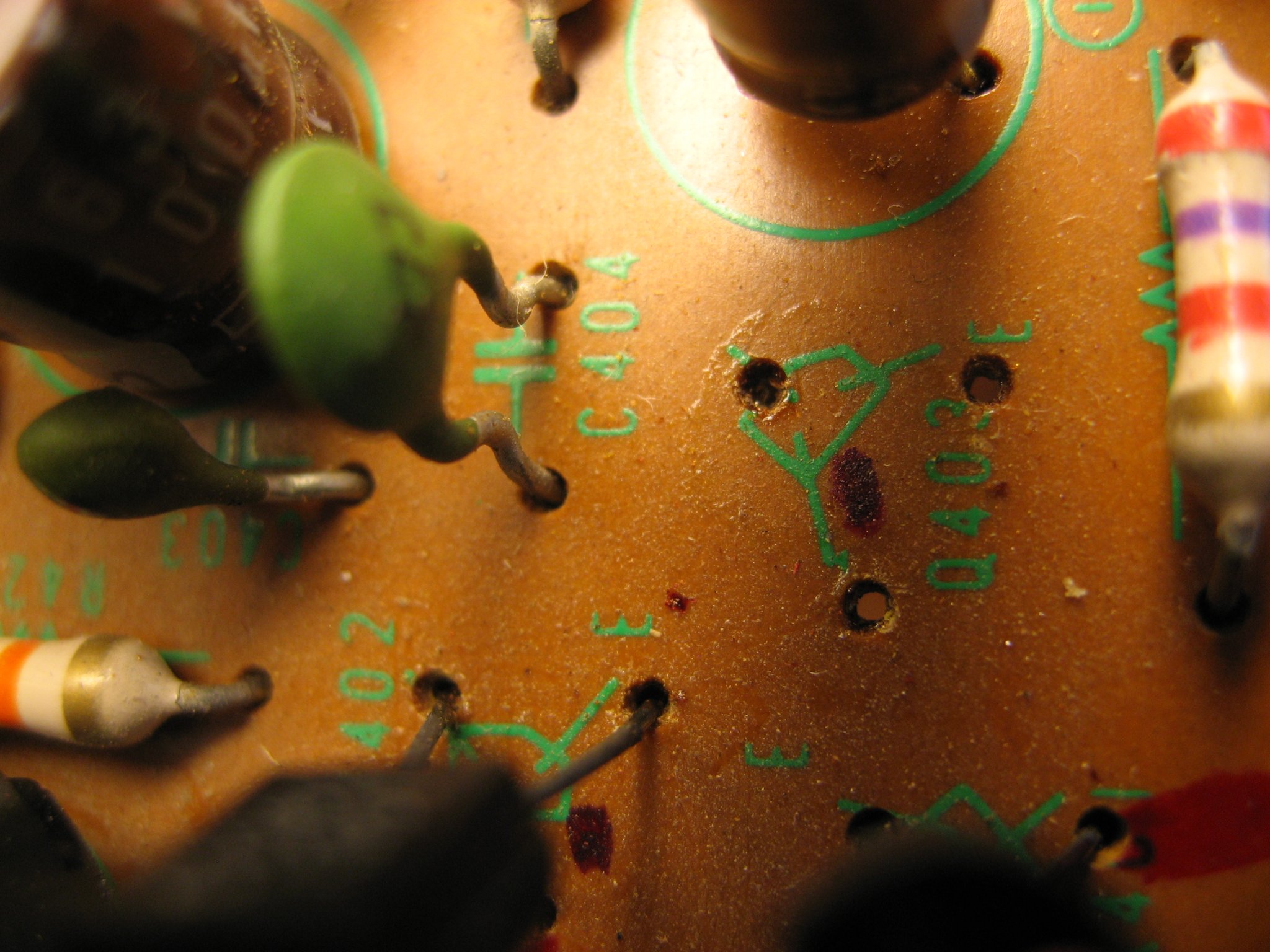

I am bothered by Q403 so before beginning on those suggested steps, I looked at it again. Formerly a 2SA678 now a KSA1015 both of those transistors have an E-C-B pinout. I would like to confirm that I have the transistor oriented correctly.
The first photo is the unoccupied Q403 spot and E is clearly marked at one hole. Comparing Q403's silkscreen image to other images where a 2SA678 is present, they differ somewhat and I am uncertain as to which hole is C and which hole is B.
The 2nd photo is of a 2SA678 which has a beveled corner. That beveled corner is represented in the silkscreen diagram. As positioned, in the photo, pinout of the transistor, left to right, is E-C-B.
With no question which hole is E, I did have B going to the top left hole and C going to the bottom hole. But a transistor could easily be positioned to reverse B & C.
What are the holes on the board - the tracks and connecting parts (resistors and capacitors etc) will tell you (regardless of the silkscreen prints).
What is the pinout of your transistor - your DMM will tell you (unless you have invested some small money into a LCR-T4 style component tester).
After that - 2+2 is usually 4. :)

The coating on the trace sice of the board is heavily applied and it's thickness varies. It was hard for me to see some traces at all in some areas and overall hard to see period.
I needed to compare the trace side diagram in the service manual with the photo I posted above. That allowed me to orient the E-C-B holes, relative to the other components surrounding the Q404 transistor.
When satisfied I had the orientation correct, I installed another fresh KSA1015 in place of the original 2SC678. I wished to see if that permitted the DBT to dim right away after the amp was switched on but it did not. Used in conjunction with a variac, the DBT glowed steadily beginning at about 50V and grew brighter if I turned up the variac.
